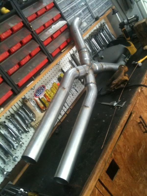

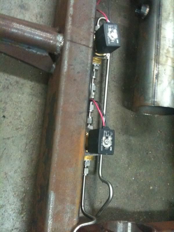

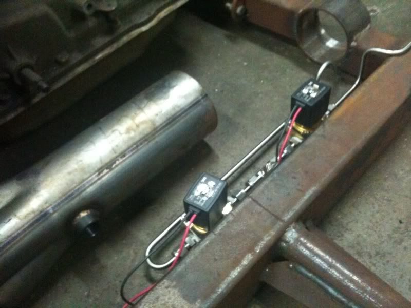

gayest line to bend.. with a few clamps itll hold it tighter to frame..

I am glad it's you bending that line and not me. I would have destroyed a ton of it trying to get it that nice.

haha.. im not totally happy with it. but some of the bends are as close together as the bender would allow.

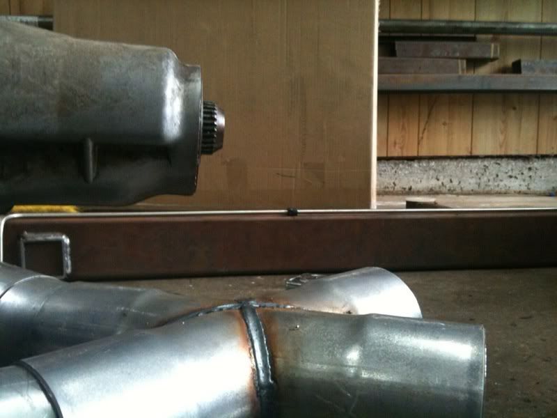

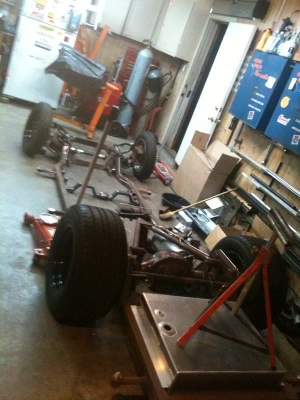

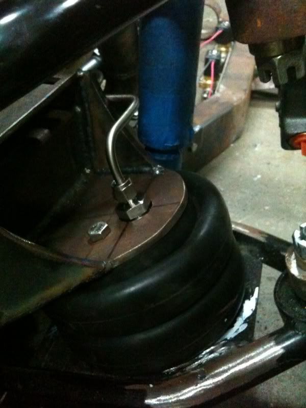

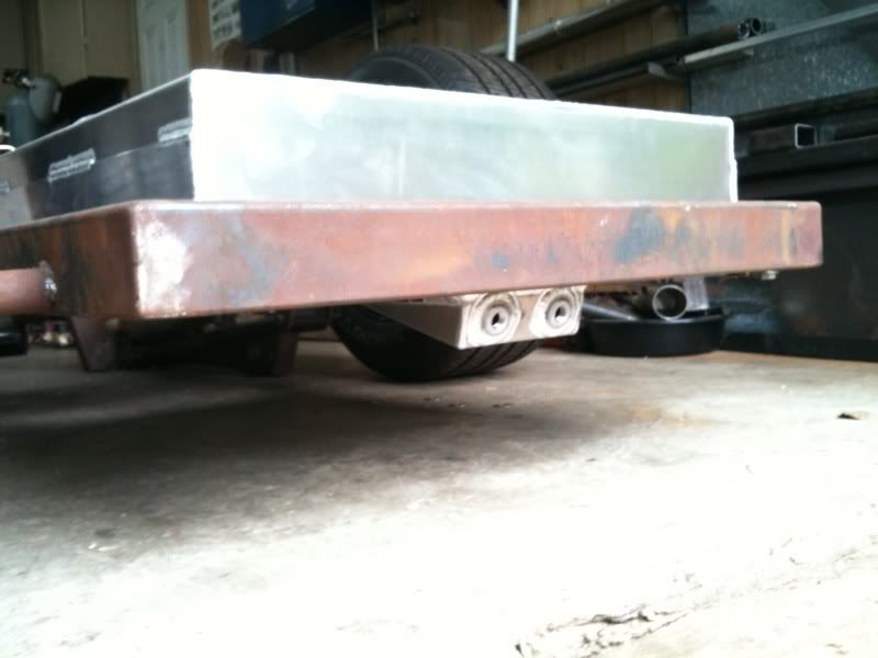

dad did a little machine work on some pipe to get me the id/od i wanted for my exhaust to run through..

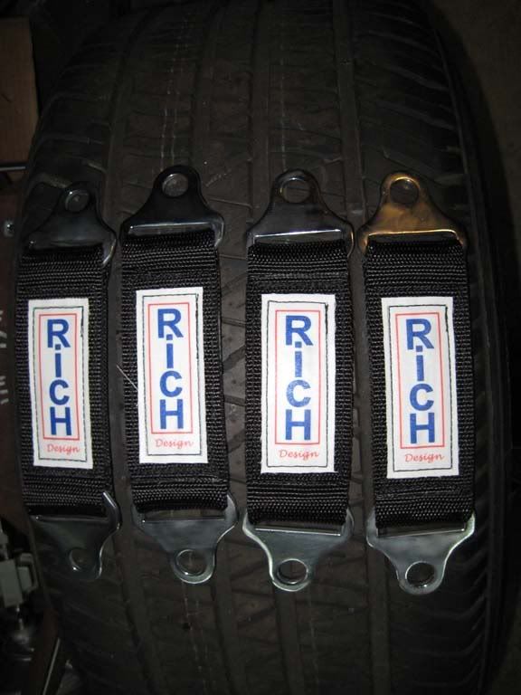

limiting straps came in.

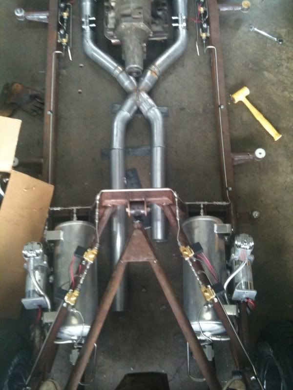

all of air suspension tubing done..

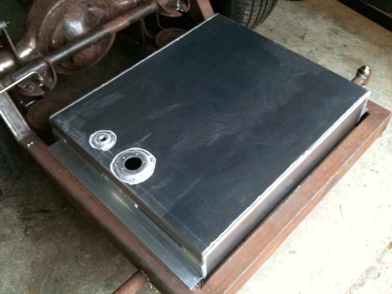

fuel cell arrived.
all my exhaust shit is here too.. along with dads windshield. woot. its like christmas.

Cool! A word to the wise though. I have those same (*&%( hardline fittings on one of my fuel systems, and they don't like to be reused much...

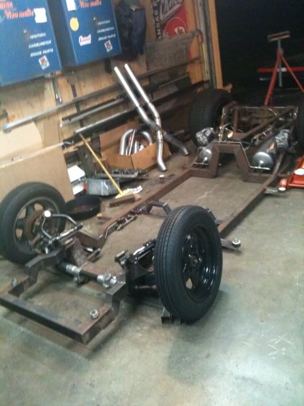

whats with the crossing of the exhaust pipe?

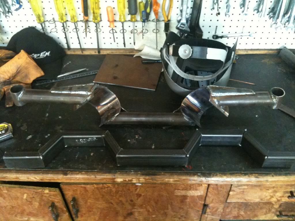

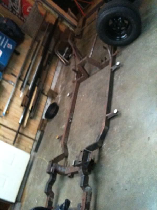

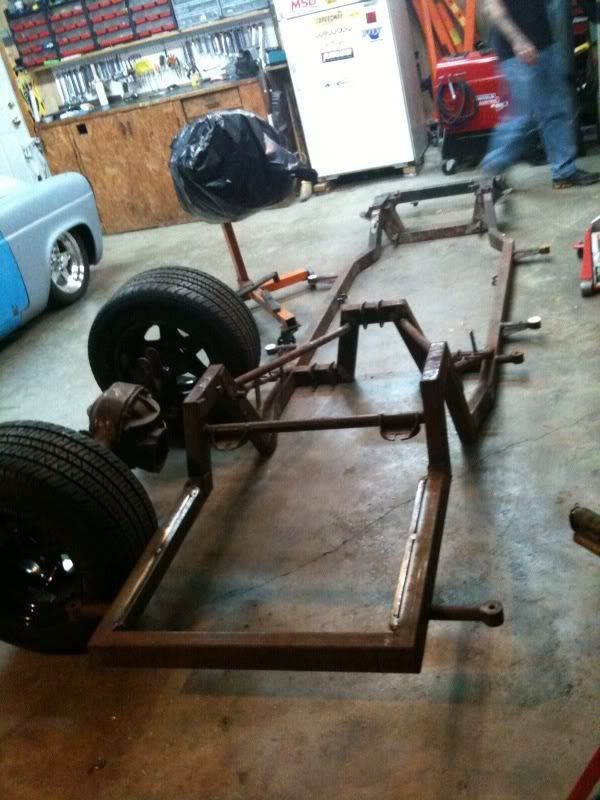

made a tranny crossmember yesterday.. hated how it was looking, and it was still a little flimsy. so i found a metal supply shop open today and ran after some 1x2

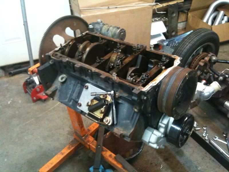

started tearing down the motor.. looks to be in great shape, just dirty. i will take it all apart, have block hot tanked, then get new bearings n shit, different cam, and maybe a few other things and go back together with it.

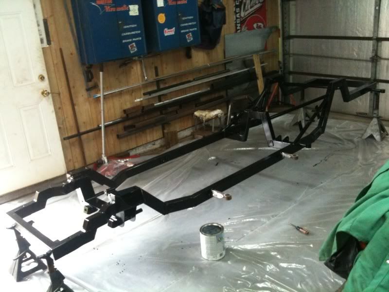

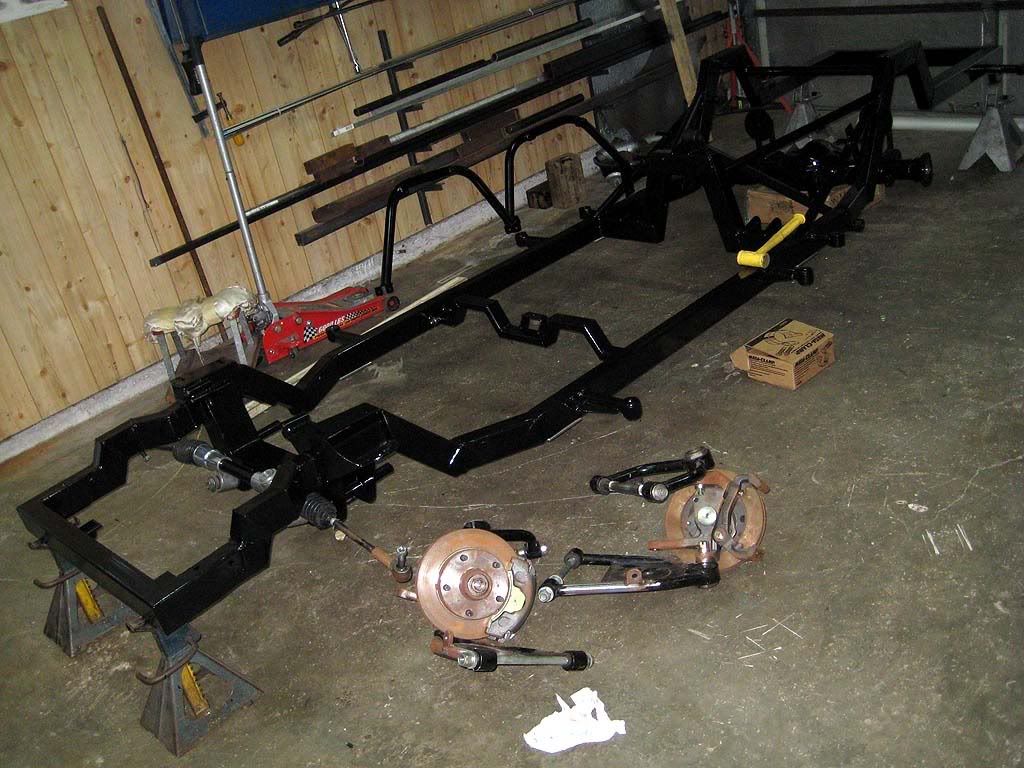

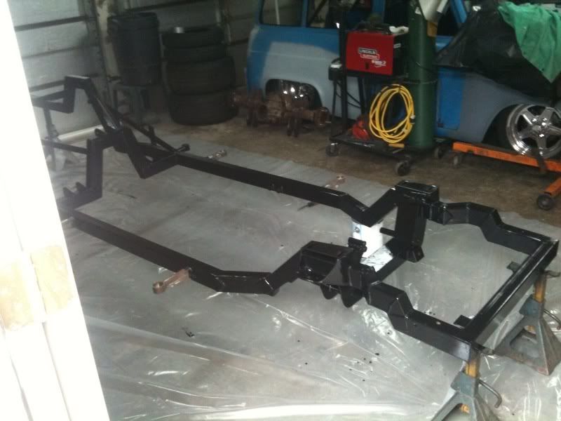

one coat on everything minus body mounts
pics do it justice

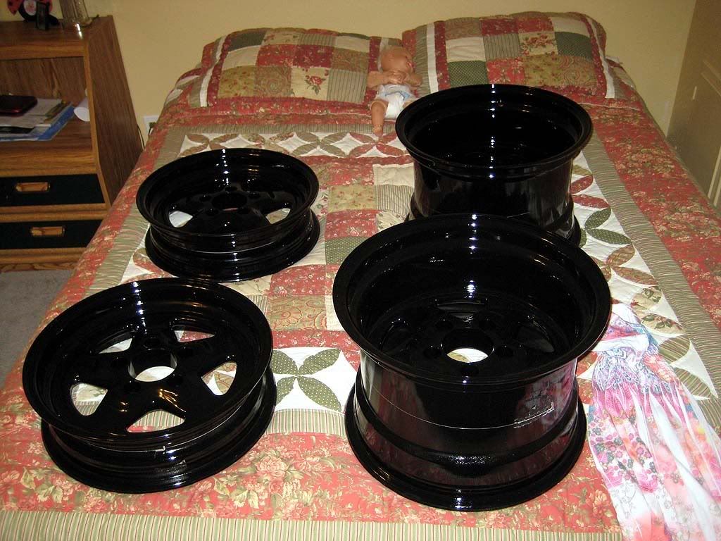

got a call today.. my wheels were done! yippie.
so i called discount and ordered my front tires. should be here thursday or friday. so i will go get them and get them mounted along with my slicks then woot.
