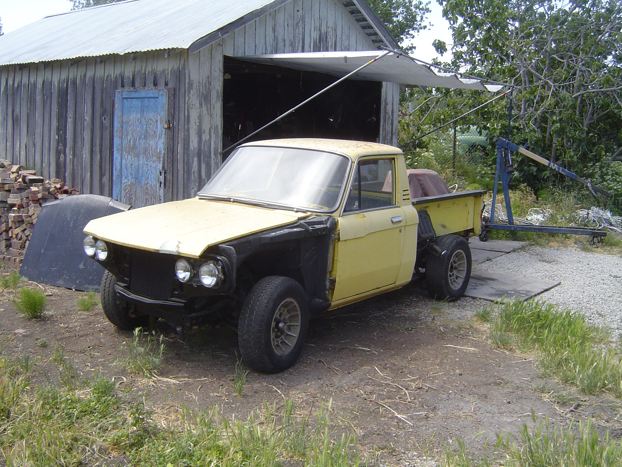

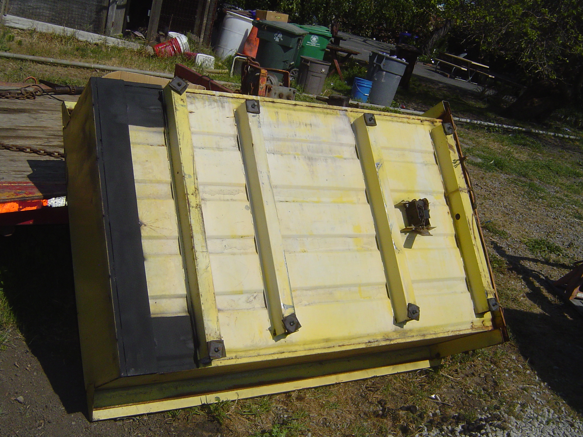

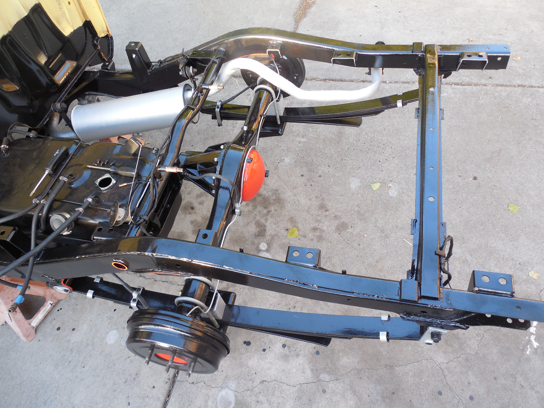

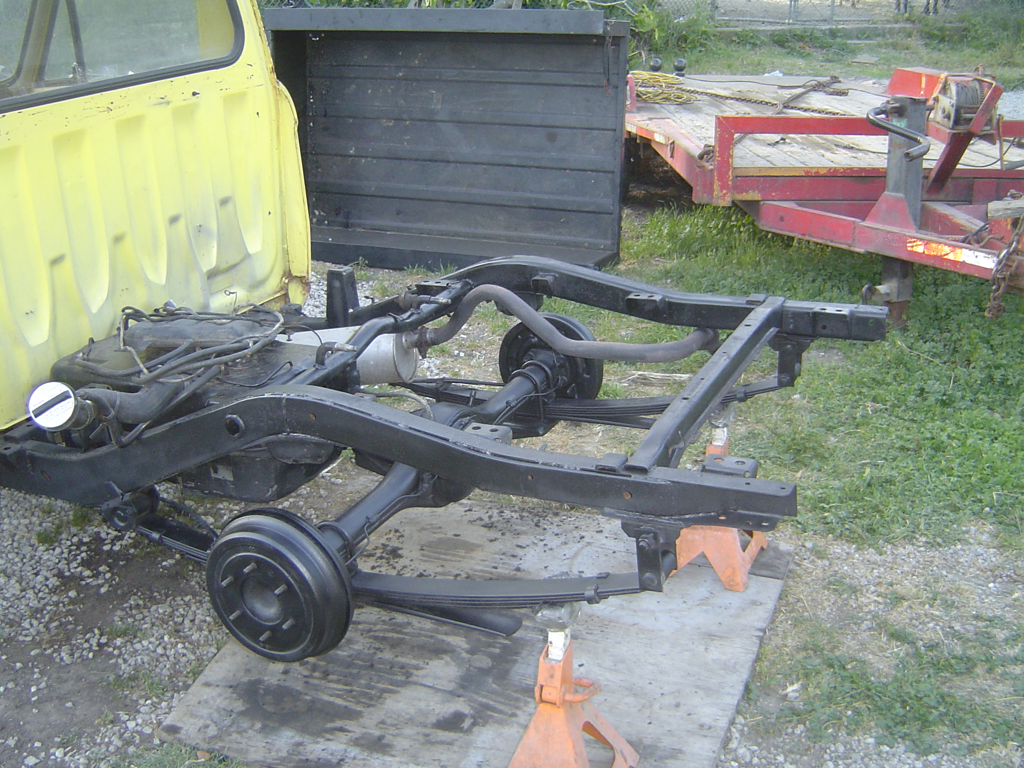

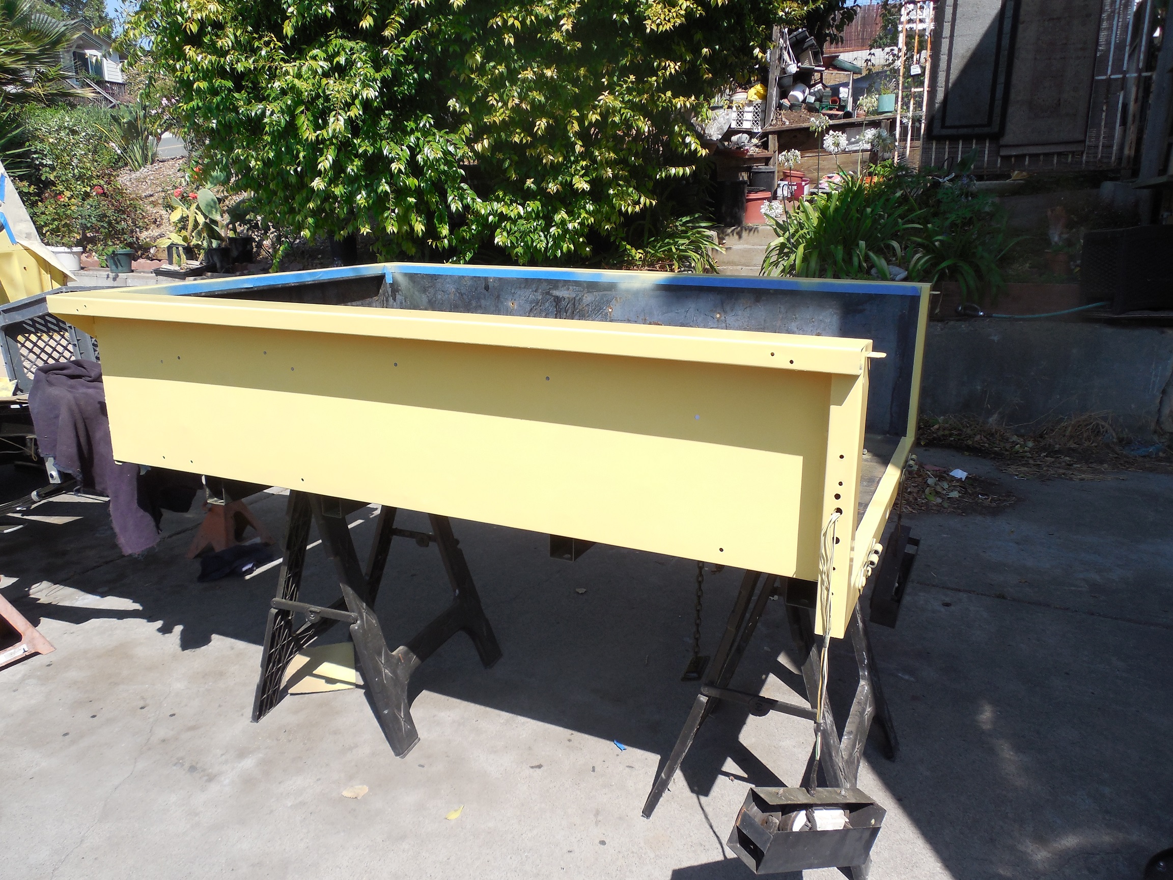

some parts had shown some rust so i wire wheeled it treated it w/ citric acid and added the metal to support.
cleaned up the back frame area as well and coated it w/ some paint. along w/ the front headlight area...but wanted to geet as much stock yellow as i could =

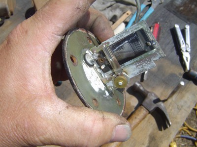

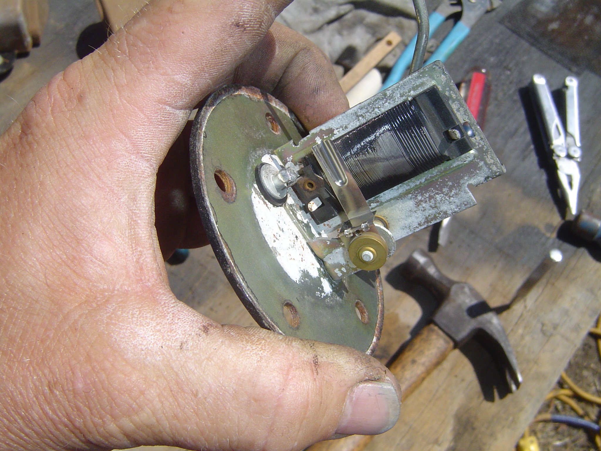

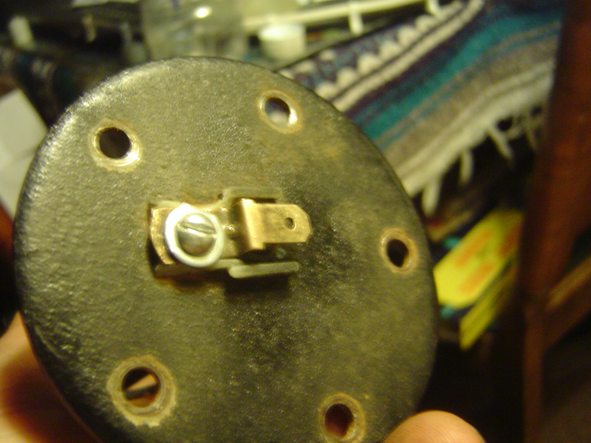

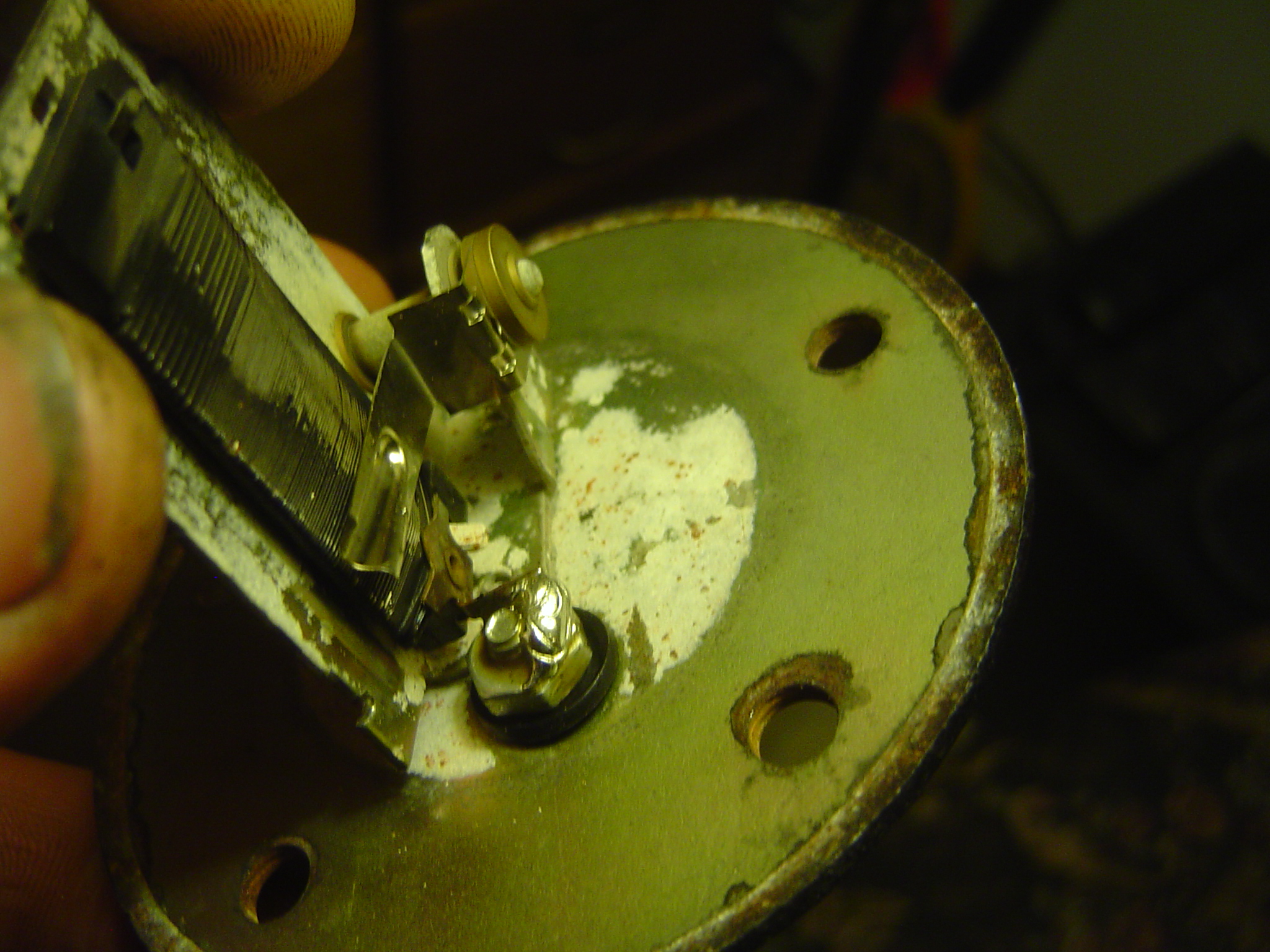

So while the bed was off i checked out the fuel sending unit looks like it had a bad connection so added a small bolt and soldered the connection to get it working again...till i can replace it later

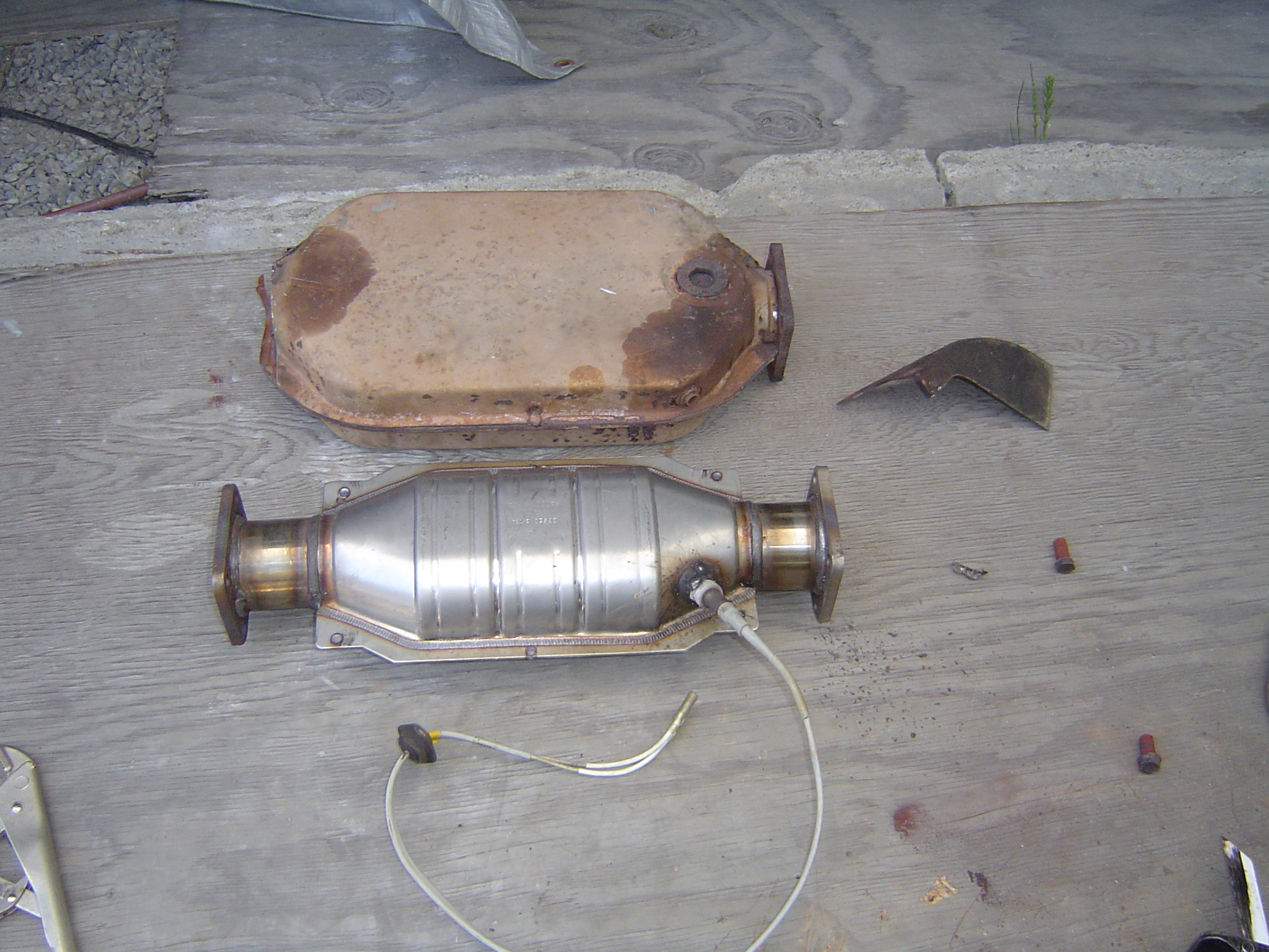

swapped out the cat w/ one i found on ebay...wanted it to pass the smog inspections so i had the muffler shop transfer the sensor in it so it at least past the visual ...no problem when it was smogged :D

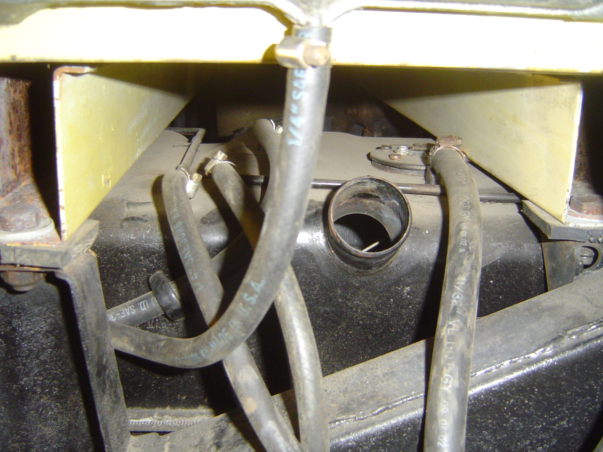

got the bed back on so i could put the fuel fill hose back on....on the step bed the hose had a nice bend in it & seems to cause problems when filling so get it as straight as you can or the gas pump sensor will keep triggering off

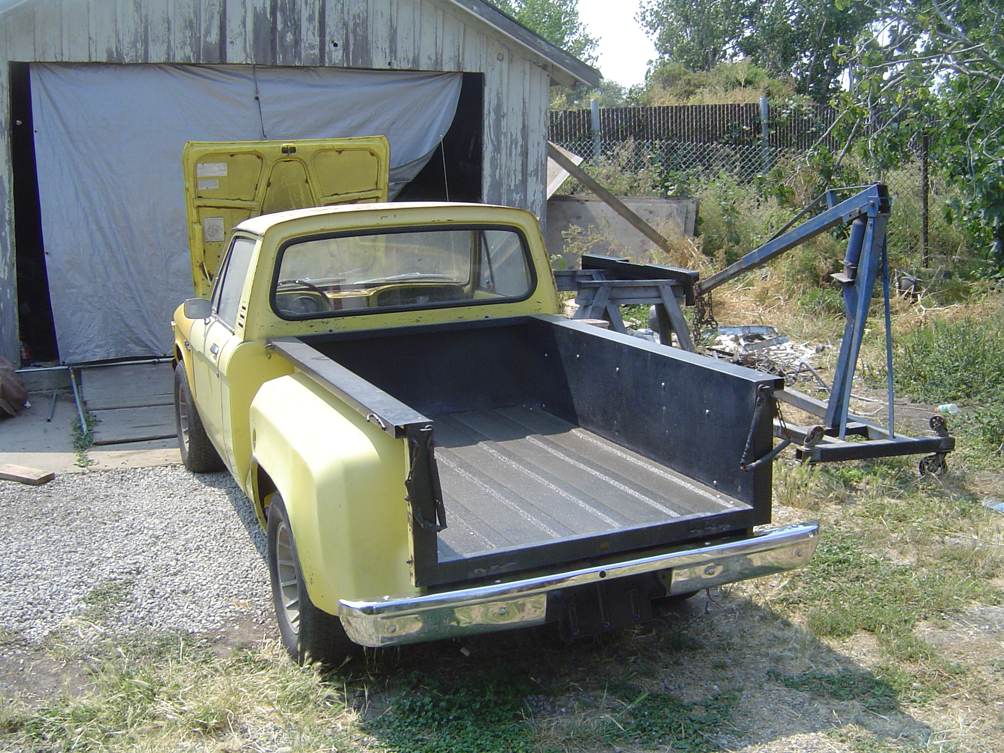

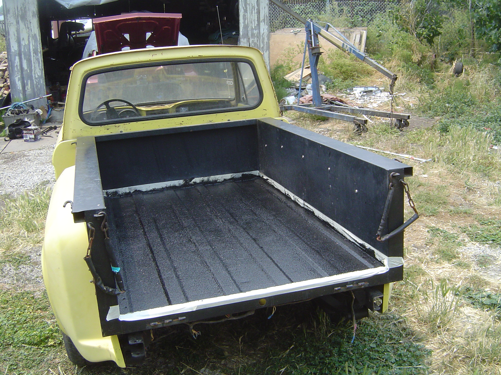

Got the bed back on. I coated the inside bottom w/ some Hurculiner bed stuff.

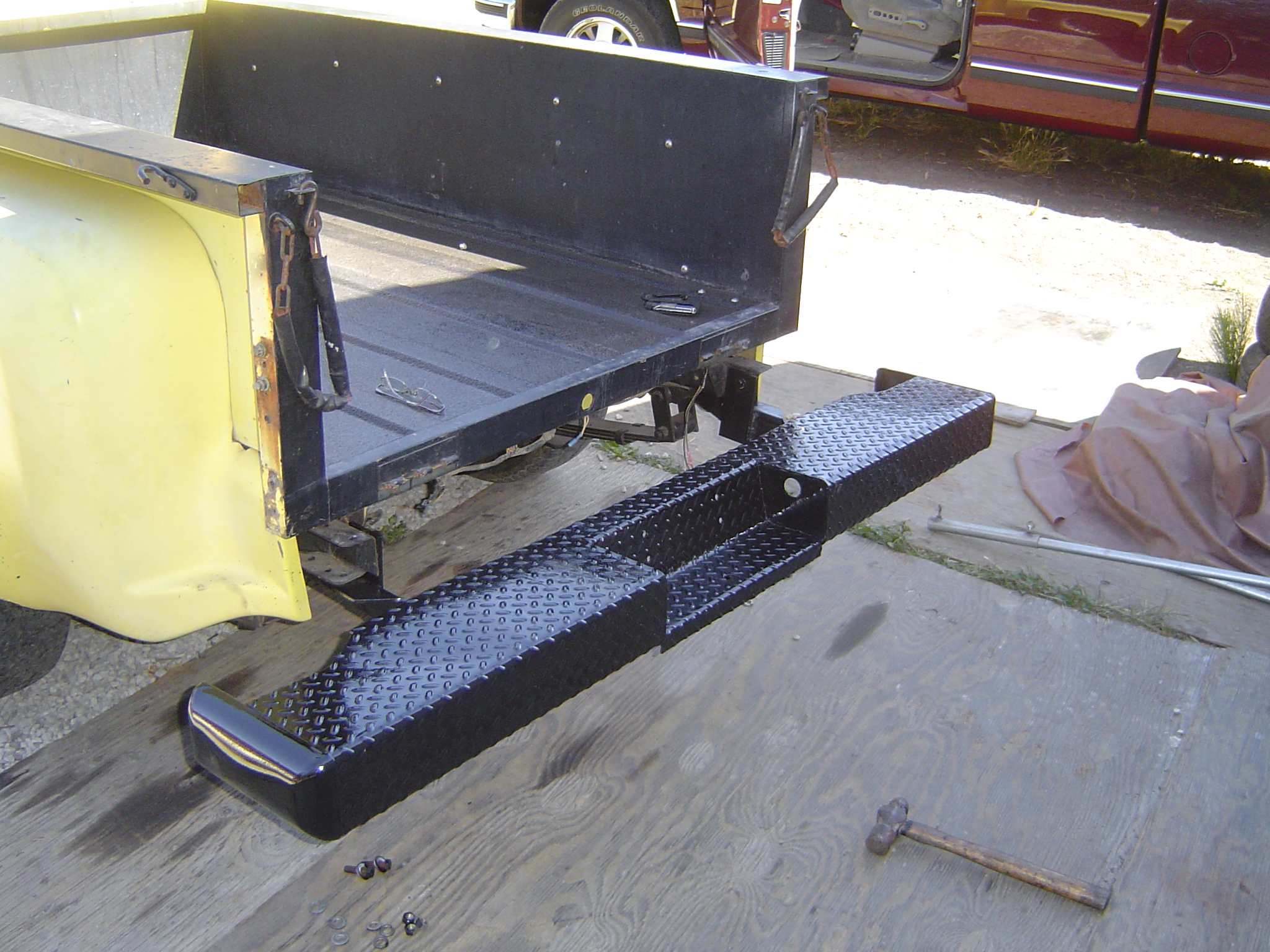

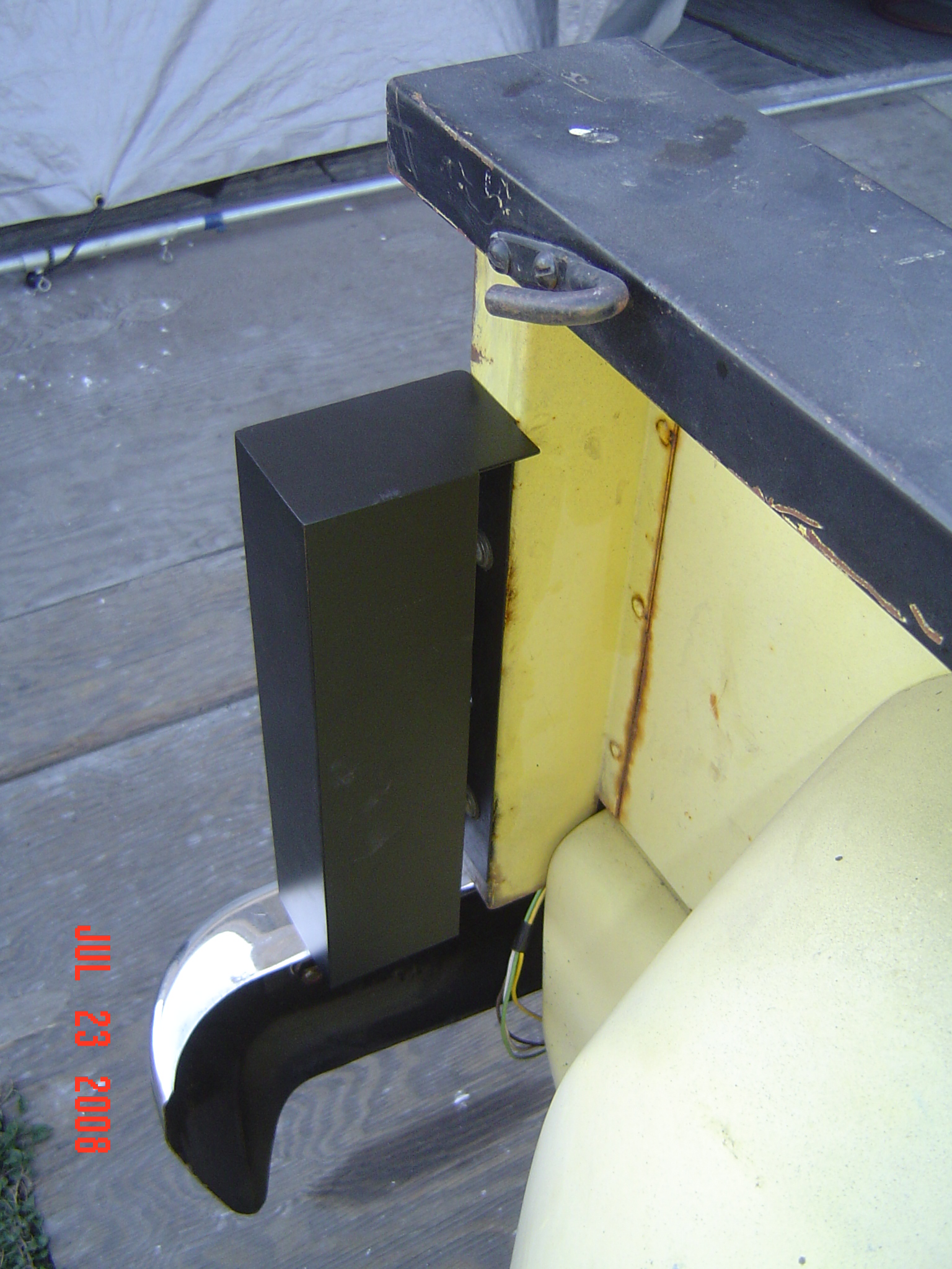

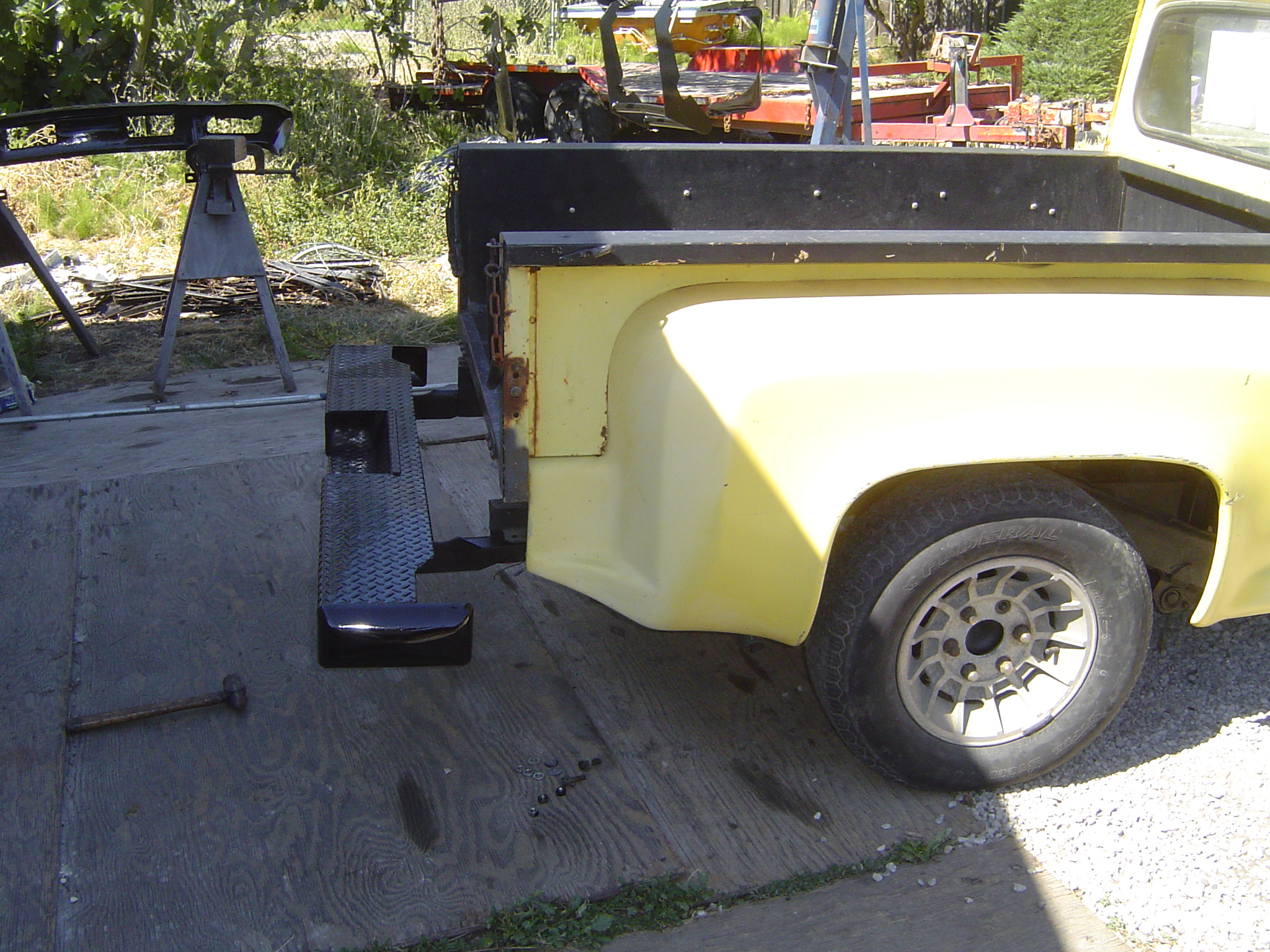

got the fenders back on there getting easier to install :lol:...cleaned up the rear bumper i gave it a coat of paint ....but it stuck out like sore thumb...DON'T YOU THINK....LOL

NICE looking rear bumper and was thinking to shorten them brackets but just looked to big so i decided its NOT for this Stepside

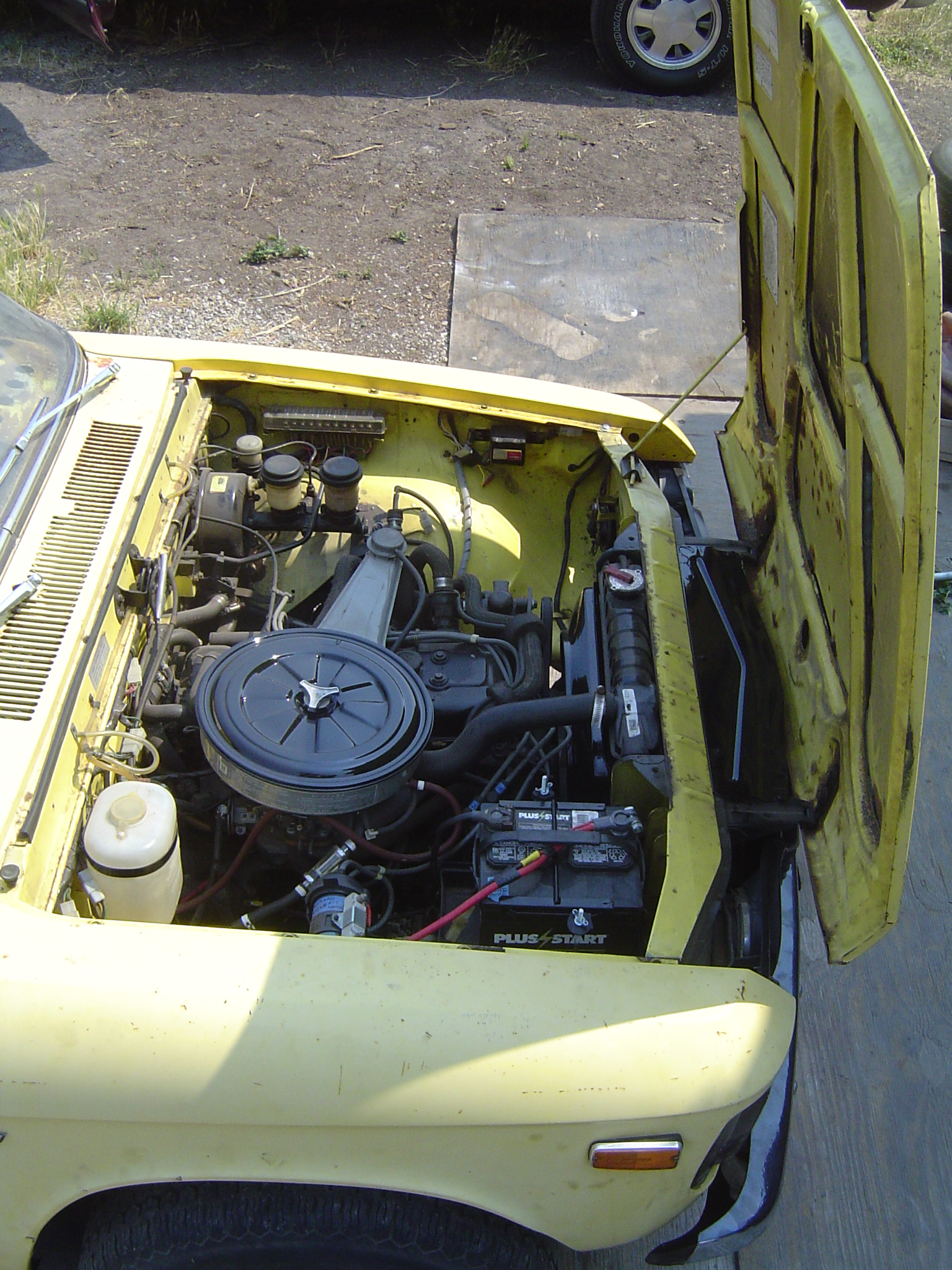

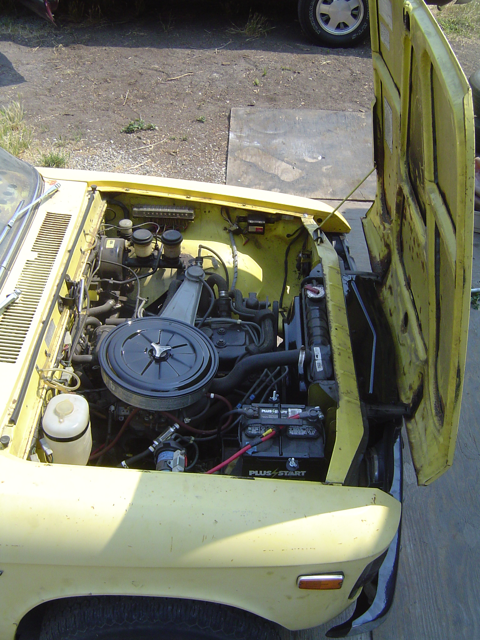

Started back under straightening up stuff the hood getting it dialed in.

decided to go ahead w/ this bumper but it seems a little long w/ the thinner step-side bed.

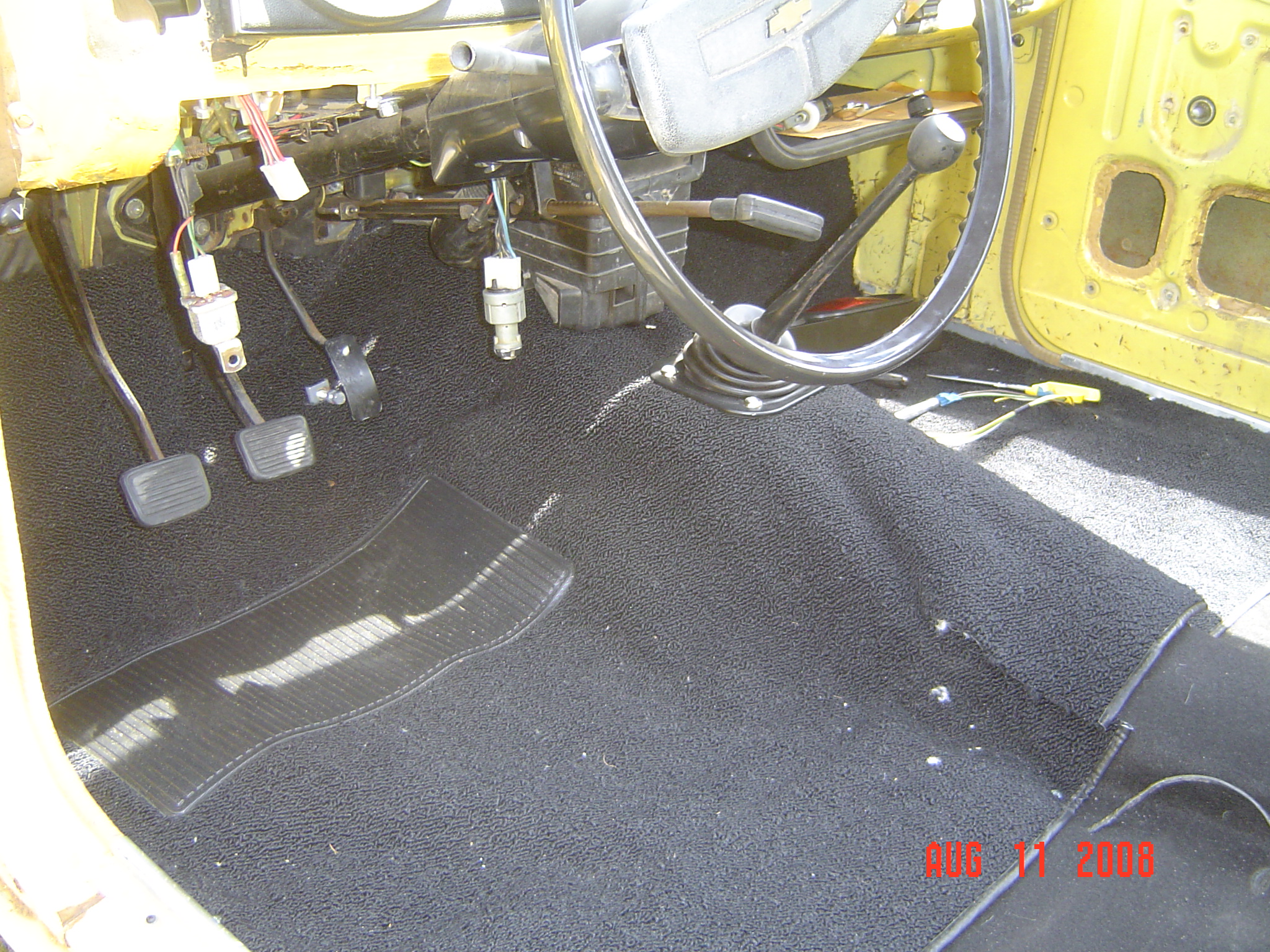

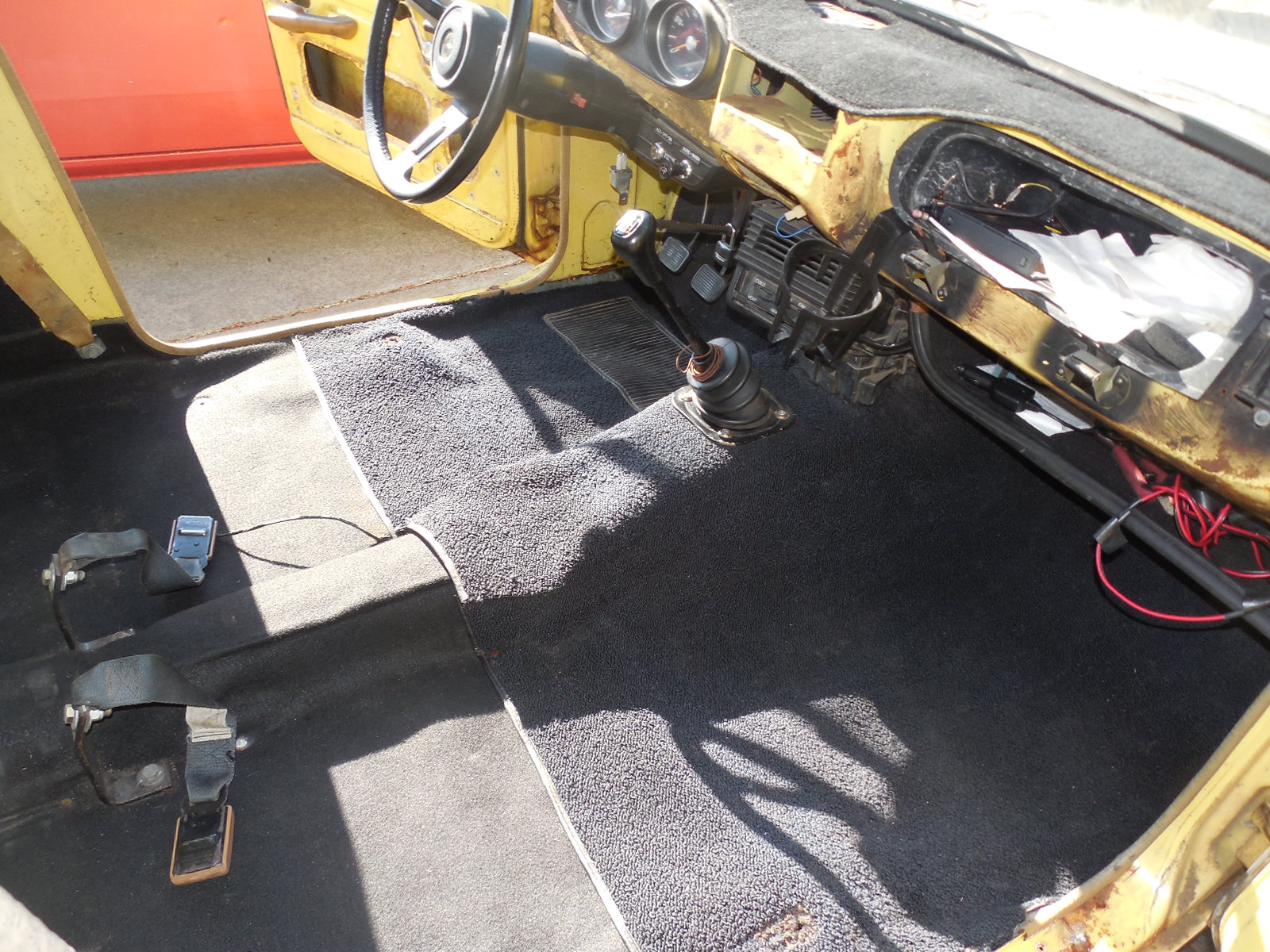

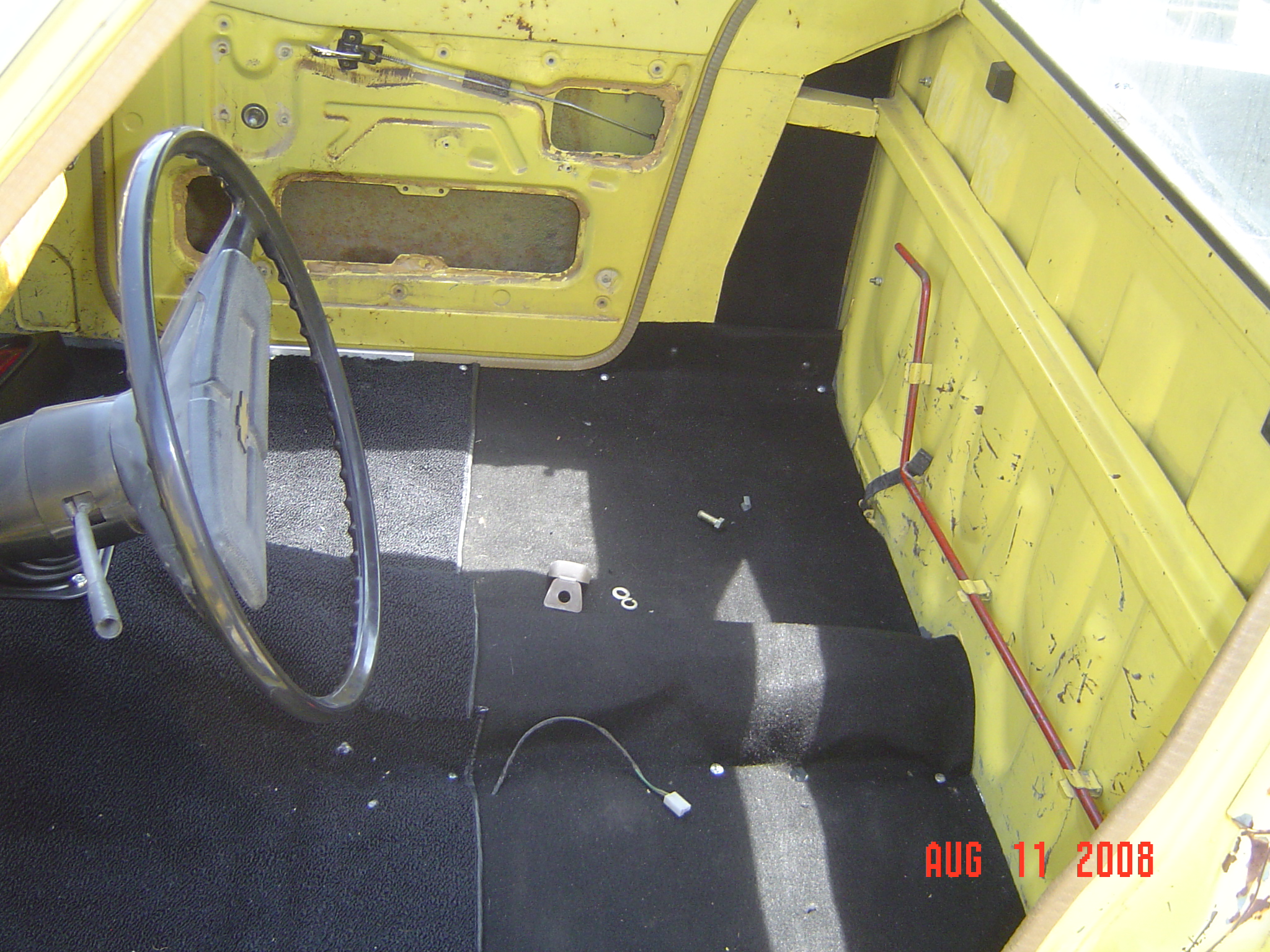

found a good deal on a new unused carpet from old chevy impala ...trimmed it so the pad was at the drivers feet and trimmed off the rest...only went 1/2 way back and used felt for the back 1/2 ...thinking i will use the back 1/2 of the carpet for the back wall of the cab

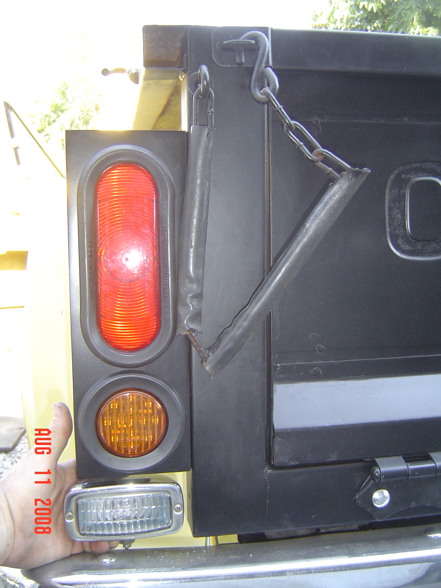

the old rear lights was brittle and all rusted up inside pretty good so to get this truck out on the road & drive-able
I made these boxes w/ some lights i had until i figure out something else.....thinking to use these vw reverse lights ...but never installed them....looking at some led lights these days ...but still not sure ...seen some stock looking lights w/ leds...so well see
I think i need to brighten up the back so i don't get rear ended & next up tailgate hinges i'm finding that they are hard to come by so probably going to make a pair fit from the hardware store.

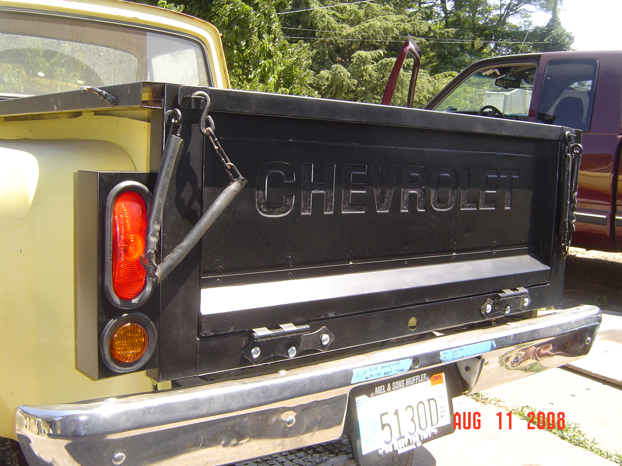

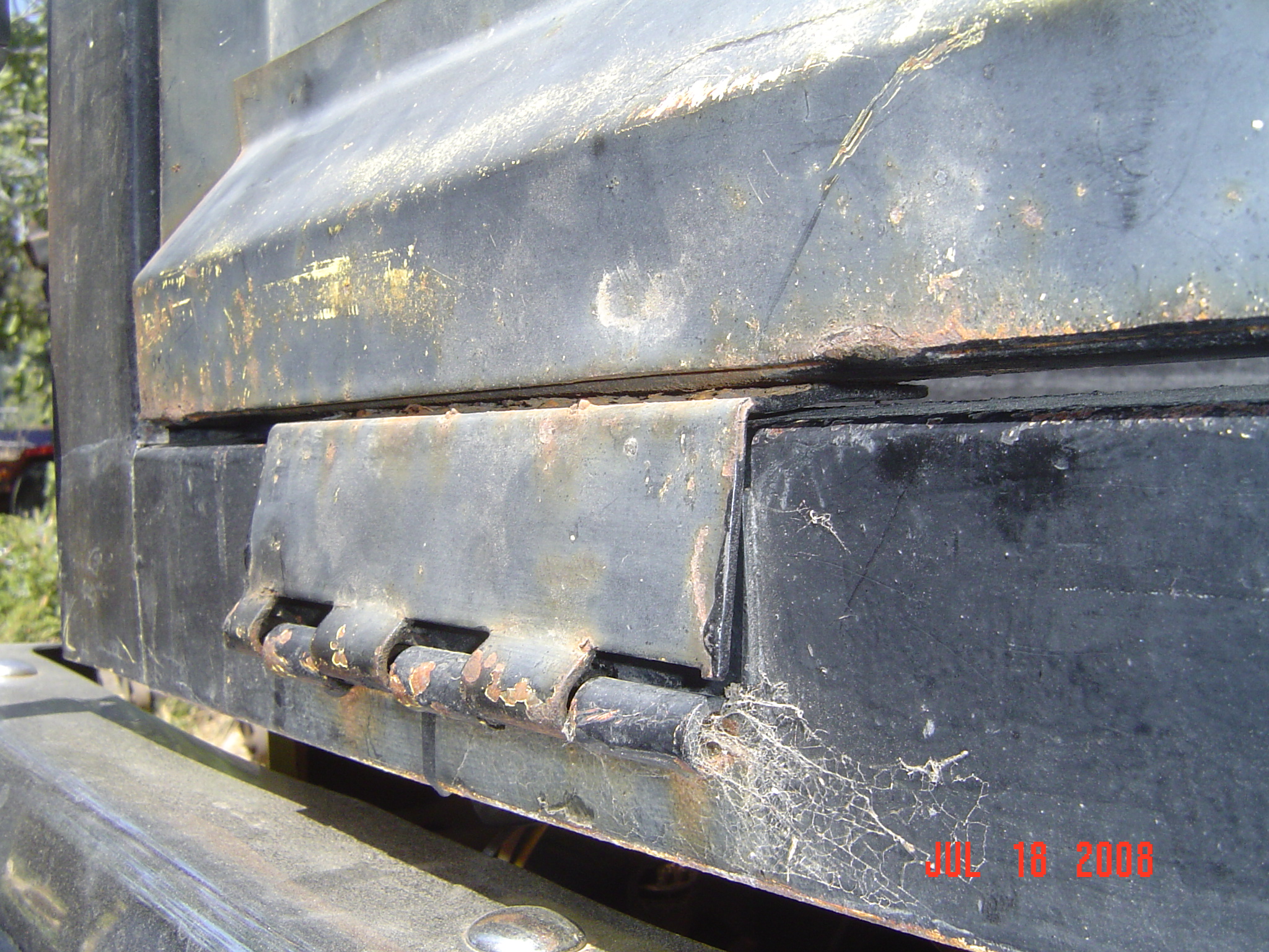

back working on the tailgate .... I modified these gate hinges to work ..but when doing this i found the stock hinges left the gate level w/ the bed opening. These are a little higher so sliding things out the bed you have to lift it to get over the tailgate.
I also cut off out & added the "Chevrolet" panel from a fleet side tailgate to make it look like the full size Chevy truck tailgate.

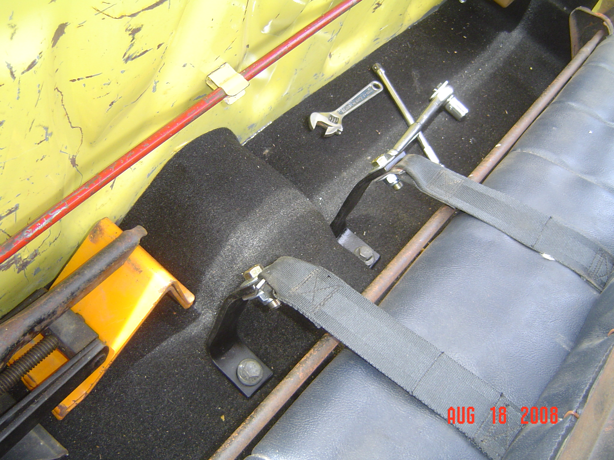

once the bench seat was back in, I found the seat belts were a little snug so i extended them w/ a couple beefy brackets for a little more breathing room =).....
it's running good & slowly refreshing my brain to this LUV...i'm now ready to go on a road trip

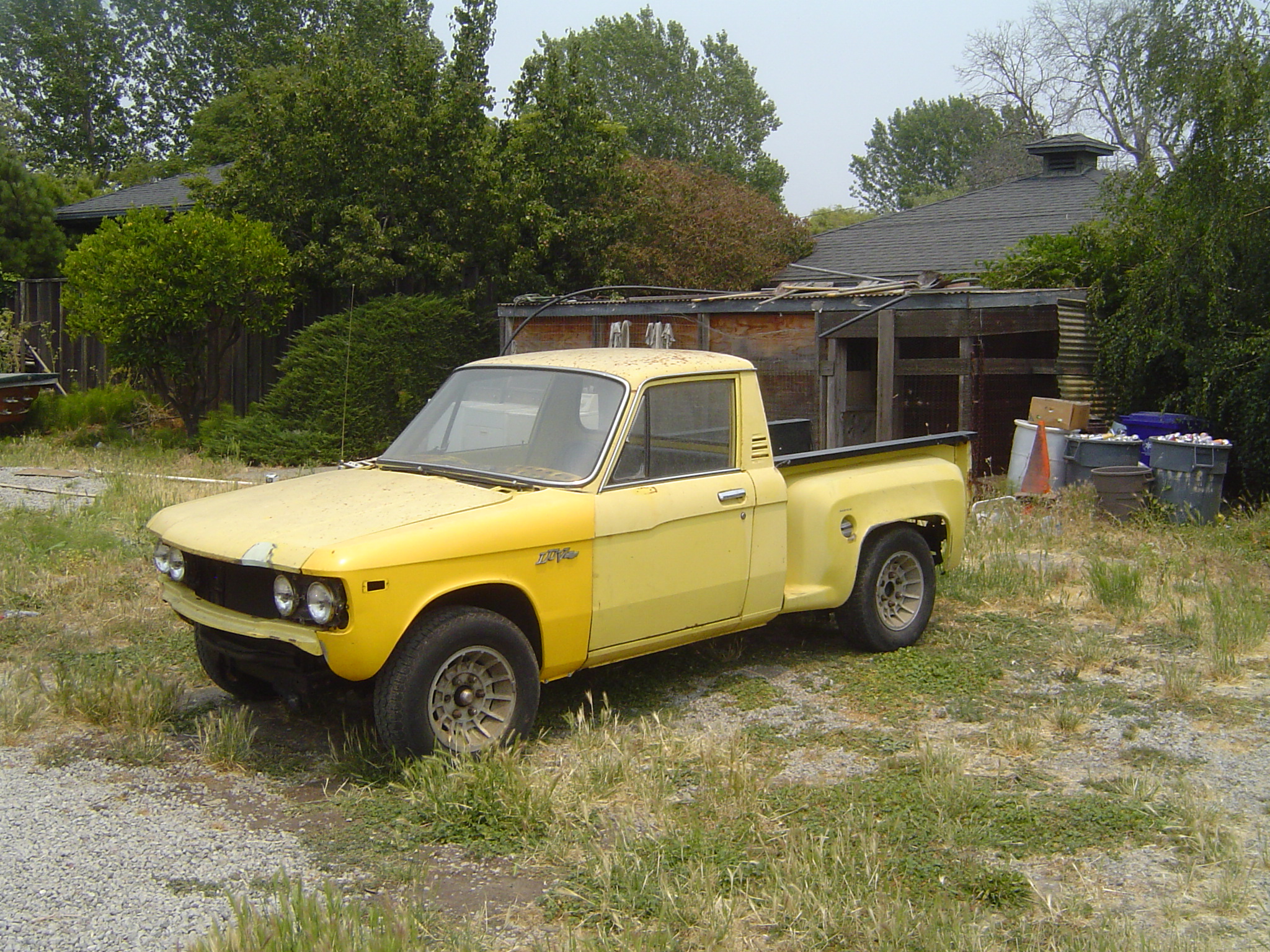

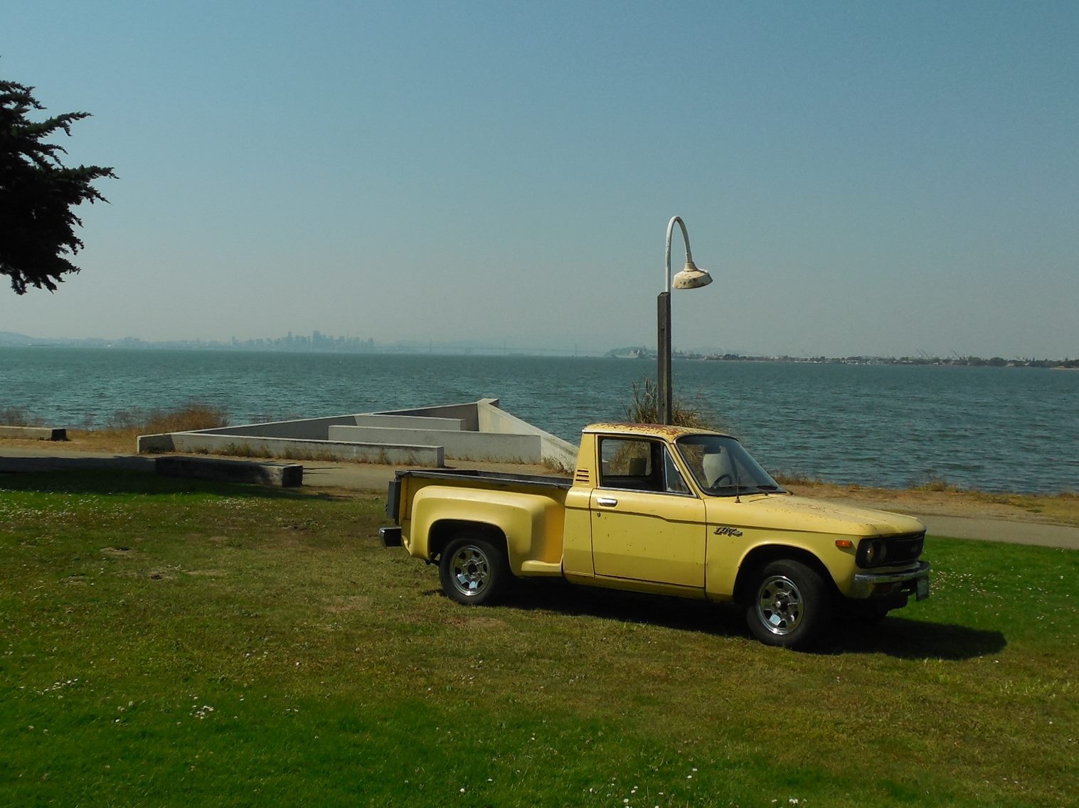

I've been just enjoying it relaxing as it was back on the road No radio still listening to the engine while collecting more parts for her and swapping a few to people who are in need...hers what she look like now...still didn't put door panel back on dash pad is still out..a few people acknowledge what they see and give me a thumbs up when driving...which is always nice
1030

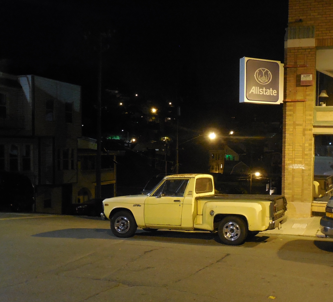

Been a whole since i posted out for a ride a few months back SF in the background2896

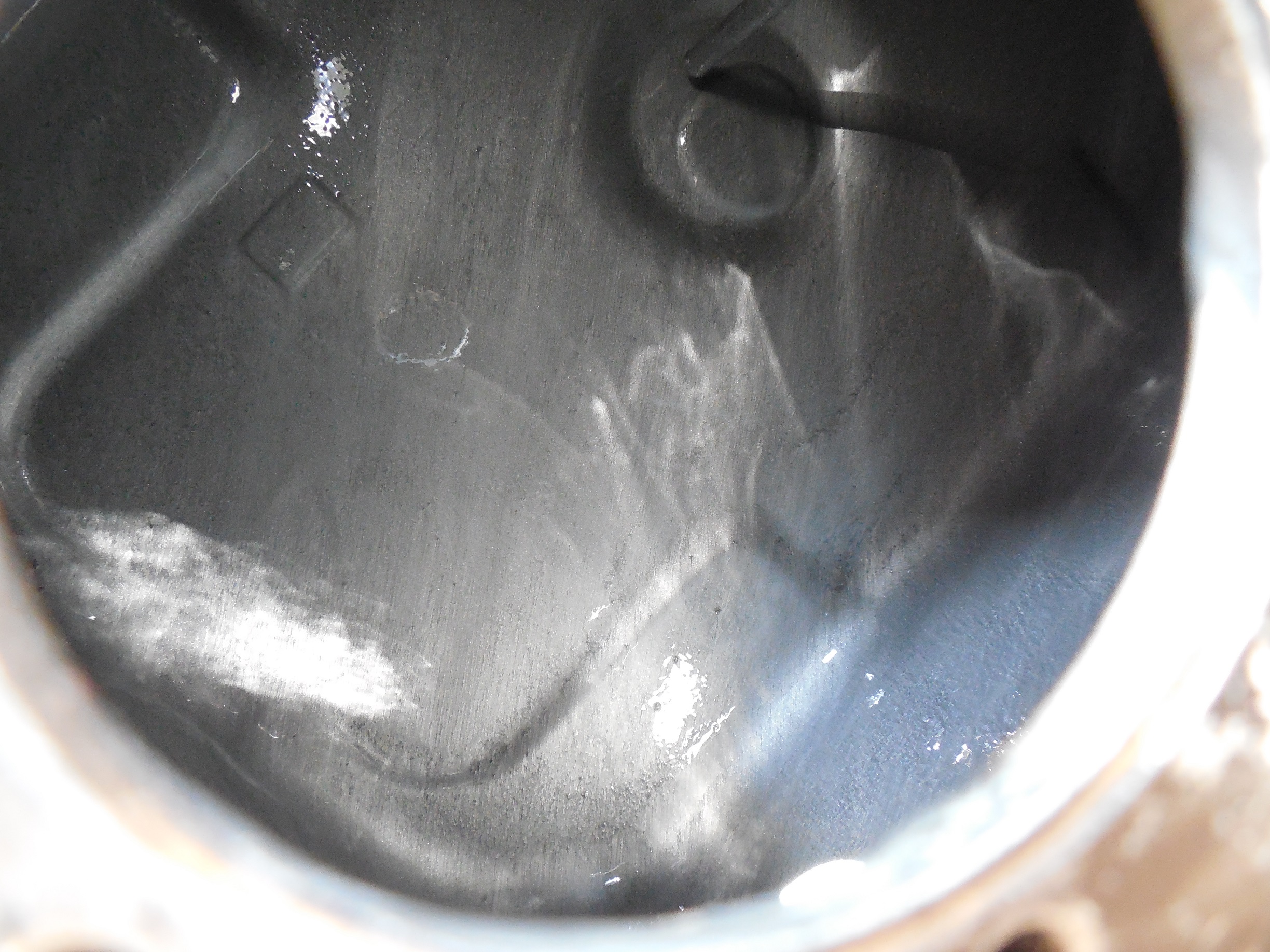

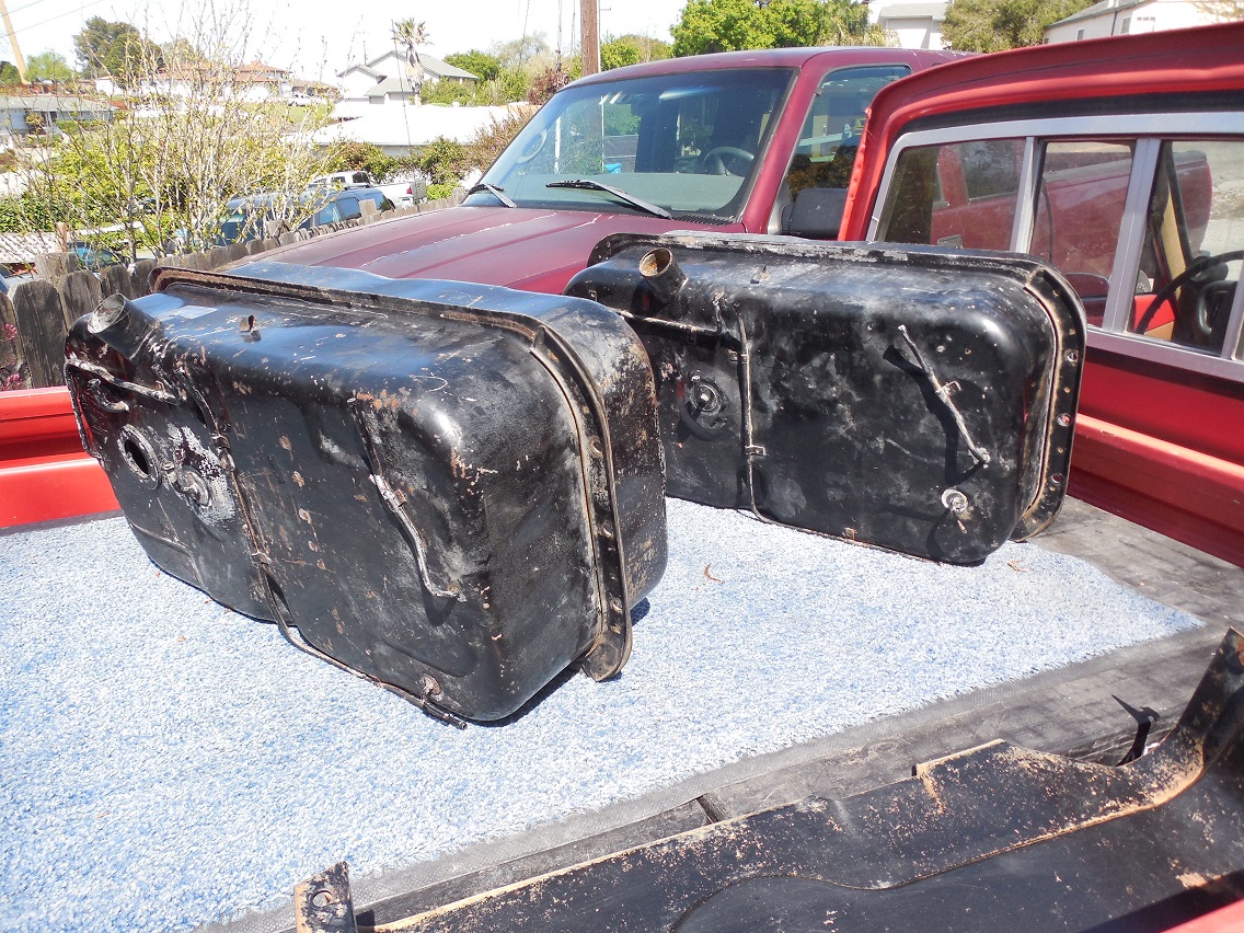

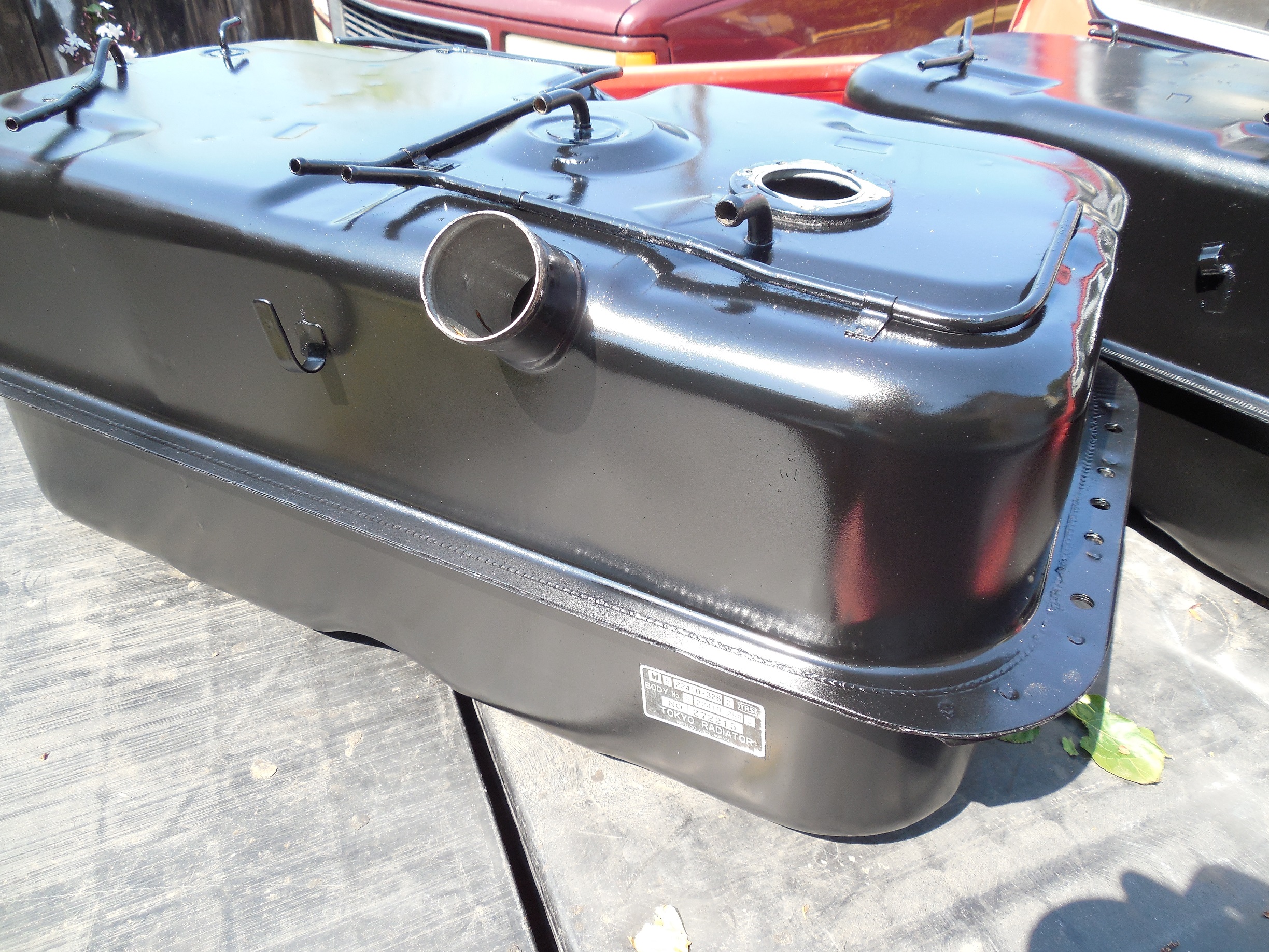

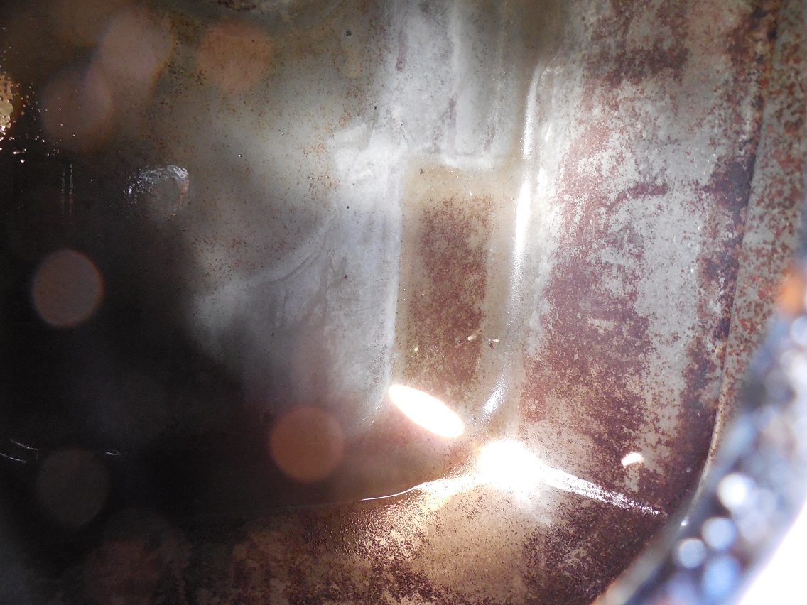

I was reworking my 66 Malibu gas tank so i pull both my luv tanks to seal up w/ Por 15
File comment: tanks pulled
File comment: before cleaning
File comment: after cleaning & preping w/ Por 15 degreaser and metal prep
PostPosted: Fri Mar 31, 2017 11:21 pm
Posts: 607

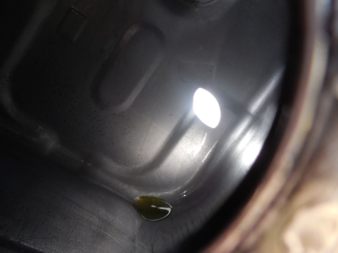

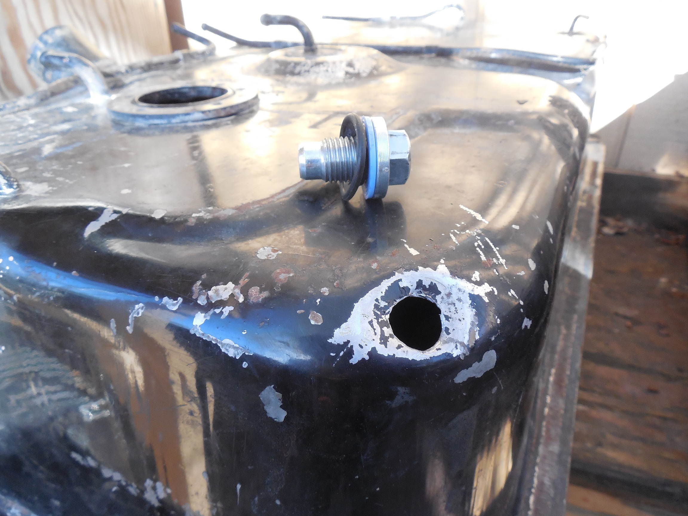

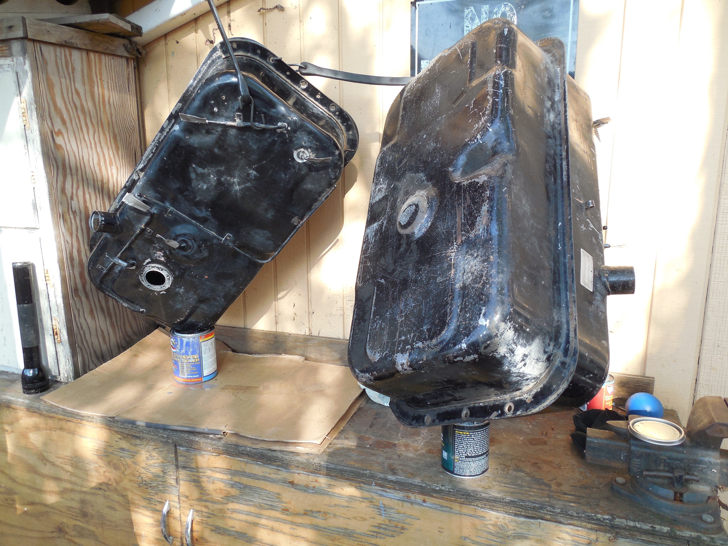

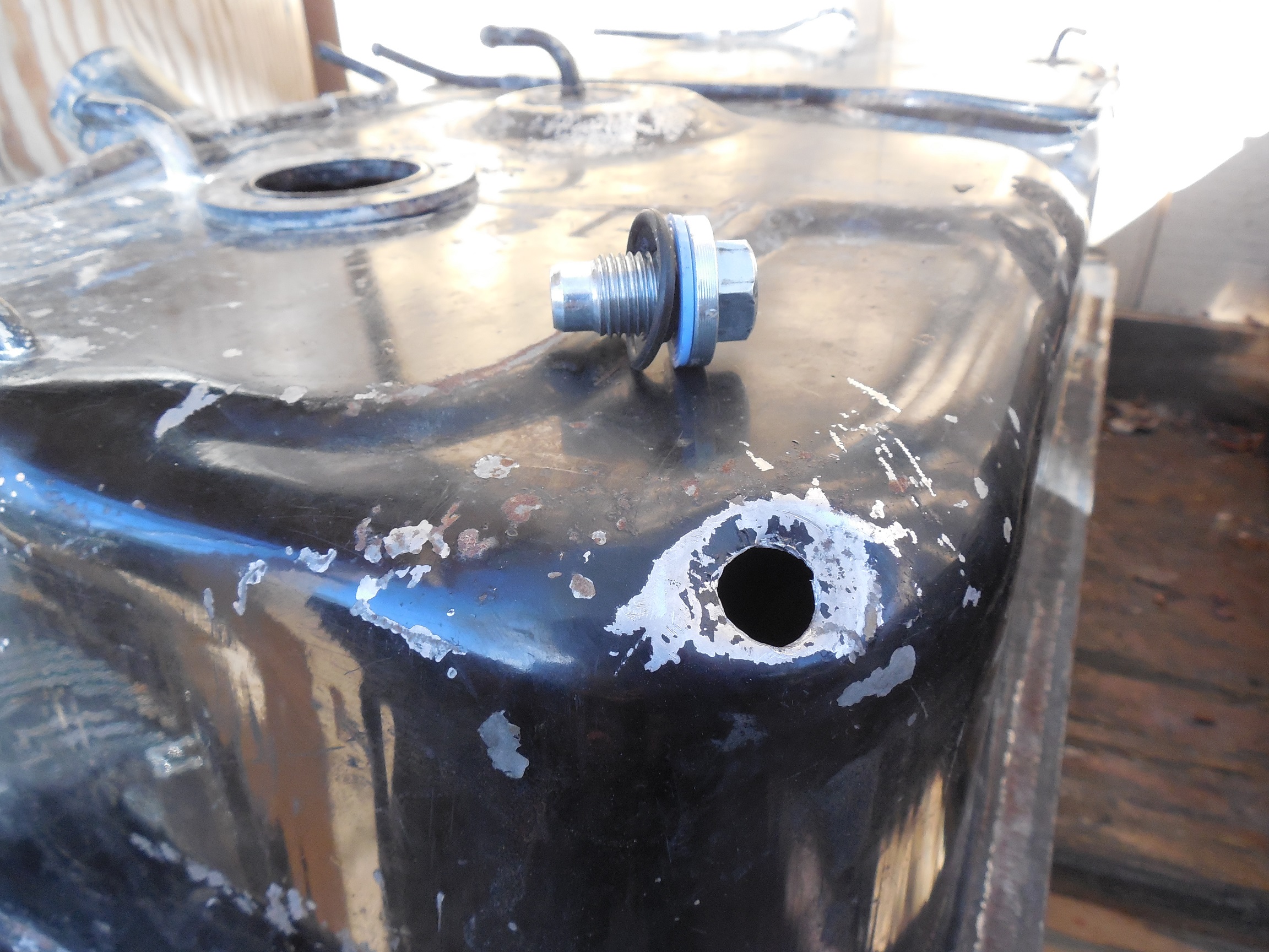

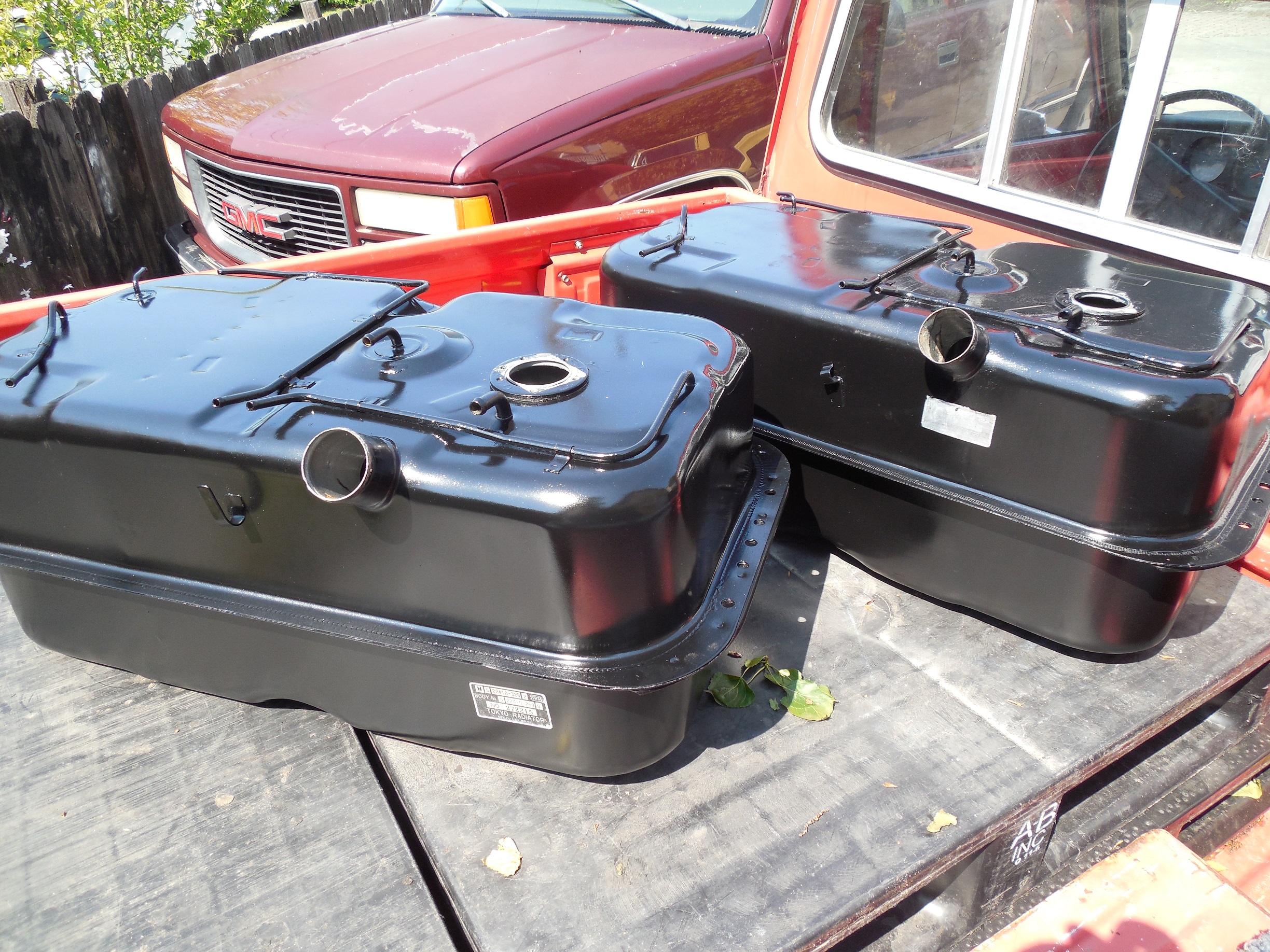

Here's what i ended up with little tuff to take pics inside but i managed a couple 3152
File comment: I decided to make it easier to drain out i added a drain plug on top corner
File comment: was able to set up and drain them for 30 min
File comment: here's how they came out all sealed up ..now 96 hrs to cure before adding gas.

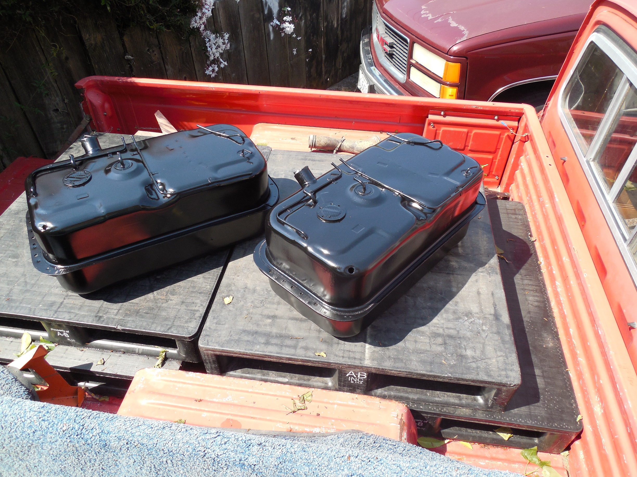

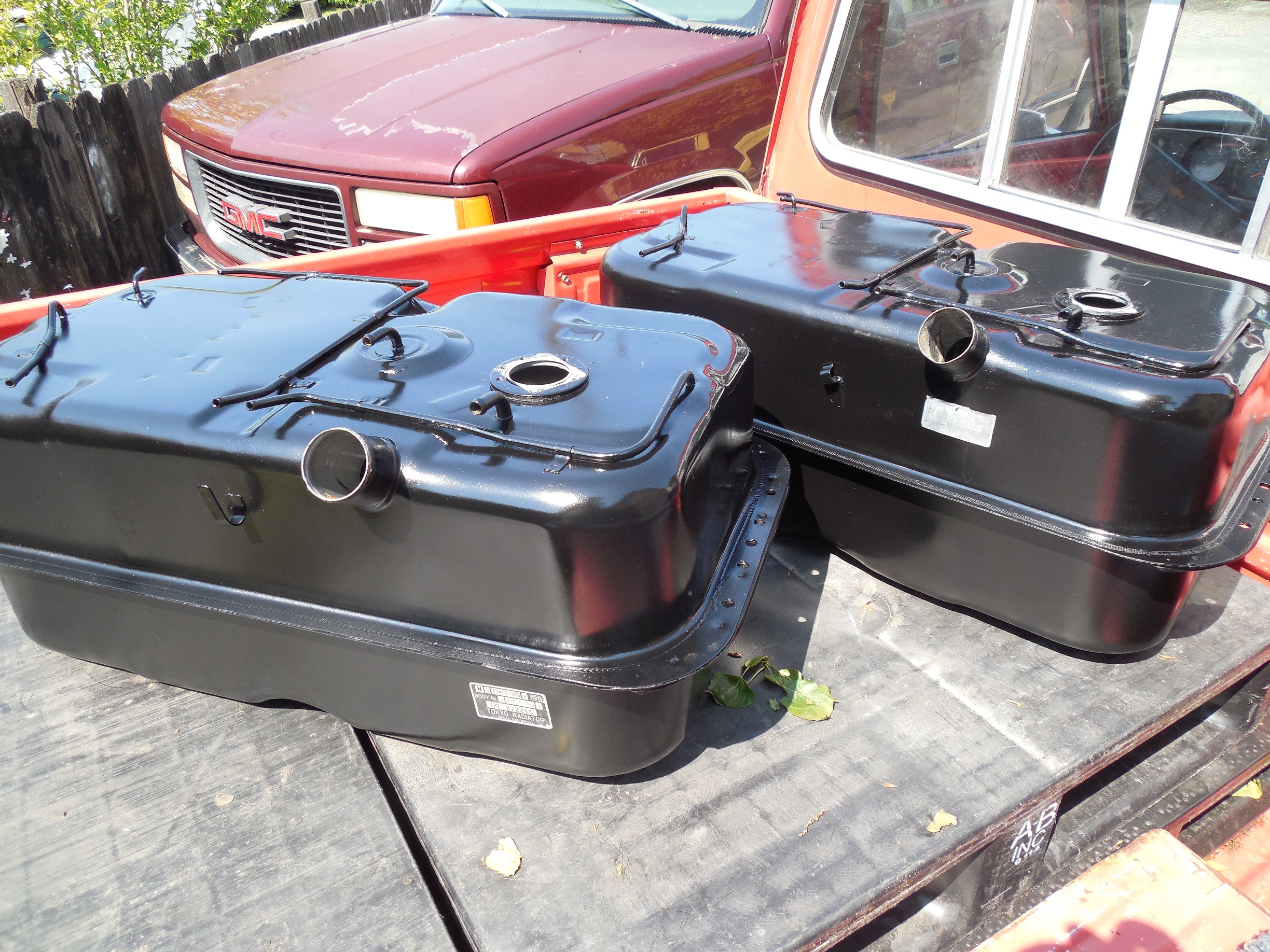

Got my 2 tanks all cleaned up L@@ing new again :D .... Ready to be installed

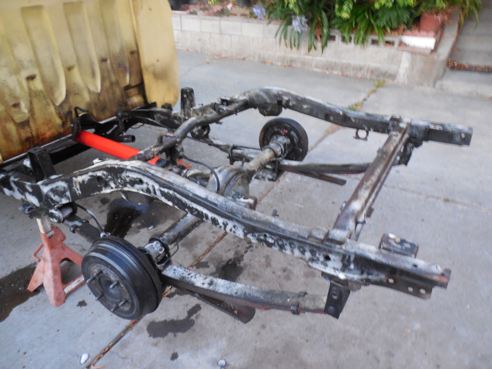

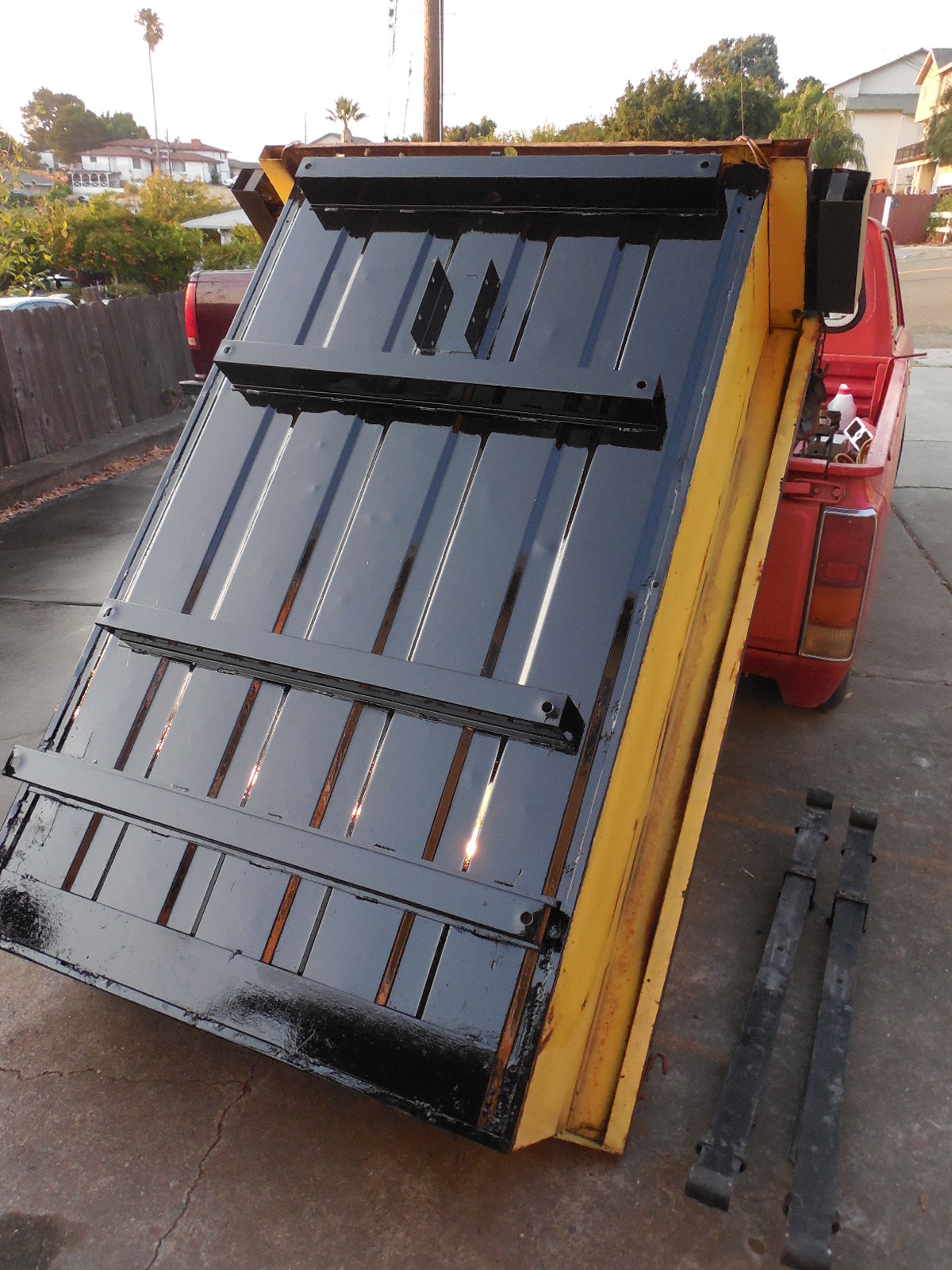

Posts: 607

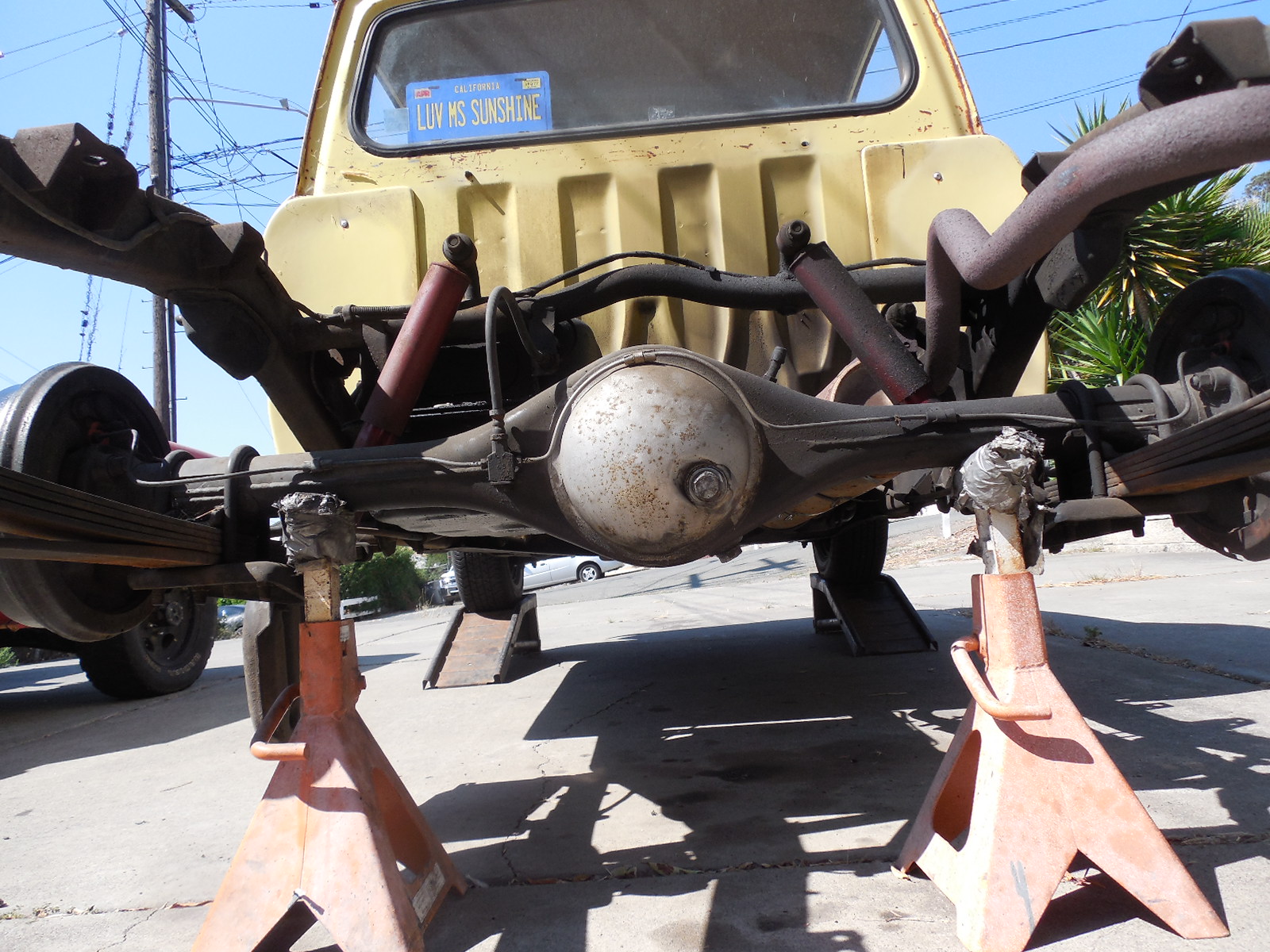

Ok its time for some LUV to the LUV

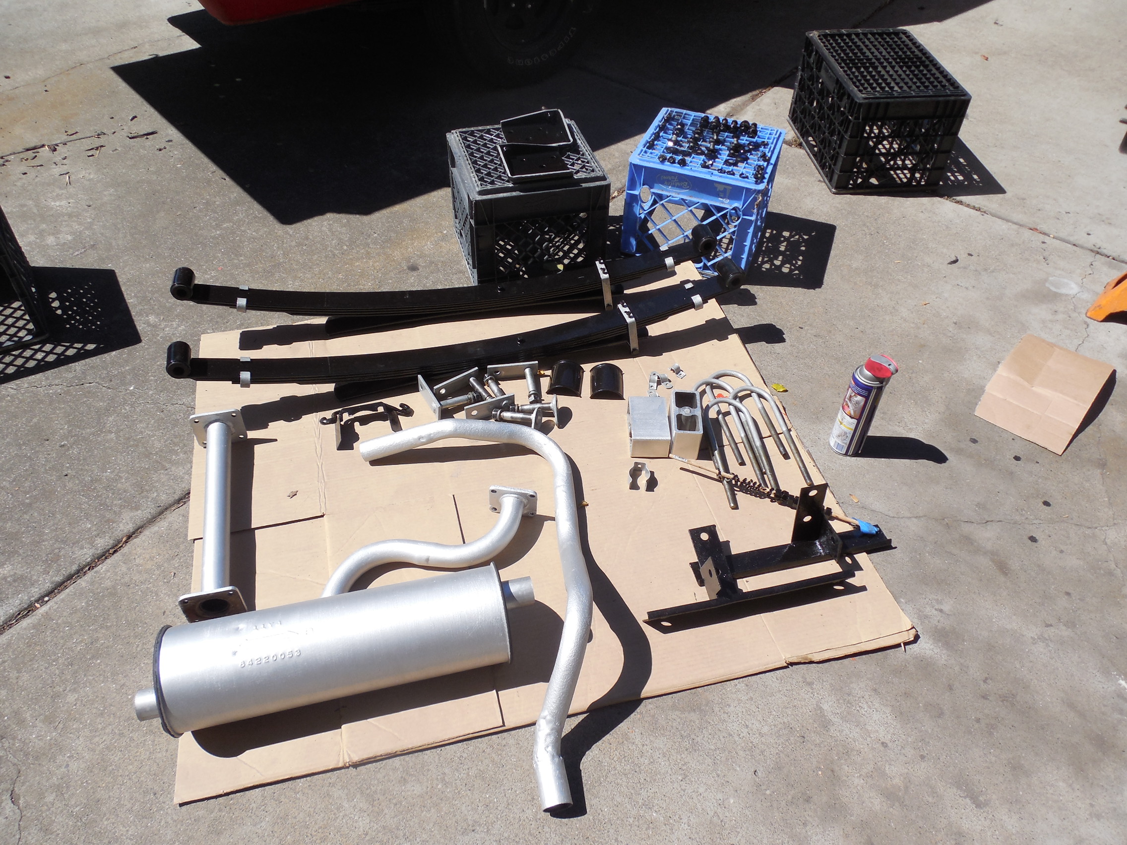

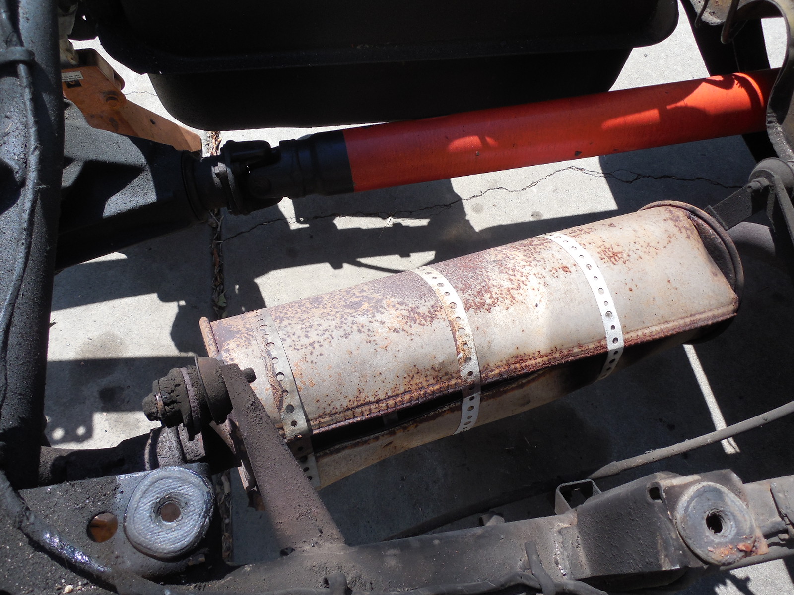

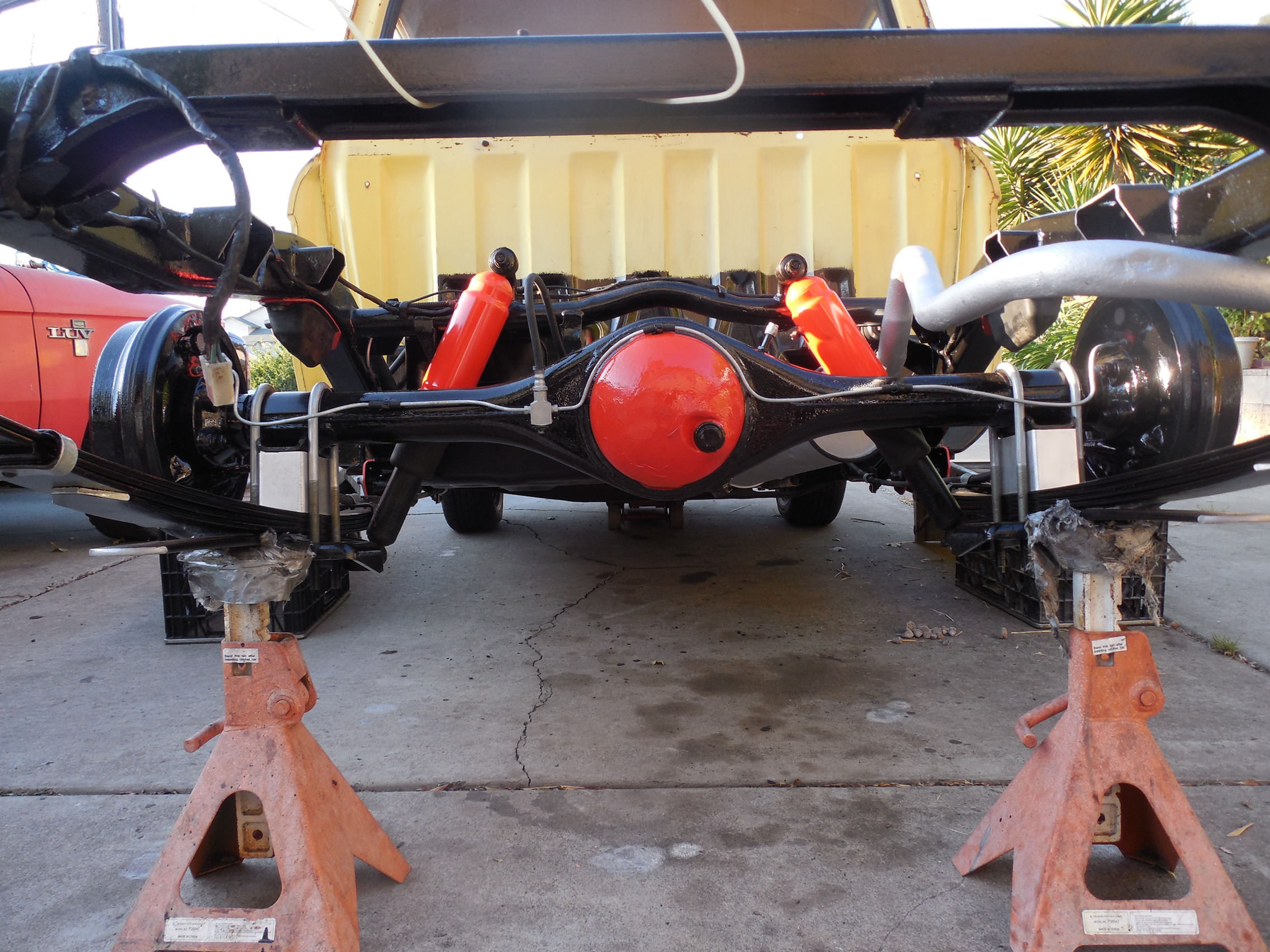

New muffler time (smog next month ) & install that sealed up gas tank & clean that rear end up & replace a few seals
File comment: bed off & time to clean all this up
swap a few things out.
File comment: rear end is looking tired, sad needs some attention & a good cleaning.

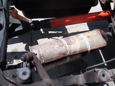

File comment: backfire split the seam last year so i sorta closed it & drove it for a while w/ the rumble.

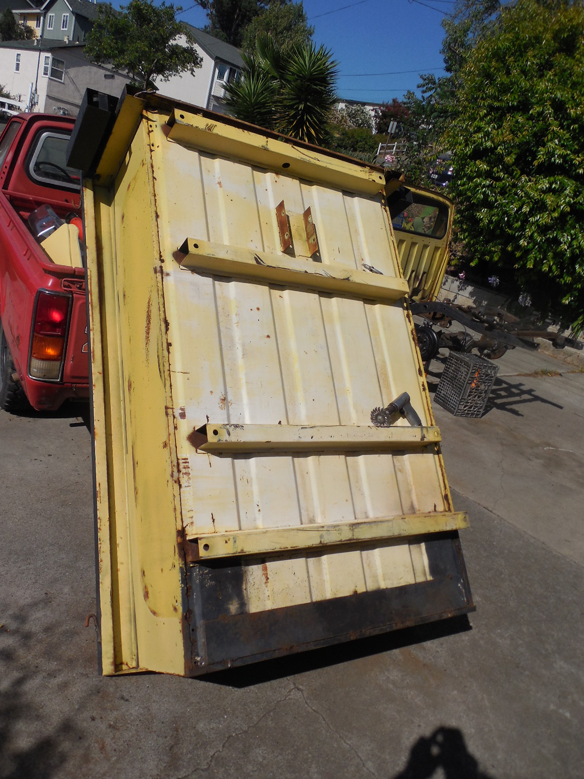

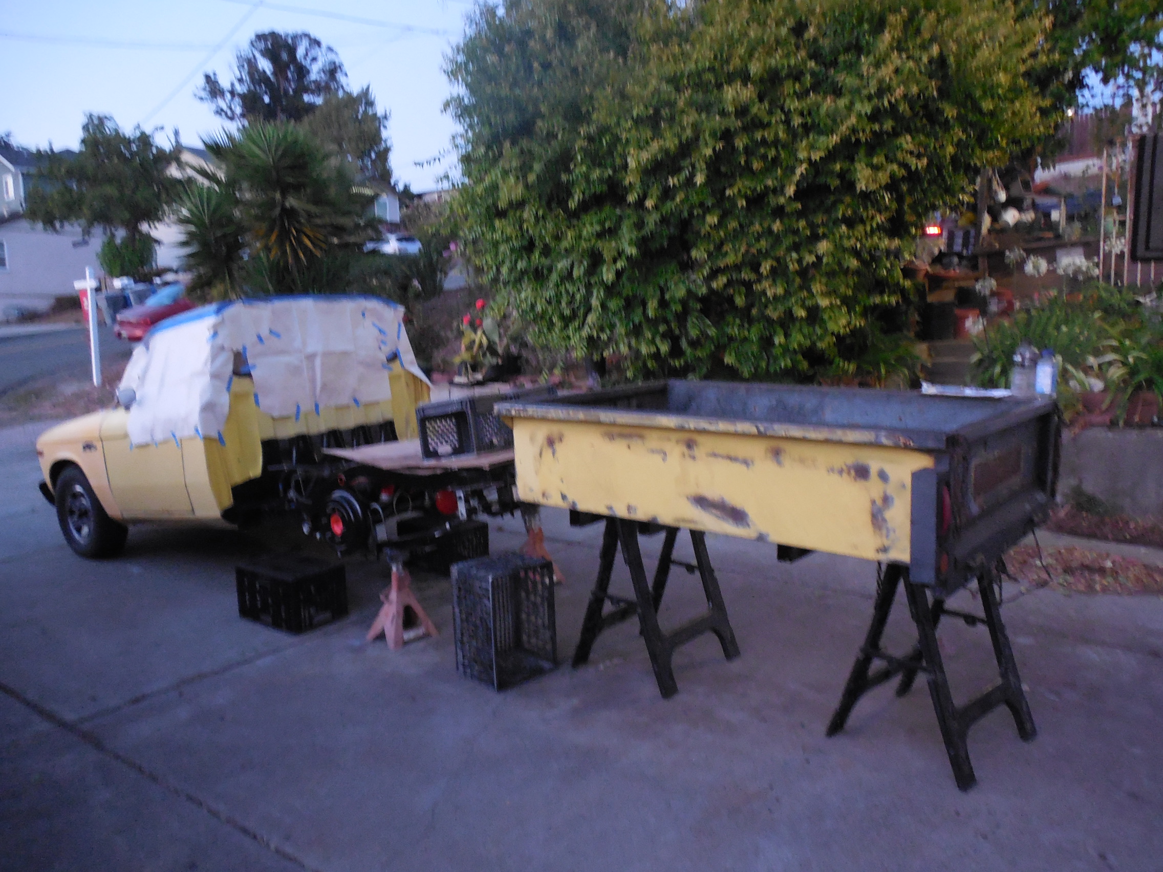

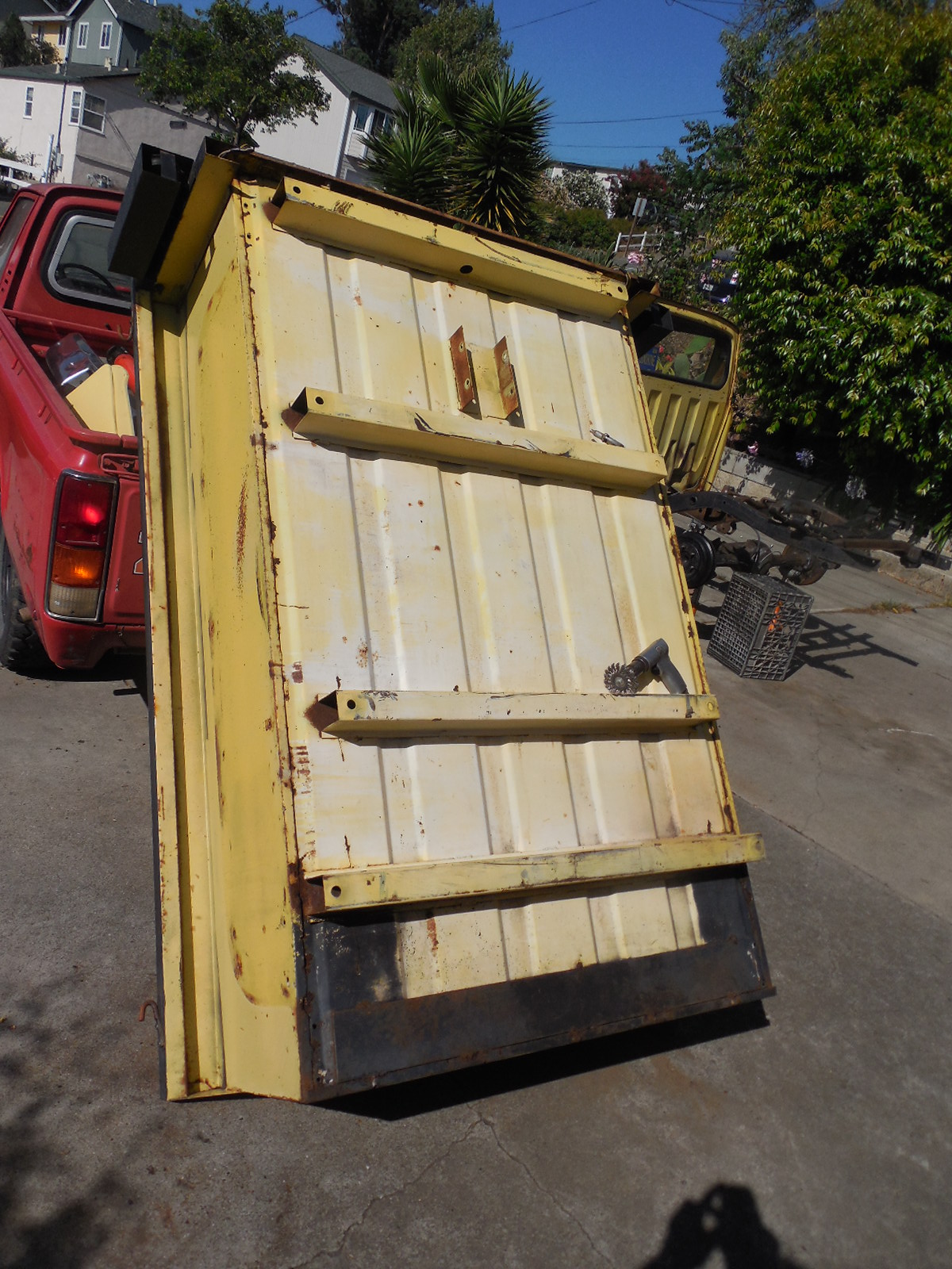

File comment: bed off & cleaning her up to paint.

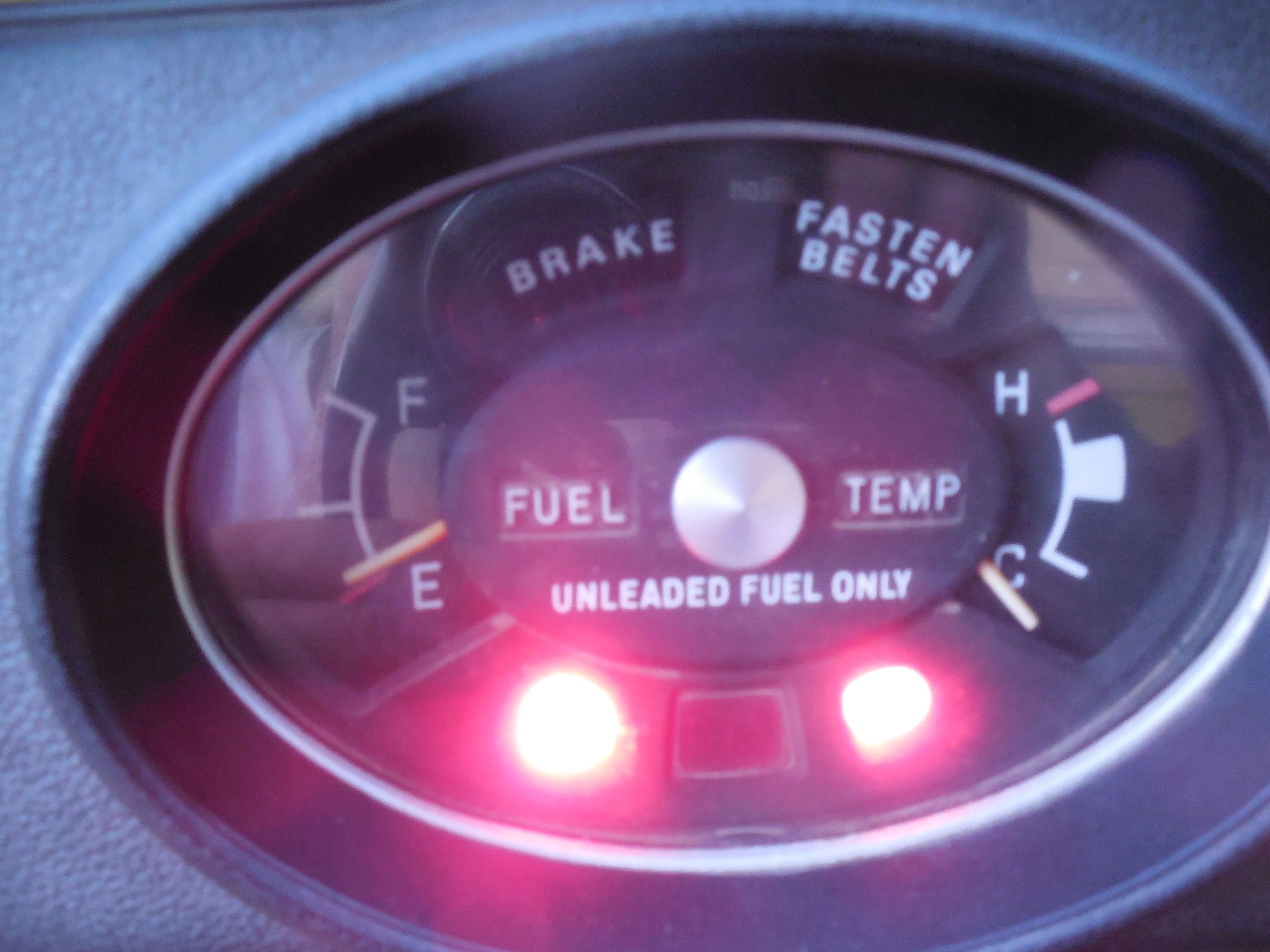

File comment: starting to get her back together & while the bed is off & tank in I can adjust the sending unit manually to where i want it As she runs out of gas before i hit empty line.

File comment: my fuel would run out before my gas gauge read empty so I adjusted my sending unit arm to here w/ 2 gallons of gas in the tank

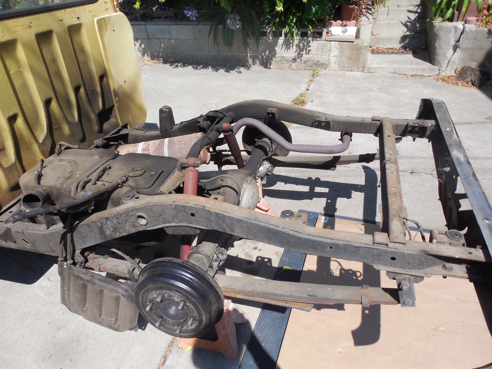

File comment: Ok last view of the underside before the bed goes back on.
