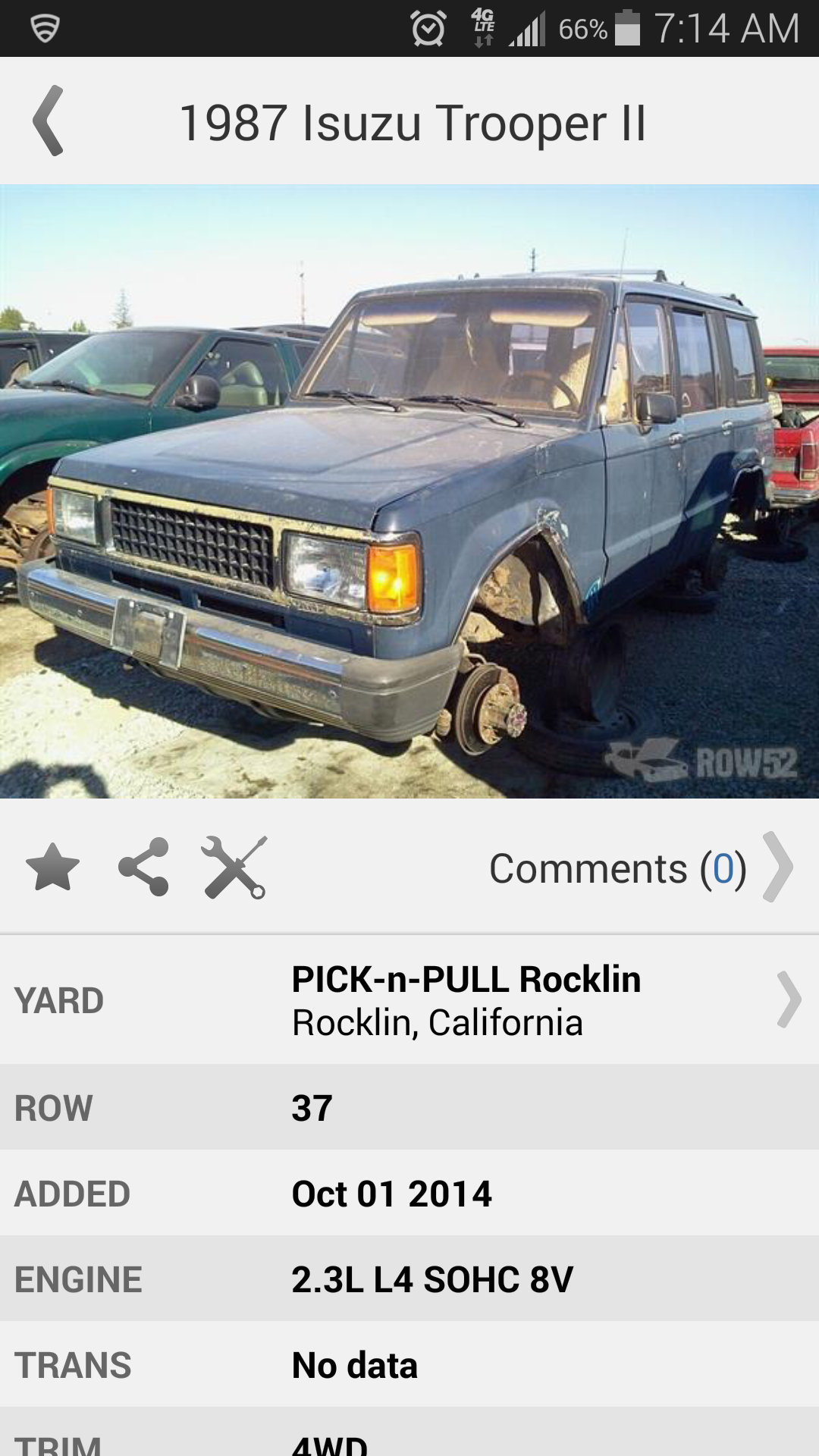

Ive been looking around for a rodeo and i cant seem to find anything under 91, how ever i did find a 87 trooper, it has a 2.3 its the same engine right?

yessir that would be an Isuzu 4zd1 2.3L

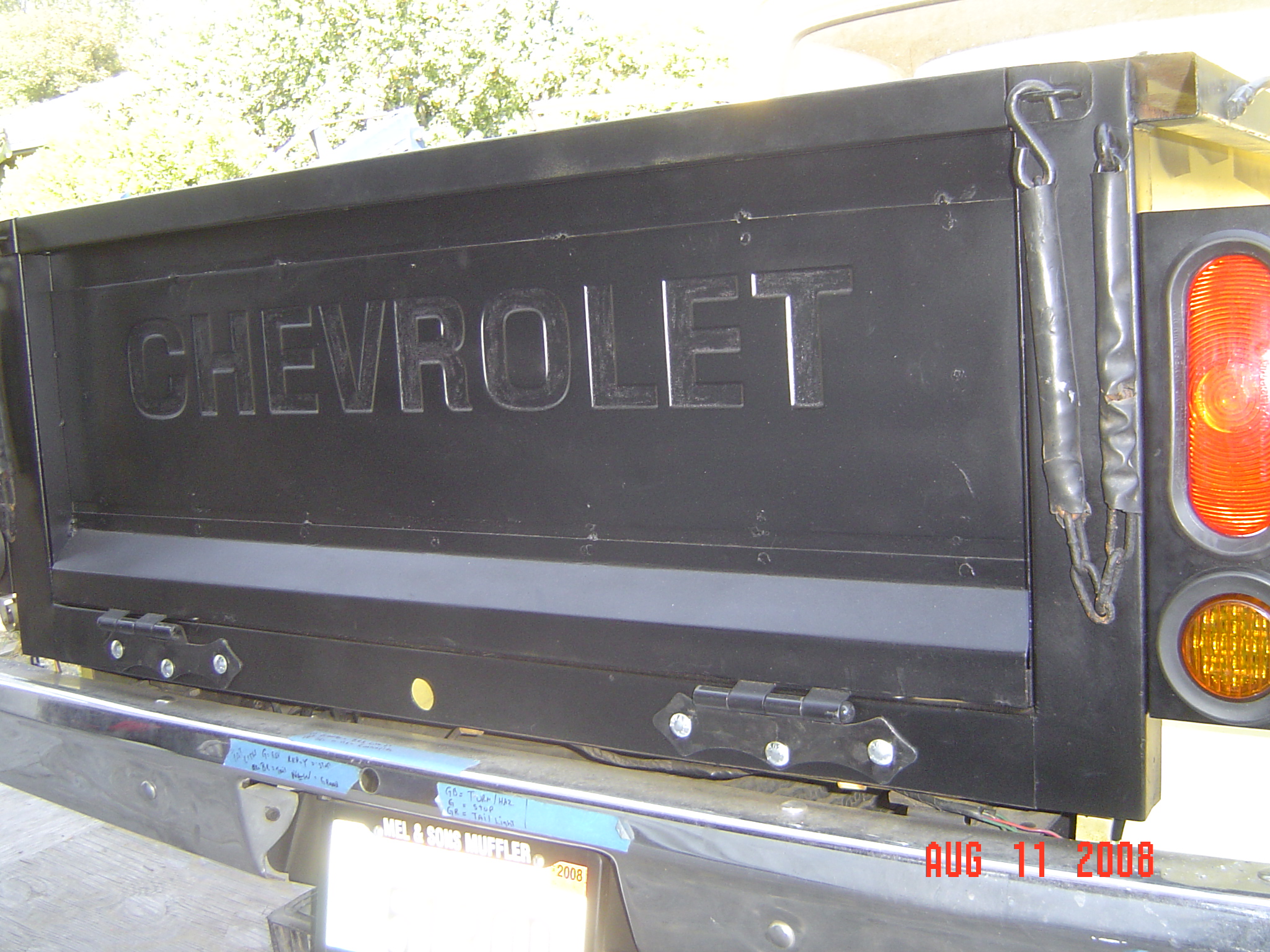

cknn18 wrote:
I just saw your metal work nice work i could cut the chevy off an old tailgate you could weld in :)
FUNNY You should say that :lol:
I had a rusted up trashed tailgate from a reg bed & cut off the logo & modified mine to look more like the reg size Chevrolet tailgates
