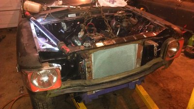

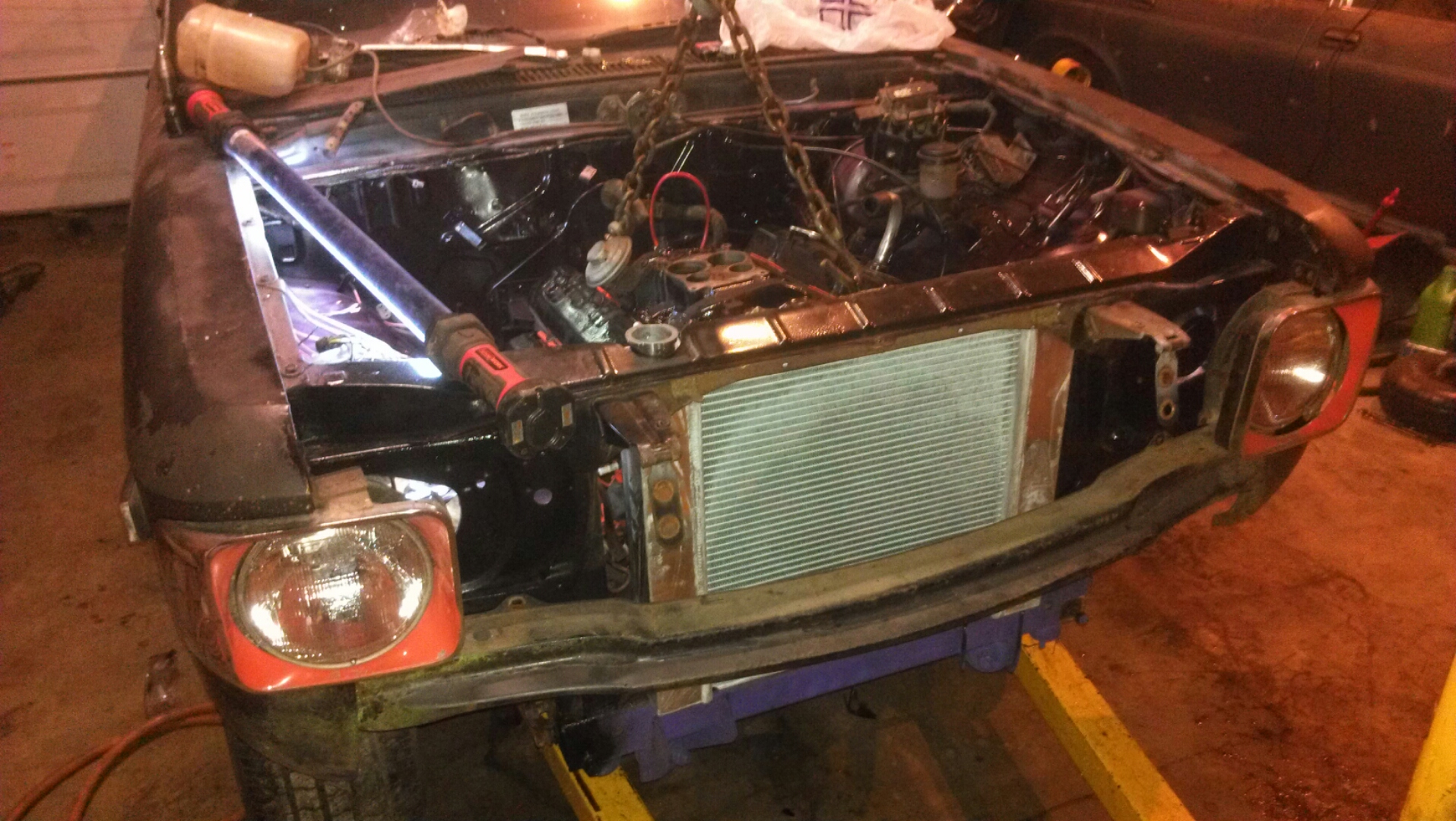

thanks! got a little work done today. put headlights, bezels and the metal thingy that goes above the bumper. and set the motor in to see what all needs to be done

Does the hood clear the filler neck/cap like that? We have the same radiator and im about to mount mine.

Thanks! And I have no idea, I guess I should check lol

Hood does clear the filler neck with cap.
