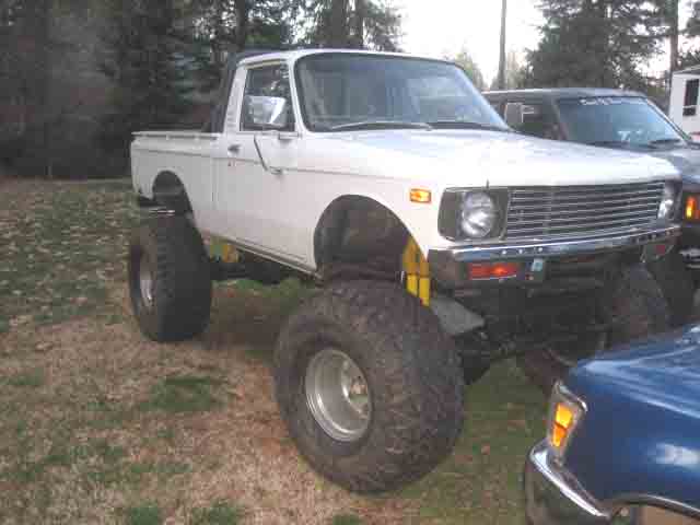

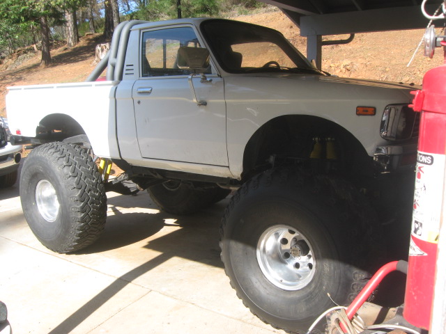

now sitting on some 39x15x15 Micky Thompson tires on 15x12 eagle alloys (snow tires),
although the 231 v-6 runs great, I couldnt pass up a deal on a tbi 350/700r4,, so next is a engine swap.!!

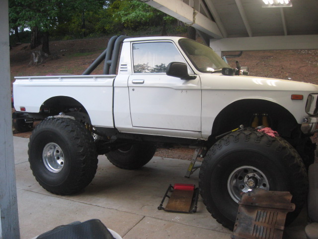

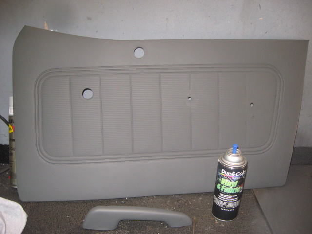

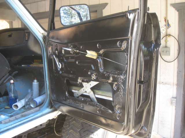

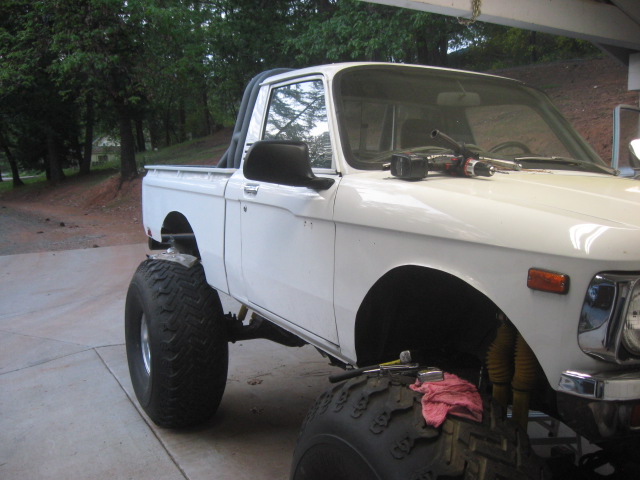

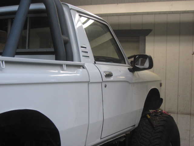

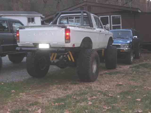

a little more progress.... 8)
got the 44" tires mounted and on
gutted the interior of the bench seat and old carpet and blue seat belts
I did a little research and took "luv2gofast" advise on using Toyota truck door door weatherstripping,, I have alot of misc Toyota 4wd parts,, so after digging around I located 2 good door seals from a 1987 Toyota 4Runner,, I'm changing the interior color from baby blue to black/gray,, so it was a good time to replace the old rubber, I got the rt. door rubber on, fits great, (I cut about 9"s off the Toyota seal and glued the cut pieces on the bottom side of the door,,the door has never shut soo good ,nice and tight!,,also used Dupli-Color vinyl/cloth spray paint for the door panels/handle,,

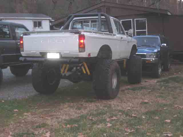

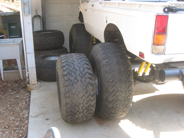

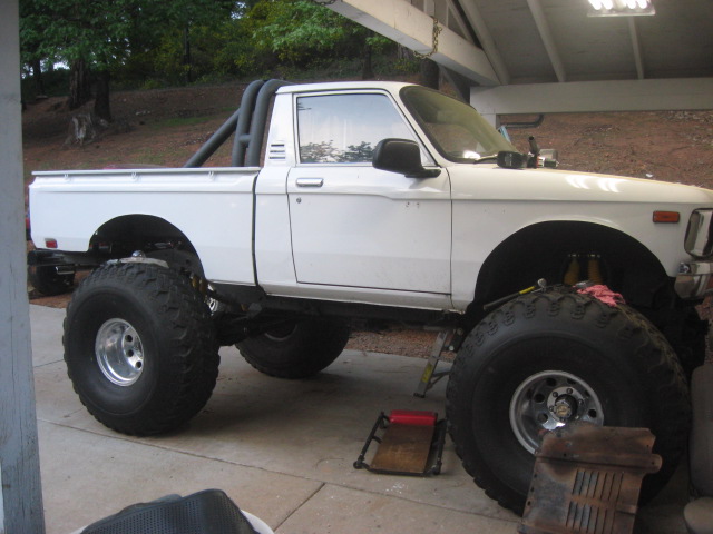

44" tires on .... 8O 8O
(1st picture shows the comparison to the 39's)

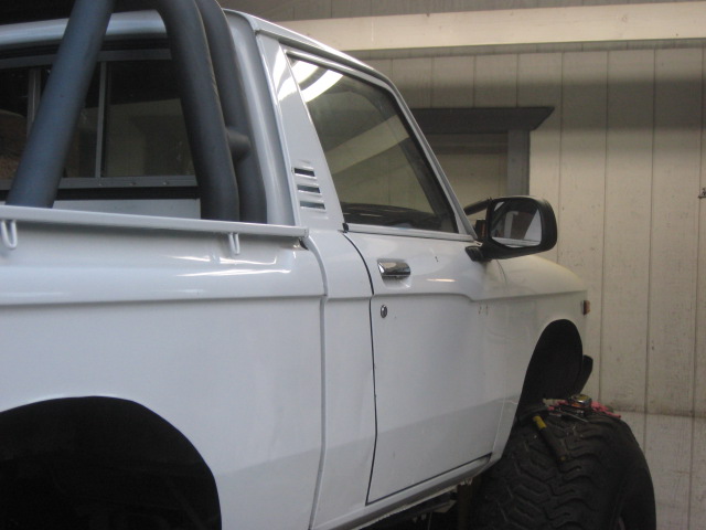

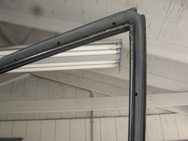

started on the bucket seat mounts, and mirrors, i went with 1993 Ford Bronco (full size) mirrors, i had used these years ago on my 1972 K5 Blazer, and liked how they looked
