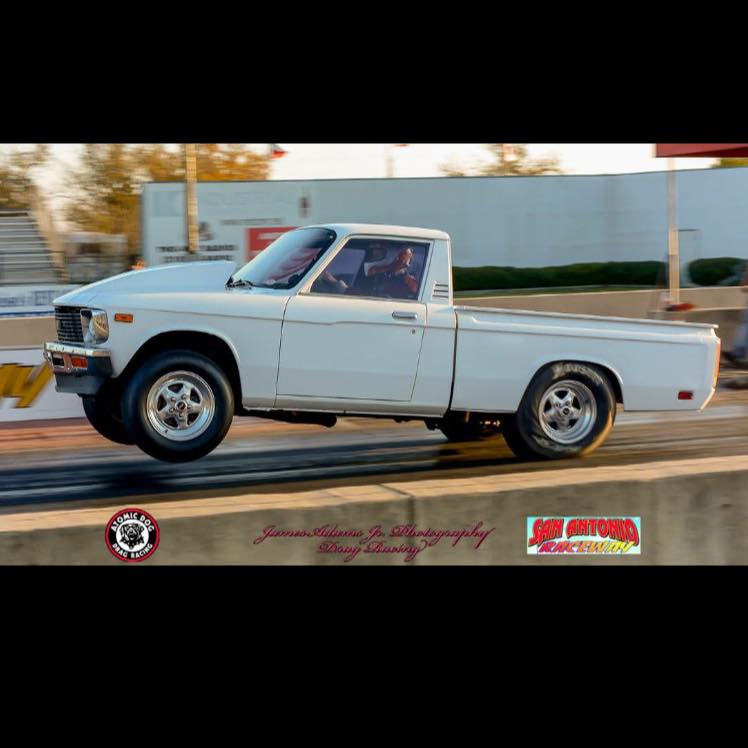

hotrod80 wrote:
I can buy these 29.5 " slicks from grudge races and true ten five guys for like $60 a pair with 20 or so passes on them . I figured i would give them a try over the 28" slicks i had been using . They seem to work good . Truck slowed down in the 60' , but picked up 3 mph and the et is the same . I also have more tire on the ground . Im sticking with them for now .
I did the same thing with the 29.5s but it seems the side wall is already getting weak in them. My 60' slowed and MPH increased also. Do they shake hard compared to the 28" MTs on your truck? I am only leaving at 3200.
