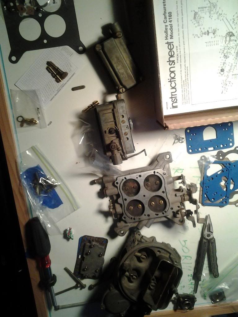

Carb rebuild set will be here tomorrow and my new lifters and pushrods will be here new years eve

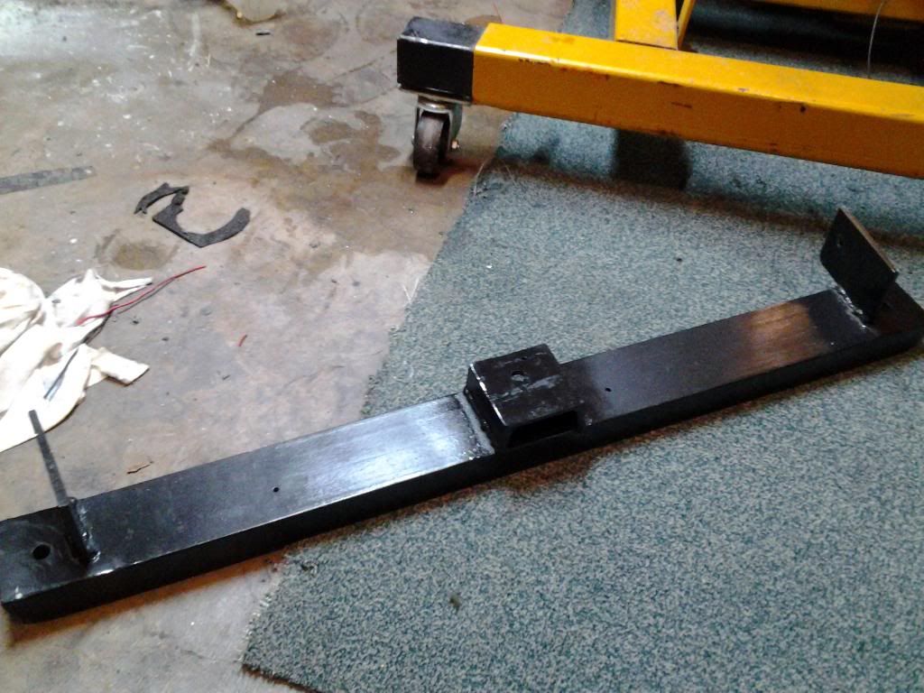

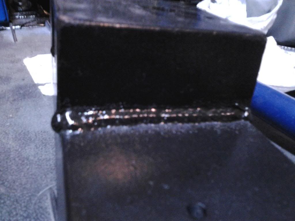

xmember is finished and installed now
mount pedestal welded on and painted with more of the jd black

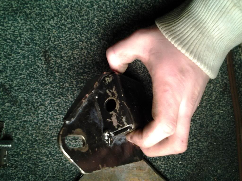

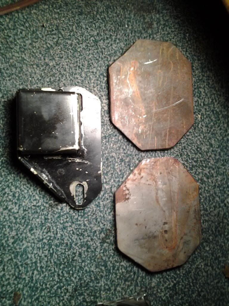

Working on my new mounts
The powerbyace mount i havent cut up yet

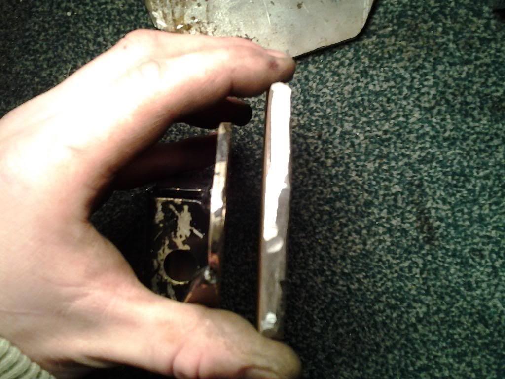

Not exact but about where it will sit now. I cut the block off the pba mounts
Also went with thicker plate. The thin plate kinda worried me

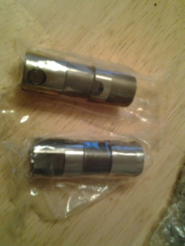

Got my new lifters
Just need to finish cleaning the carb up and it will be back together.
Should have the intake on, distributor in carb on etc today now that i have my new lifters. Still need to check my clearance with my headers. We did a quick mockup and it looks like it will either clear or only be a couple mm off

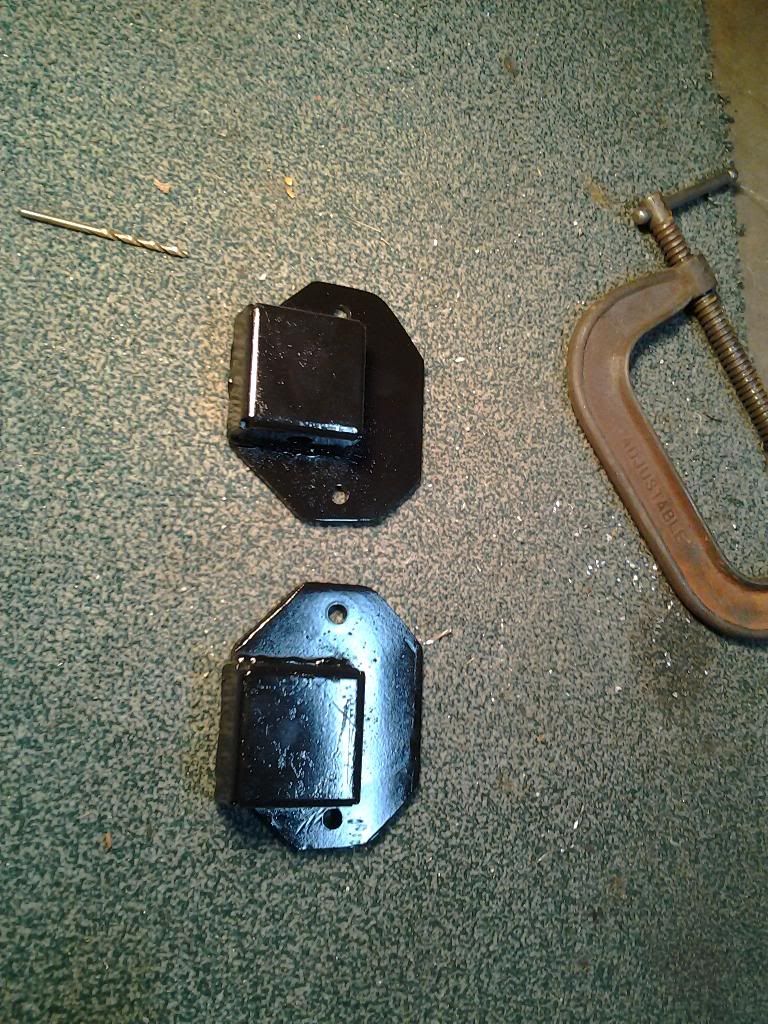

Got the trans xmember bolted up had to redrill one hole that came out crooked
Finished my new motor mounts welded and painted

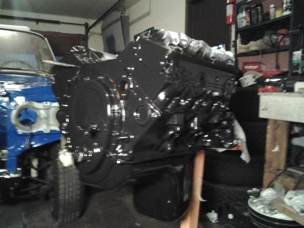

When that was done went ahead and pulled the engine and tranny to see how that process was gonna work out. It didnt fight very hard. Got it out and painted, two coats down in the pic

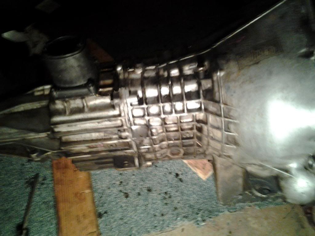

Started cleaning up the tranny, it was covered in grime and is taking a while even with some maf cleaner and degreaser. Im having a buddy bring his pressure washer over to get into the waffling better. Its not necessary for aluminum but im thinking about giving the tranny a couple coats of the hi-temp black as well. It needs a new gasket around the shifter tower looks like a lot of the crap on the case is coming from around it.
Also got the carb reassembled with the new gaskets and internals. Finished with my intake manifold and cleand up the cai tubes and plenum some more. Not sure if i want to leave them bare aluminum, or paint them with the matching blue or the hitemp black. Any opinions?

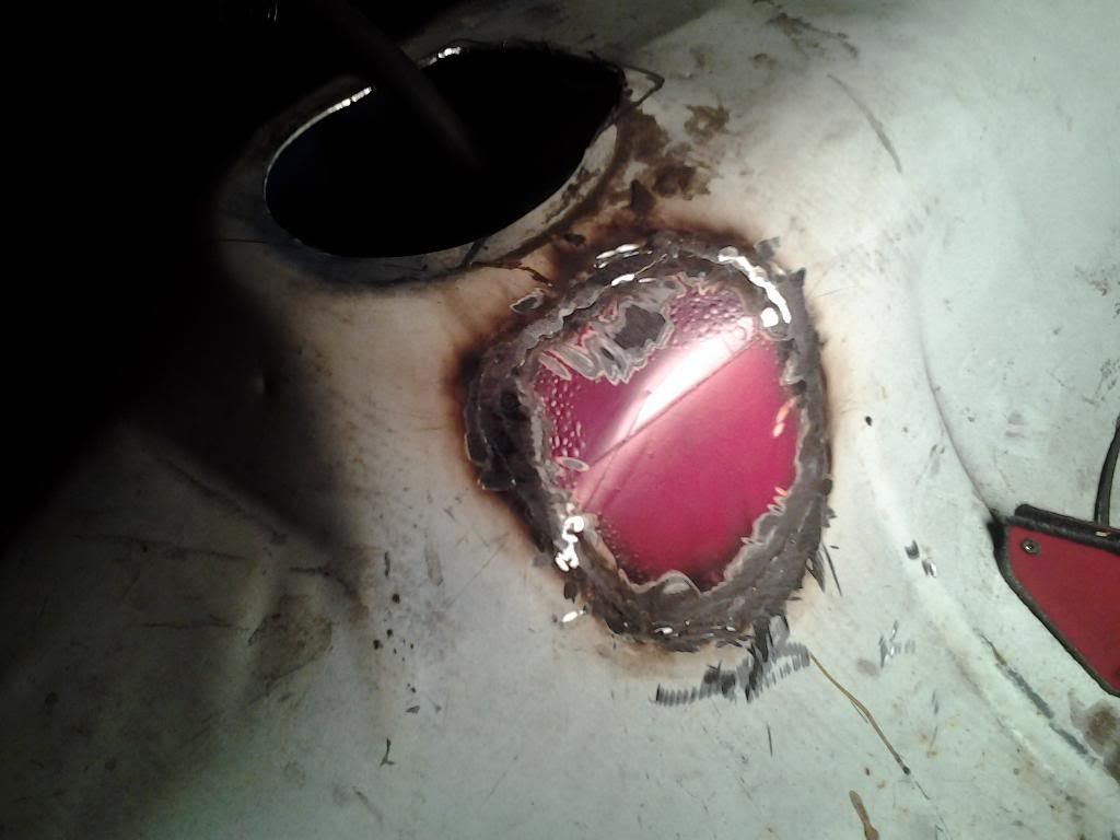

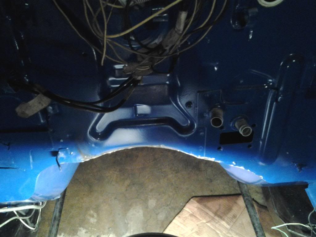

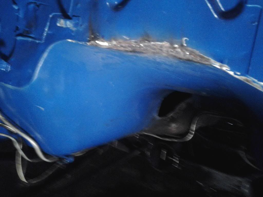

Got around to moving my firewall a bit. With the thicker mount plates i didnt have enough clearance for the bellhousing up top where the floorpan meets the firewall at the bottom. Made a cut at the center of the firewall 3/4" back and tapered it back 3" on each side until it was flush again. A crescent shaped cut. And carefully whacked the firewal back until it met the curve and welded it up. Will get a pic later but yo cant tell it was modified unless you were looking for it. Thanks to my dad on that. I lack the finesse to make it look a good as it does i just did the welding.

Basically cut a relief behind the lip of the firewall and rolled it back to get more height and depth clearance out of it, it looks better than i can make a camera phone pic look but you get the idea
Will look better painted just picked up another can of the blue for this and touchups, gained a ptetty good amount of clearance from it.
Also got my tranny pressure washed up real well after a long soak ans multiple coats of degreaser. Will be giving that the hitemp black just cuz i feel like making it match its surroundings. No good reaaon just want to

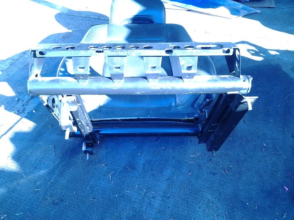

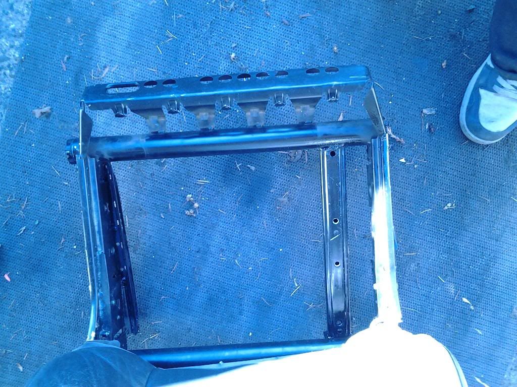

Got my seats new rails made and got the seats installed
They look wildly offset but the seats sit just right like this. They dont slide anymore but they are so big there would be no point anyway

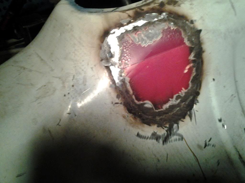

Made a patch for the 4wd shifter hole out of a piece of old tailgate skin
