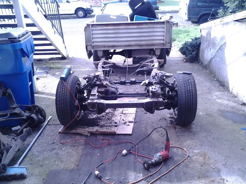

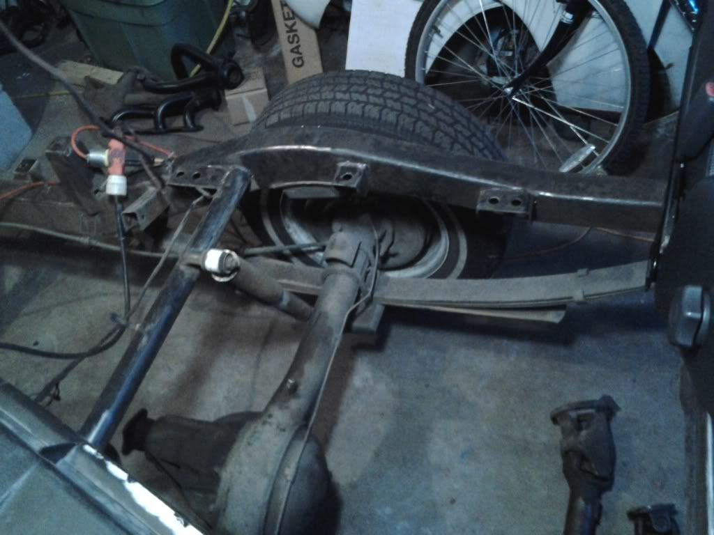

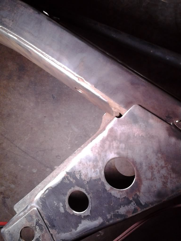

got my engine pulled, transfer case and transmission pulled, had to compress the front shocks to roll the chassis out from underneath the cab and into the driveway. spent a good bit of time with a putty knife screw driver and a big wire brush cleaning out the grease and grime from the control arms ball joints etc etc. got a TON of gunk out of there

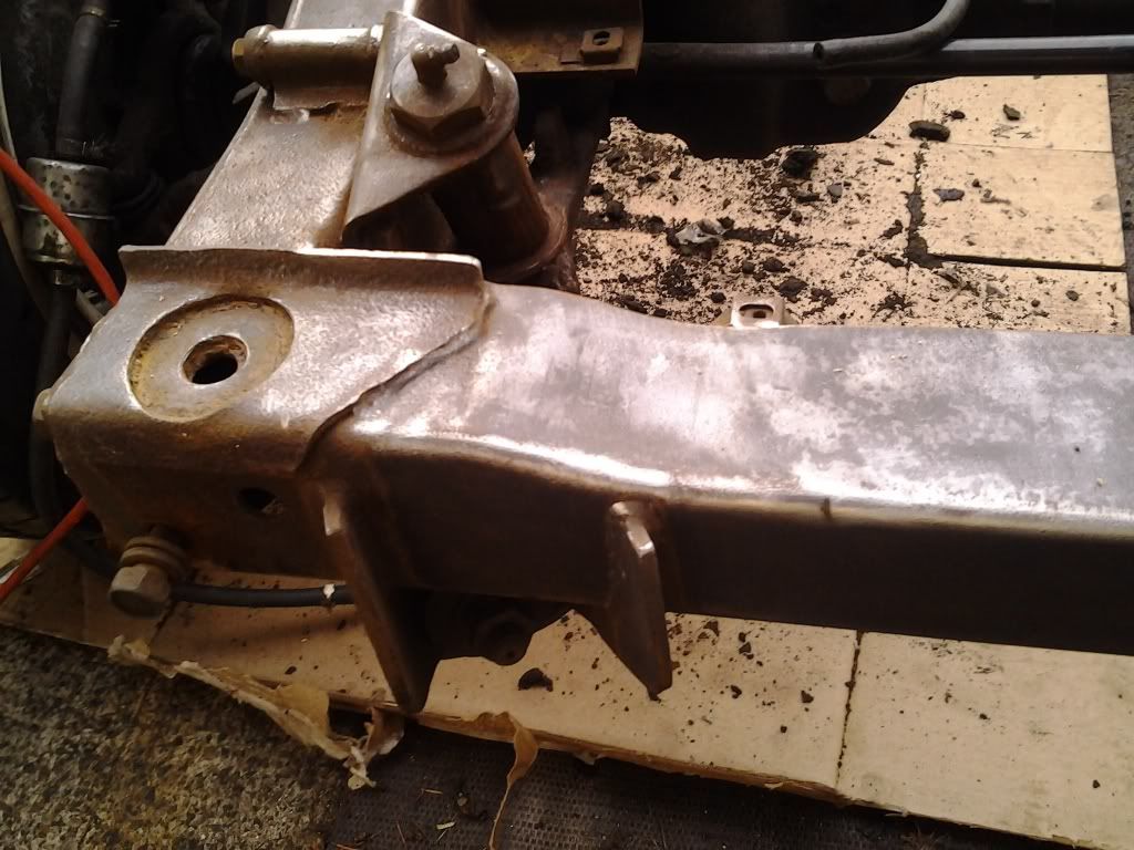

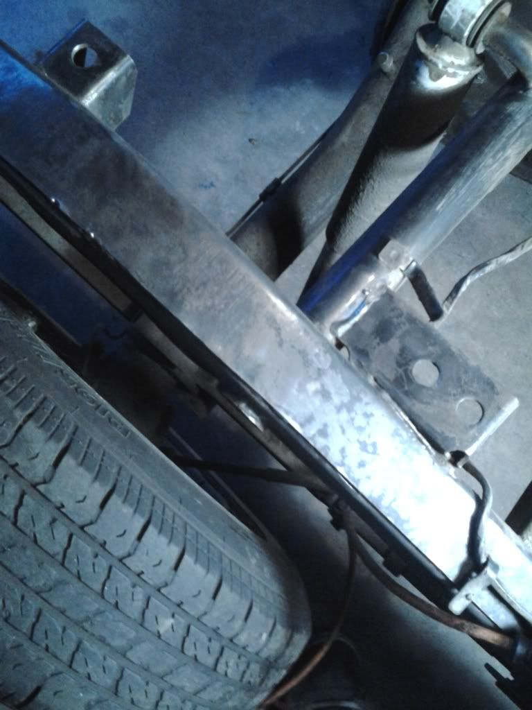

spent a couple hours with a really aggressive wire brush wheel on my grinder stripping the frame, got everything from the bed forward stripped of all rust, and almost all the paint, didn't need to take it ALL to bare metal but I took the top layer off all around and most of the paint.

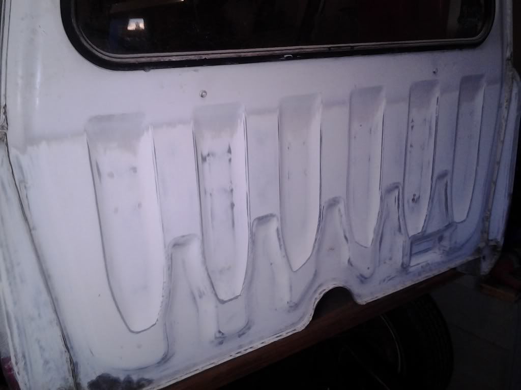

then hand sanded the back of the cab and the front of the bed,
I have to break out the lacquer thinner and a rag and I can primer and paint the frame, the back of the cab and front of the bed. gotta pull the bed off and get the back half of the frame ready to paint. I have another day off tomorrow and will have some time to tear into the back half and spray the primer. also going to check picknpull's inventory and see if I can find a 2wd 5 speed to pull for this. tested out my welder on a couple pieces of scrap metal to dial in my feed rate/amperage and gas flow. happy with it so far so I wont be long with the rest of the work :ebiggrin would kill to be done by new years and drive myself to the hangover scramble 8)

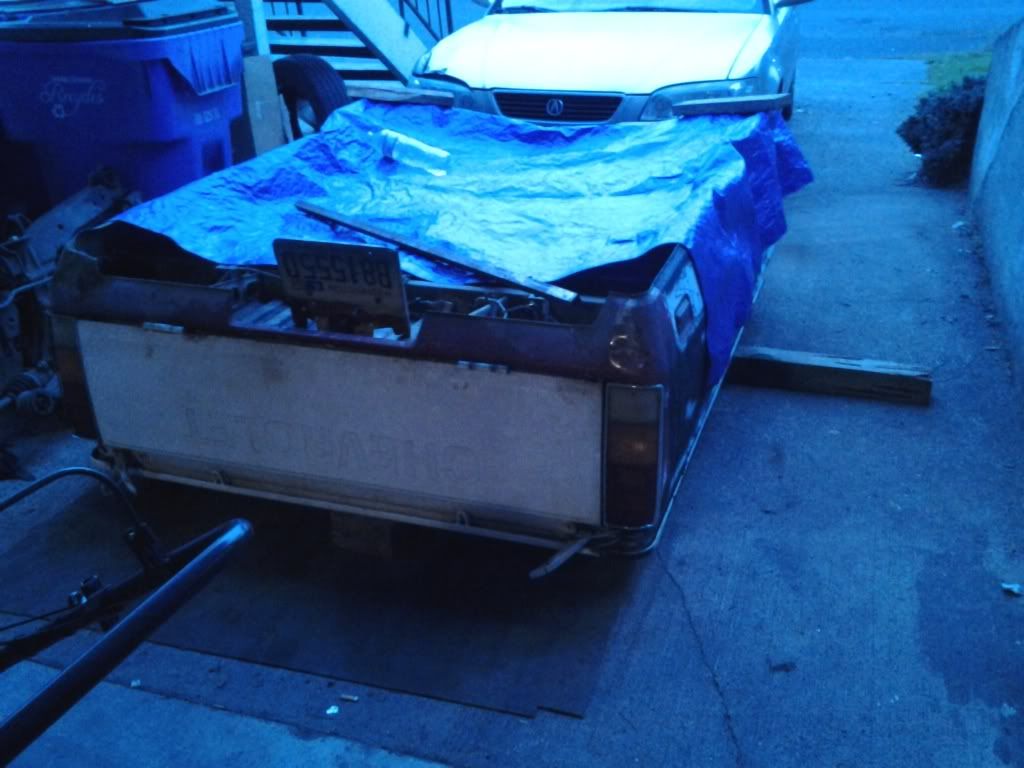

PostPosted: Mon Nov 11, 2013 7:08 pm
spent another few hours out there today, not a whole lot to report on, didn't take pics until I had rolled the chassis back inside for the night
pulled the bed and stripped the majority of the frame, some small areas still need going over but its 90% ready for paint
bed still needs an afternoon of work put into it but that's next on the list.

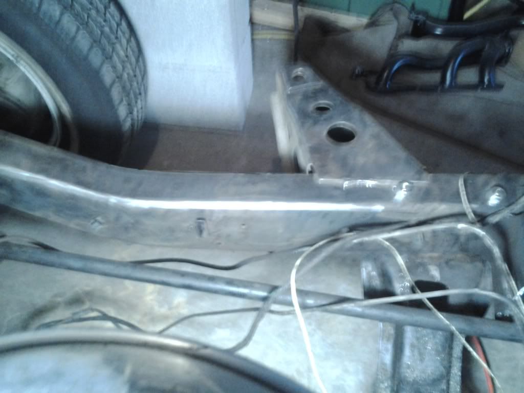

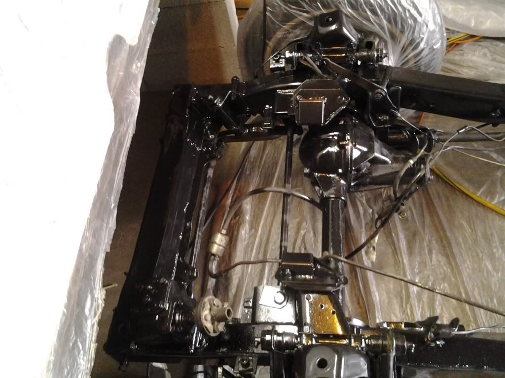

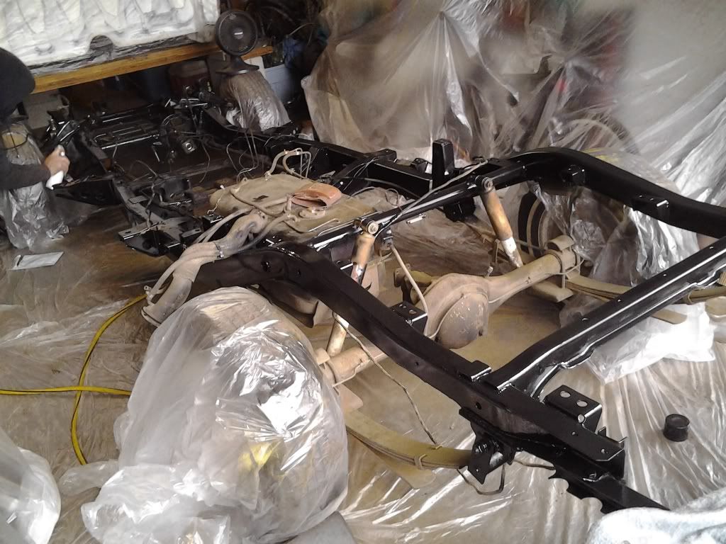

dad and I got my chassis painted today front to back top and bottom :lol:
this right here is some GOOD paint covered in the first pass and one can lasts forever. did the frame 3-5 times over depending on where with 3 cans

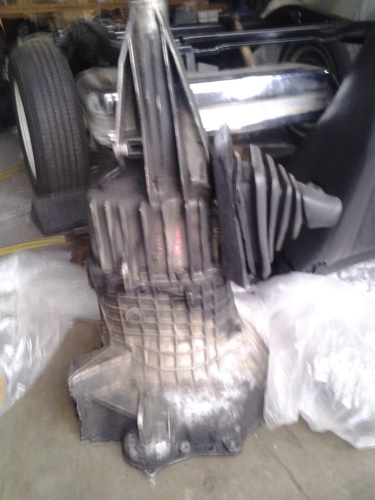

had a pretty good morning at picknpull, went to Vancouver and had no luck, made it down to north Portland and struck out finding a T5... so I got myself a NV3500 out of a 95 S10, I don't know of any of you guys have tried pulling the trans out of a mid 90s s10 there is that ONE bell housing bolt you just cannot get to :evil: got to it by dropping the crossmember finally after a half hour of trying to bend the floorboard out of my way
not pictured but I go the flywheel, shifter, shifter boot, slave cyl, xmember mount and the line for the slave cyl, ran out of time before I could pull the master cyl, will just order one from rockauto
sadly there is a bit of damage...
but I have a 1yr +30 day warranty on it to if I run into problems I can go get a new one. Thankfully the crack that extended out from it was welded up and didnt come near the gearbox end of the housing wont have any leakage issues. Still wanting to at least epoxy a plate over the hole or have someone weld it up

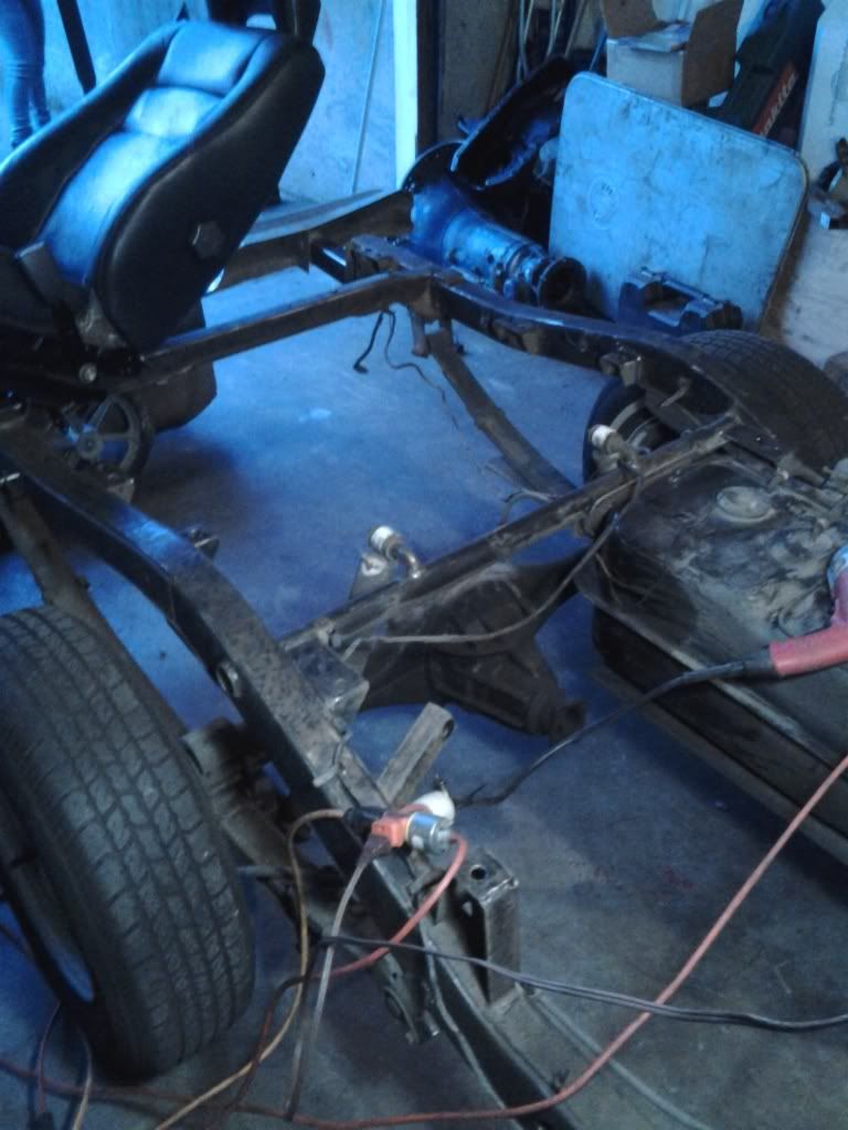

Yessir its a bit shorter and has a bit less steep first gear. I already chopped my stock xmember out so im going to have to do a little fabrication. Will be test fitting and measuring on my day off tomorrow and see where im at . I have pacesetter shorty headers that are reallllly close to clearing the steering shaft . I think it will actually clear if i can pull the steering shaft and put it back thru the middle tube that goes out and down. Will get a pic of that when the cabs back on
A few more little tweaks and such and the truck will be ready to be assembled
