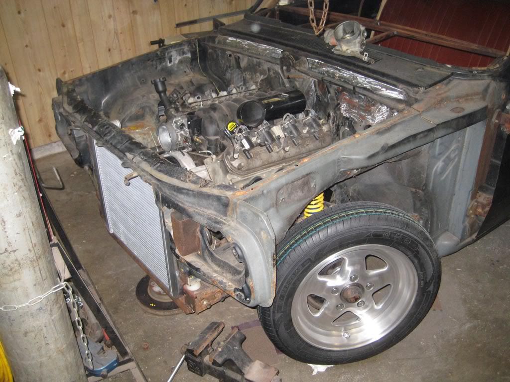

Those cheapo wheels are knock offs of weld prostars. Look good though.
 Post subject: Re: LUV II
PostPosted: Thu Jun 25, 2009 9:47 pm
LSX LUV Owner
Posts: 1261
Location: Dickinson, Texas
correct.. i dont like them on the truck at all. i cant wait to buy the weld racing magnum's.. then these wheels will be my full set of spares!
Those will look nice on your luv. Can't wait to see them on there.

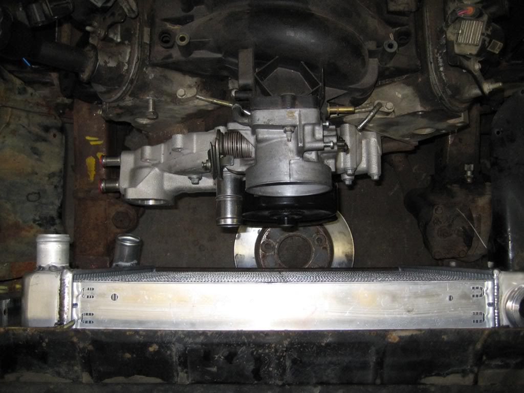

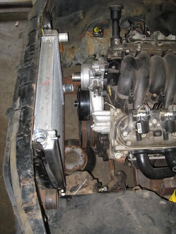

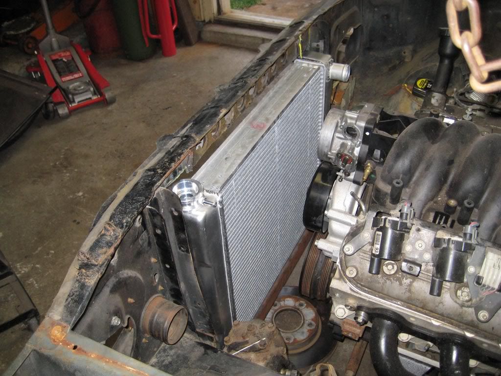

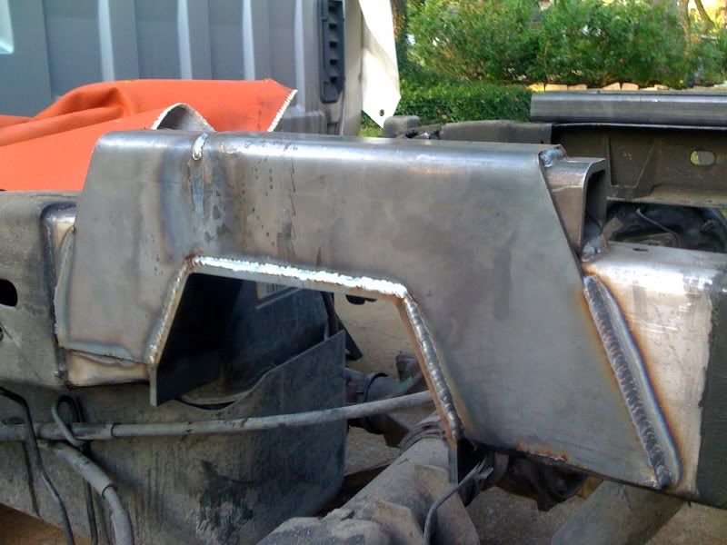

got the radiator.. cut out some of my core support for it..thats where i would like it to sit.. but will have to be quite a bit further away from engine so i can fit my hoses, air intake, and fans...
next i need to find the tightest 90 degree bend.. im guessing 3.5-4" pipe.. then figure out my hoses if my damn water neck ever shows up..

What is the size and brand of the radiator ? Looks like a good fit .

19x24

Thanks for the info . They also make one for a standard SBC at the same price . My Griffen had epoxy where the core met the tanks . Welded could be repaired or modified if needed .

Yeah it looks like a nice radiator especially for the price. Once I got tuis cobra head elbow for my air intake and fans, I'll get the radiator mounted.

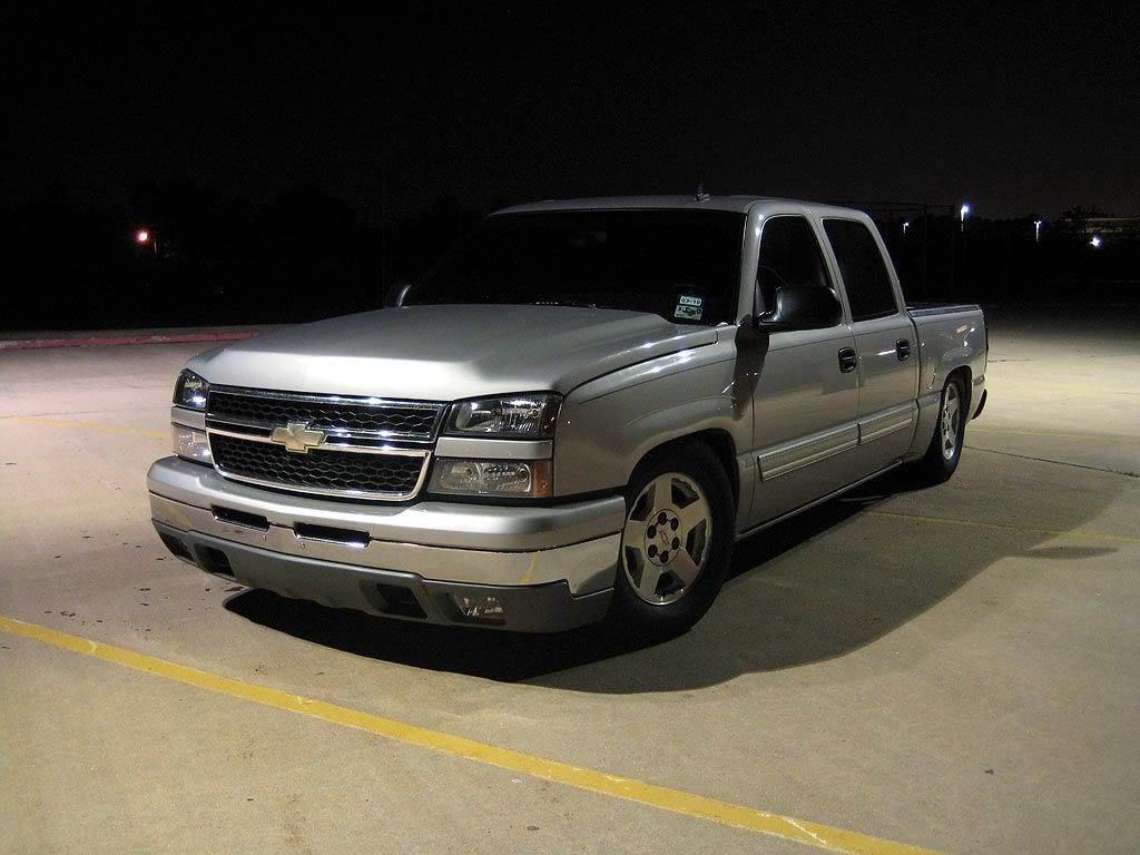

figure id throw an update in here.. non luv related..
i dropped my daily driver.. pieced together a drop kit for cheap.. found deals on everything. rides like stock. 5/8 drop.
