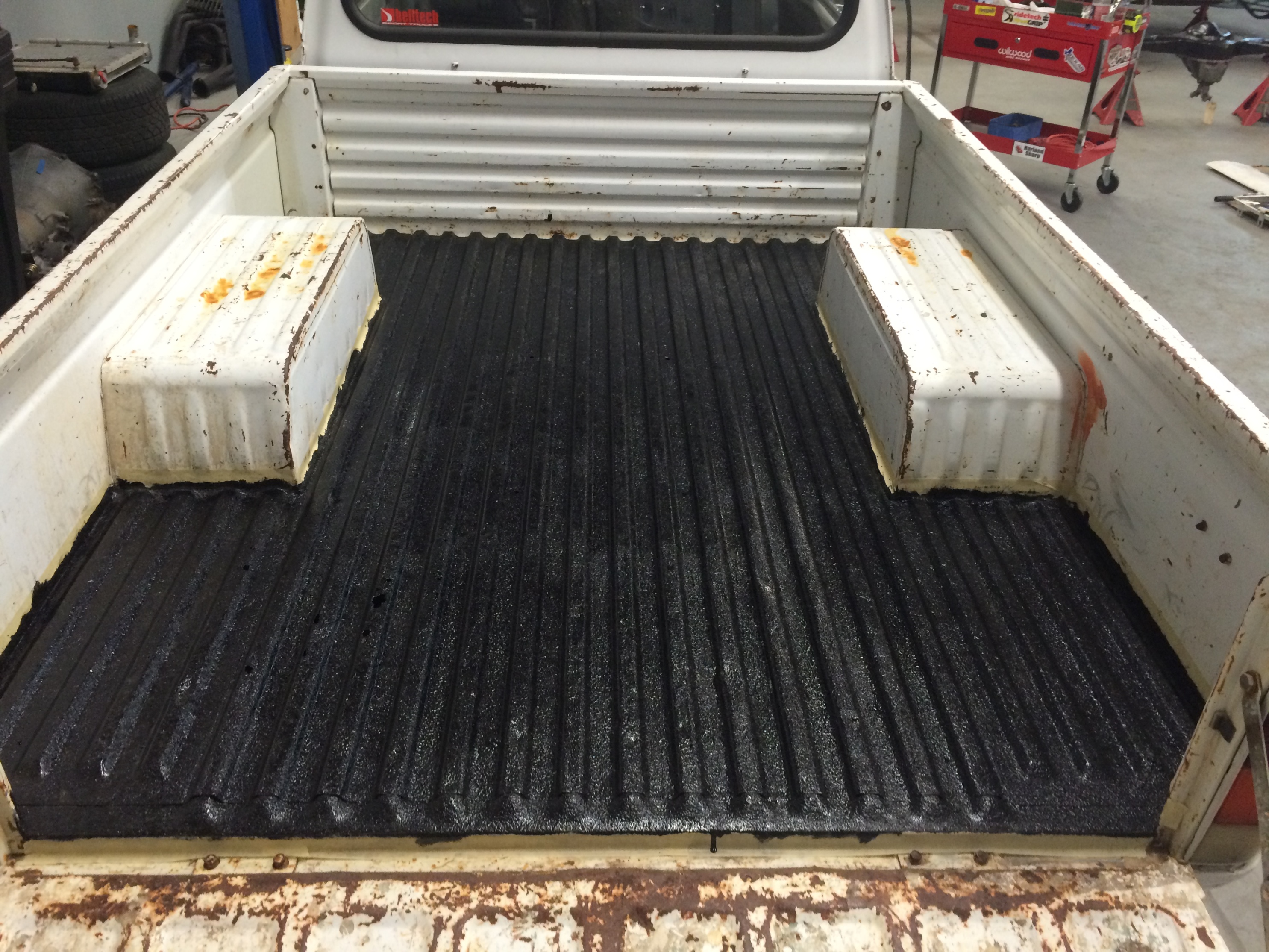

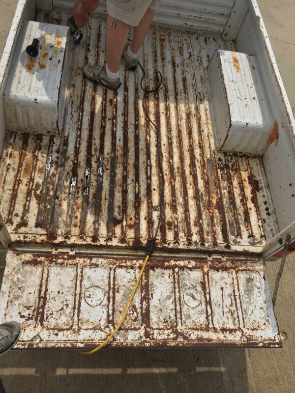

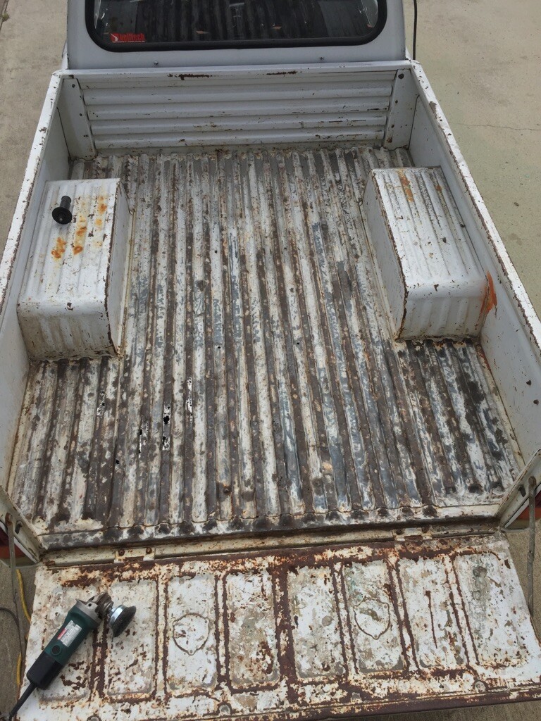

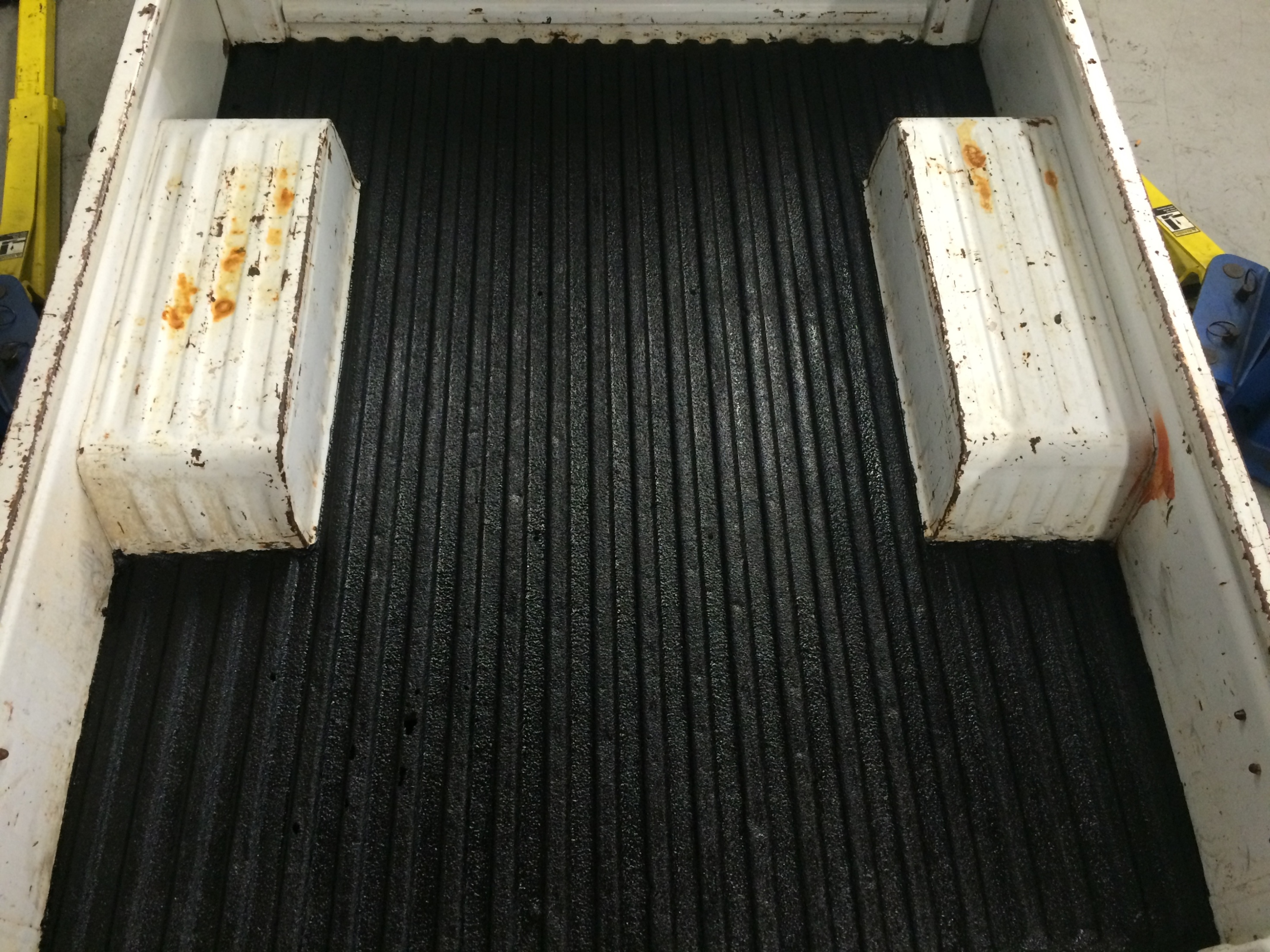

We finally had some time to start getting back on the luv again. We started with the bed and rolled in a DIY bed liner. Hardest part was the prep work. We did this in preparation for the fuel system.
BEFORE
Making progress

1ST coat is done. now a 4 hour break till the next one......that will be 8:00pm.
9:00pm and the second coat is now complete. Wasn't to hard to do.

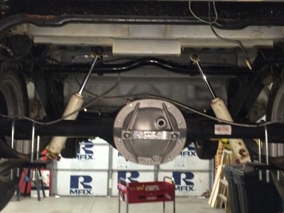

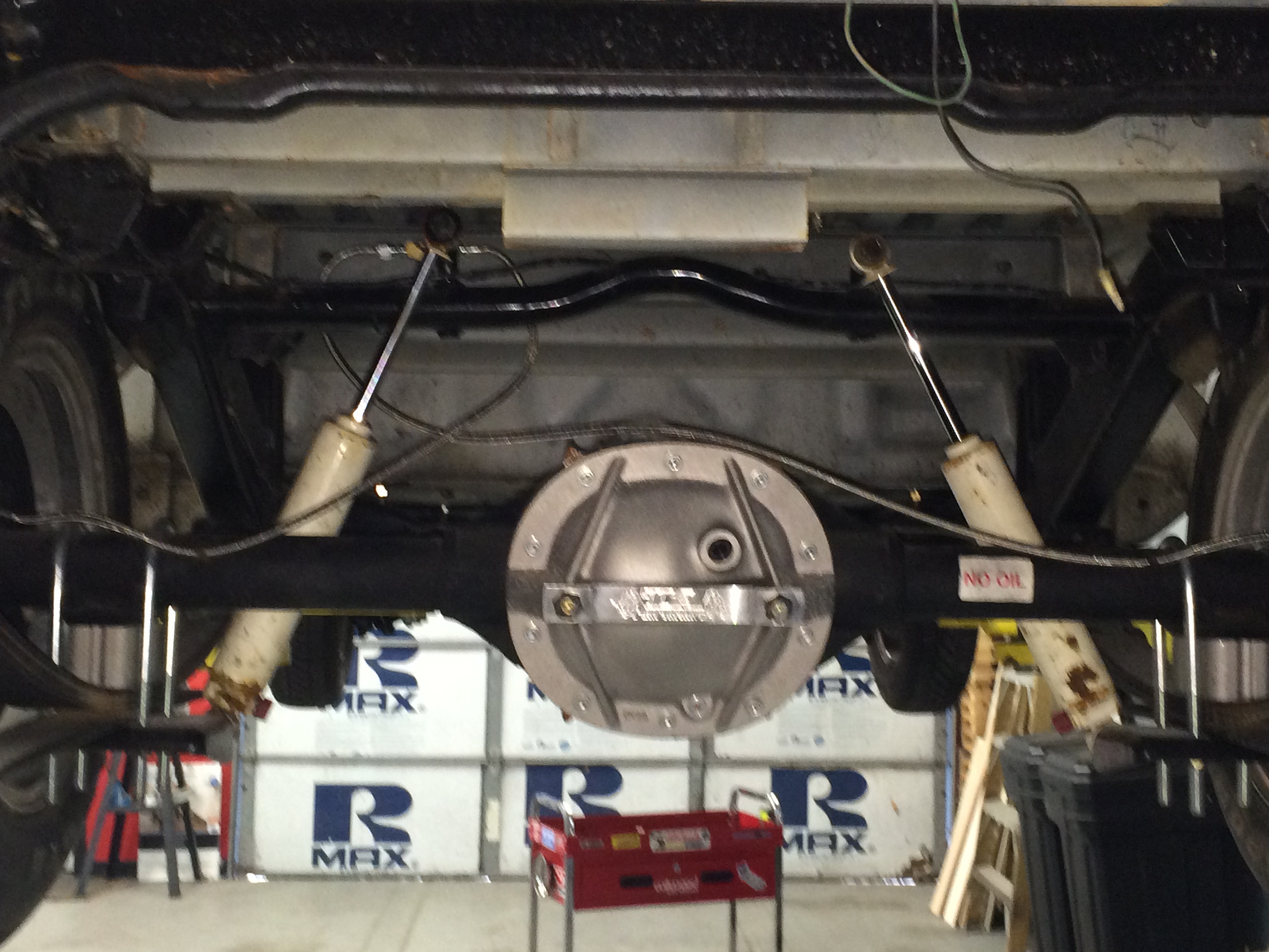

rearend has been plumbed and flushed from the reservoir back to the wheel cylinders.

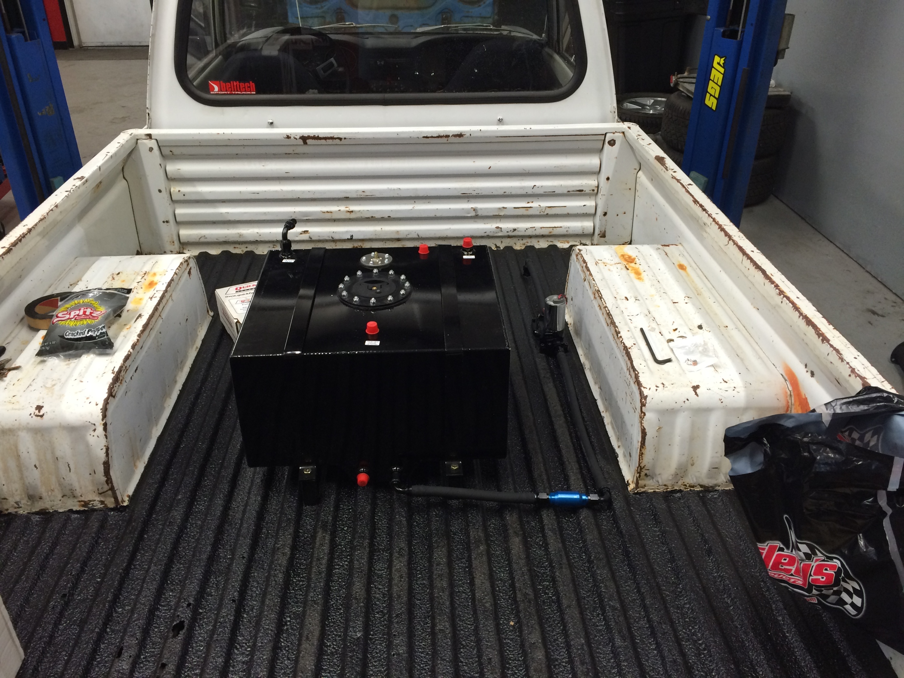

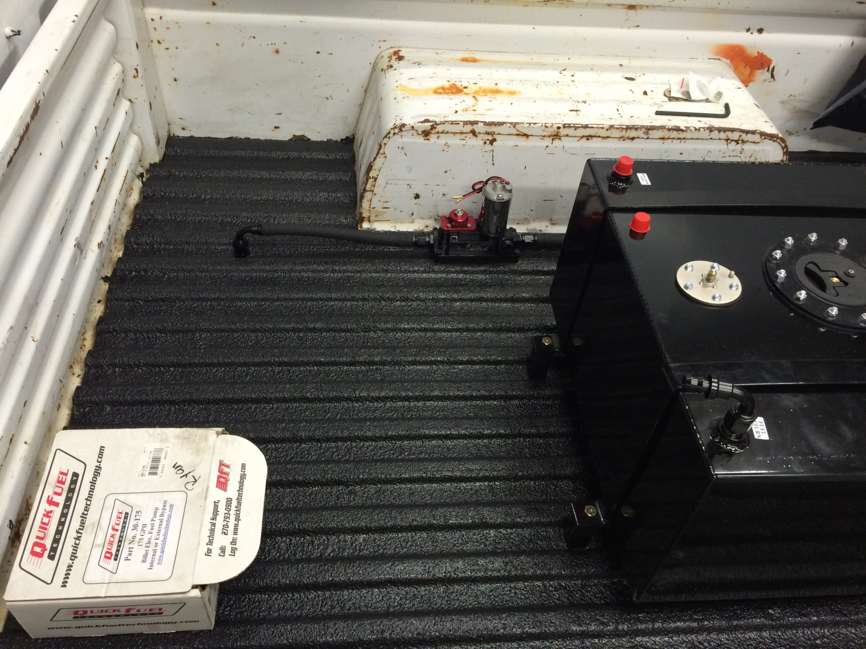

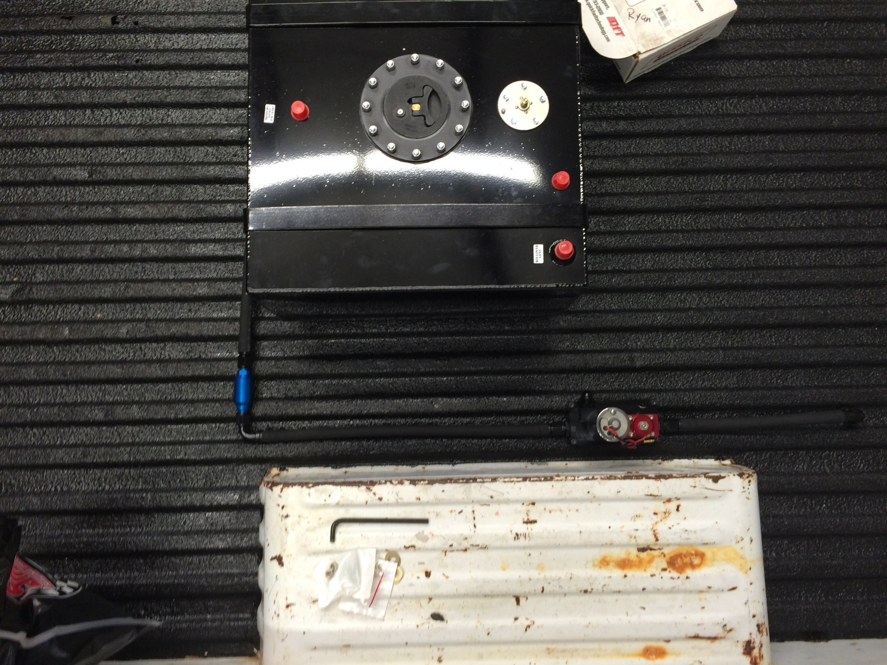

more pictures. QFT 175 pump mounted just have to run the return line from the pump to the tank. I like that you really cant see the fuel line against the bed liner.

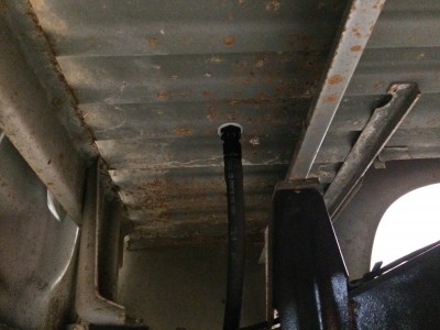

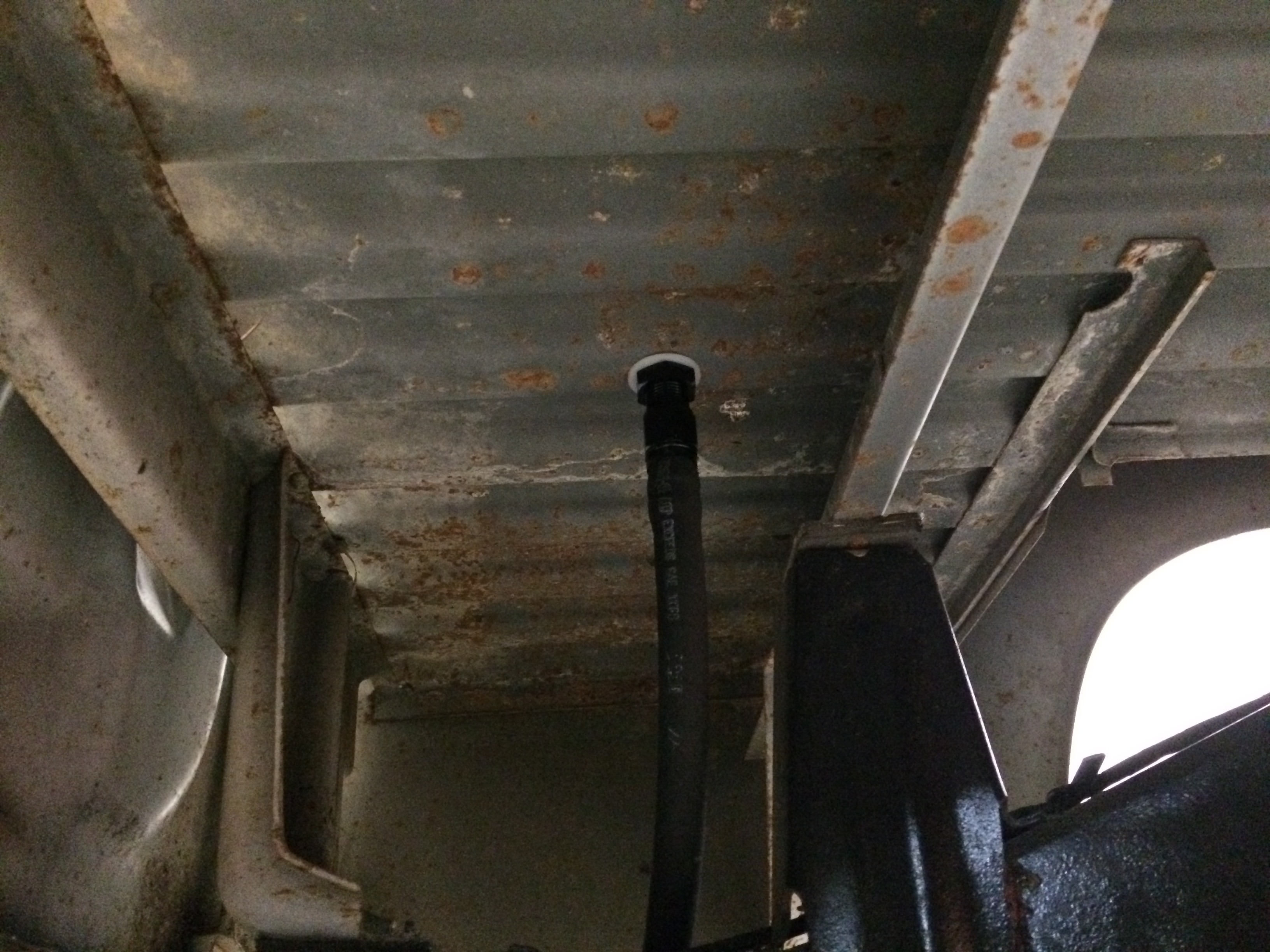

used a bulkhead connector to go thru the bed.
That's all for now. motor will be picked up Sunday and then we start with the drivetrain install.

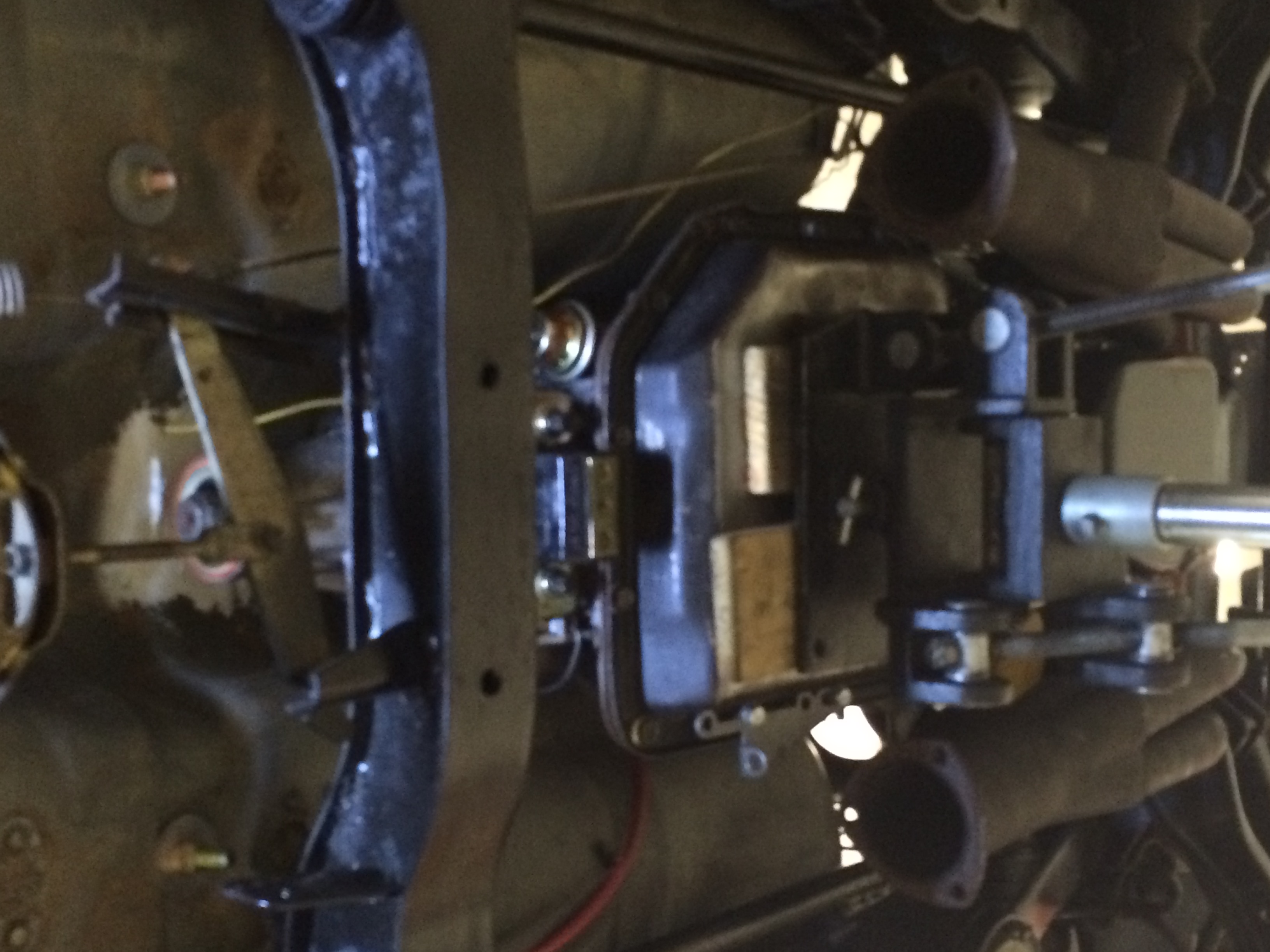

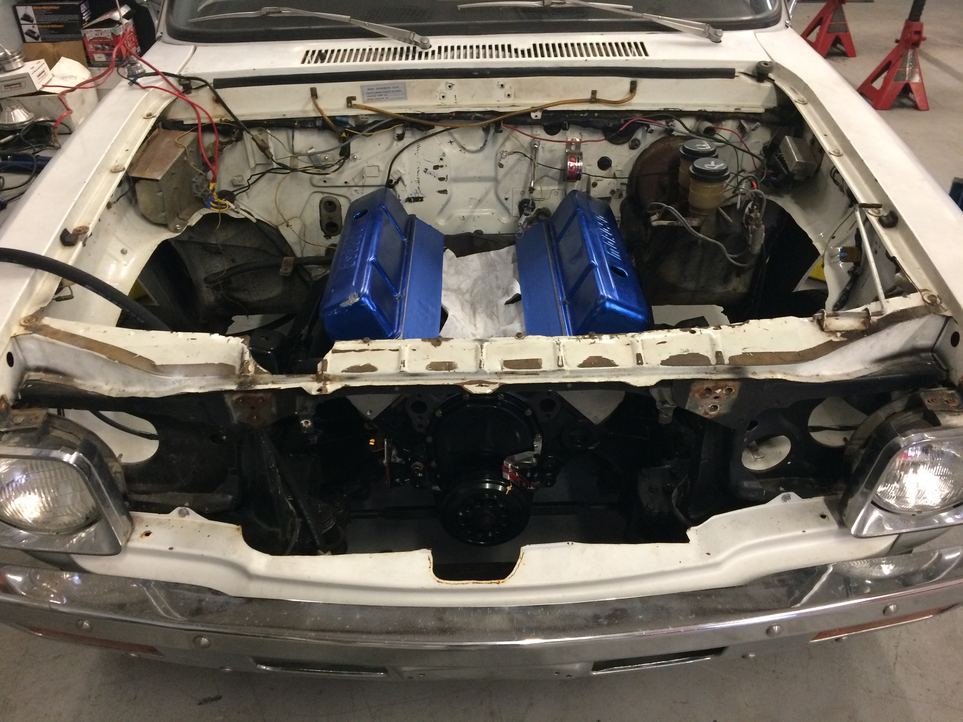

finally had time to do the motor/trans install.
PostPosted: Wed Sep 14, 2016 6:15 pm
Posts: 727
Location: SPRING,TX
My son getting it done.

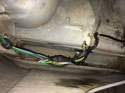

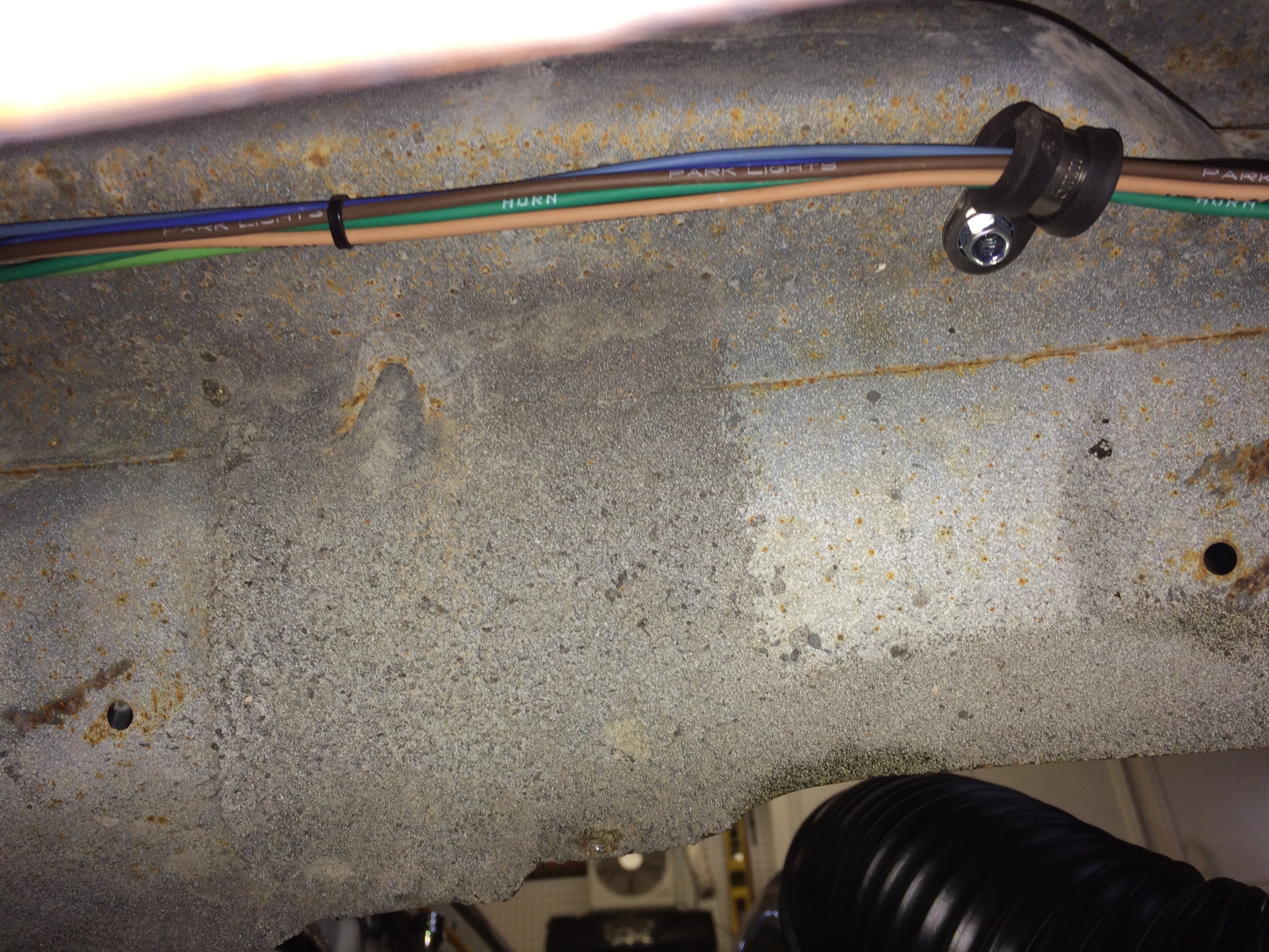

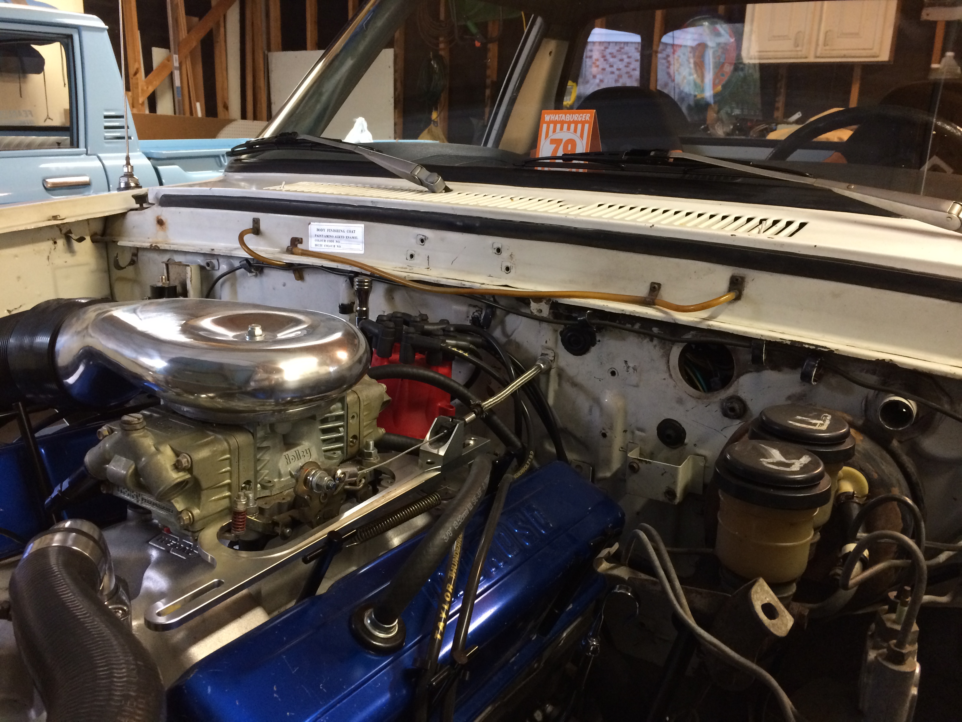

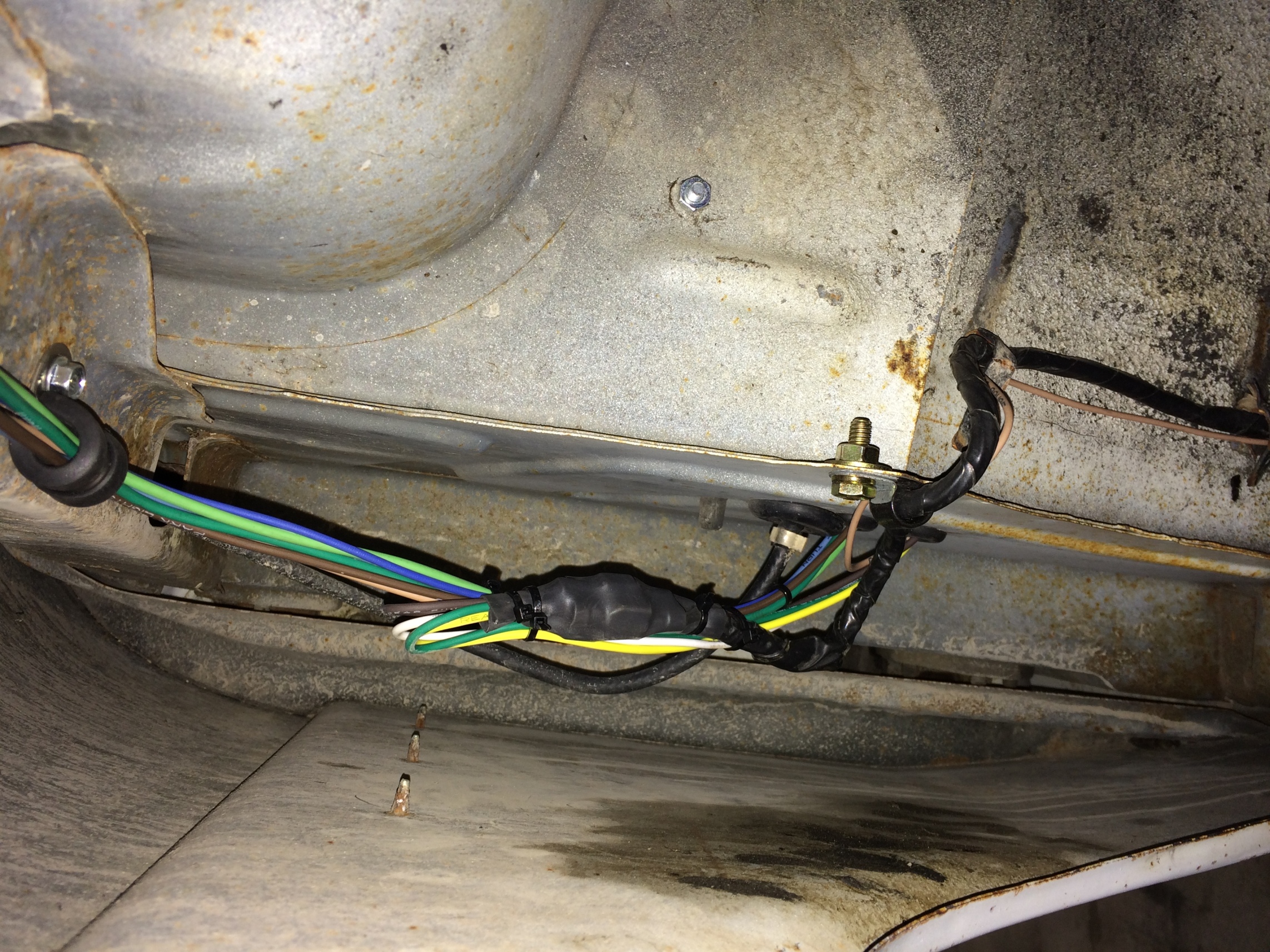

Been awhile since I posted anything on the build but it is finally finished. Got the exhaust done on the truck and took it to a buddies house straight from the muffler shop to tune the carb. Adjusted the carb, shut it off and cleaned up. We came back out to go test drive and it will not start????? It acted like the battery was dead....NOT!!! Well after a little digging,trying to trace wires and reading schematics I said FK IT and bought a new wiring harness from autowire. Had a friend install the harness but we routed it a little differently than stock so the wires are not seen on the firewall. The new luv I bought was done this way and looked really clean. so here are some pics and maybe a video if it loads of the finished product.
PostPosted: Thu Jan 05, 2017 7:43 pm
Posts: 727
Location: SPRING,TX

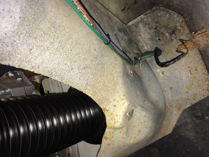

wiring coming out of the kick passenger side kick panel into the wheel well down to the front headlight.
