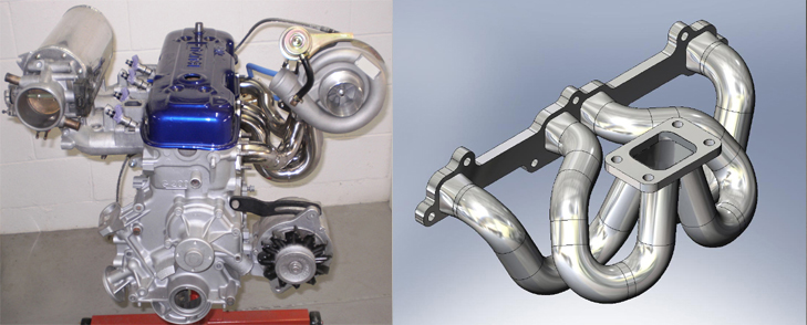

Hey nice build. Im looking into doing the same type of swap on my luv. I found this on turbogemini.com its a g200. Boy doesnt that look sweet. What did u pull that 4zd1 from?
Yep,,, I've chatted to the guy on the phone a couple of times when I was looking at hotting up the G161 or getting a G200,,, but went for the 4zd1 instead. Those turbo manifolds not only fit the G161, G180 & G200,,, they also fit the 4zd and 4ze.
The 4zd1 engine was pulled from a 1988 Jackaroo, 4x4 Wagon. It's a Holden badged Isuzu wagon that's based on the Rodeo platform, no idea what they're called anywhere else in the world?

and yeah the turbo manifolds for the 4z engines but the ports aren't the same shape, not a huge problem at low boost and you can easily port match them for more performance
