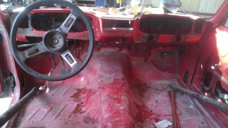

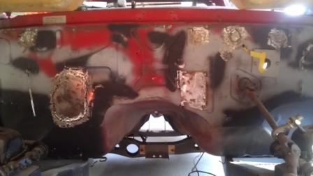

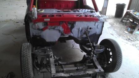

Didnt want any holes on the firewall so i had to remove the a/c and heater unit so the body shop guy can weld it up.
File comment: don't like the welds the body shop guy made.... i think i could do better with my eyes closes but o well looked fine later

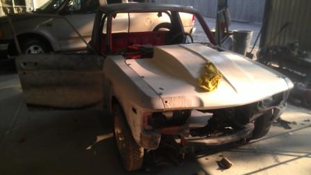

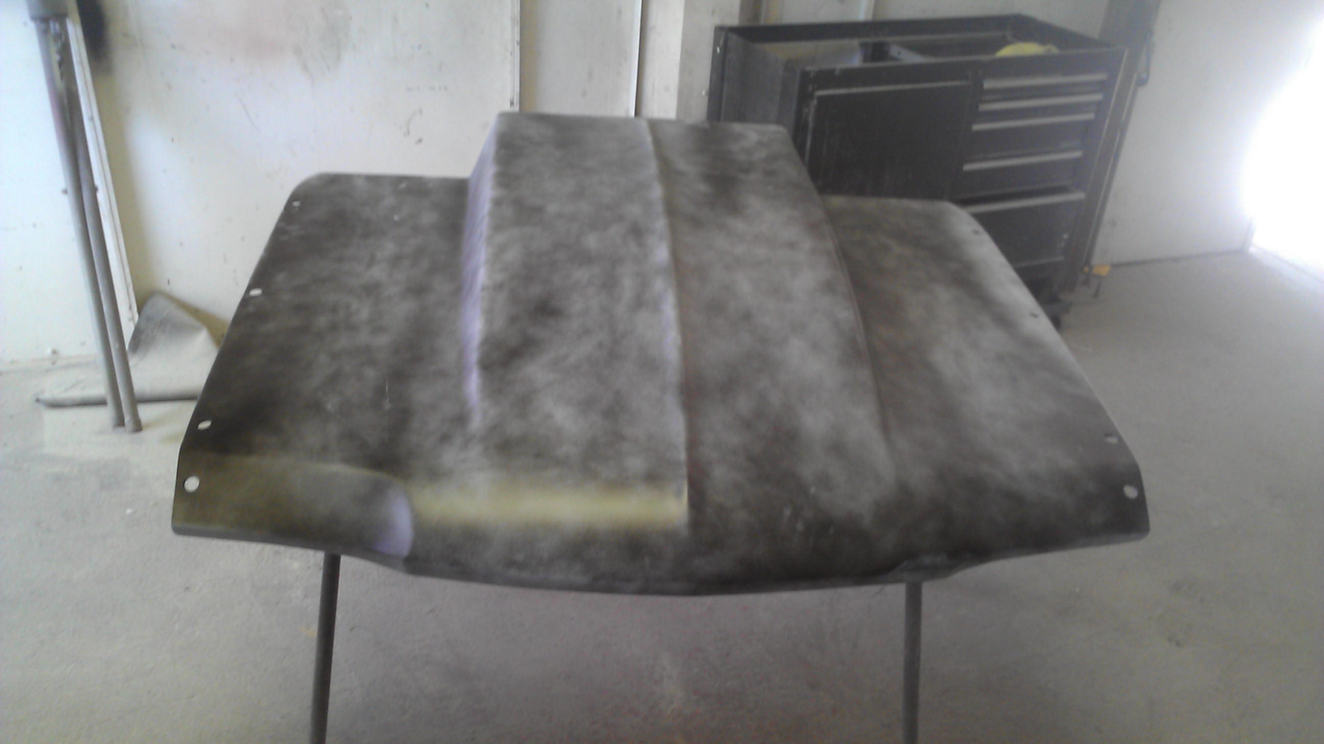

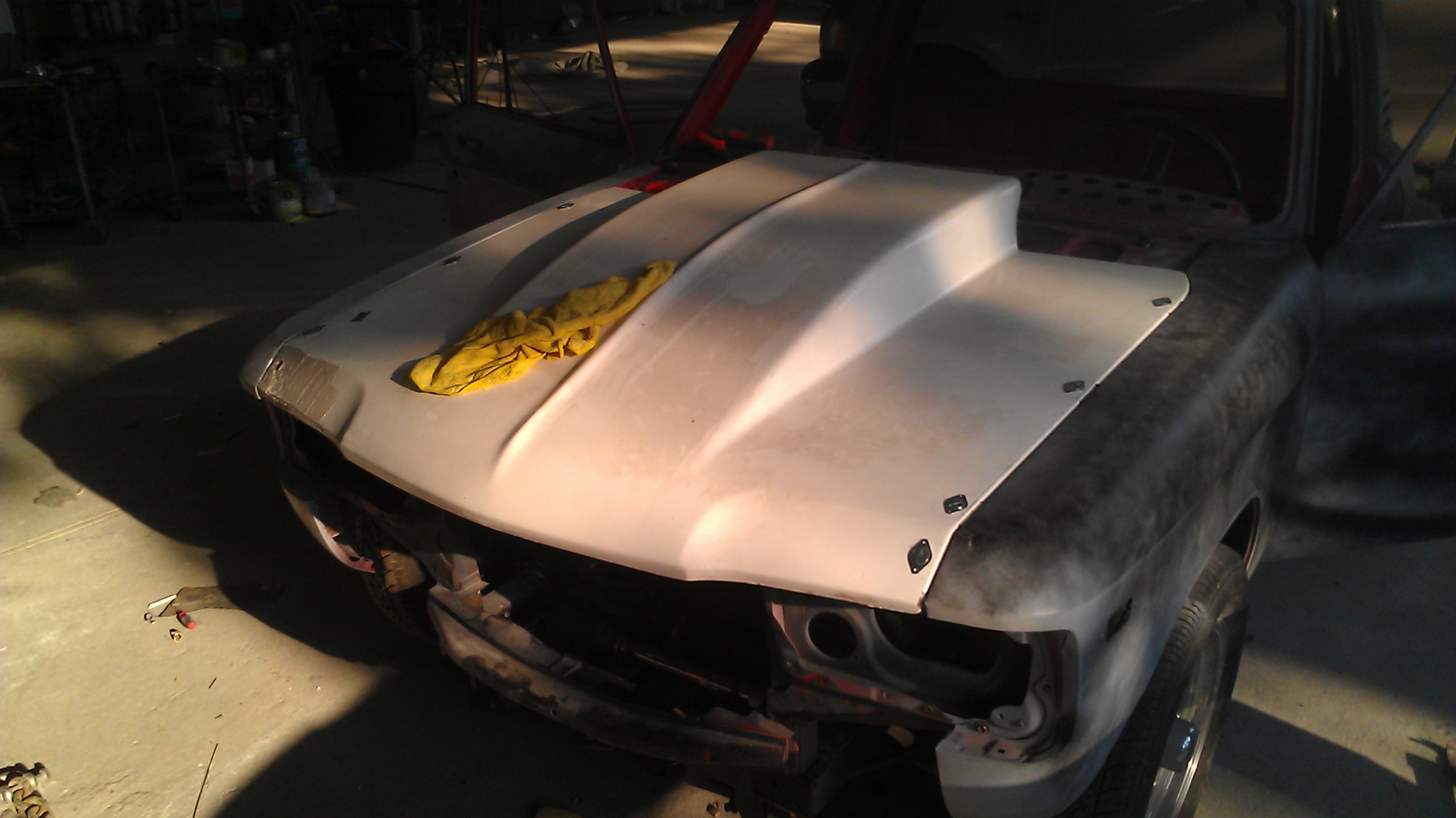

Hood mocked up and they had to remold the corner on the hood as it wouldn't line up right

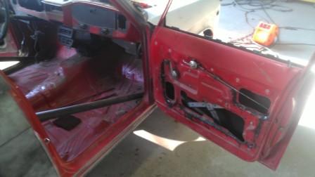

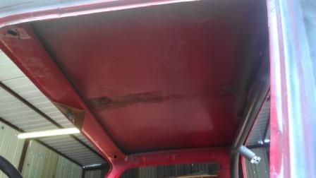

told him to be careful and what did he do rip my headliner off. I should have took it off my self really pissed me off big time.

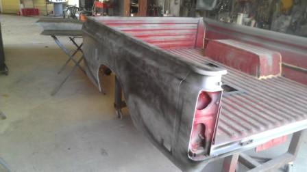

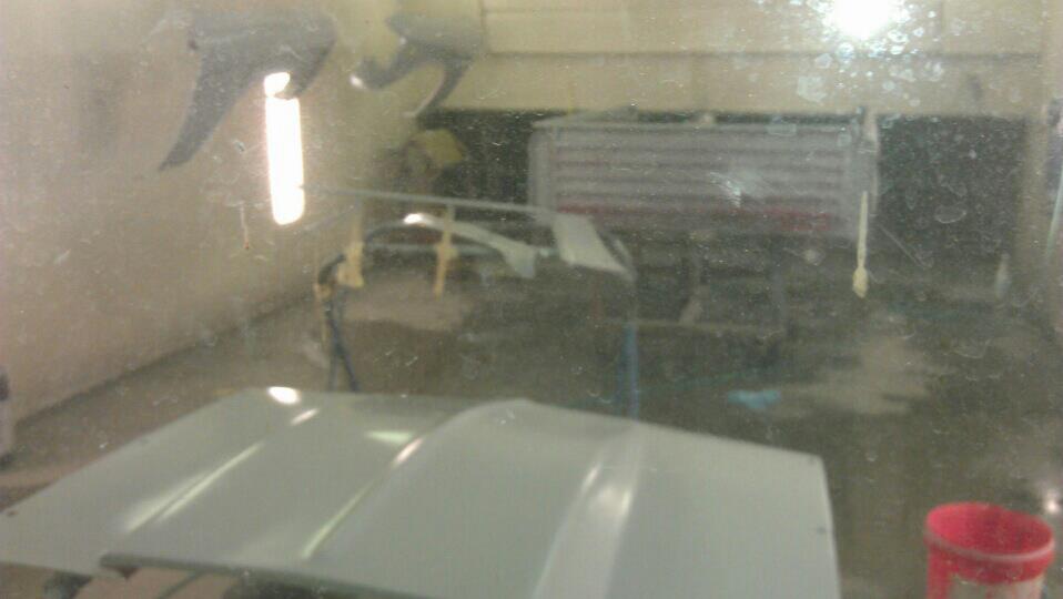

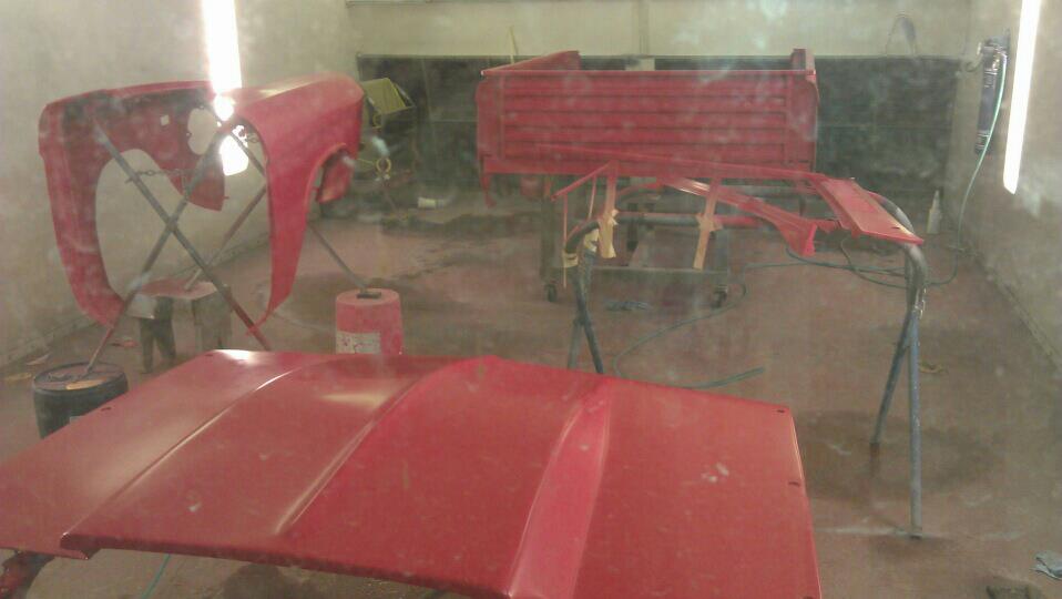

firewall, hood, and bed almost ready for paint.

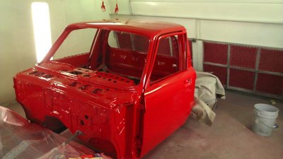

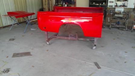

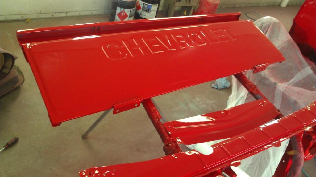

Painted cab
Tailgate

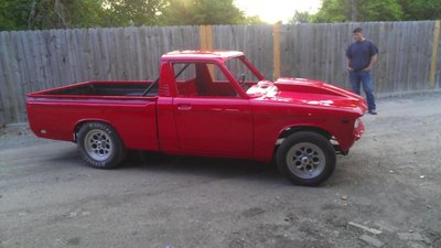

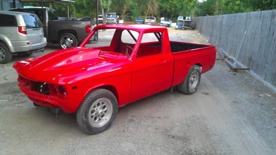

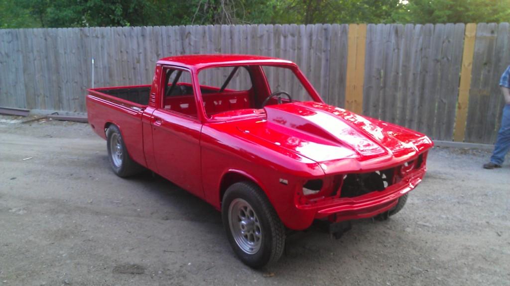

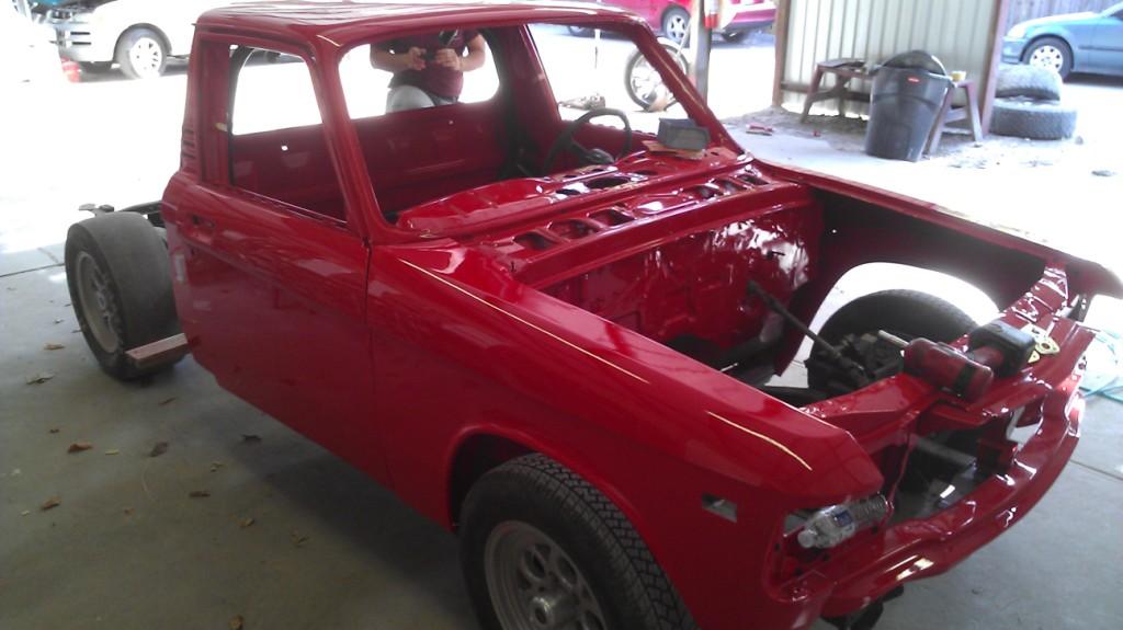

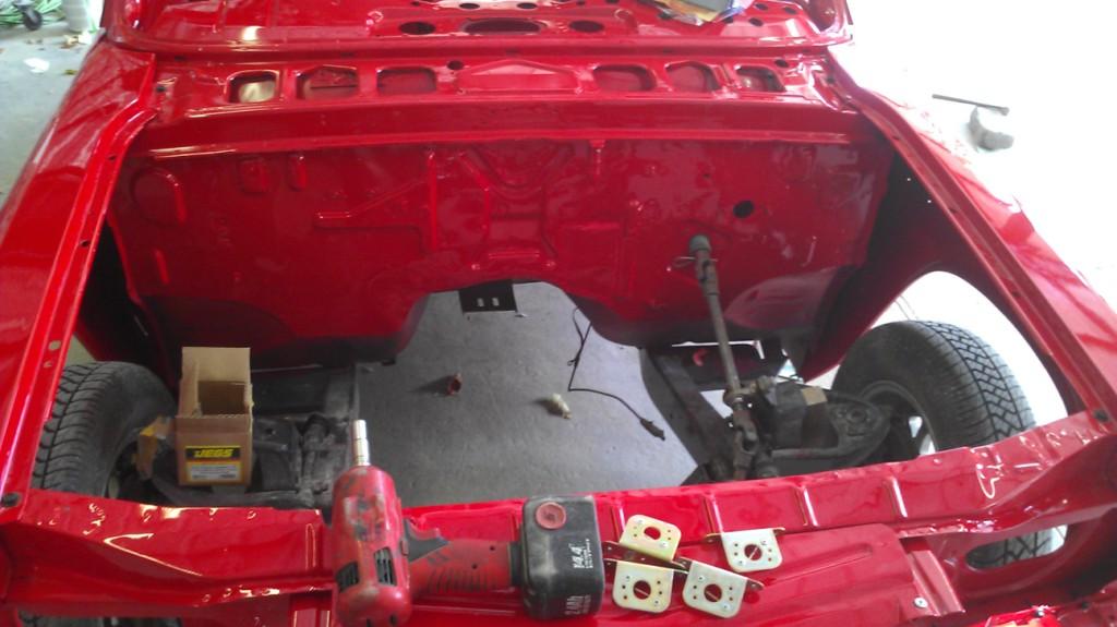

Picking up the truck from the body shop.

Wow.................very nice, what shade of red is that?

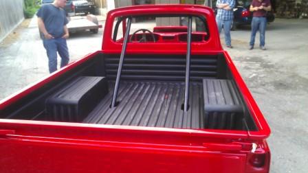

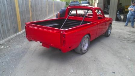

shots of the bed liner and rear of truck.
Thanks! Pics kinda suck but thats a torch red its a GM color.

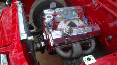

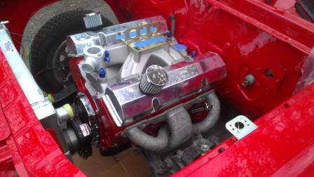

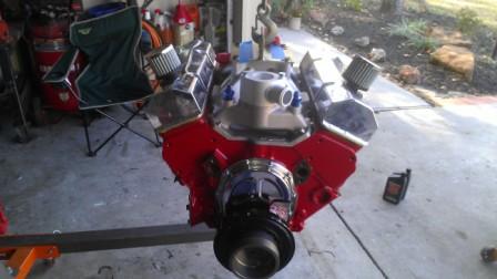

A little something i was working on while the truck was at the body shop :D
come to find out i rounded the cam and wasted all my bearings :econfused
scored my cylinders a bit but most of it came out with a hone.
Refreshed 412sbc:
New pistons and rings
1 new rod
Machine the crankshaft (Thank you Napa in Conroe)
re-balanced the rotating assembly (thank you Houston engine and balancing)
new oil pump HV,bearing ,seals,gaskets
refreashed and reworked with new longer valves and recommended springs dart iron eagle platinum heads with new MLS gaskets
new Lunati Solid roller cam and lifters
new 1.6 roller rockers, 7/16 studs, and Stud Girdles.
New Motown intake
new fabricated valve covers( cheap ebay )
new stefs B&B oil pan with custom pickup tube for my oil pump (fit like a glove)
And a new serpentine crank and water pump pulleys (1:1 ratio)
Cross My fingers and Hoping for the best.

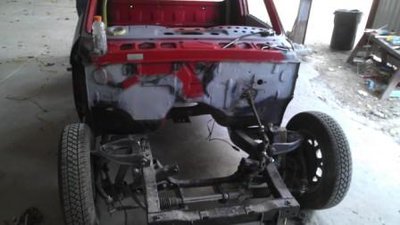

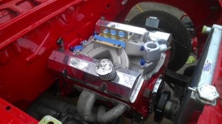

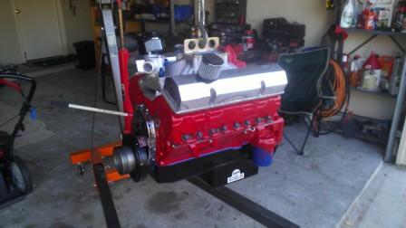

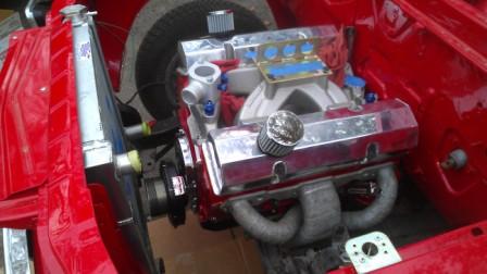

just put the engine and trans in a weeks ago and this is where im at on it will start posting more pics as i go
File comment: Good thing i Clarence the front crossmember or the serpentine pulley wouldn't of fit

nice truck! so u are using top control arms and spindles of an s10?
SALINASRACING.COM
 Post subject: Re: Project 412Luv
PostPosted: Wed Jan 30, 2013 6:13 am
Joined: Wed Sep 29, 2010 3:45 pm
Posts: 45
Location: Kingwood TX
No. Just the spindles And the brakes that go with it. I may end up fabricating some uppers tho I don't really like the angle on the upper control arm compared to the lower.
