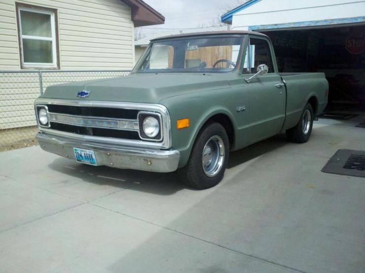

and the progress on my bros truck.
All new bed, doors and fenders, rattle canned the hood and cab to match the new body panels till it is ready for real paint.
He just sold his house because of his crackhead and pyromaniac neighbours and is buying a place about 5 miles out of town and building a 30x60 shop!!
