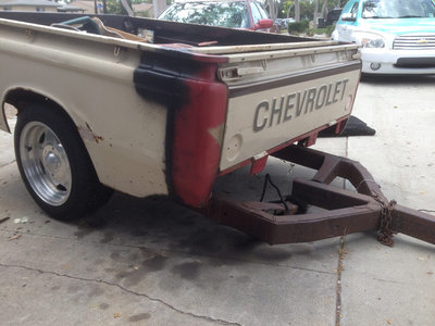

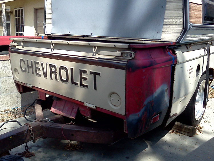

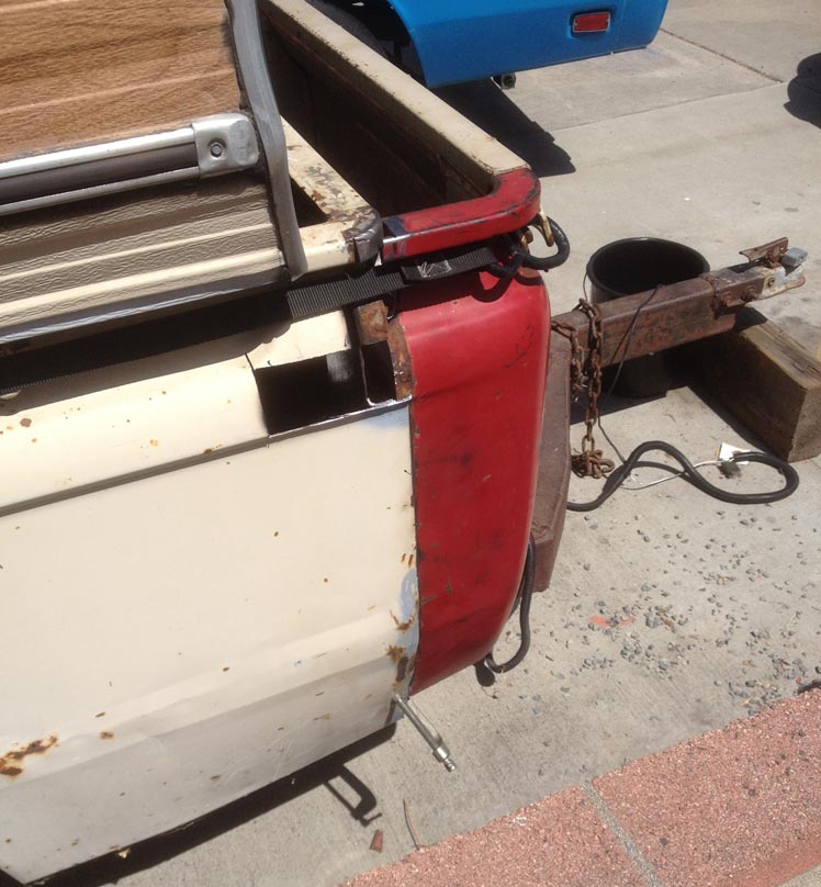

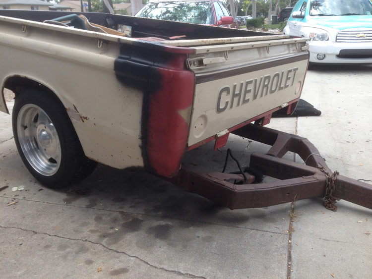

I picked up another bed and tailgate and decided slice the end off and add it to the trailer since there is so much frame sticking out in the front. Planning on notching into the existing bed from the rail 4" and make the bodyline the same down the sides. I figure this will give me lots of practice welding. The camper shell will have to go, I plan on making a bed cover or have a tonneau cover made to match my 72.

Looks almost like it would line up better if you took a few more inches of the top from the bed lip down just under the body line. Kind of an extra notch to replace the part at the front of the bed where the body line curves up at the front corners of the stock bed.
I like the look of that though. That pre-75 tailgate makes a nice front to the bed with no lights in the corners. I may have to steal this idea for mine. :)

800xl, that is the plan. The pic doesn't show it too well but there is about 3" extra at the top from the rail down to the body line and I will have to trim another 1" below the body line of the add on to get rid of the part that turns up toward the cab. I left some room for error since the sawzall went through the bed like butter. I just got lucky finding the 73 bed and really scored on the tailgate. I want to make a roll pan where the tailights were eventually too.

Oh yeah duh, I see the gap below the extra part on the 73 bed now. Very slick. I have not seen a topper that matched up exactly to a LUV in years, but if this ended up the same length as a longbed that might be possible. It looks like you are pretty close to that now. A nice sleeked back front and color matched glass topper would make this even more amazing than I think it will be with just the bed alone.
I'll be looking forward to more pics. :)

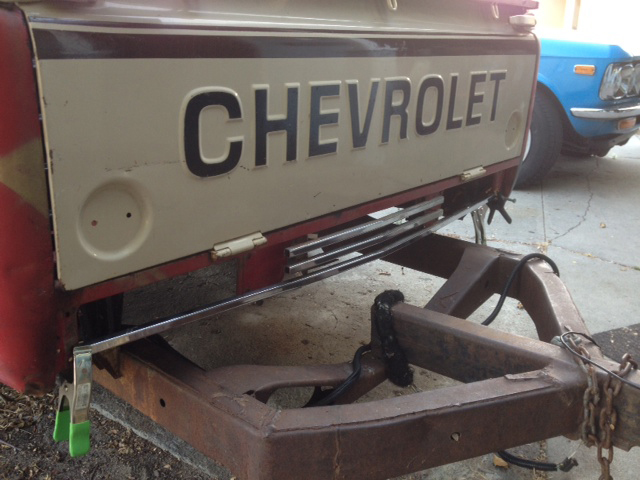

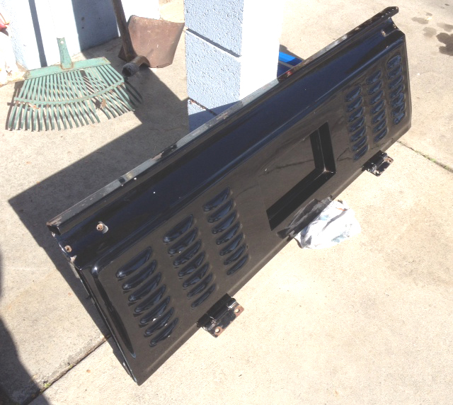

I haven't done a thing to the trailer for a while but could not resist another tailgate I came across. This one is nicer than the other louvered one and I dig the license plate box.

Thanks, I am sorry I missed the chrome latches that used to be on it. The local chrome shop quoted me $200 to chrome the ones I have. 8O

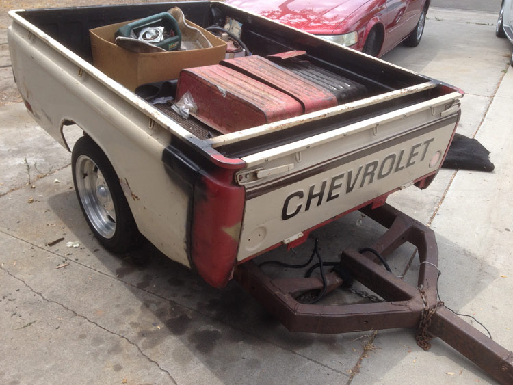

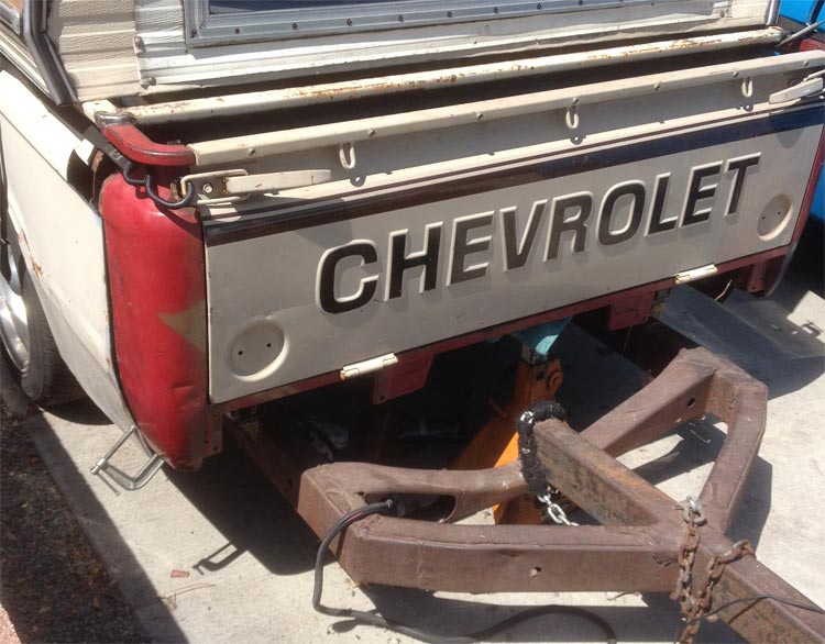

I have been working on this for the last couple weeks. I decided to go with the factory body seam on the bed instead of trying to butt weld it on. I gave up most of the extension but I think my welding skills are better suited to this. Plus I have plenty of leftover sheet metal to patch everything. I ran out of cut off wheels but made some progress today. A long way to go still.

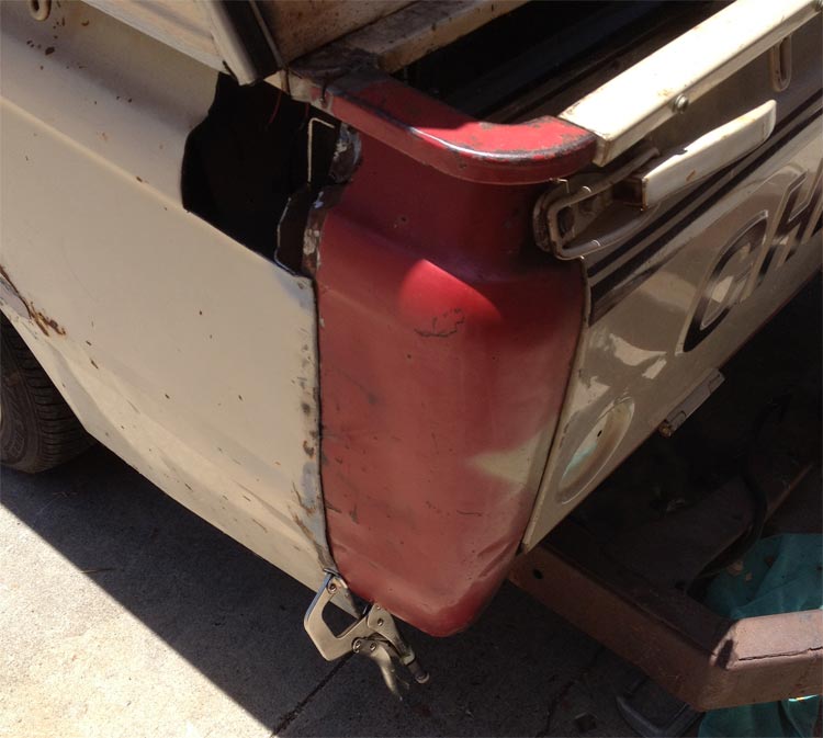

Started welding it up and its going together pretty good. The front of the bed is wider than the rear section by 1/4" on each side so some persuasion was needed.
