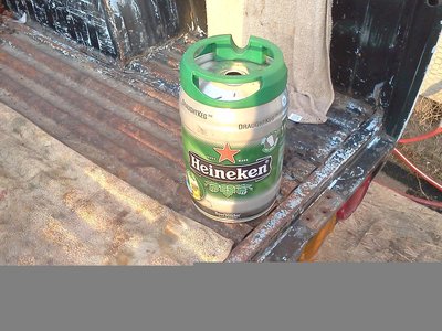

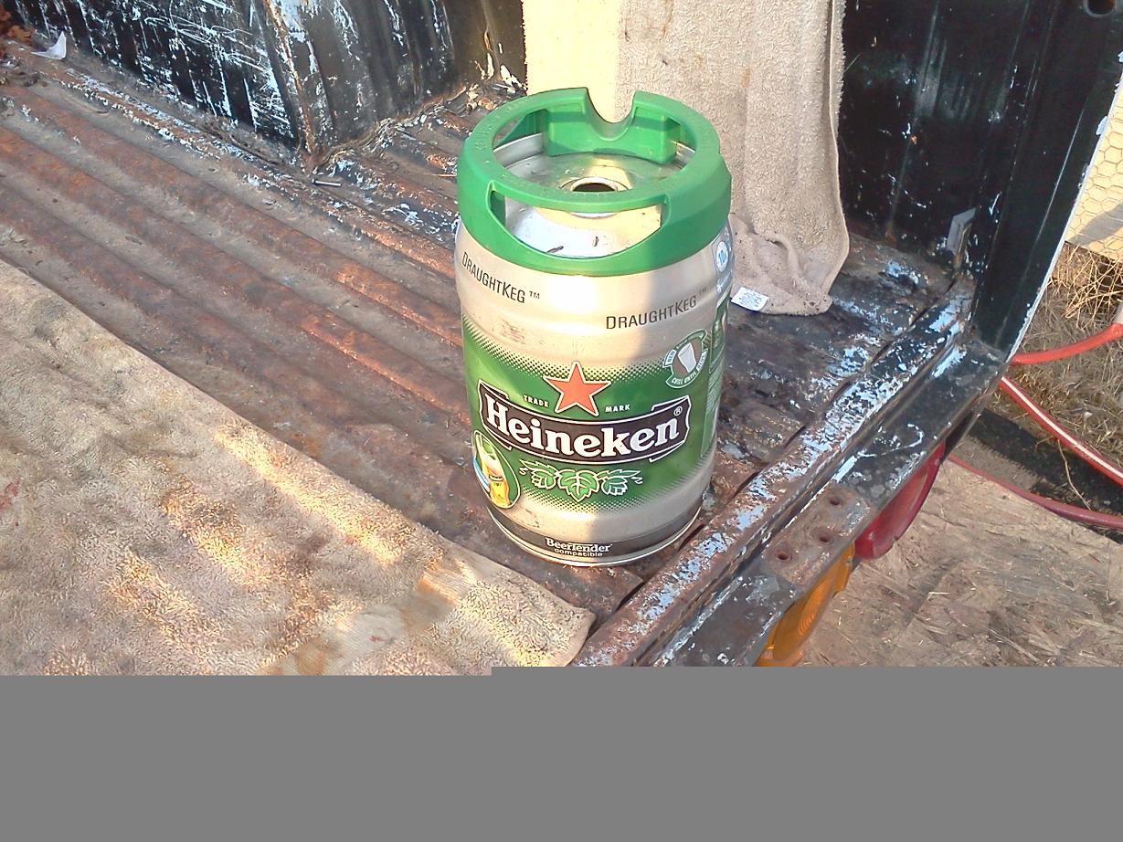

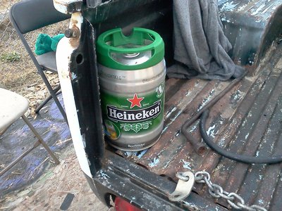

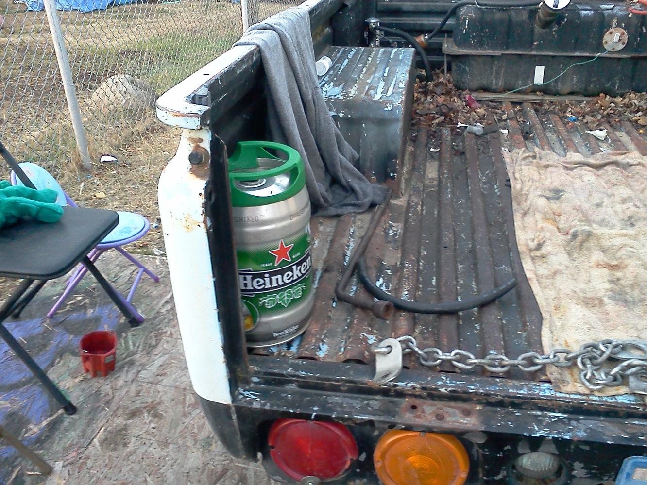

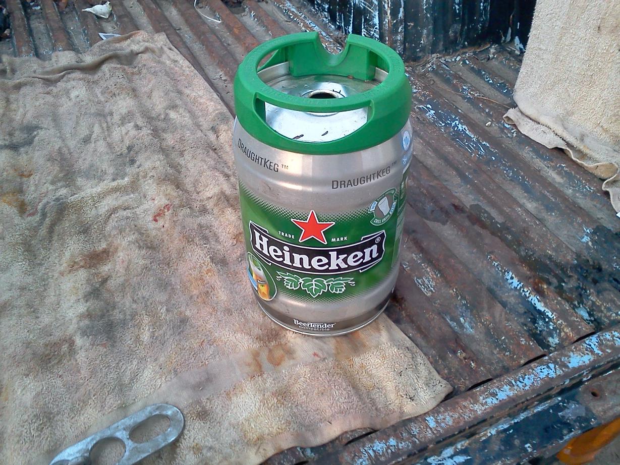

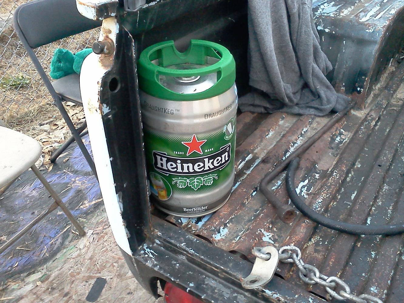

not much progress today but just got signed into machanics school and the baby luv is going to be my project car haha but anyways made me a radiator reserve for my back radiator heres so pics.trying to get bed off but it wont come off have all the bolts out any suggestions?

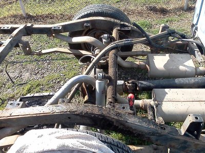

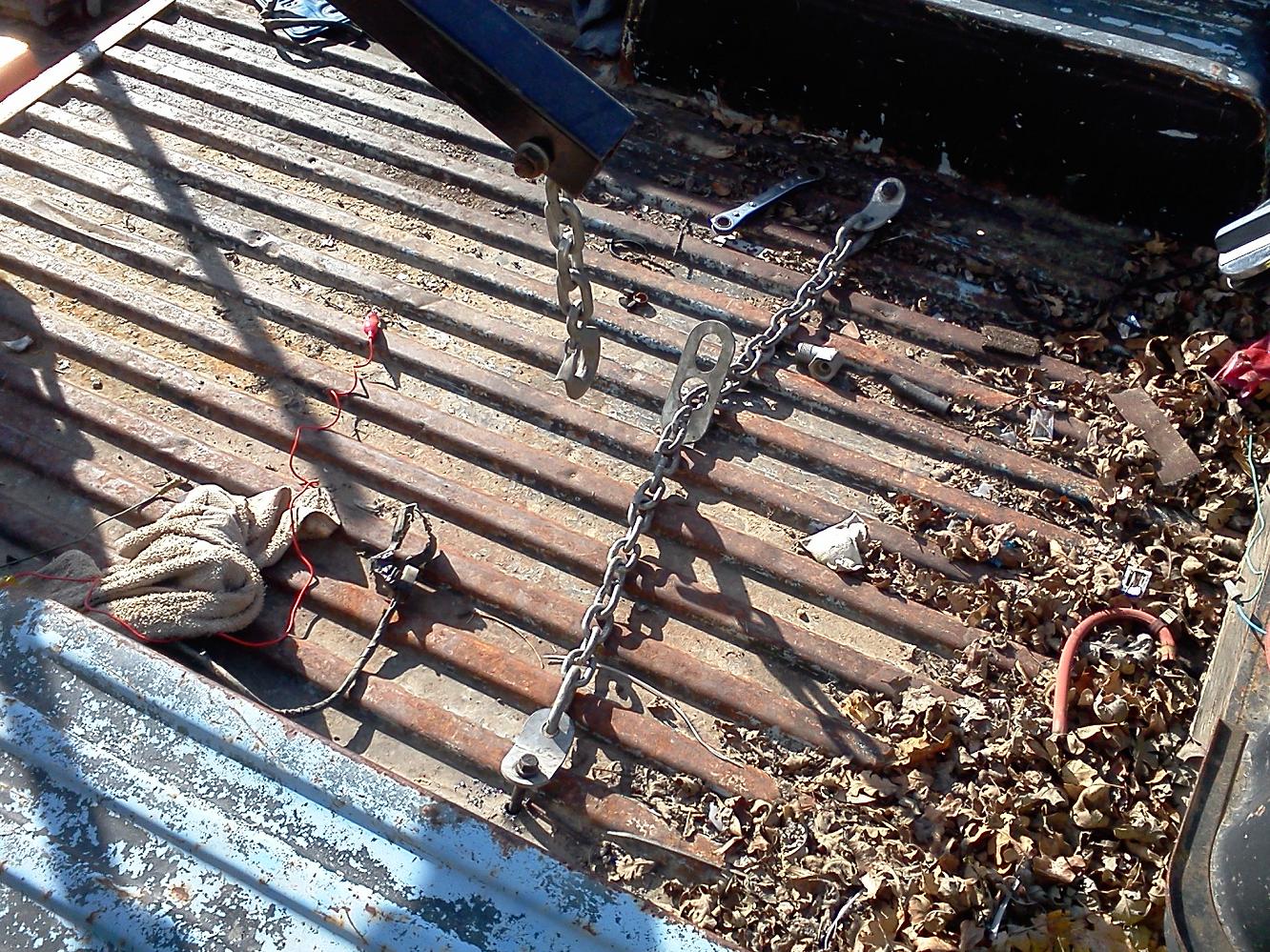

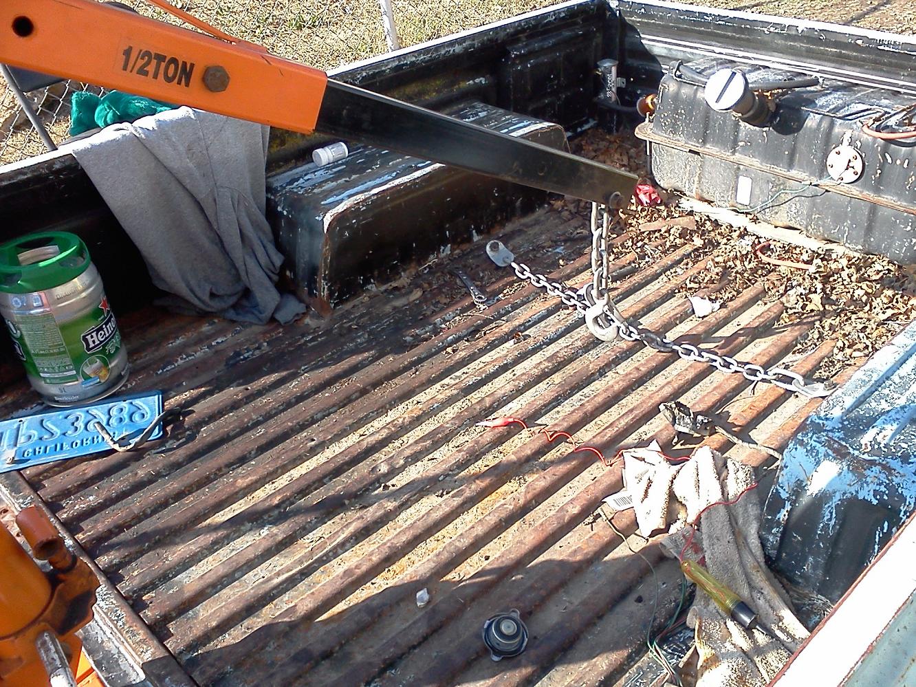

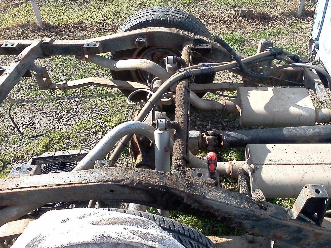

got my bed off today going to rewire the truck and clean up frame and also be adding a hitch

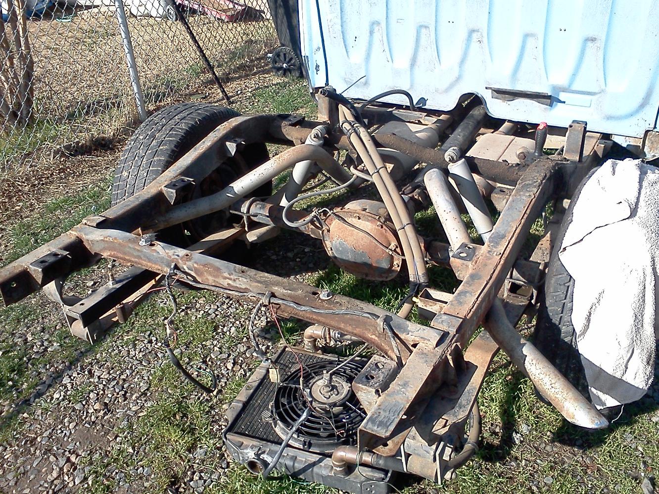

rear radiator

why is there dual radiators? and i like the heineken mini keg resivor...
how are you running your setup are you going to be putting the fuel takn back in its stock location or is there a reason its mounted in the bed???

i think the rear radiator and fuel tank would be to go along with his ratrod prerunner layout.
will help with weight distribution moving the mass of liquid to the far rear of the truck offsetting the 350 in the front :lol:
i was thinking it would be cool to put a heat exchanger for an air to water intercooler in the top section of the tailgate. the extra length of hose gives to water more time to cool off before it gets back
how do you plan to have it mounted? following this thread :egeek

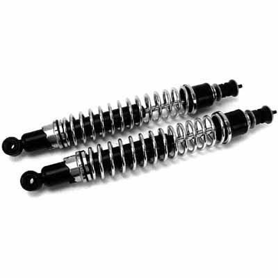

hey guys will these work to raise it?if i take out the torson bars

you would probably have to "fortify" the mounting towers for the front shocks with some plate steel but i think it would work once that was done. what i would do is lift the truck up by the frame and see how much more spring length it would take to get you where you want to be in terms of ride height above the ground/wheel center.
also if you are planning to go more than a few inches up you may start having issues with the stock lower arm angle being farther away from the upper, tower and the mounts.
how are your fabrication skills? thats pretty much what it comes down to..
if you have the tools and time to modify the upper and lower control arms to be at the right angle at your new ride height you can bolt in whatever length of coilovers.
