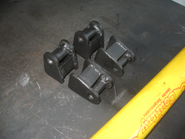

o.k., got alot done today, (for a change :roll: )

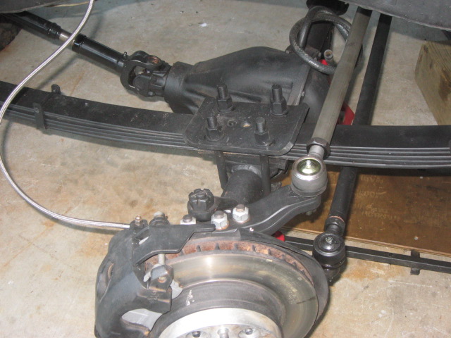

I had a custom pressure side power steering line built ,and fabb'ed up a return line with a inline tube cooler, got all that installed,along with a new power steering pump and belt, fired it up,, and no leaks, !!

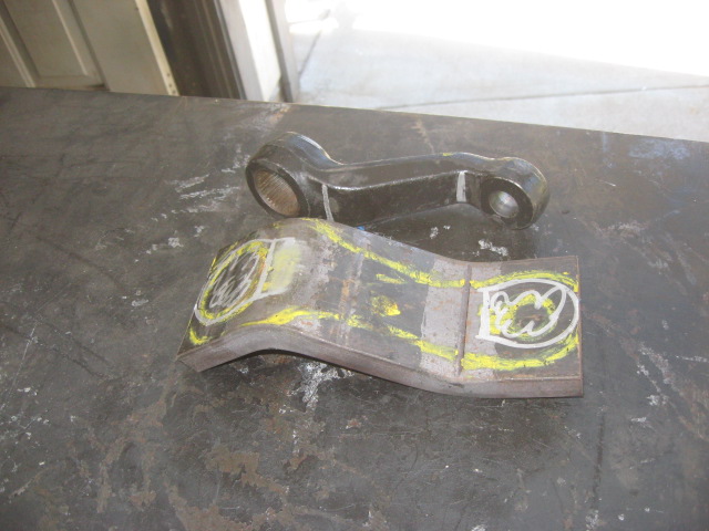

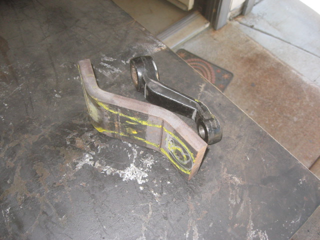

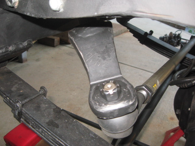

I ended up building my own pitman arm ,the stock Trooper arm is only aprox 4 3/4" long, I needed something in the 6" long range to match the Parts Mike steering arm on the axle,, soo, I had my friend bend a piece of 1/2 thick steel, and than cut and key'ed the trooper arm ends and welded them in the new arm, after some trimming it worked fine,! 8)
I also got the tie rod/drag links installed, along with the front steel braided brake lines,, I built some upper/lower shock mounts,, and will make a couple of shock hoops later this week.....

is welding a suspention or steering part legal in cali ? its a big safty no no in oregon .
PostPosted: Mon Jul 25, 2011 12:12 am
Joined: Sun Feb 07, 2010 1:30 am
Posts: 64
Location: northern california
not sure, :?:
I guess it depends on who you talk to,
I know a few people in Oregon, and other states,
who have done similar mods to their trucks ?
this arm is twice the arm of the stock Trooper, 8)
PostPosted: Mon Jul 25, 2011 5:35 pm
Joined: Sat Jan 02, 2010 8:59 pm
Posts: 153
Location: Pinedale, Wyoming
lol, thats one way to build a drop pitman arm! As far as i know the only thing thats iffy when it comes to home built stuff is linked style suspensions, really only because any highway patrol can deem it unsafe for the highway and impound your truck. (Ive worked at a offroad shop in california)

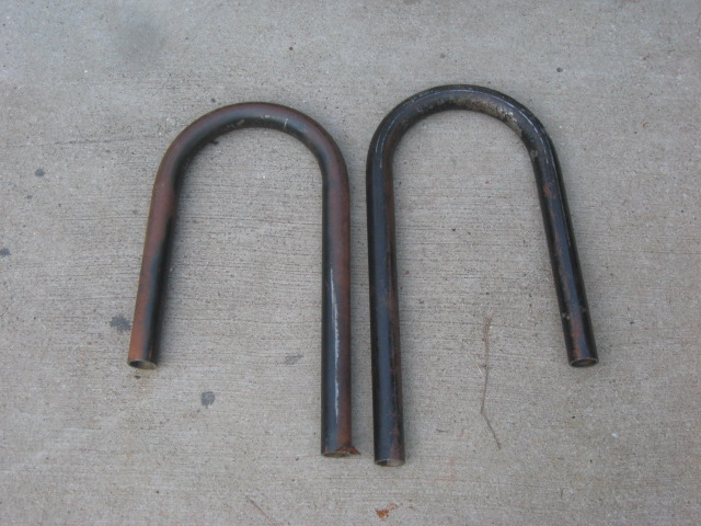

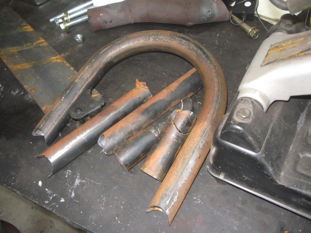

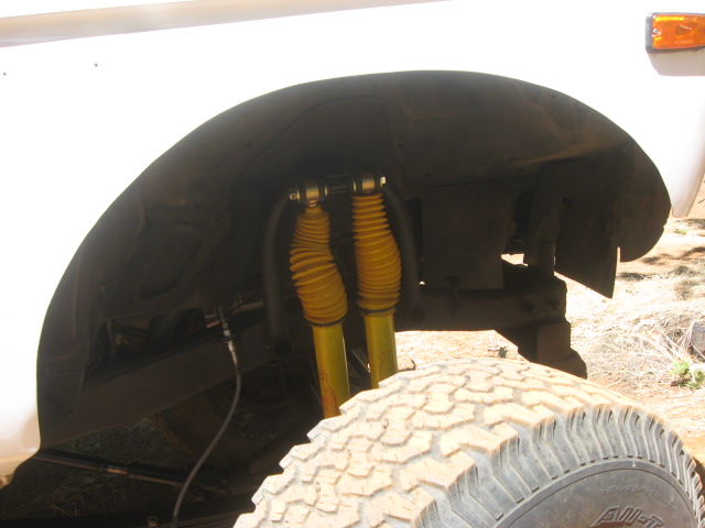

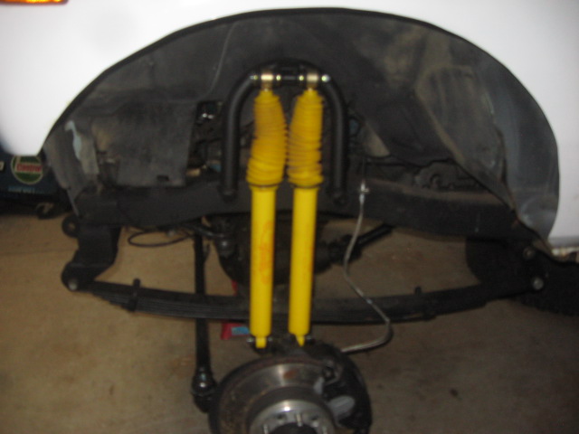

front shock hoops bent up and assembled

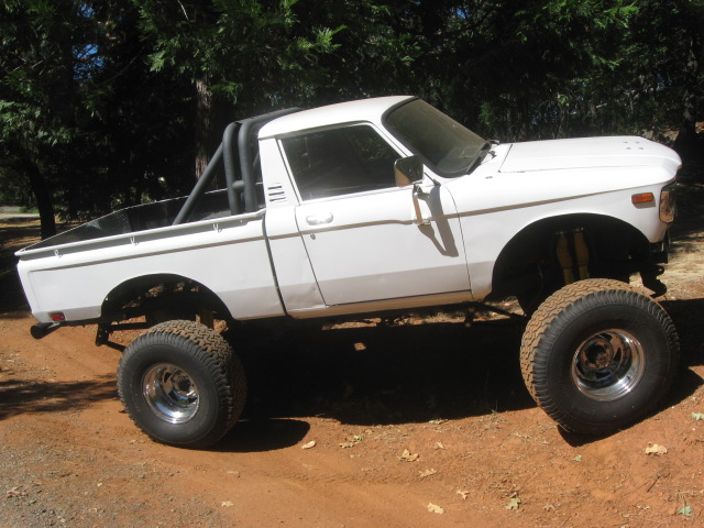

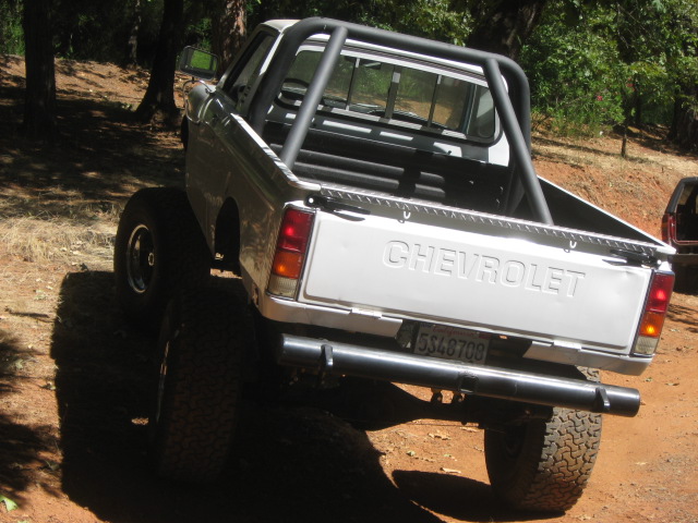

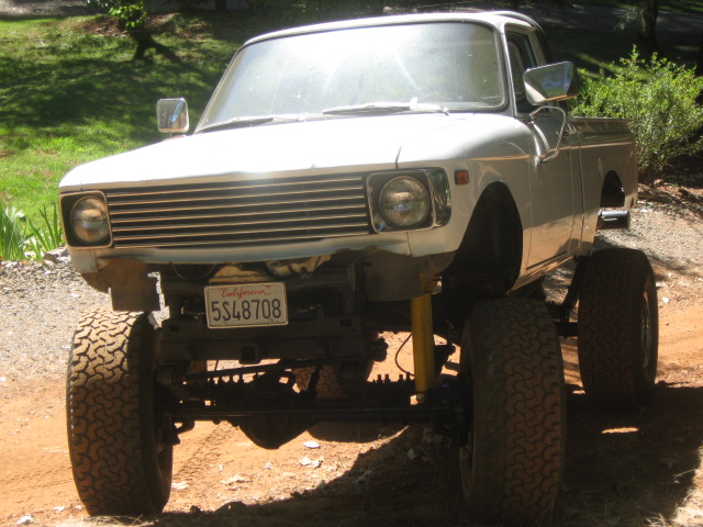

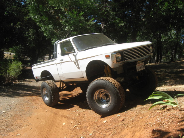

getting the 40 series Flow Master installed this coming Wednesday,, I drove it around a little more this evening, locked the hubs and played on a hill, everything is working great, (love the power steering !),

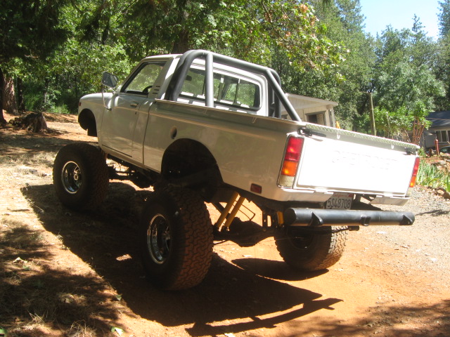

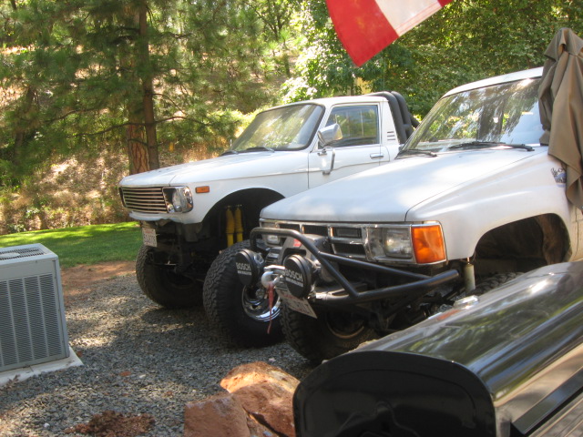

here are a few poser shots :
