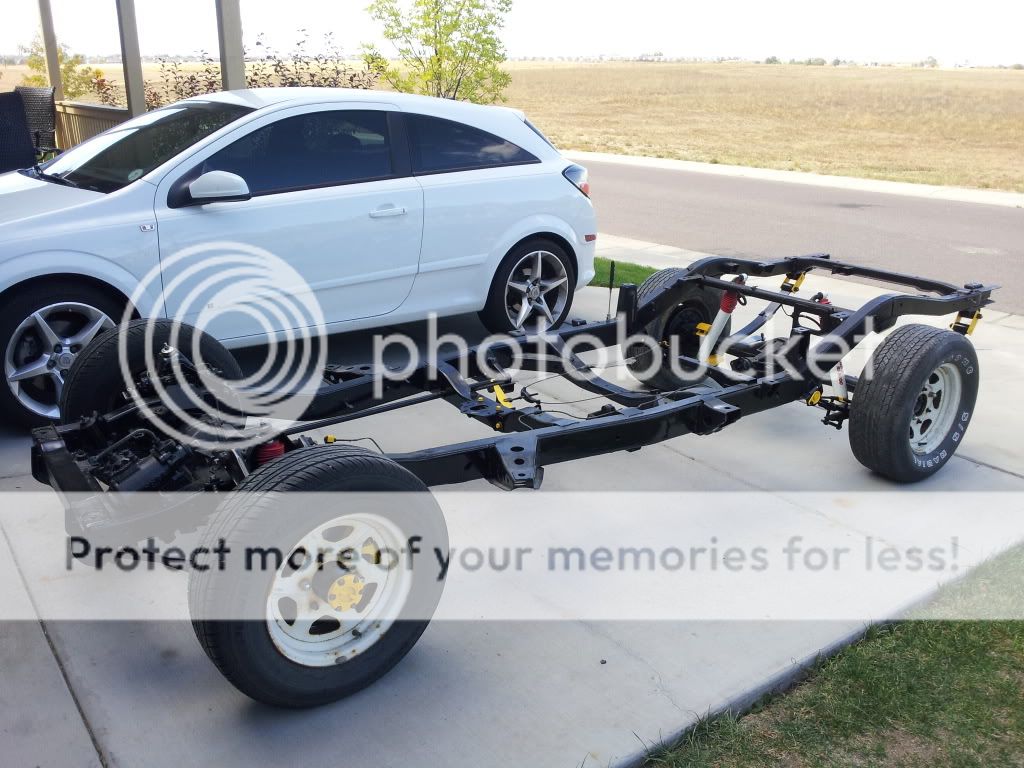

And I'm back with another funfilled update...First up some pics of the frame finally back to a roller. The front and rear suspension is finally all back together with one exception. Just about ready to start putting the rest of the truck back on.
So first up the frame...

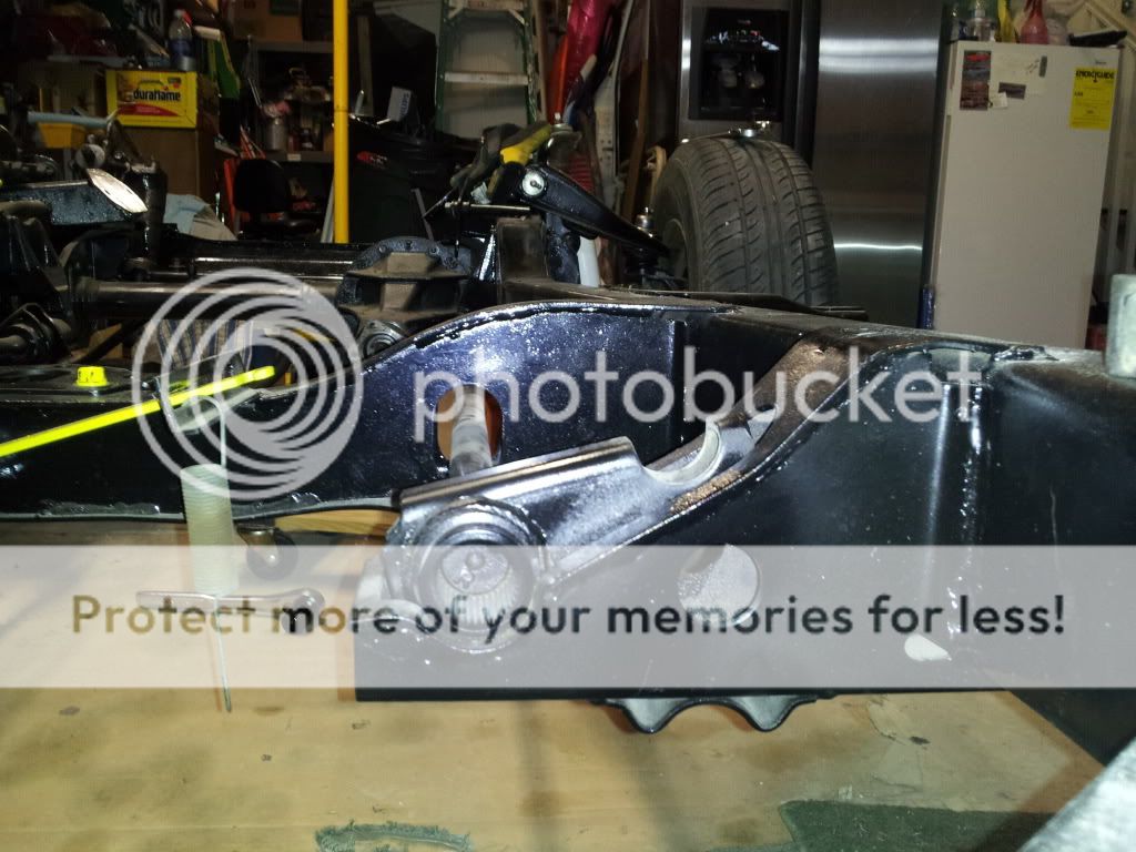

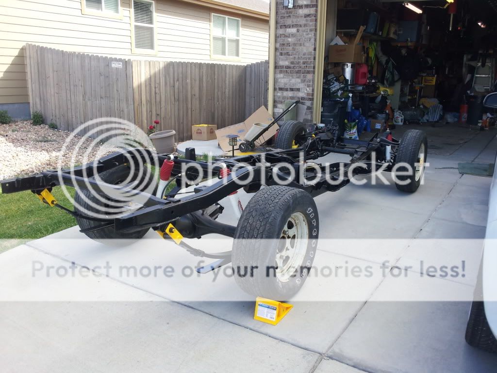

Now the issue I've come across. After putting the front back together, I noticed that the torsion bars seemed a little off. The driver side did not release like the passenger side did when loosening them. I have the front end supported and removed the adjustment bolts completely and this is what it looks like.
Drivers Side
Passenger Side
If you can see it, the Driver side is raised more than the passenger side is and it makes it just a bit difficult to adust back, as passenger side I can finger tighten the adjustment bolt 10 turns, where as the driver side is tight from the very beginning. I did a trial to adjust them 15 turns and was struggling to tighten the drivers side that many turns. Once I did that I measured the distance of the front of the frame from the concrete and the passenger side was about 1/4" lower than the driver side. So...any thougths on if this is a real issue, what the issue is, or how the issue can be resolved?
Drivers Side
Passenger Side
So I think what I'm going to do is take both Torsion bars out and reseat them so they are the same on both sides. Anyone see any flaws in this course of action?
perfect.

If you want the truck lifted, but still have the original ride/stiffness, take the bars out, lift the frame up until the wheels float, install the bars and set it back down. Then you can crank the bars up to the level you want and the bars won't have as much tension on them then they would if you just cranked them up. We call this re-indexing the torsion bars. There is a thread about this around here somewhere.
