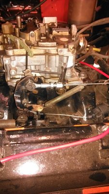

Stock pedal here too. Is there any other locations for the peg on the throttle shaft to increase the throw? Post a picture.

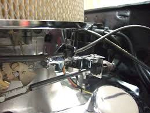

Posts: 370
theres only one other spot to put the cable, and no change but a stiffer pedal. heres a pic or two

Moving the cable closer to the throttle shaft would be a shorter throw. I don't understand how it won't go to full throttle. Just a question here, will the current set up open the primary butterflies to the 90 degree position looking down the carb? Is this a manual or vacuum secondaries?

1: I've been running around with it closest to the throttle shaft like pictured. 2: I'm stumped also, along with everyone else I've talked to. 3: I'm pretty sure, I will double check that tomorrow. 4: they are manual secondaries

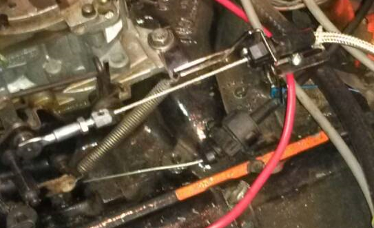

It looks to me like you are losing the travel from the bracket to the throttle shaft like Karl said, The distance looks about 2" farther back than it should be. It should be right at the rear bolt of the carb not back like it is. Does the bracket have the mount for the kickdown cable? Its hard to tell from your picture but the kickdown mount should be about 2" back from the throttle mount. I know from my junkyard scrounging that GM made a lot of variations on the cable mounts and I have always used a factory bracket instead of the aftermarket ones.
As a note I have a similar S curve in my spectre cable and they last about 3 years before the cable starts breaking strands. I am planning on switching to a 70 Camaro pedal which will move the cable 2 inches closer to center and give it a straighter throw for the cable.

I fixed it finally :) I moved the mount closer to the throttle shaft like luvtrkr suggested. (Adjustable bracket)There was still no change. Then I noticed my return spring was touching the secondary shaft, not letting it open. Removed the spring and all 4 open now and its nice and smooth unlike before. I knew it had to be something easy, all 4 opened when I first got it going. Sorry for my stupidity guys lol and thanks for helping me out. Also there is a spot for the kickdown cable luvtrkr, but I have it just laying there. The ratchet shifter is my kickdown and makes driving that much more fun
