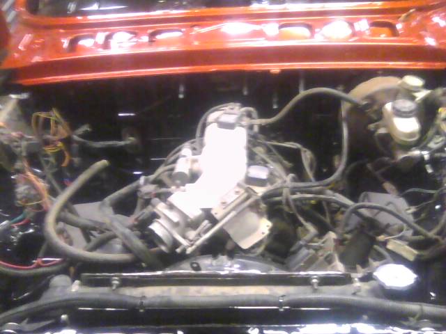

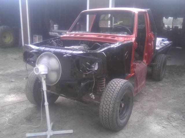

Been working on it every night! Wow worked on it untill 12 last night after i got home from college. Well i got a lot done! 8) I got it to turn over yesterday, and fogged gas into the intake (we did this with my bronco II i just needed to get air bubbles out of the lines) It STARTED!!!! For the first time in over 2 years, that 2.9 rumbled to life! :twisted: I couldnt believe it! I did it!!! :mrgreen A 1980 chevy luv on a 1986 ford ranger frame with the 2.9 V6! I was so happy!!! :D I couldnt believe the 2.9 ran as good as it did for not being ran for over 2 years! Didnt Even Smoke!!! and Feels like its strong! :twisted: ...............................................................................BUT i had a problem. I wouldnt run with out fogging gas into it??? I had spark but no fuel??? Well after two days i figered it out! The ECM controlls fuel, the ranger had two fuel pumps a low pressure one in the tank and a high pressure on the frame. Well after testing the relays, taking out the inertia switch (i must of threw it away 2 years a go! dam me! olwell) I just bypassing it. not sure what to do now, i started reading the broncoii/ranger sites and the older 2.9 computers can go bad. But i thought? How i havent used it in two years? Well i pulled the computer off my 89 bronco II (it has a 2.9 to and they are the same computer from 86-90, and 91-92 2.9s but im non sure on those years tho) and i hooked it up and What do you know?! it STARTS and the Fuel pump kicks on and shuts off like it should and EVERYTHING is Great!!! :smt023
I took a video of it running but threw getting down loaded from my email it has no sound? Not sure wy so sorry for that!

heck yea man that is awesome! finally got it up and running. now you just need a junkyard ecu and you will be good to go 8)
i really like the paint job the reddish orange looks great with the black should be a fun lil driver.
whats left before it gets its first test drive?

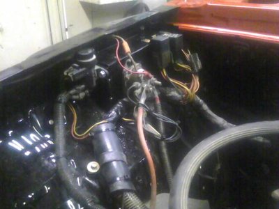

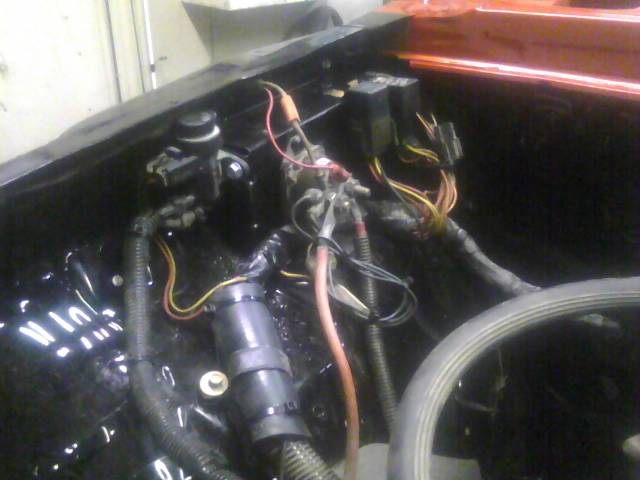

Well got all the wiring done on the left side off my engine bay wow it looks like its ment to be there! 8)

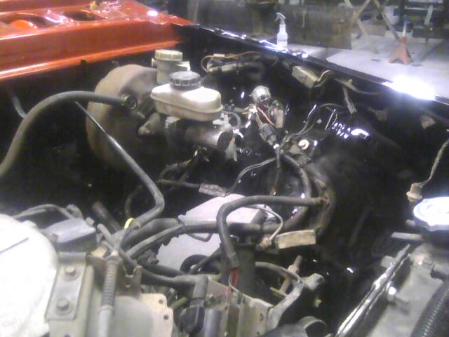

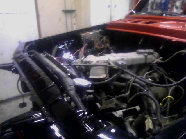

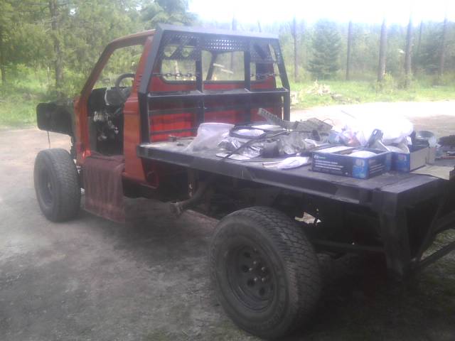

Well spent $130 on brakes my rears all new, drum to backing plate! 8) there bled and working great!!! ran it for more than a hour the other day to see how hot i could get it, it got a little hot but put the fan in front of it and it ran cool! :D I really need to start on the cab wiring and get that done!

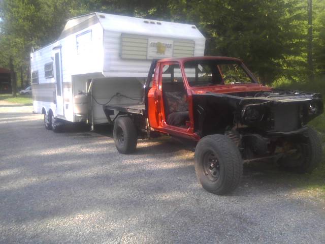

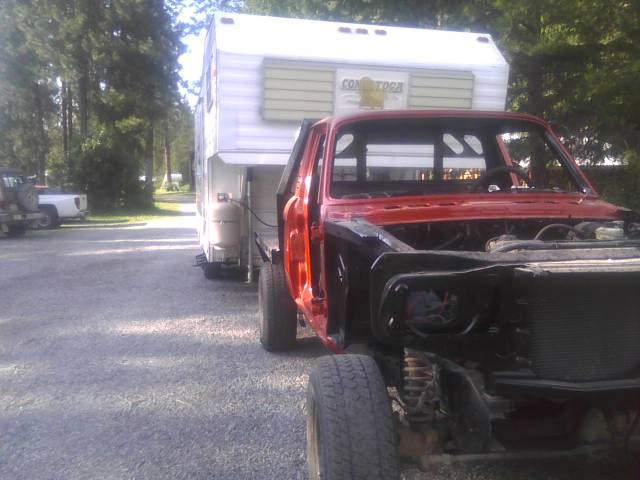

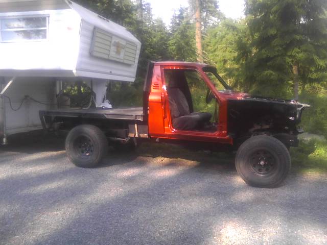

Well its been a while since i posted anything. havent got anything done! But i had to move my camper so i could move it today, and my foks had the dodge. So my luv got to pull my camper over to the shop! No problems what so ever! (Its been 3 weeks since i started it last to)
