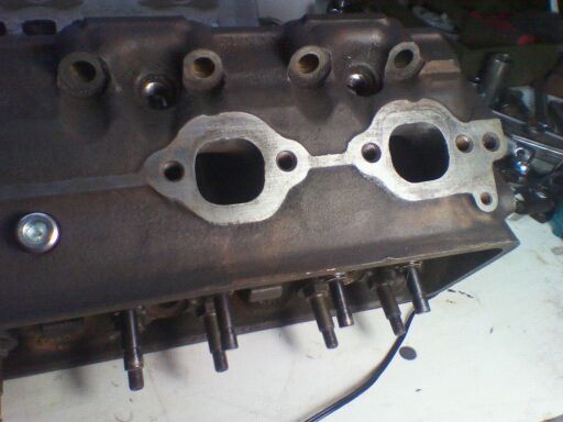

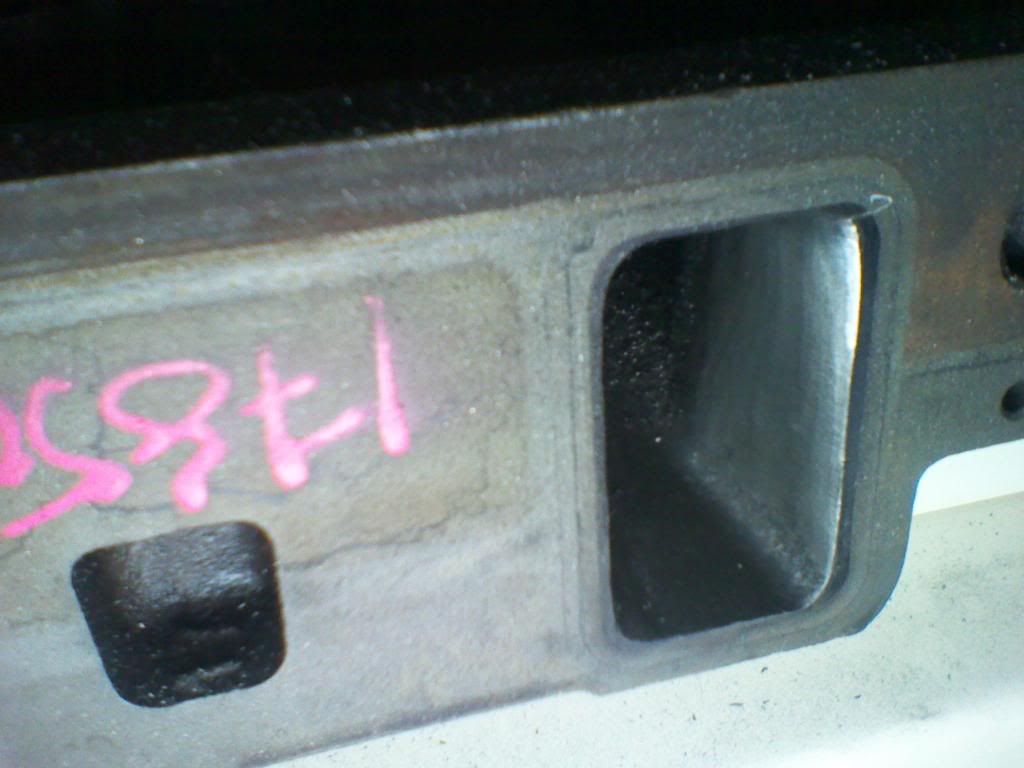

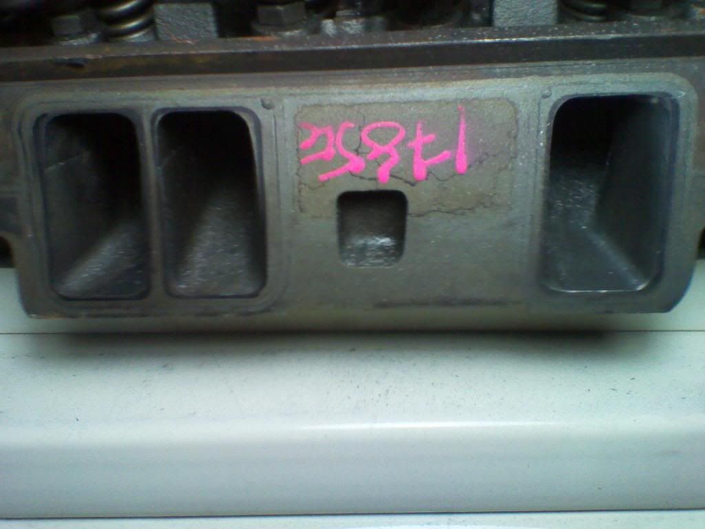

figured while im opening boxes and getting ready to assemble I will show some of the difference between the 91 (grey) and 97 (blk/blu) heads on the intake side
with the tops of the port lined up there is a lot more open area on the 97 gasket, port width is the same but you would have to grind the 91 heads down paper thin to get as much port volume
also the 91 heads have 6 bolts per head holding them to the intake manifold, and the 97's have 4 at a different angle. the 91 bolts are about 90* to the head while the 97 is closer to 45* I had a pic but photobucket isn't working right so I will upload it later.

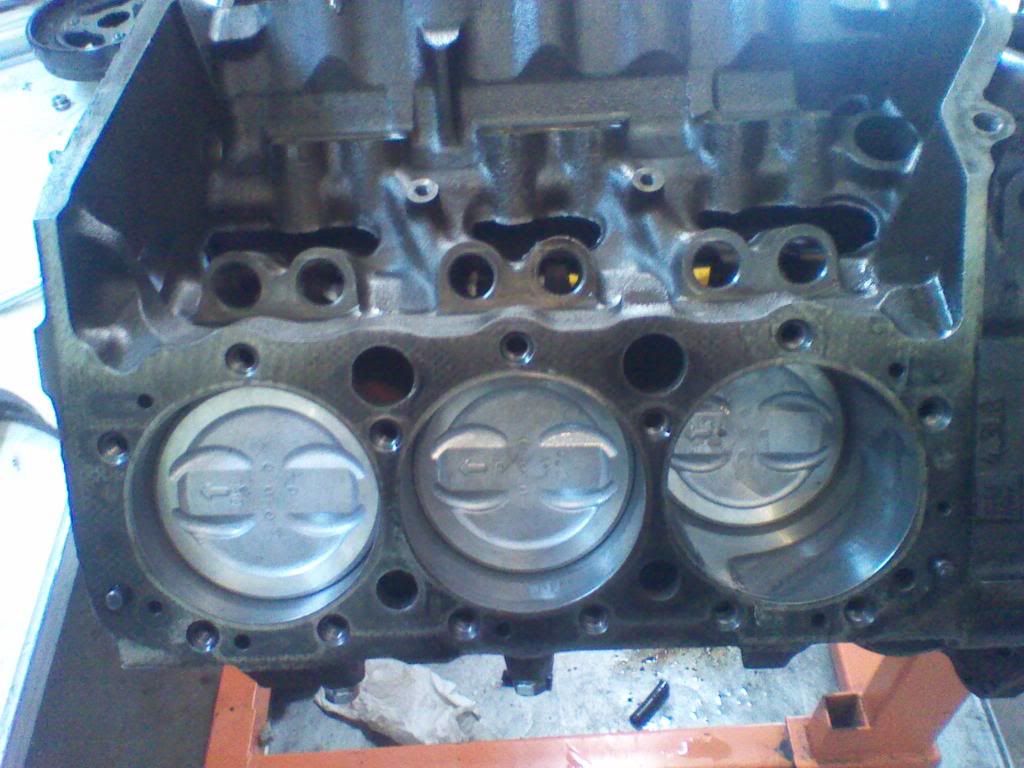

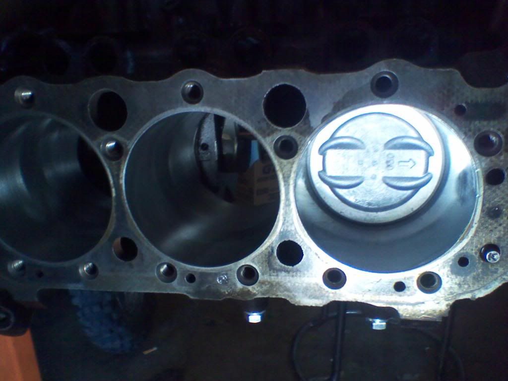

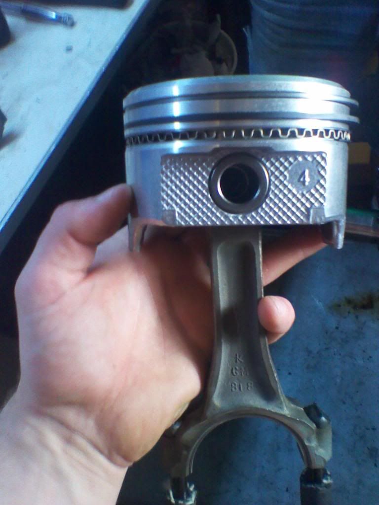

got the rings all installed
one piston installed, ring gap checked perfect recommended .016 and .015
got them all in, torqued down.. used a very generous amount of assembly lube on all the bearings, got a 10oz tube so I have plenty :lol: oiled the cylinders, next step im putting the cam and timing set in, dropping in the lifters and will have the heads ready to go by the time I get the valve springs and retainers Wednesday or Thursday

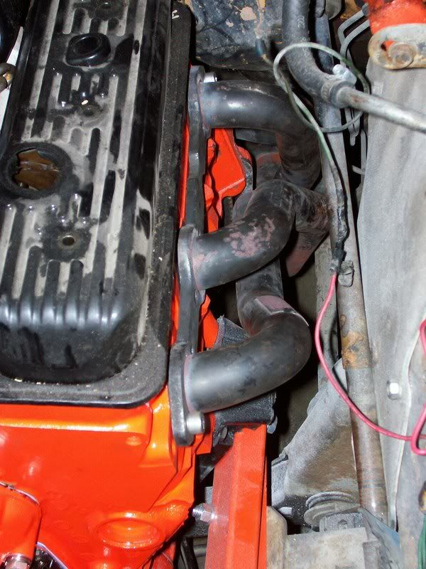

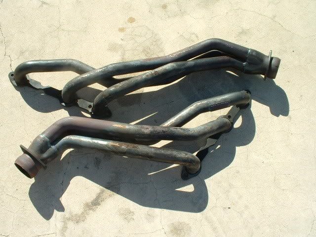

If you need headers theirs are the ones i used on my luv 4.3l v6.
http://www.summitracing.com/parts/hed-6 ... refilter=1
PostPosted: Wed Jul 31, 2013 1:30 pm
those look like they fit great. and they barely cost more than the pacesetter shorty headers.
I was going to go with the shortys because I wasn't sure if any long tubes would fit without hacking or hammering, I will have to see if they make the same ones for the 96+ heads

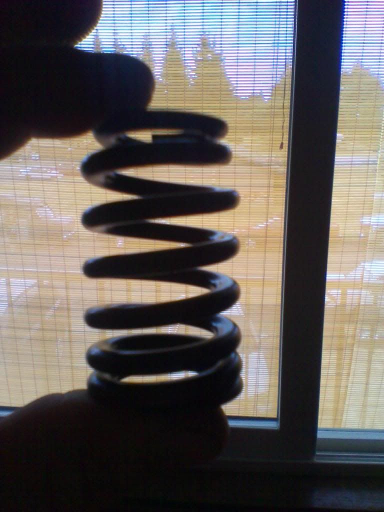

got my valve springs today, got a set of 16 for a bit less than compcams wants for their springs. these are the stock springs for the ls2, ls3 and ls9, they also fit the ls6 but are stiffer than the stock springs. im assuming these fit the vortec v8 heads the same as they do my v6 heads
these are progressive rate springs, easier to start opening, little less friction little less wear

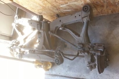

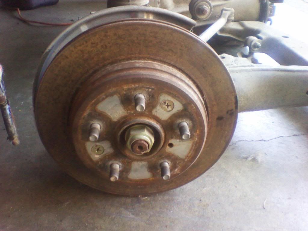

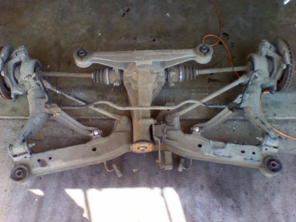

picked up my 87 rx7 rear end
lug pattern is a 5x114.3 = 5x4.5" found a set of wheels spacer/adapters to match the rear bolt pattern and get to the same width at the rx7 56.5" the front will be 56 3/4" vs stock 52 3/4 so I can find matching wheels with the right offset to clear on both ends.

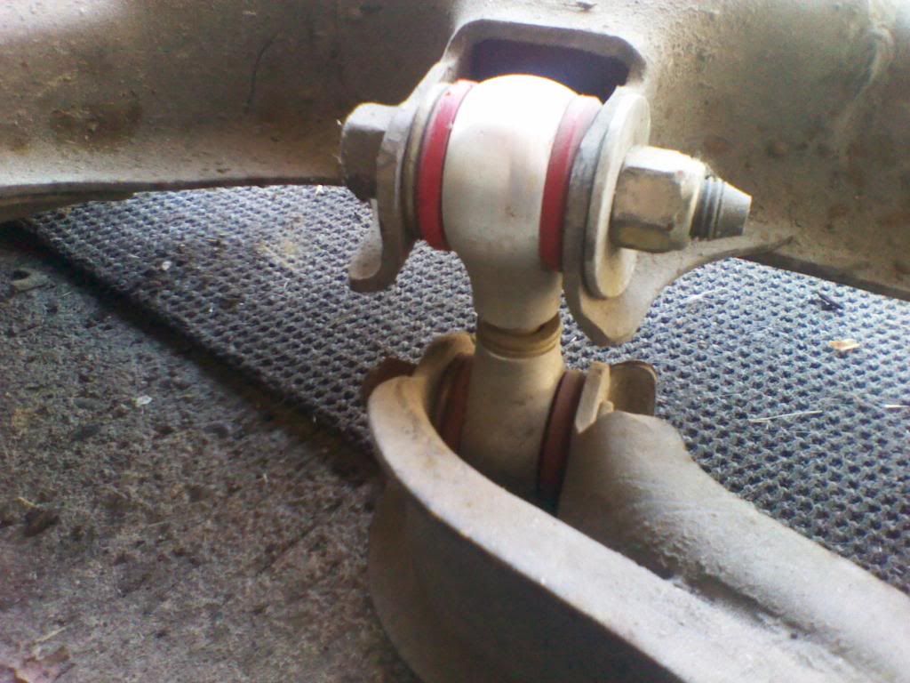

the whole assembly. I have everything but the calipers and I will order a set from rockauto with new hardware and calipers in the near future. its basically a triangulated 3 link on each side with a little baby sway bar.
even has aftermarket links worth what I paid for the whole rear :lol:

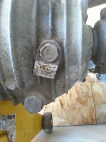

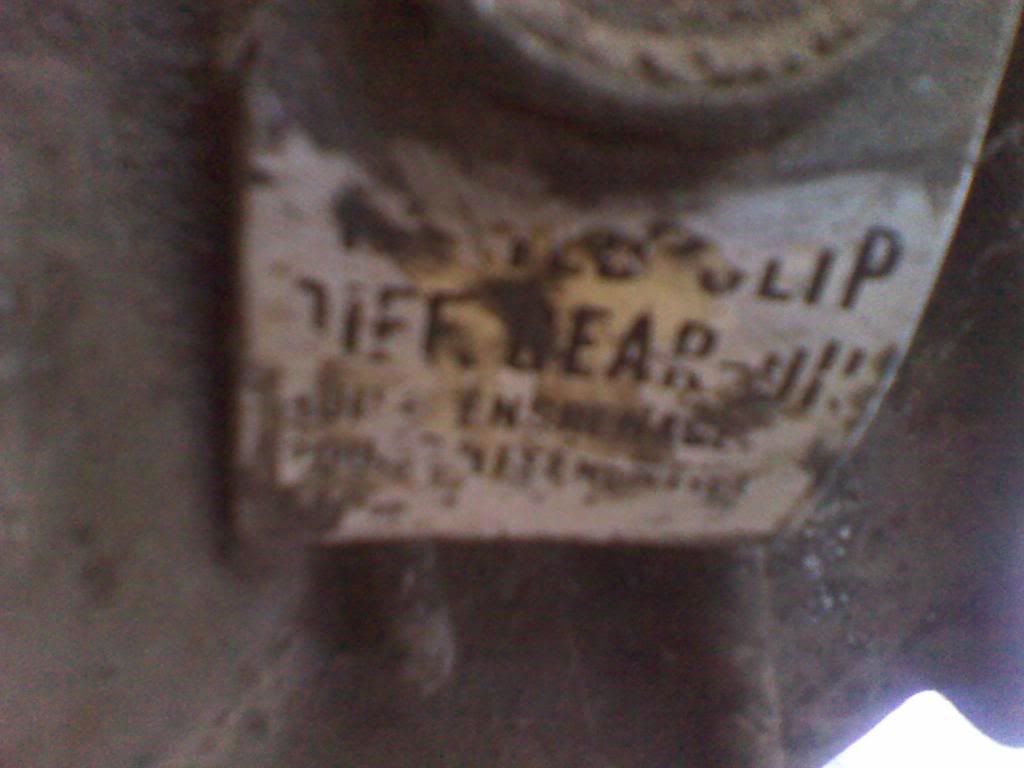

still nearly impossible to read but this is limited slip and 4.10, requires a special 90w fluid for clutch type lsd's which im going to change frequently and hopefully it will survive a lil while longer

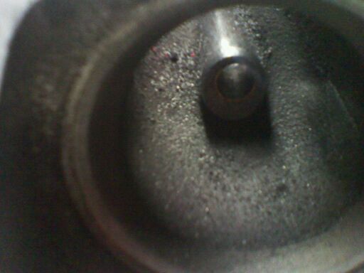

got my new intake/exhaust valves, finished messing with my ports and got the new valves installed, gave them a quick spin with some find lapping compound to make sure they seal well with the ground seats, carefully block sanded the exhaust and intake manifold surfaces and the head gasket surface with some fine grit paper, this is not the recommended process for cleaning up the surfaces, but it wont hurt it to insure a smoother sealing surface
few pics
not sure if this is common practice or what but I got anal about details and beveled the edge of the valve guide towers (pic was before final cleaning and smoothening

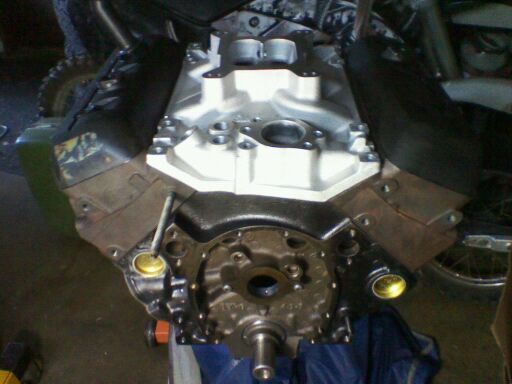

intake showed up so I had to get a quick pic, heads will be on permanently in a couple days just waiting on valve stem seals to get here.
