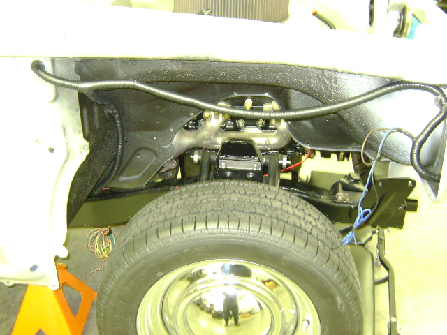

got the wiring loom done . The front end , headlights ect. ect . all done and the loom to the back lights , done . and still cant see wirers under the hood .

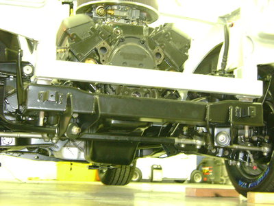

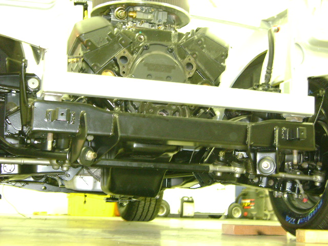

Looks like a custom centerlink in your suspension, where did that come from and why did you go that route?Any other front suspension upgrades or changes?
 Post subject: Re: Norms 75 luv build
PostPosted: Mon Jan 02, 2012 10:04 am
Posts: 158
Location: cental point oregon

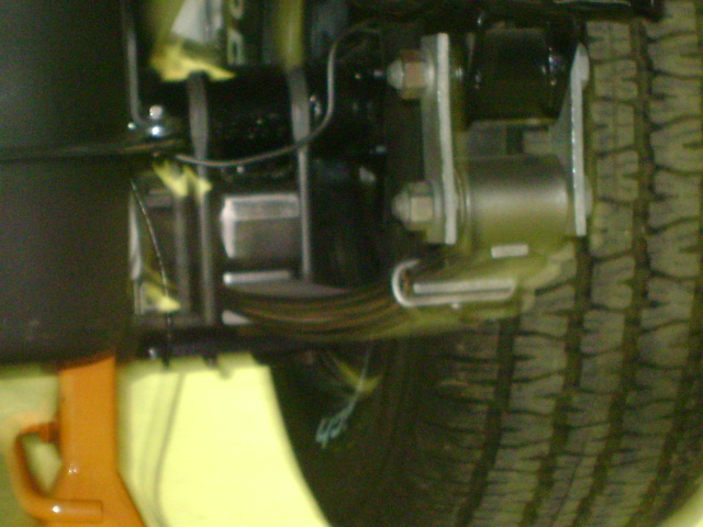

the whole front suspention and steering is stock 75 luv stuff with a 90 tropper box . the center link is just painted

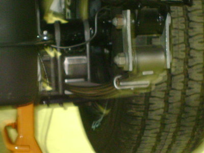

the rear i droped 2 in. and took out the overload spring to get a 2.5 drop
other than that i figured why mess with a good handleing truck , just softened it up alittle in the back .

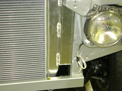

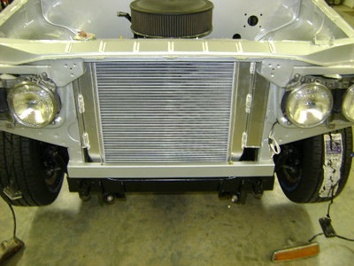

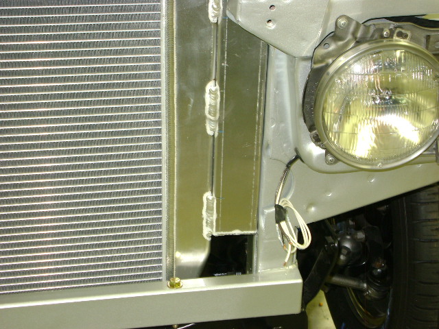

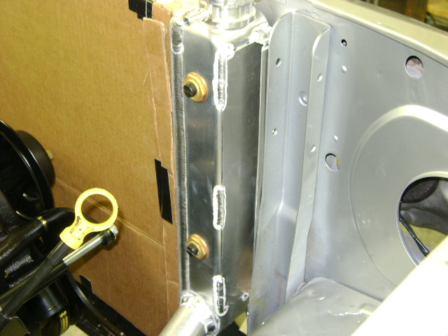

rad is fitted and heading to the welder to get tabs welded on

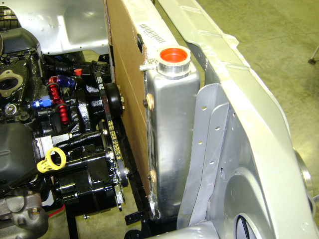

well got the radiator mounts made

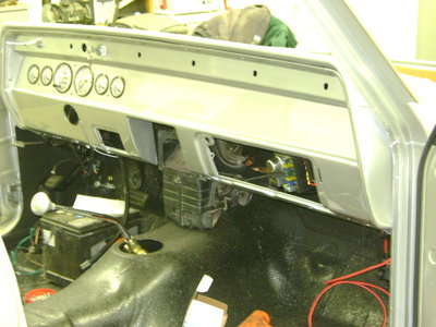

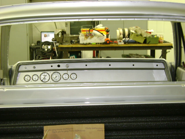

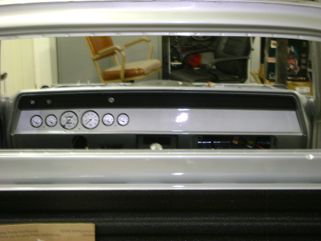

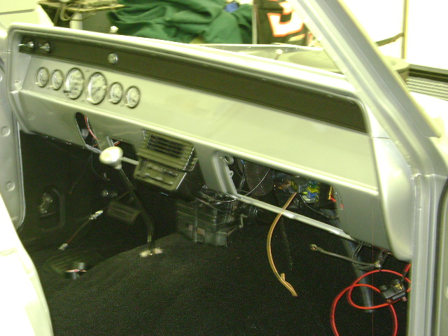

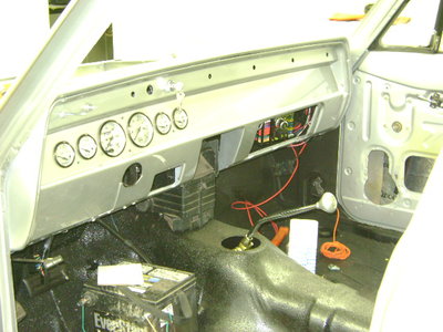

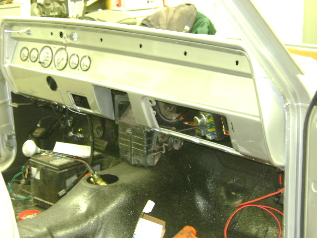

first fit of the dash . fits preety good

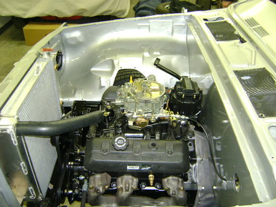

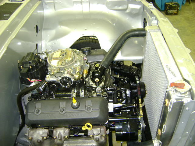

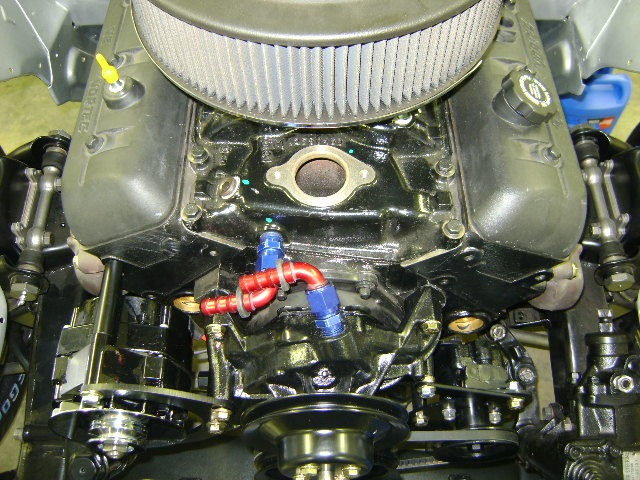

well a littel more done on the luv . carb on distributor in oil primed and dipsticks shortened .
oh yes the moter is all wired and ready to go . but you cant find the wires .

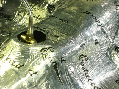

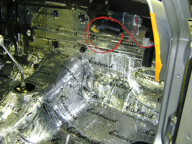

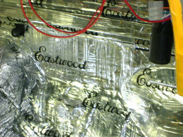

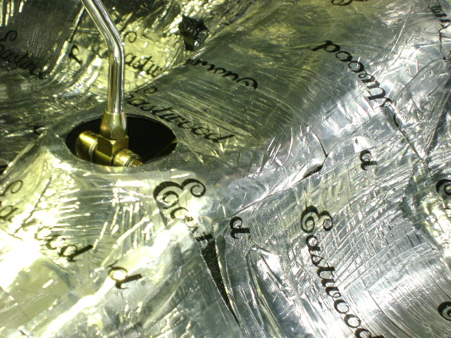

did a littel work on the sound deading today

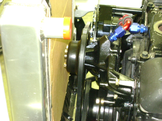

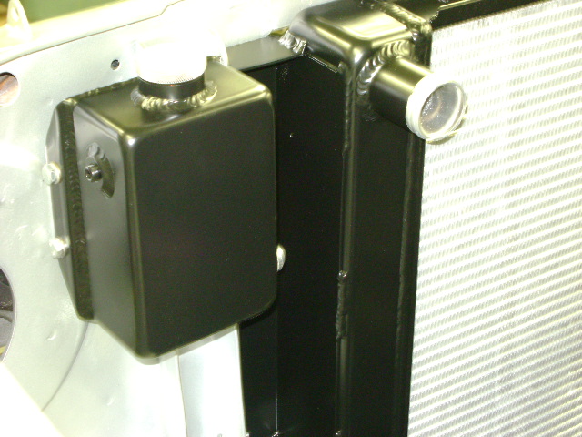

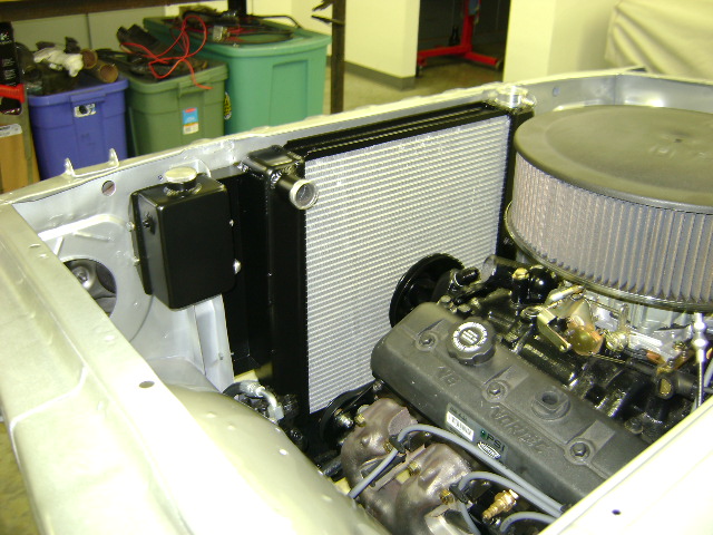

did somthing a littel diffren t to the rad . powder coated the tanks only .

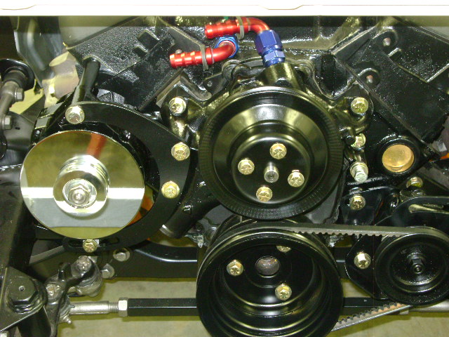

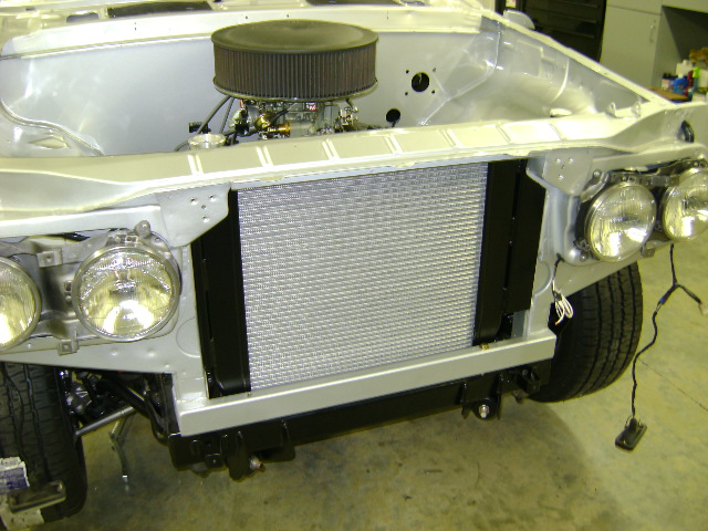

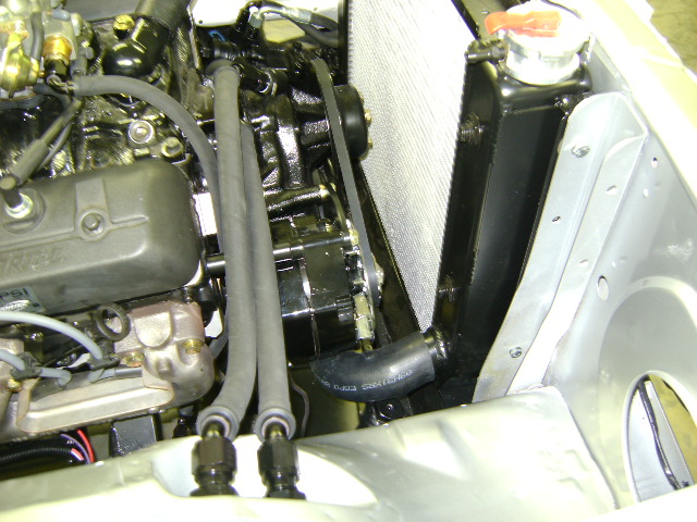

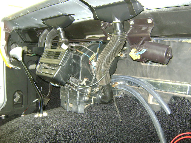

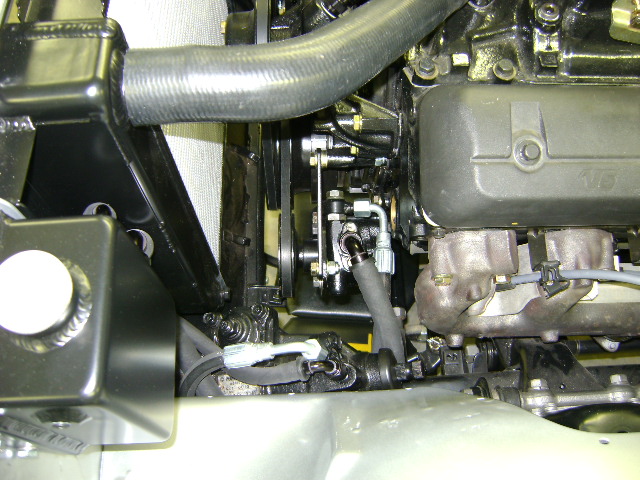

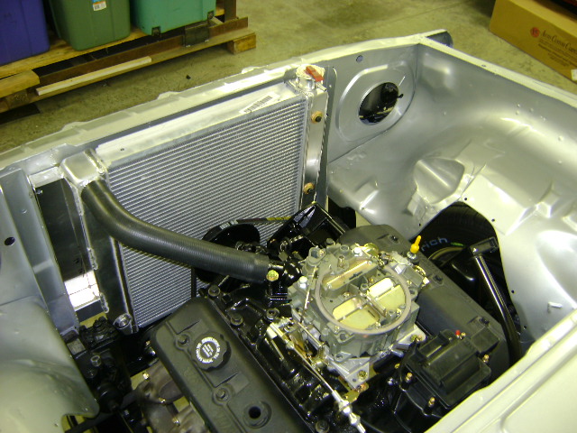

power steering pump brackets and hoses in and done .

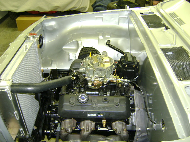

. rad is in and allmost done just need to run tranny lines
. heater defrost ducts in , i used shop vac hose ends and they fit perfectly
. tommrow well put the dash in for good and then the sterring column . the luv well go to the muffler shop wed. .
PostPosted: Sat Feb 18, 2012 6:28 pm
Posts: 158

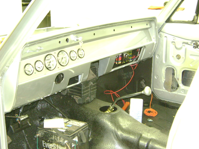

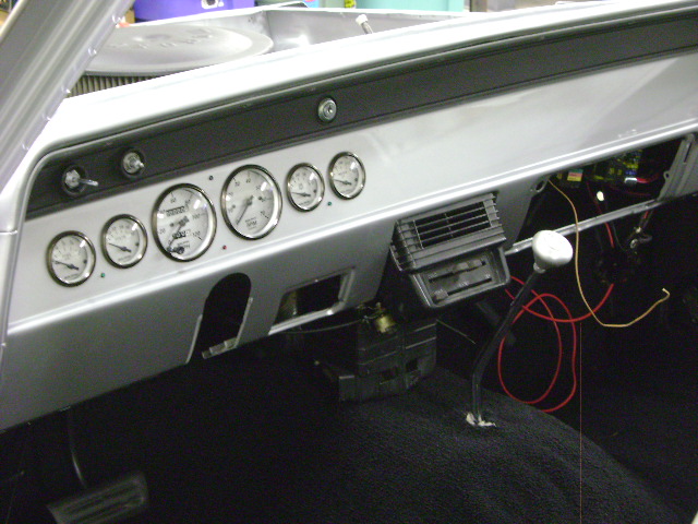

well its in for good
