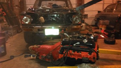

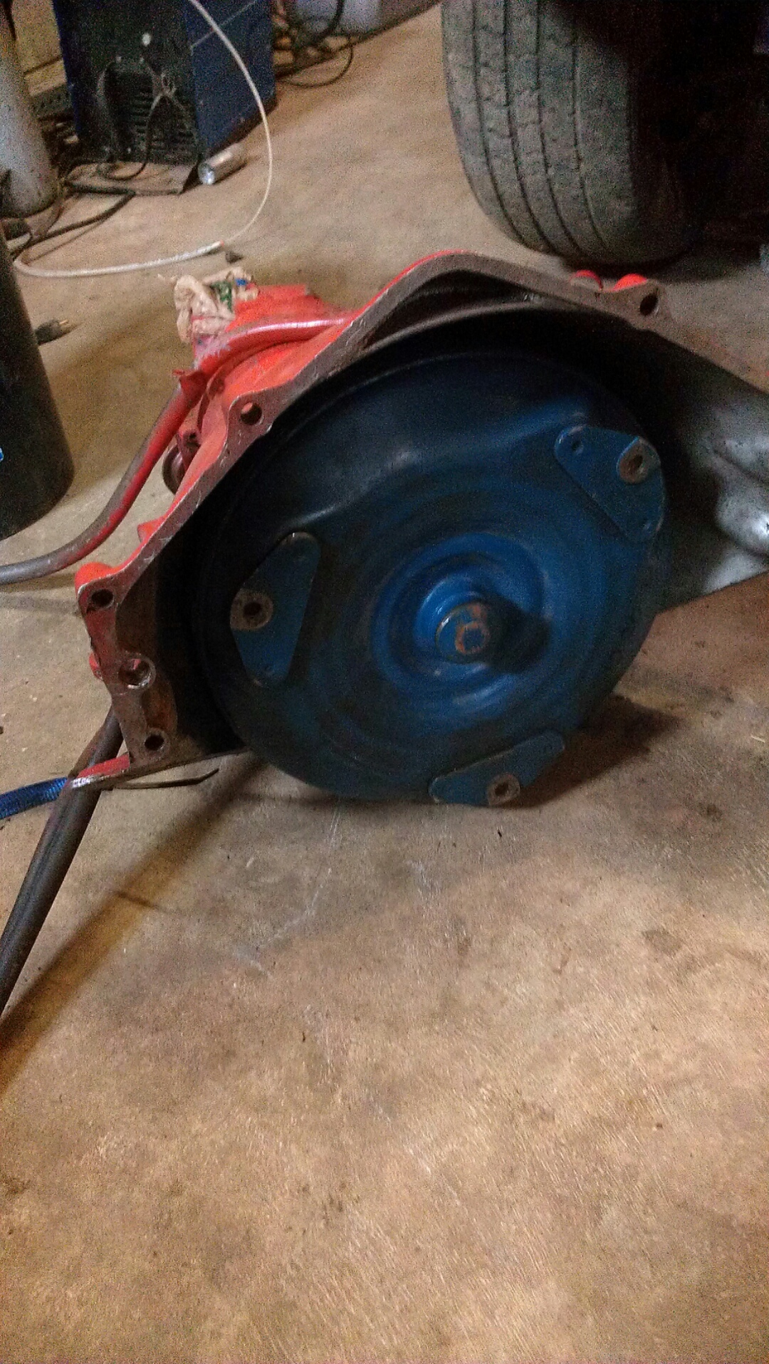

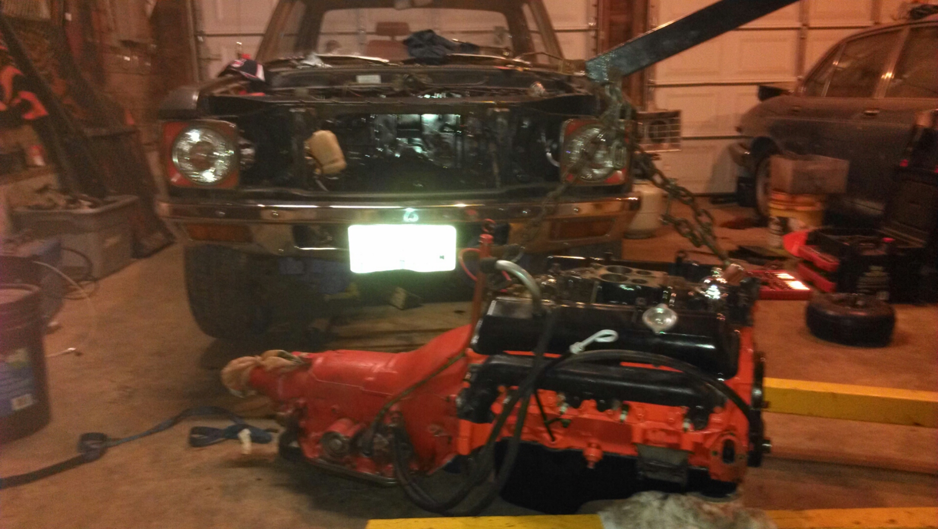

some pics.. got everything ready to go in last night but didn't have the torque converter bolts and id rather put those on now then while laying under the truck.

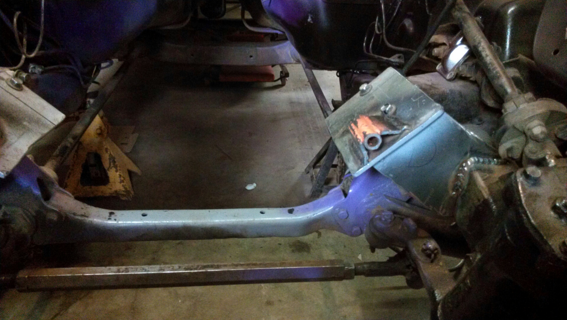

Motor and tranny are in, carb is on, driveshaft is on but still gotta bolt that down, Speedo and shifter cables hooked up. Off to oreillys again tomorrow for some engine mount bolts, and radiator hoses. Getting the driver side bolt to go through the mount was a PIA.. welded on the gussets for the mount a little crooked. I'm sure it'll be fine, might eat through motor mounts though.

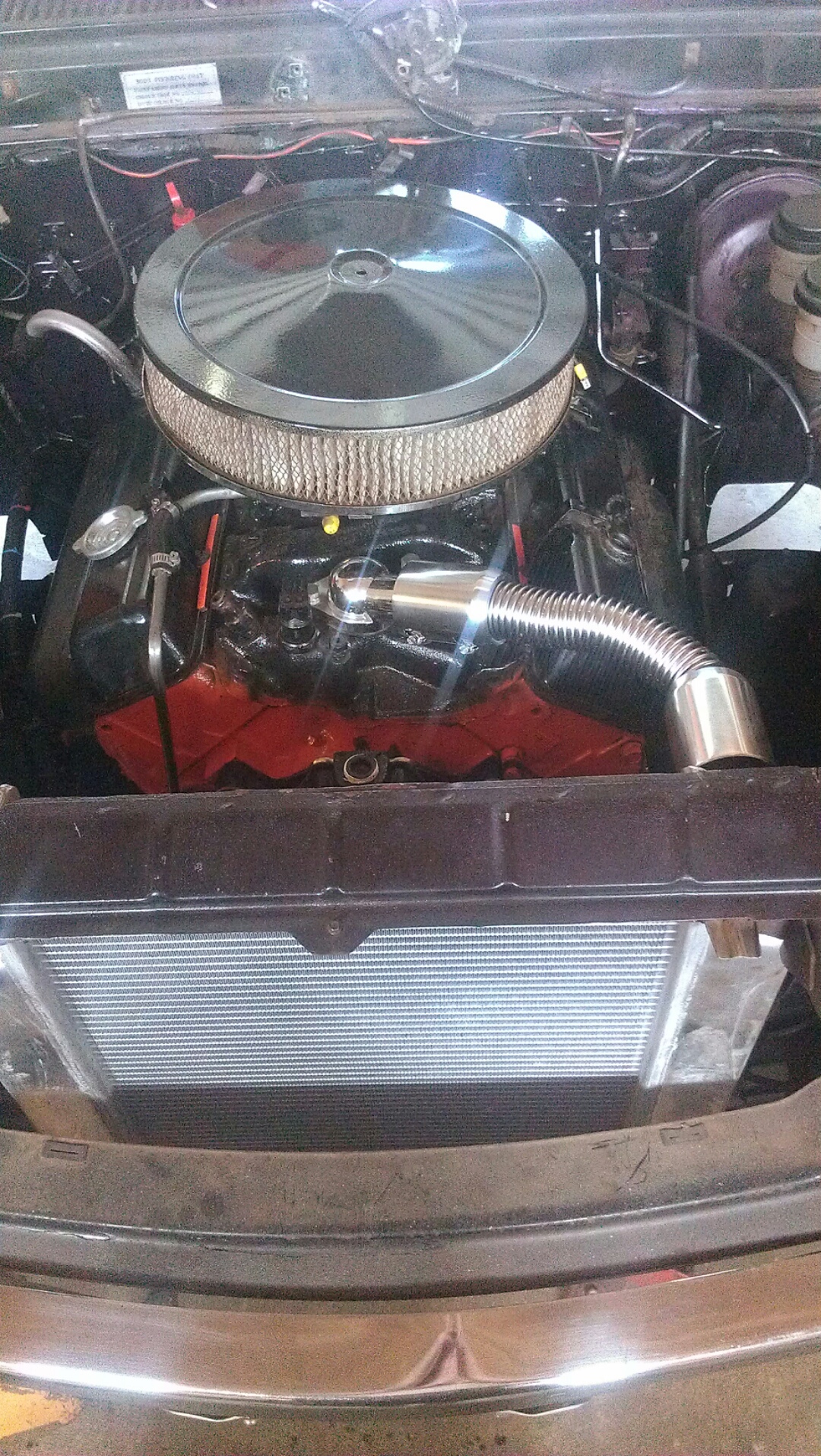

heres a pic... wish I woulda gotten the braided socks for the hoses but I couldn't find the right shade of purple or orange.
