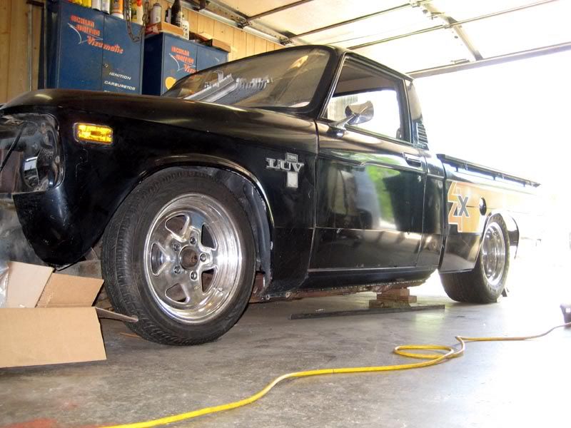

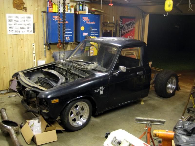

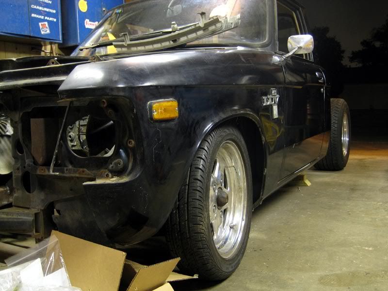

notched.. again, not finished.
 Post subject: Re: LUV II
PostPosted: Fri Apr 24, 2009 8:03 pm
Nice, I like the stance of your truck.

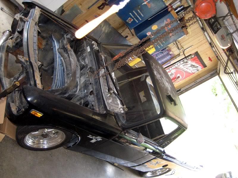

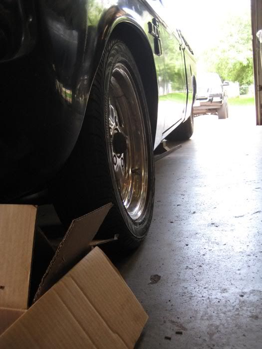

woot my cuts were good.

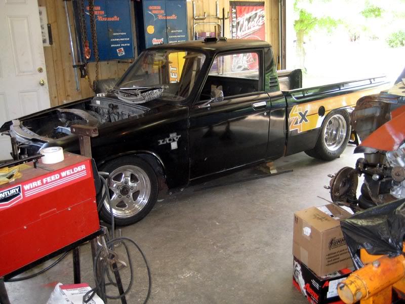

PostPosted: Sun Apr 26, 2009 1:26 pm

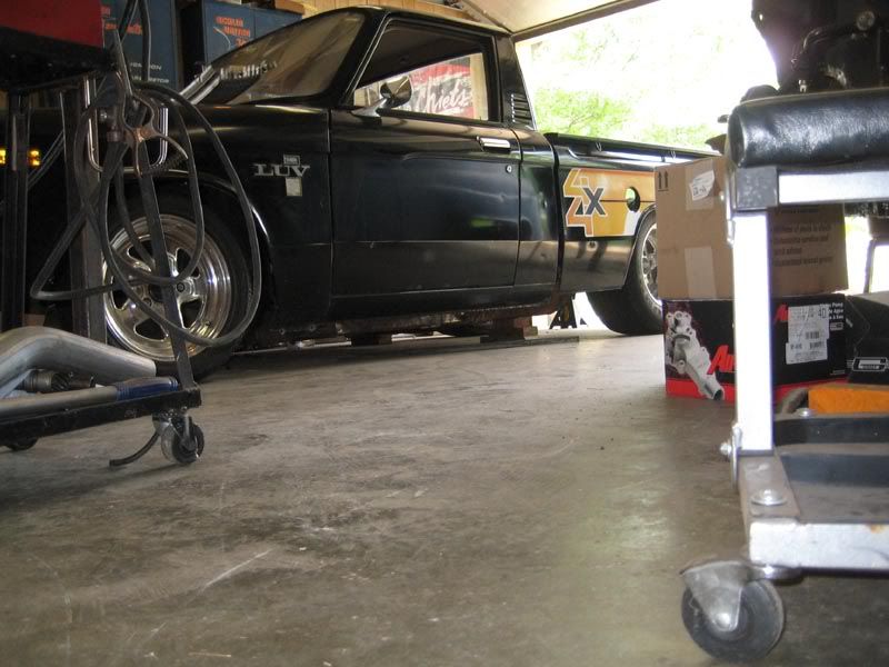

Your a liar! That's not a 4X4! :P
I'd think about leaving the decals on there. Makes people take a second look. :?
Nice truck, man.

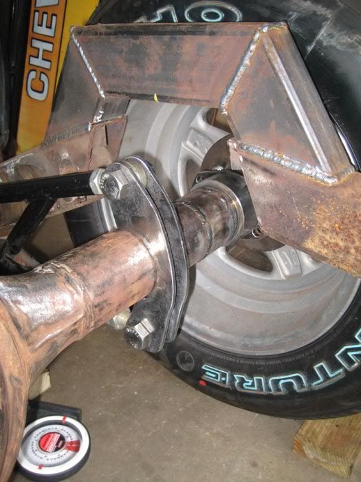

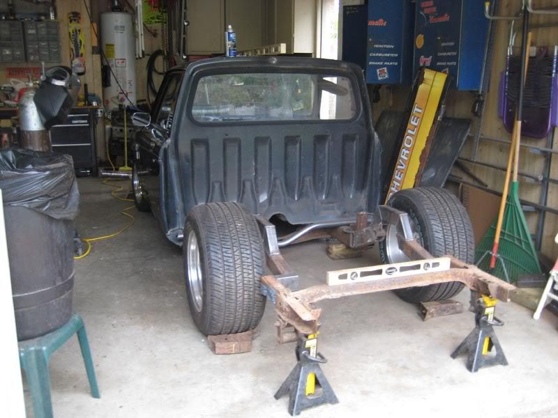

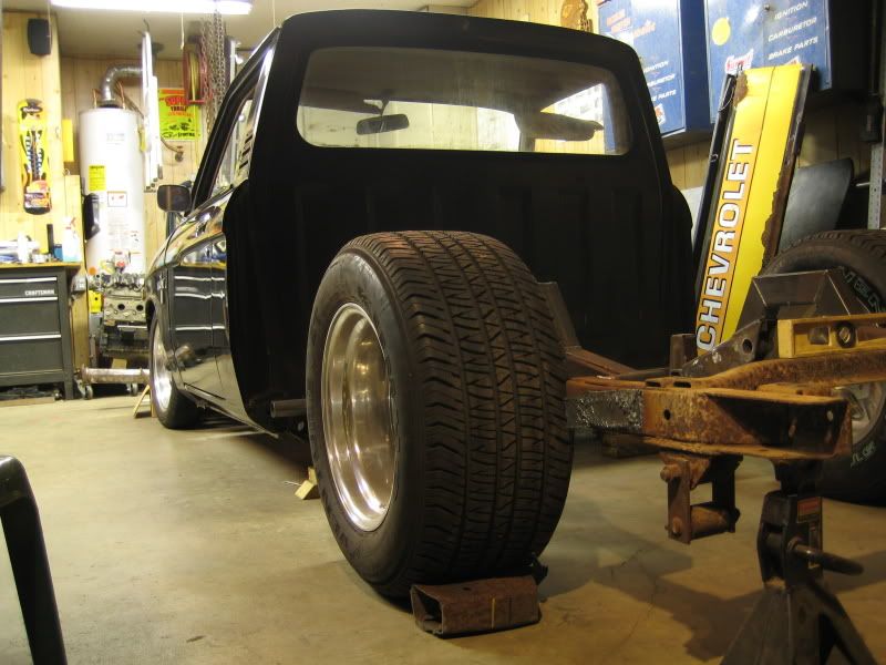

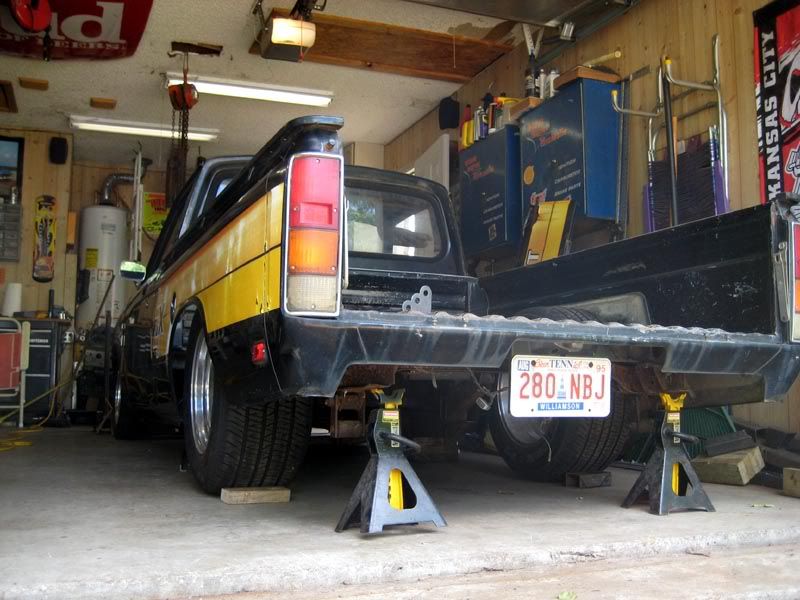

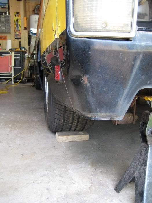

got the rear end narrowed, under the truck, started setting up the ladder bars. had to modify the axle brackets so they would push the ladder bars backs o the front crossmember wouldnt be under the truck and have to cut the cab for it. need to modify the front brackets now...
what the brackets looked like before i started

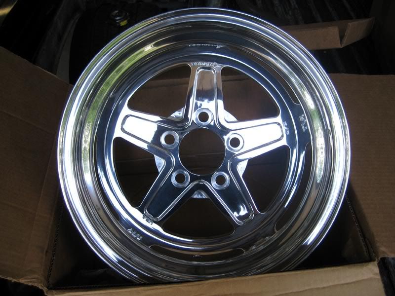

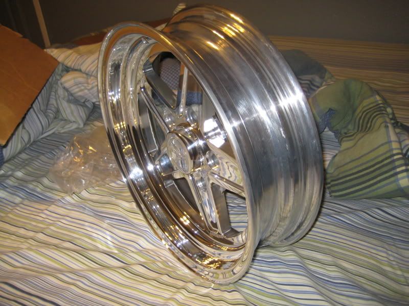

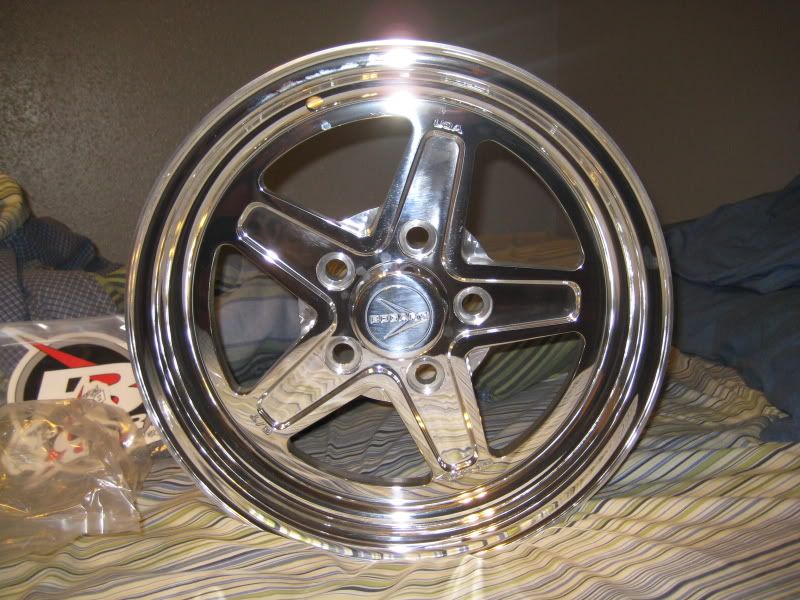

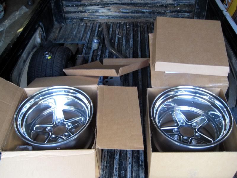

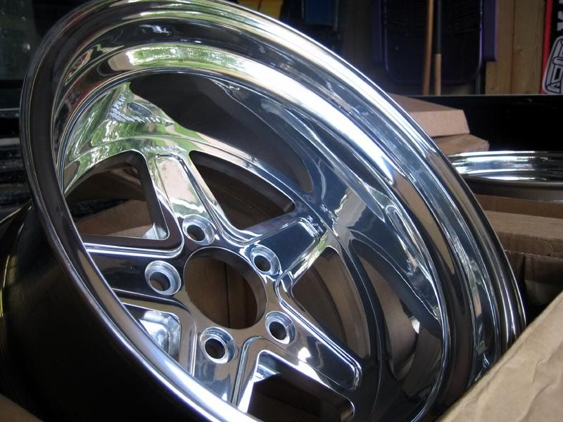

got the front wheels thursday...
