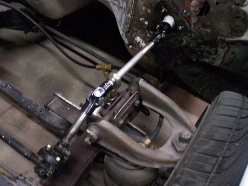

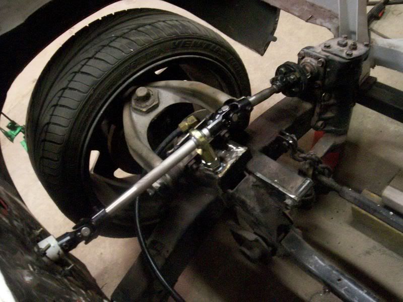

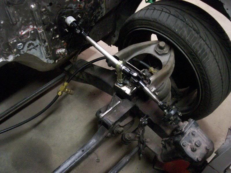

Well have been busy finishin up a customers car, and not to mention gettin sick, so I finally got my parts in for my steerin(Two 3/4" u-joints from flamingriver.com & my 3/4" heim joint) Got the steerin all taken care of. This weekend I'm blastin the frame so it can get fully welded, some more gussets, battery trays, compressor mounts, then I can finish up a little body work on the frame and then it'll be ready for paint.

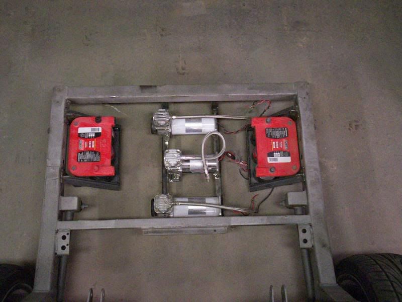

The frame is almost completely welded, but I ran outta gas. But here's some pics of the battery trays and compressor mount
Passenger side has more of a gap for the main wiring harness, just for a little extra room

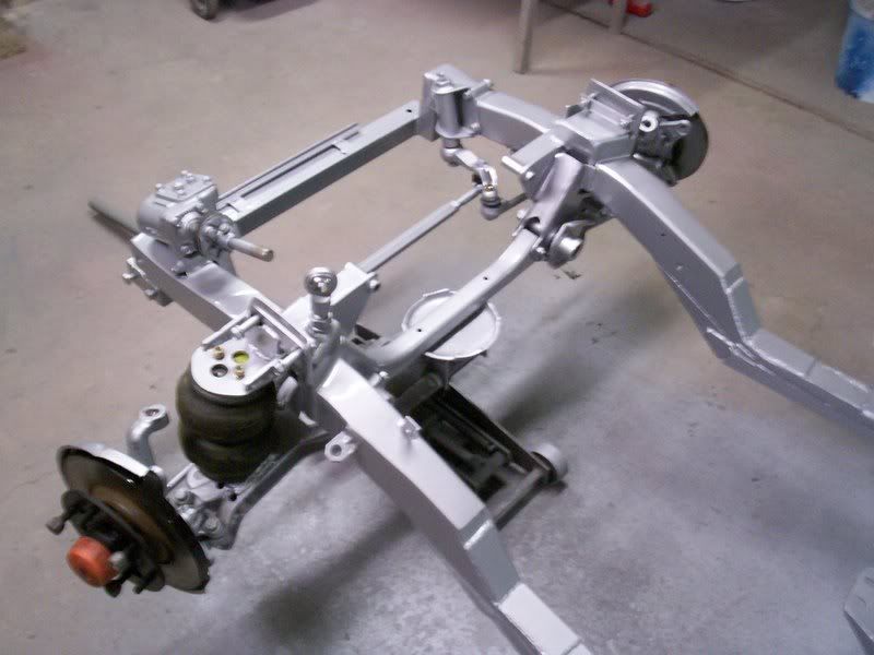

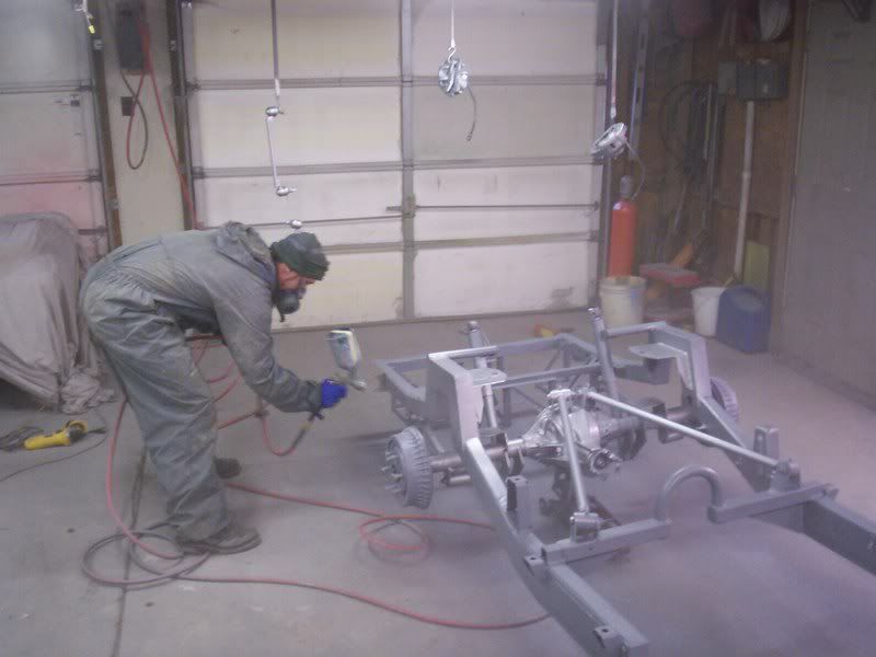

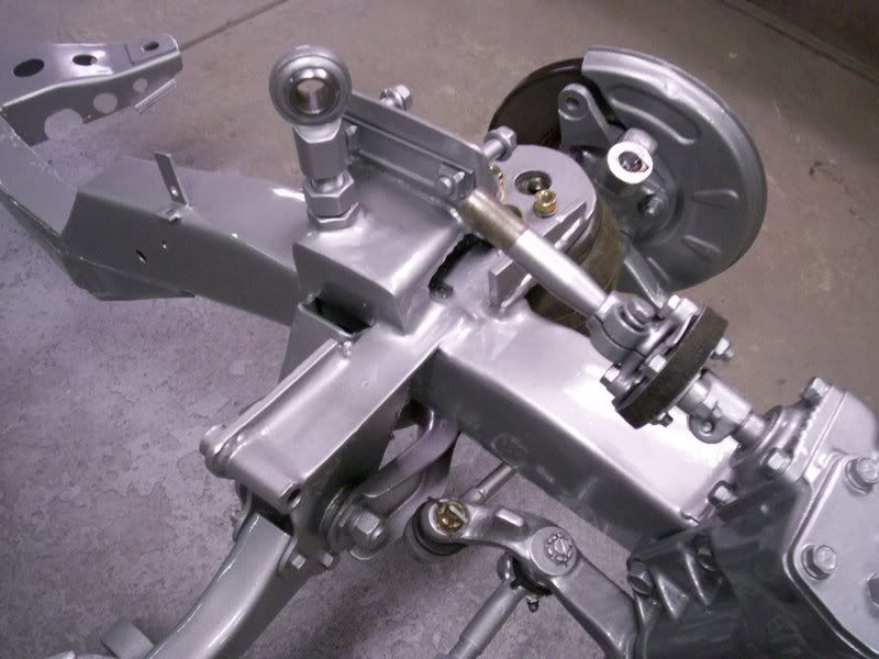

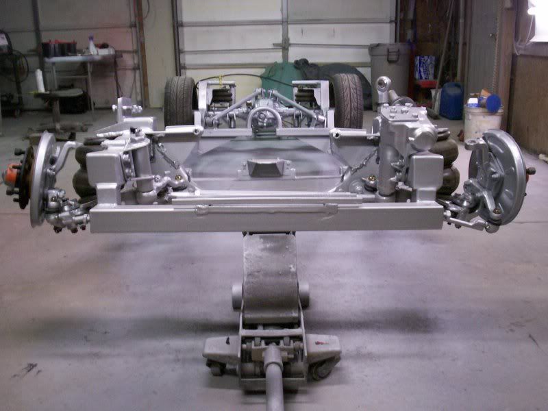

Frame is painted, I smoothed out the front clip to make the frame look nice. Puttin back together now, hopefully by tomorrow if everything goes right the frame will be completely back together, then I'll run my airline, and valves, so I can have a rollin chassis, also got my license plate, sick of people last year tellin me, "nice s10"
Me paintin up the frame

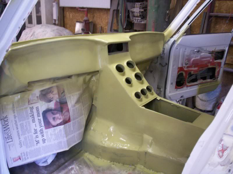

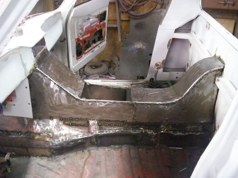

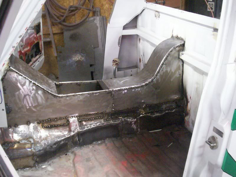

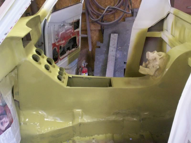

Gotta get my interior finished by next weekend so my air brush guy can come out and work his magic. Here's a few pics of the center console that flows right w/my dash, and the tunnel sectioned and raised up. The piece missin in the console is a removable piece for my shifter, and wires for switches

Here's a teaser pic of the dash/console, I have removable panels for the back to extend the console underneath the dash, I molded in my bezel from my B&M shifter so I can use the chrome bezel(which is the piece that is missin), the gauges are placed slightly at an angle towards me when I'm drivin which wasn't fun doin the body work, lol
