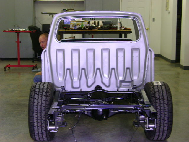

no its one that we made to fit out of 18 ga. cold roll sheet metal and had a friend put some beads in it for strenth

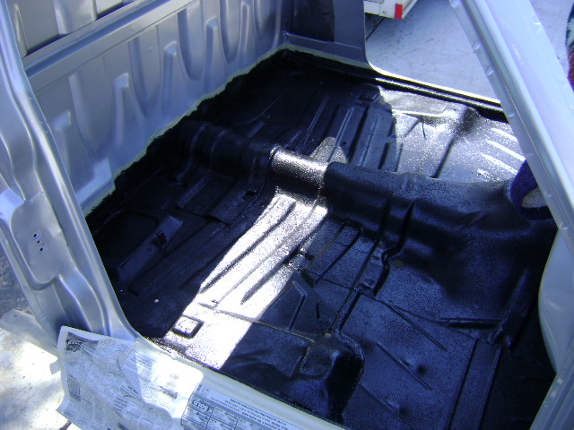

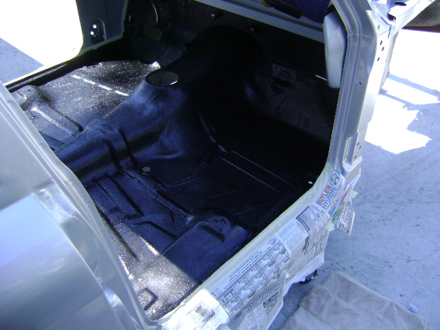

how the floor is sealed top and bottom . there well be no more rust ever . used por 15 then herculiner on the inside of the cab and por15 and ruberized undercoating on the bottom

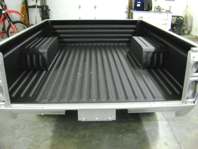

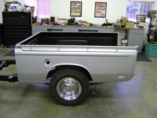

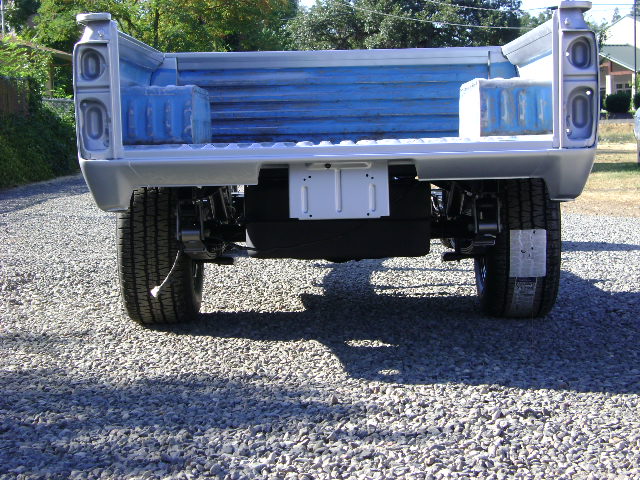

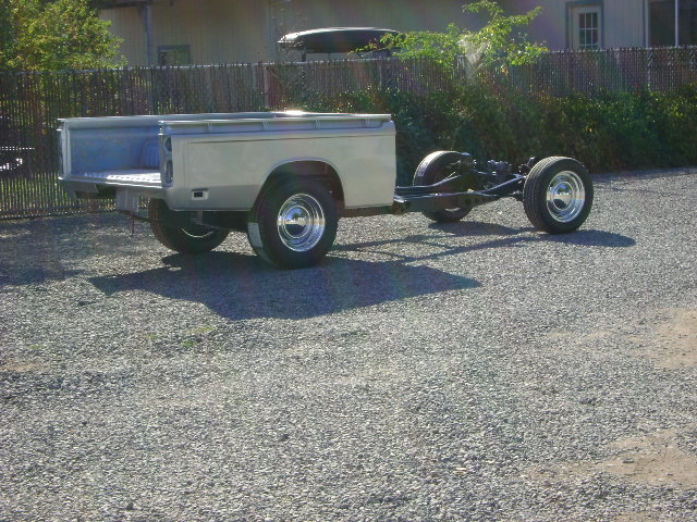

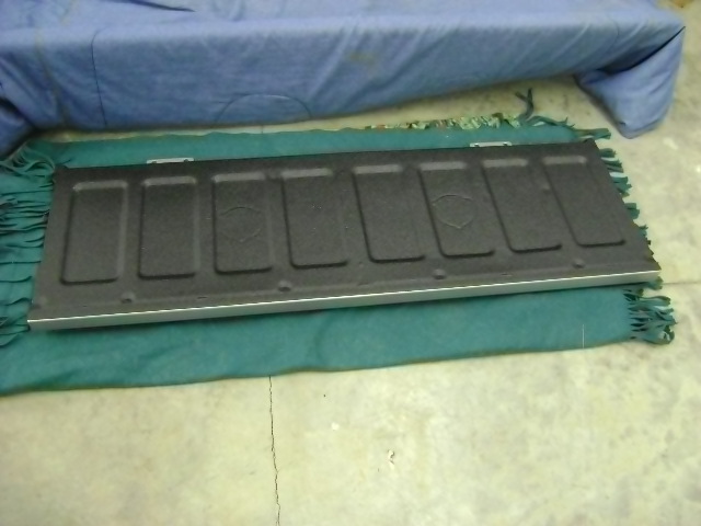

got the bed ready to go to linex on monday.

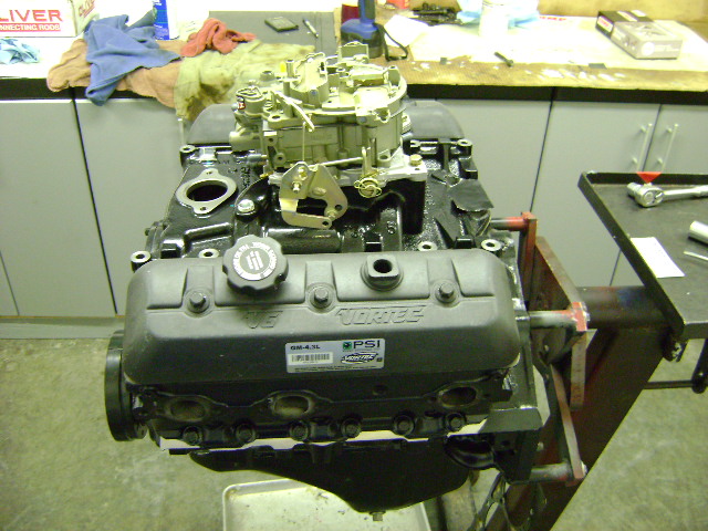

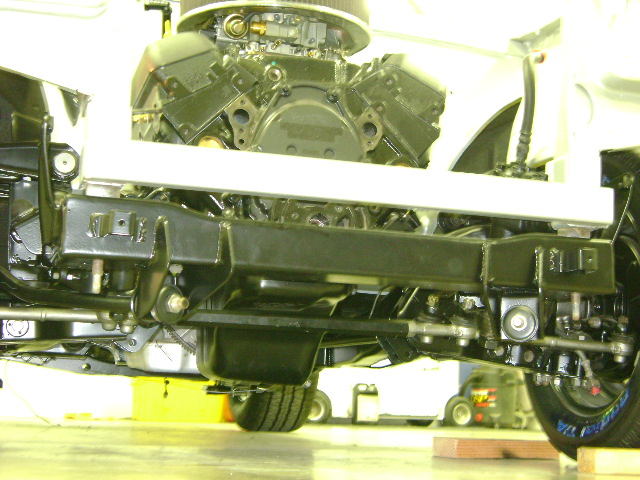

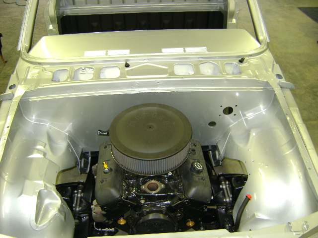

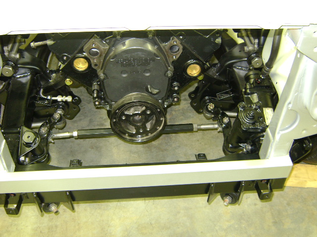

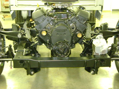

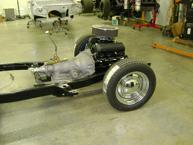

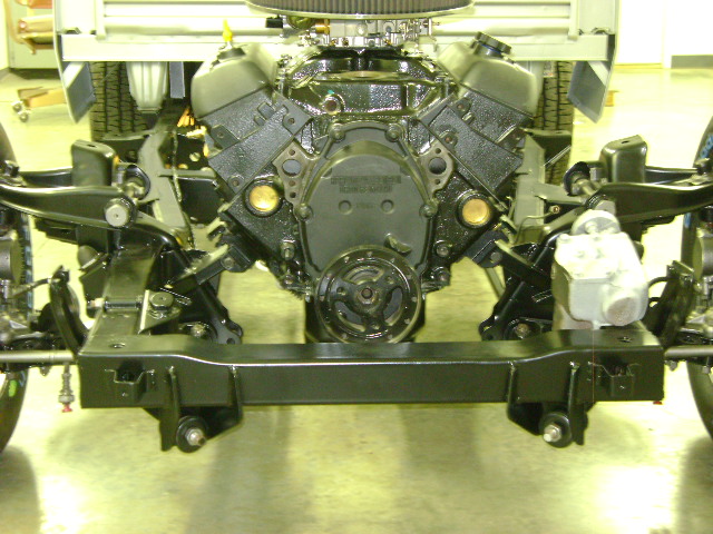

the motor is done
 Post subject: Re: Norms 75 luv build
PostPosted: Sat Aug 27, 2011 1:47 pm
Posts: 158
Location: cental point oregon

not yet maybe next week . still have to run the fuel line and finish the tank mounts .got the bed linex,ed today looks great

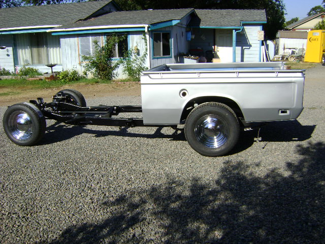

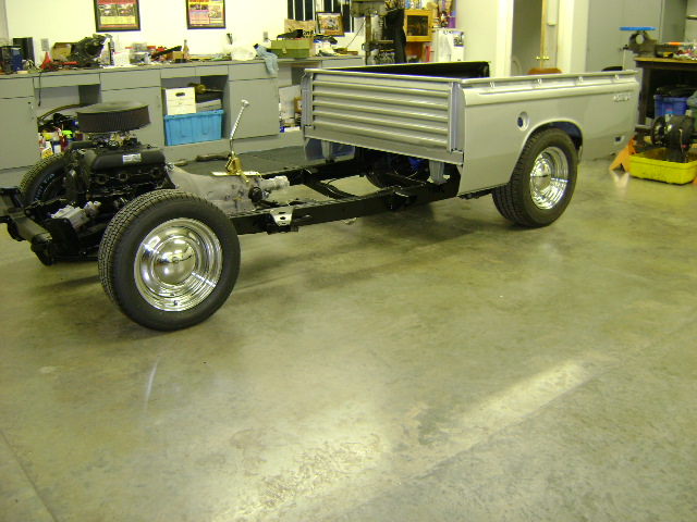

got a little done on the truck today
PostPosted: Sat Sep 03, 2011 9:53 pm
Posts: 158

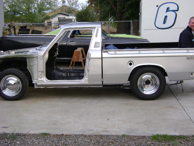

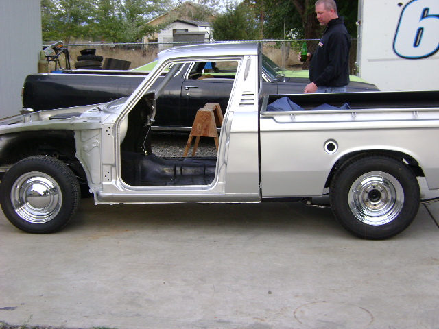

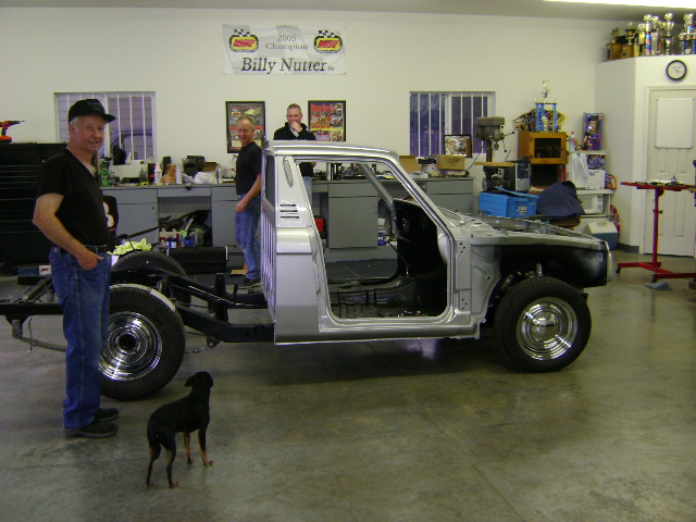

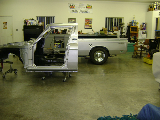

well its been awhile and now that racing is done for the year we got to work on the luv . put the cab on today .

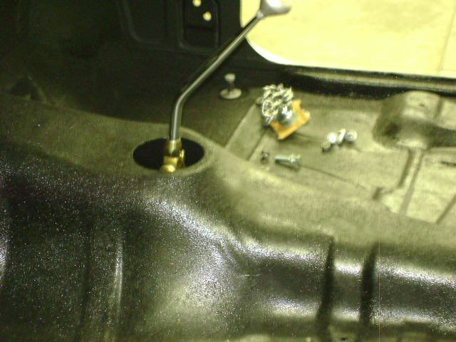

lokar shifter for the 700r4 . i think it looks like a standard shifterand i think that it looks cool.
here is the happy owner and his dog pee wee.

Very nice truck. I like that shifter through the stock hole.

thats what we thought to . walking by it looks like stock 4 speed , but its really hooked to 300 hp v6 and a 700r4 , sleeper .

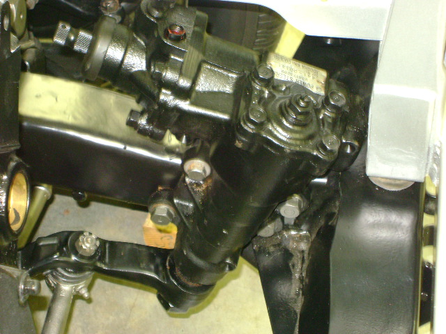

well there it is , the easyest way i could find to power steering .
this is a 1990 tropper 4x4 steering box then cut end of the pittman arm and added it to the 1975 pittman arm and power steering
