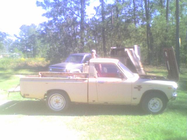

alright im startin athread for my build i should have a good bit of pix up to night of the build so far..heres the start of the build a lil while after i first got it
