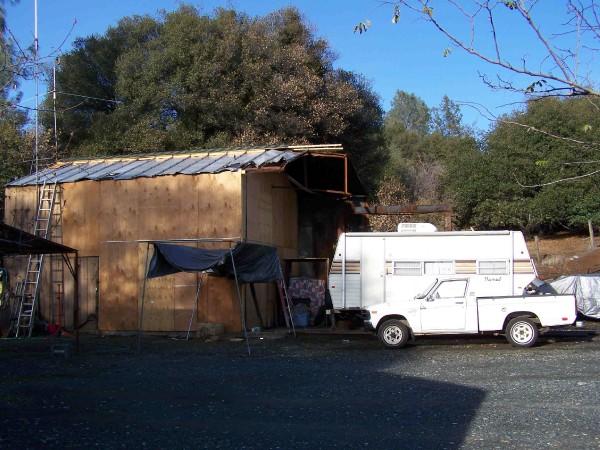

PostPosted: Sun Dec 06, 2009 4:08 pm
Posts: 518
Location: Sonora, CA
12ft are nice... unless you wanna keep it warm...
Then it bites.
lol, there still isn't room for arcade games
