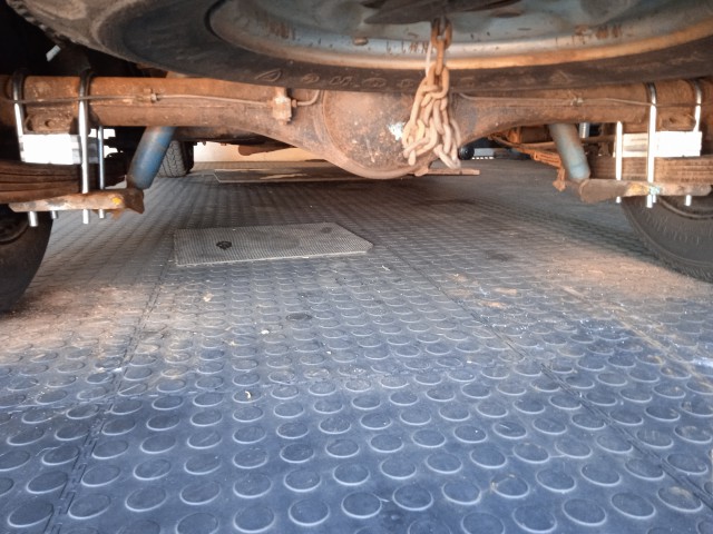

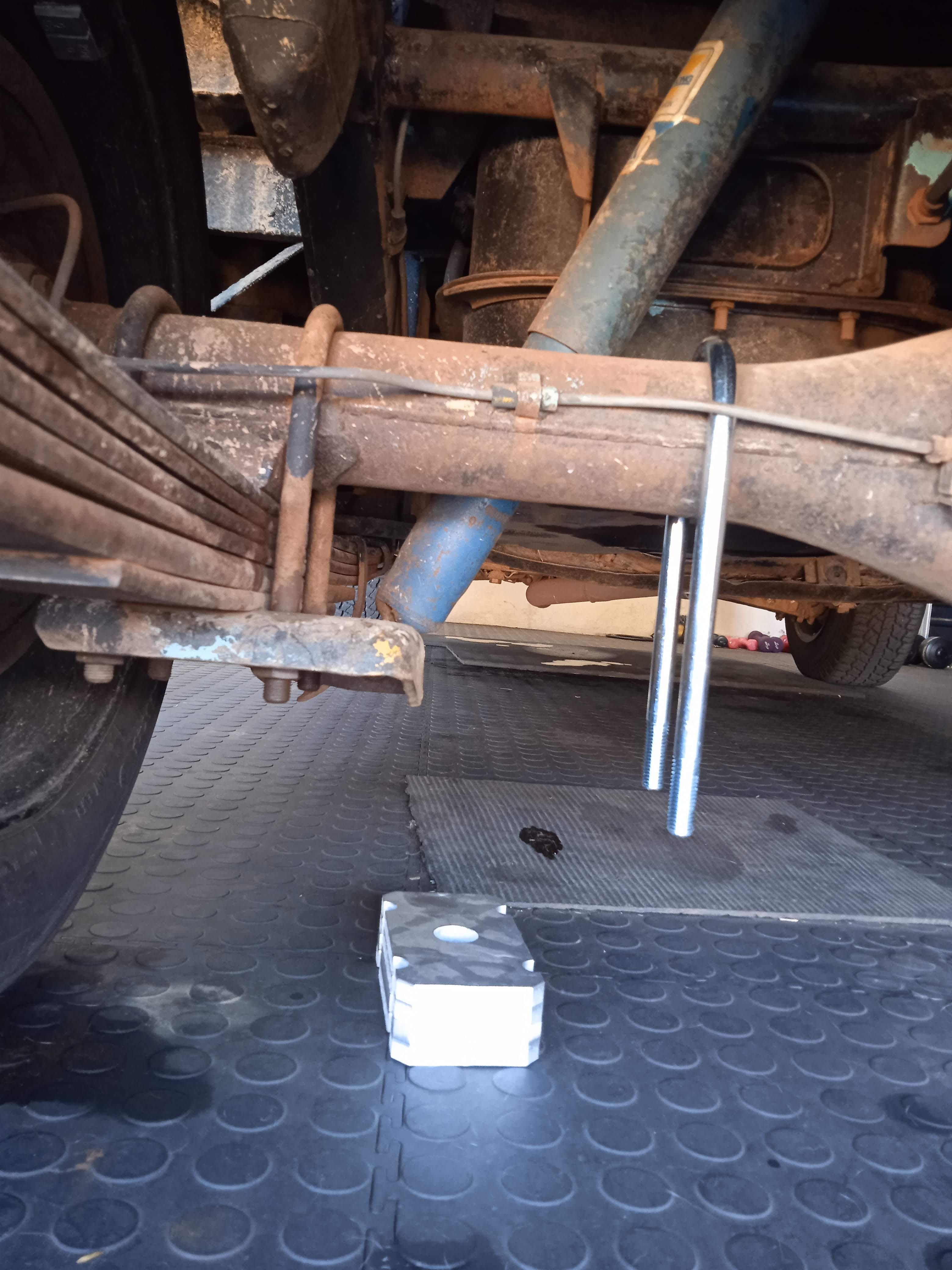

Finally, after many years there is an update.
I had u-bolt made as I could not purchase any my size to have fit. Cost was about $30 for all four.
File comment: Testing where what fits
File comment: mmmm, the look of new metal
File comment: Final look

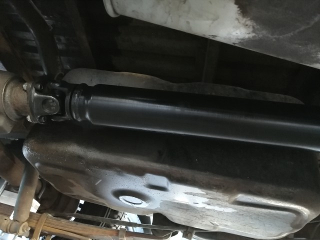

As time goes on, more and more old parts need refurbishment. The drive shaft needed fixing before the whole truck gets shafted.
Quick and easy to the local prop-shaft specialist, and $100 later, I have a nice shiny shaft!
File comment: Everyone likes a big shaft!

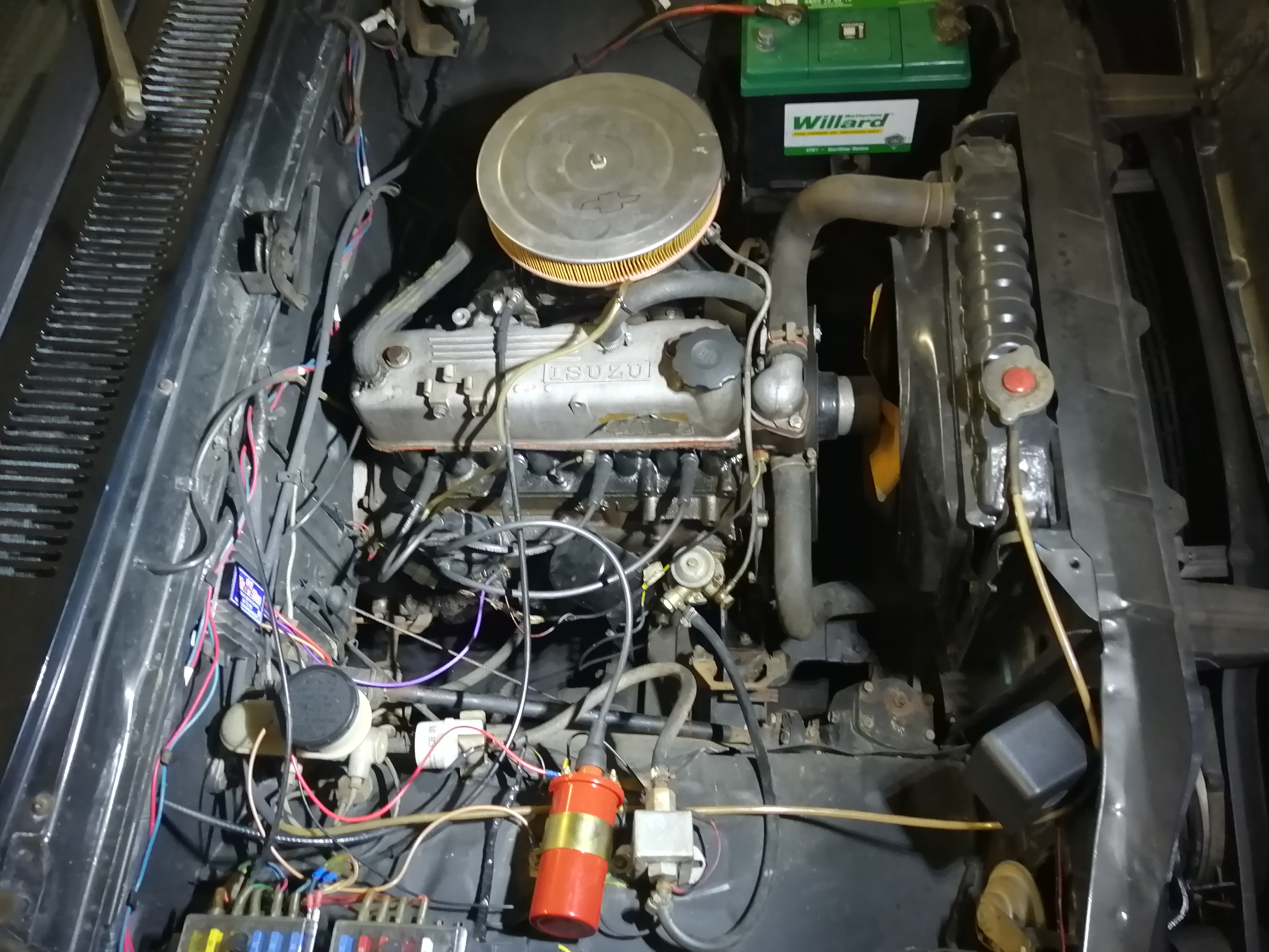

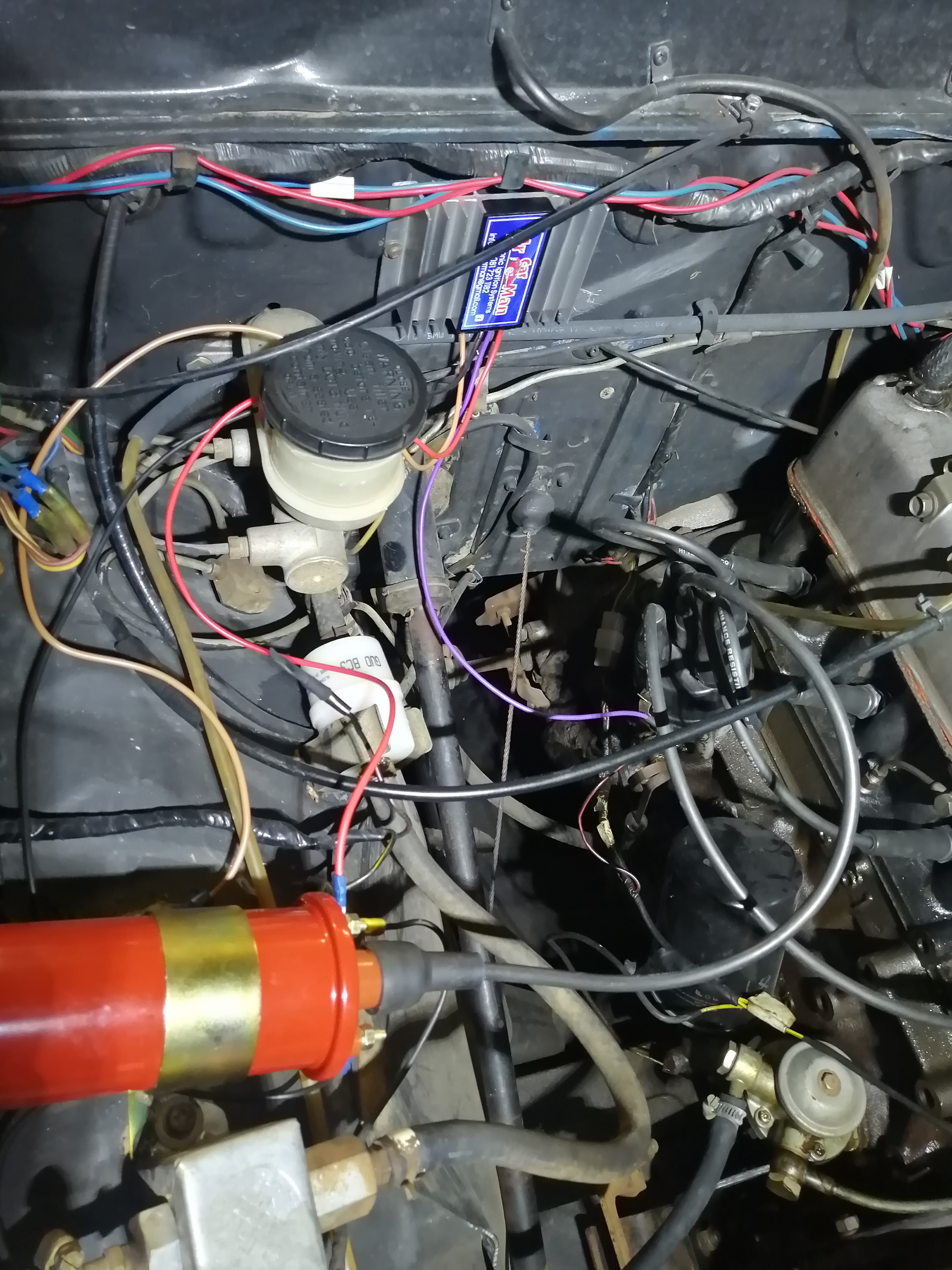

As time progress, new things come to mind to increase the Chevy's daily drive-ability.

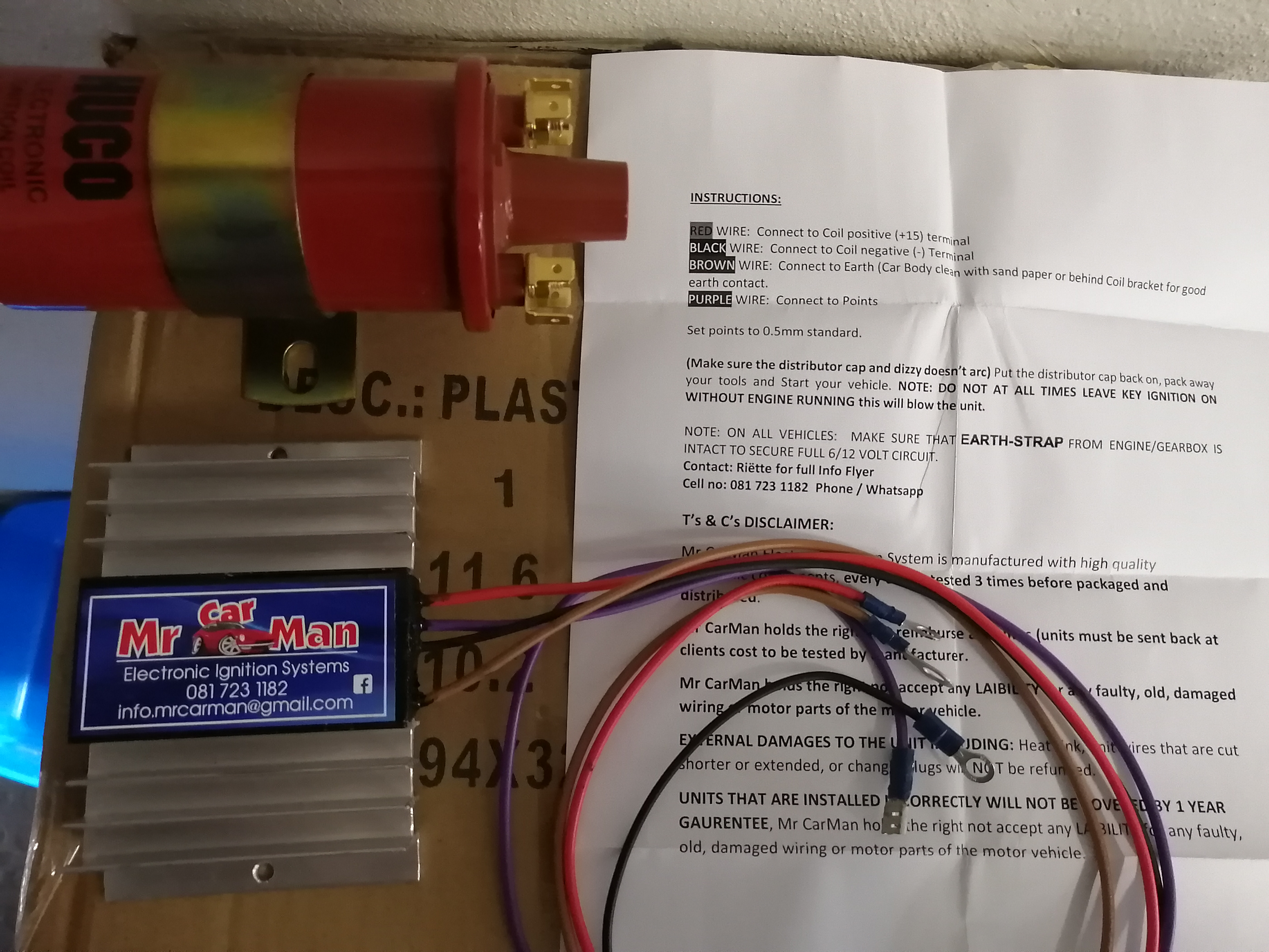

Next on the line was an electronic ignition, and also combined with this another coil which has low resistance.
We have a local to South Africa supplier of electronic ignitions, at a very fair price of only $70. This is for both the ignition and coil. https://4x4direct.co.za/spares-online/9837-mrcarman-electronic-ignition-systems.html
The installation is quite easy (comparable to pertronix), but do read the instructions. If you leave the negative wire on the coil, you will blow the new electronic ignition, and the warranty is void.
File comment: Figuring out which wires goes where
File comment: Here is the whole system wired
File comment: Wide view of how everything fits together.
