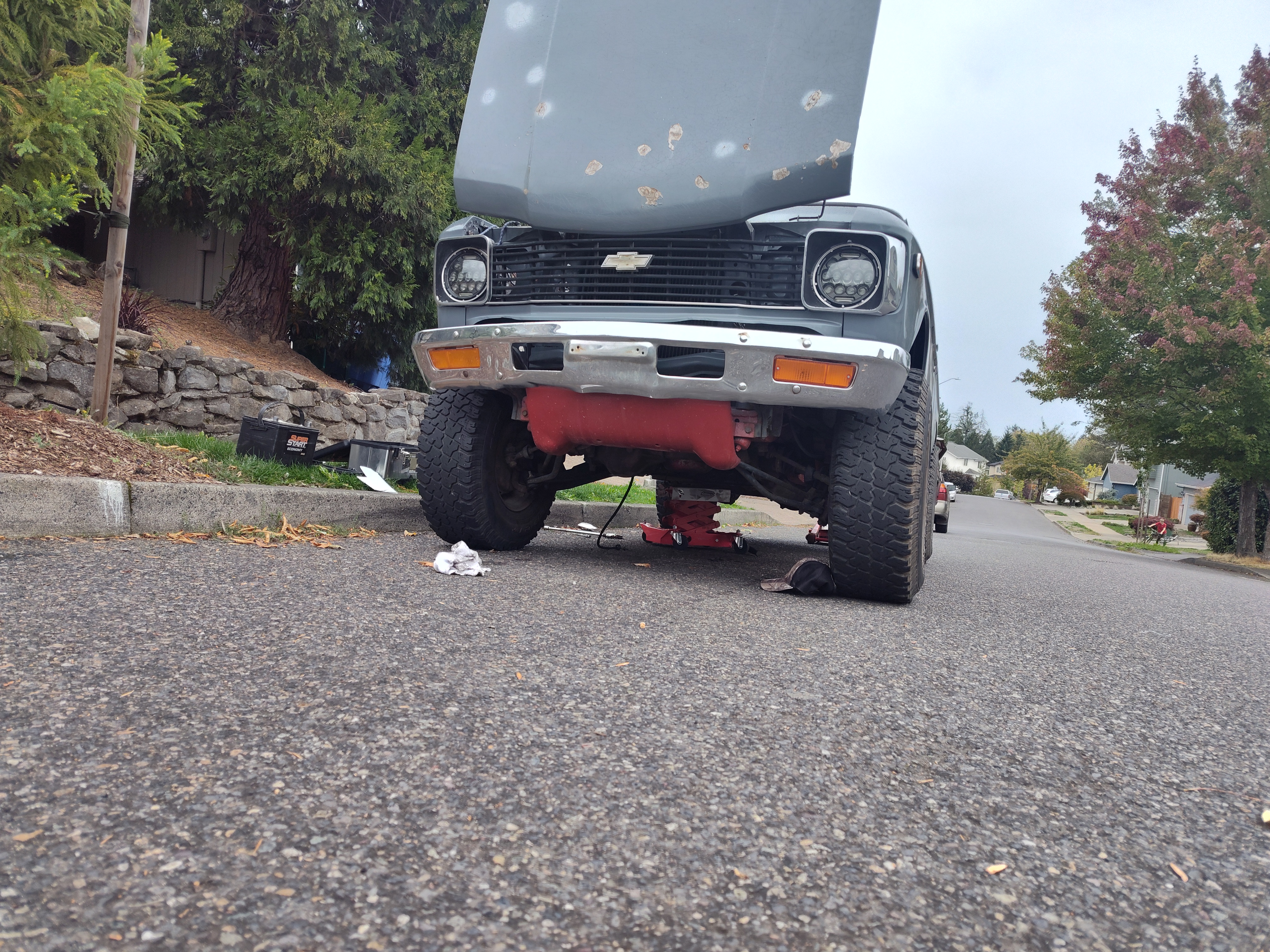

File comment: Truck as I bought it

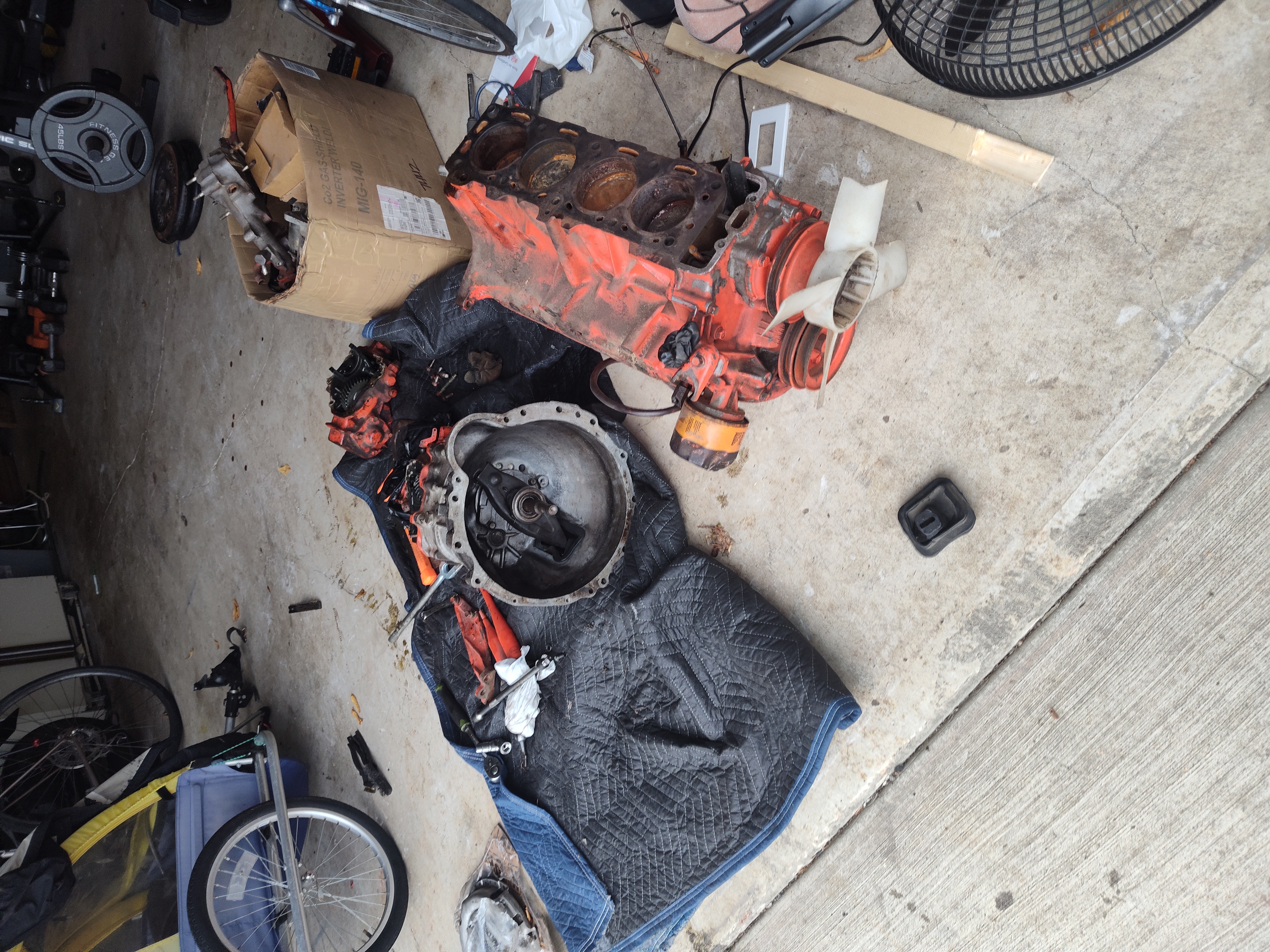

File comment: Donor engine and tranny

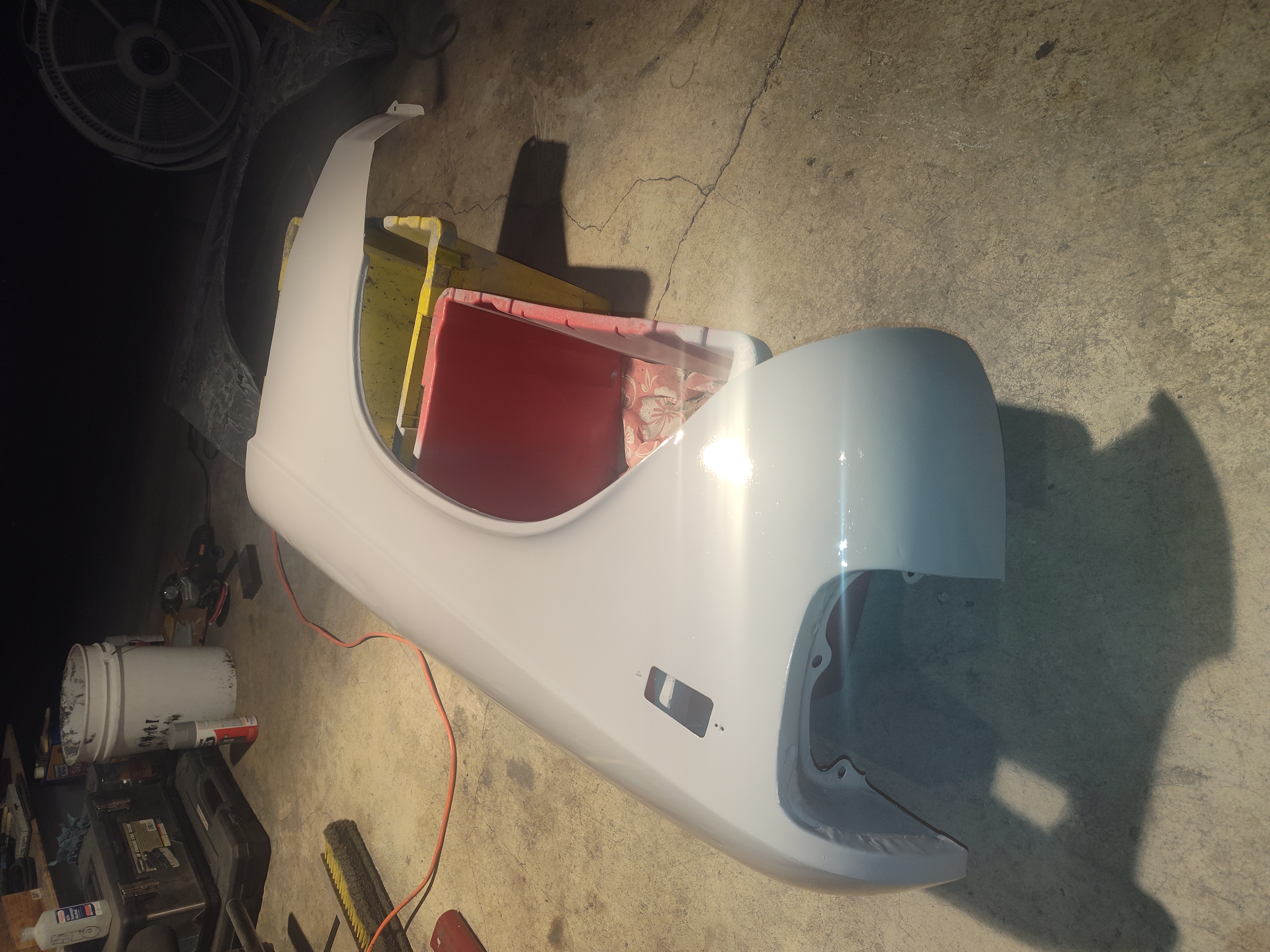

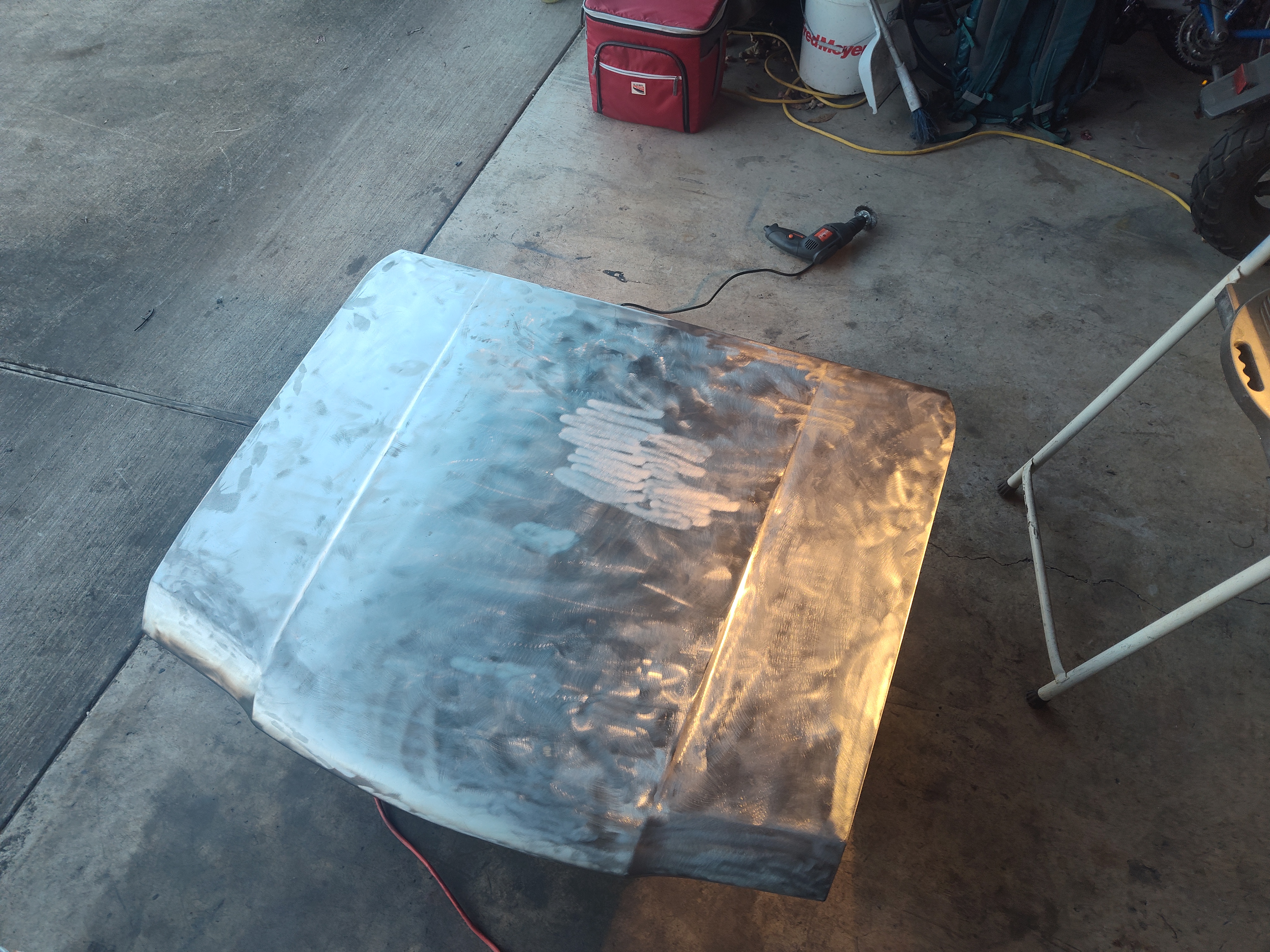

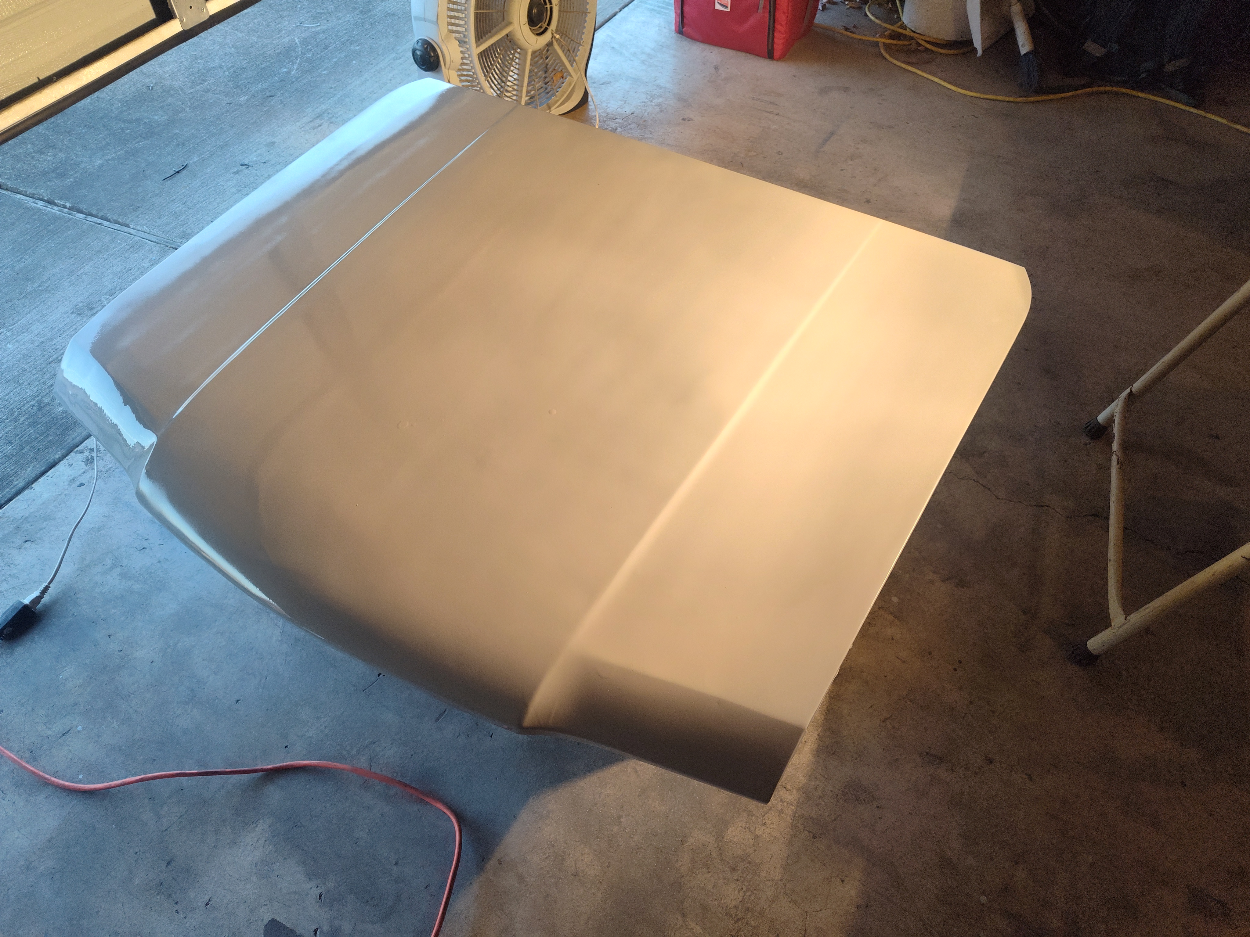

Body and paint

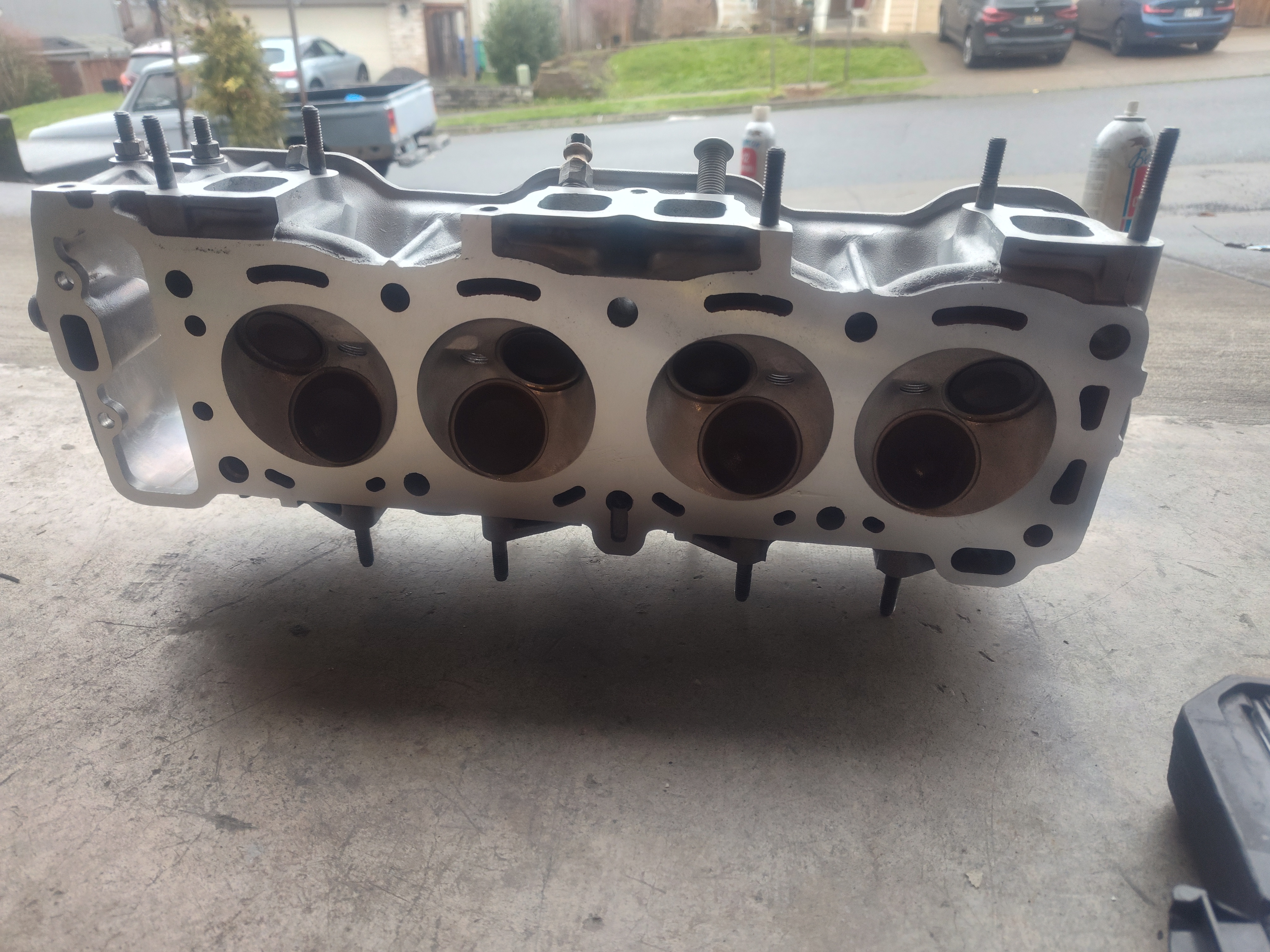

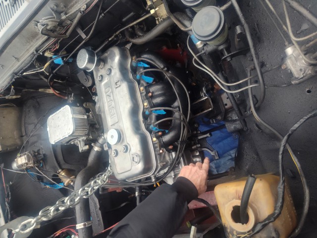

Engine rebuild step by step. I'll start out by saying that this rebuild took about 3 months, much of that time was spent sourcing hard to find parts. My original head was warped beyond repair, the second head from the donor engine had gouged and damaged camshaft journals, I managed to get a third and in good condition head from another LUV enthusiast who I follow on Instagram big shout out to @luv_project_ on Instagram for the head and the guidance. My original engine block was good but the crankshaft, connecting rods, bearings were all completely shot. I managed to source new connecting rods from Engine Rebuilders Supply (ERS) based in Troutdale, OR. The third head may have been in good shape but the camshaft needed a grind so I Sent it off in the mail to DeltaCam based in Tacoma, WA to get grinded. I sourced new main/connecting rod bearings, 20 over pistons/rings, intake/exhaust valves on eBay, another source for them is Clegg engine but they're a bit more expensive. I sourced new water pump, new engine gasket kit, new oil pump, and new timing component kit on rockauto.com.

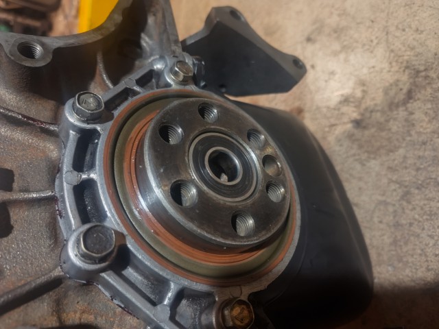

File comment: New pilot bearing installed

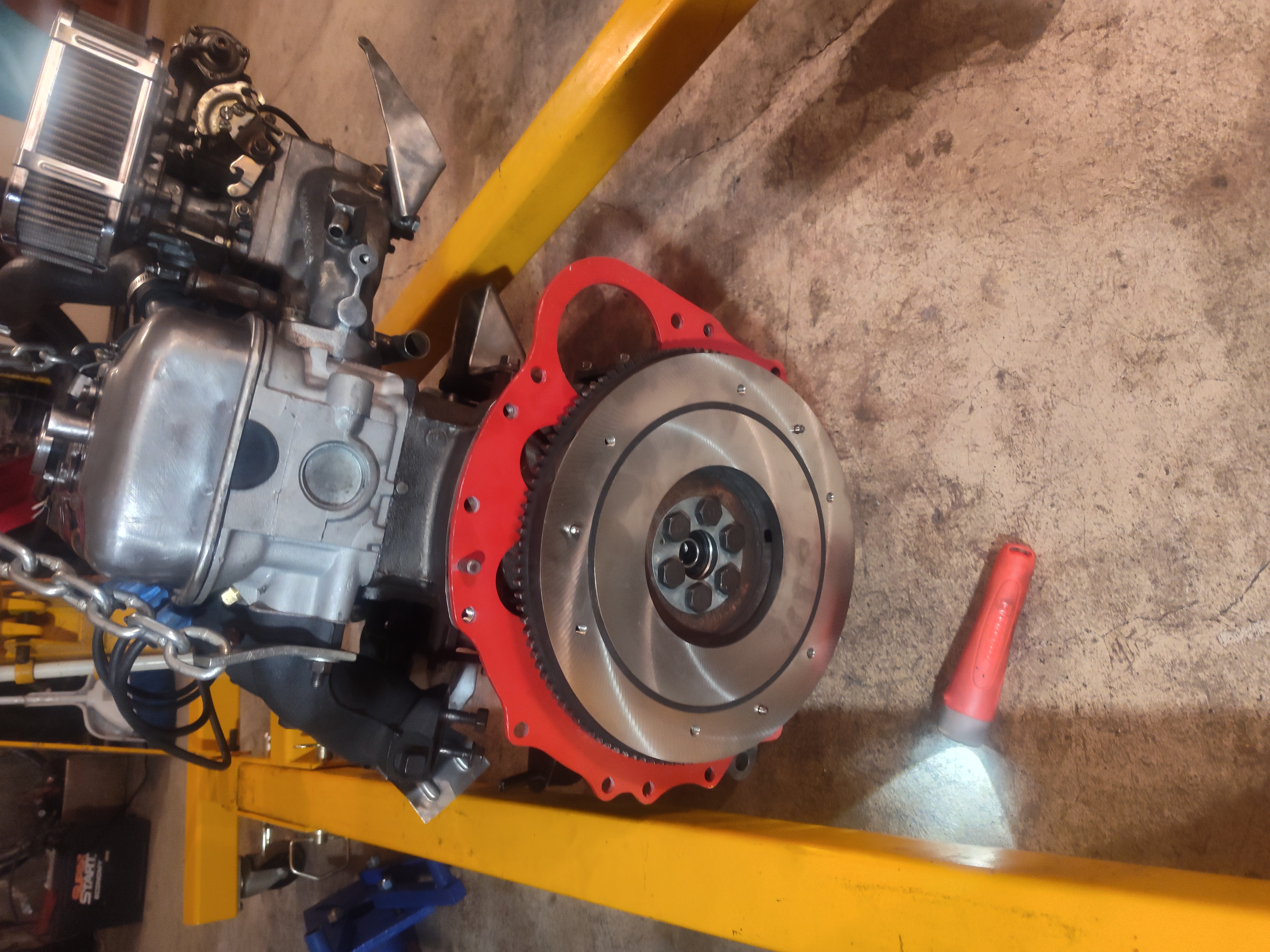

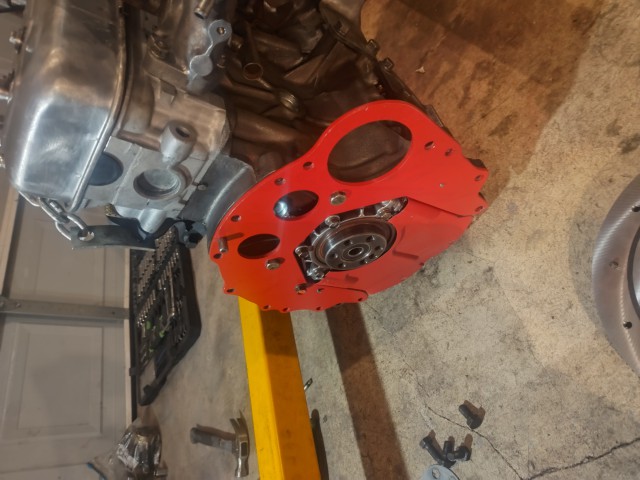

File comment: Resurfaced flywheel
File comment: Clutch and pressure plate installed

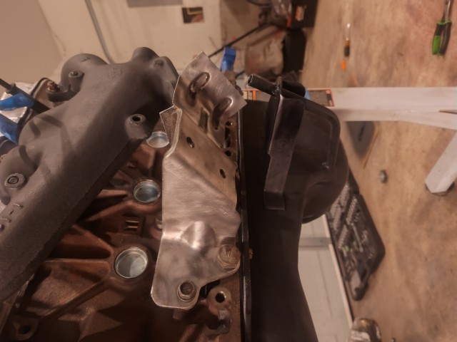

Rebuild
File comment: Timing cover installed with new seal.
File comment: New head gasket
File comment: Machined head looking very nice
File comment: Head with new cam mounted torqued to spec with new head gasket.
File comment: Cleaned the inside of oil pan meticulously, steel wire brushed exterior/primed painted, mounted with new gasket, put a little bit of oil resistant gasket sealer near base of rear main seal and at timing cover where it meets the block.
File comment: Exhaust manifold cleaned, painted with high temp ceramic coating. New brass plugs.
File comment: New thermostat

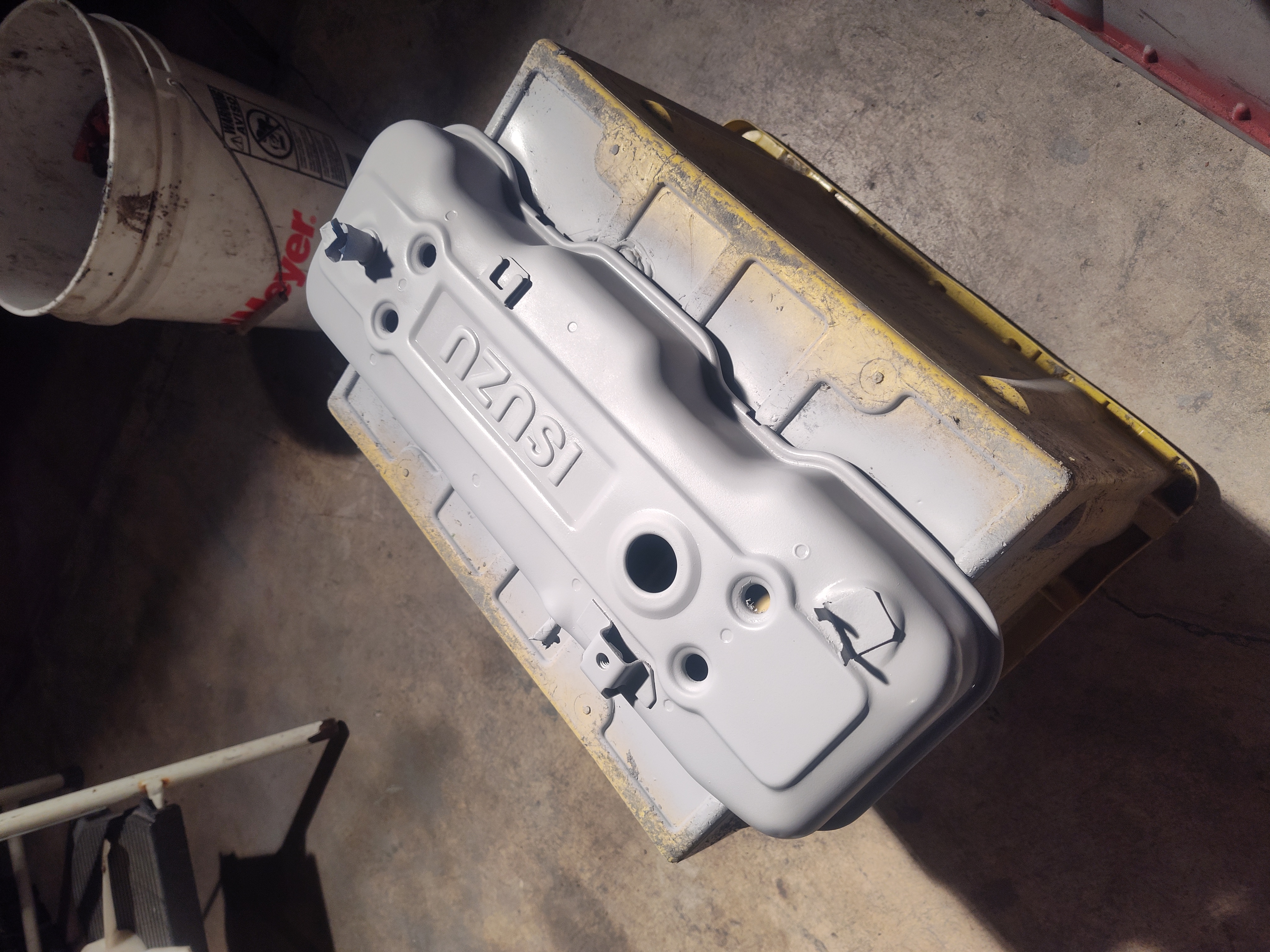

File comment: Block and valve cover clear coated

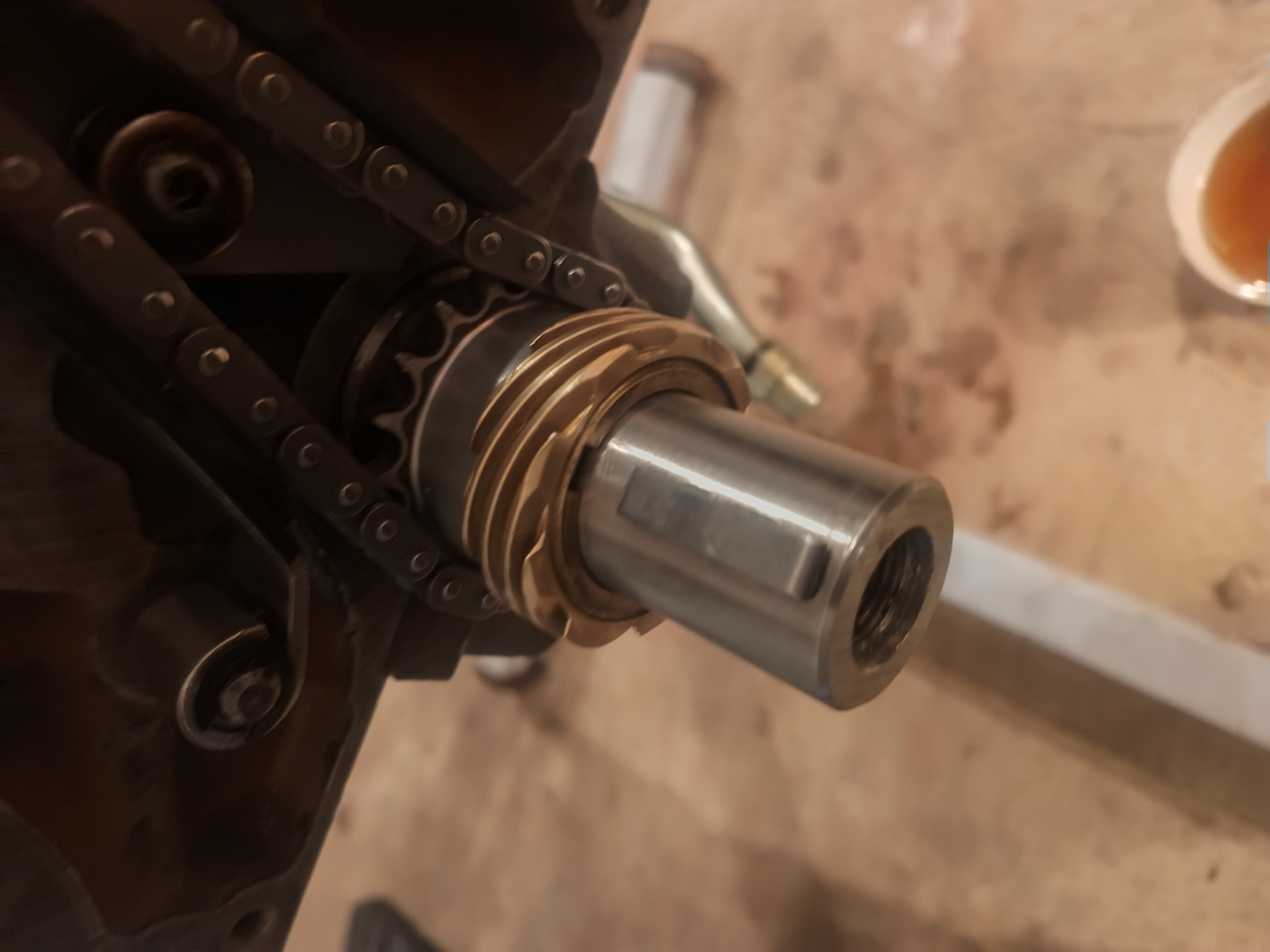

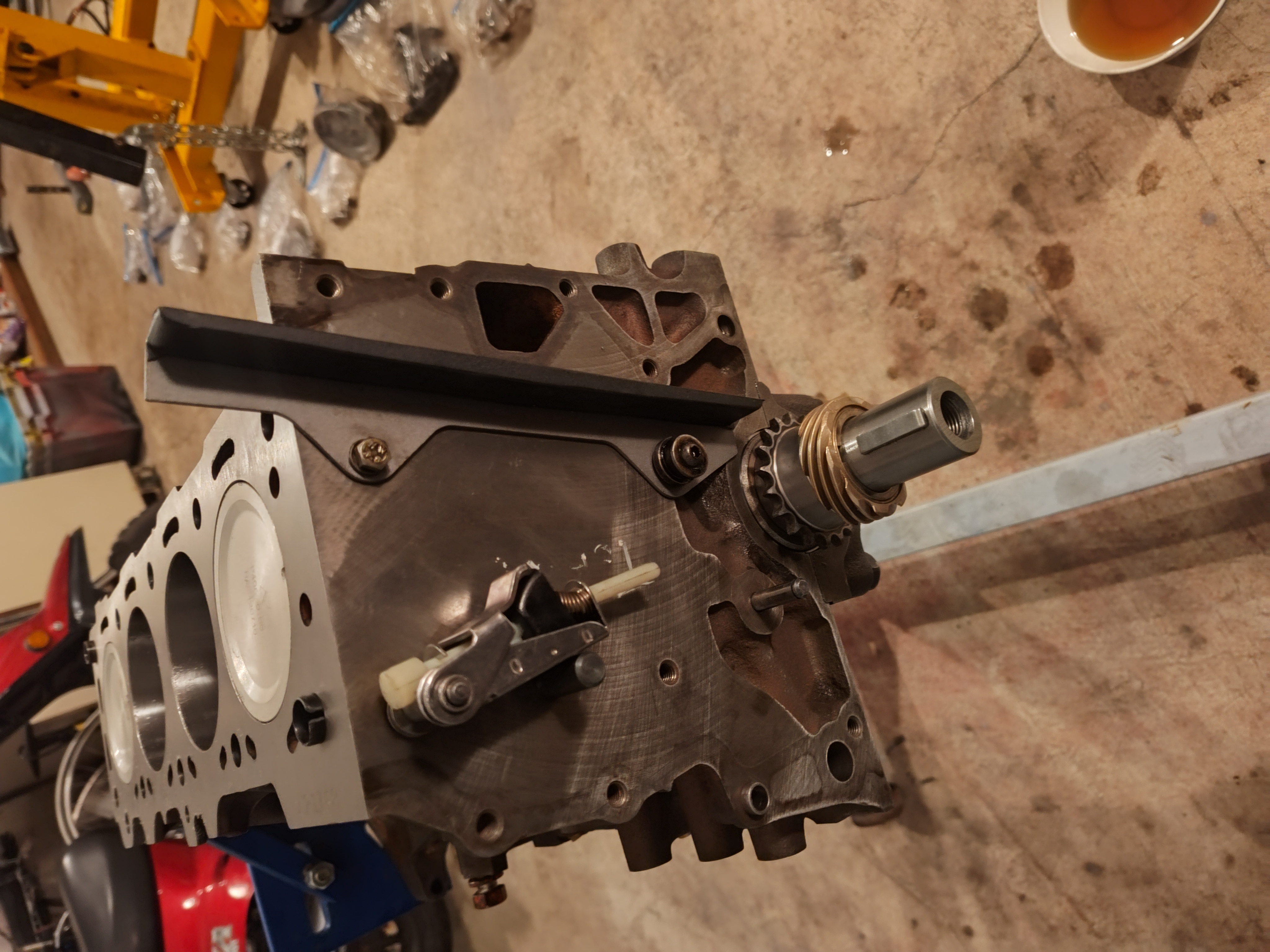

File comment: Crankshaft timing gear sprocket installed, oil pump gear drive installed

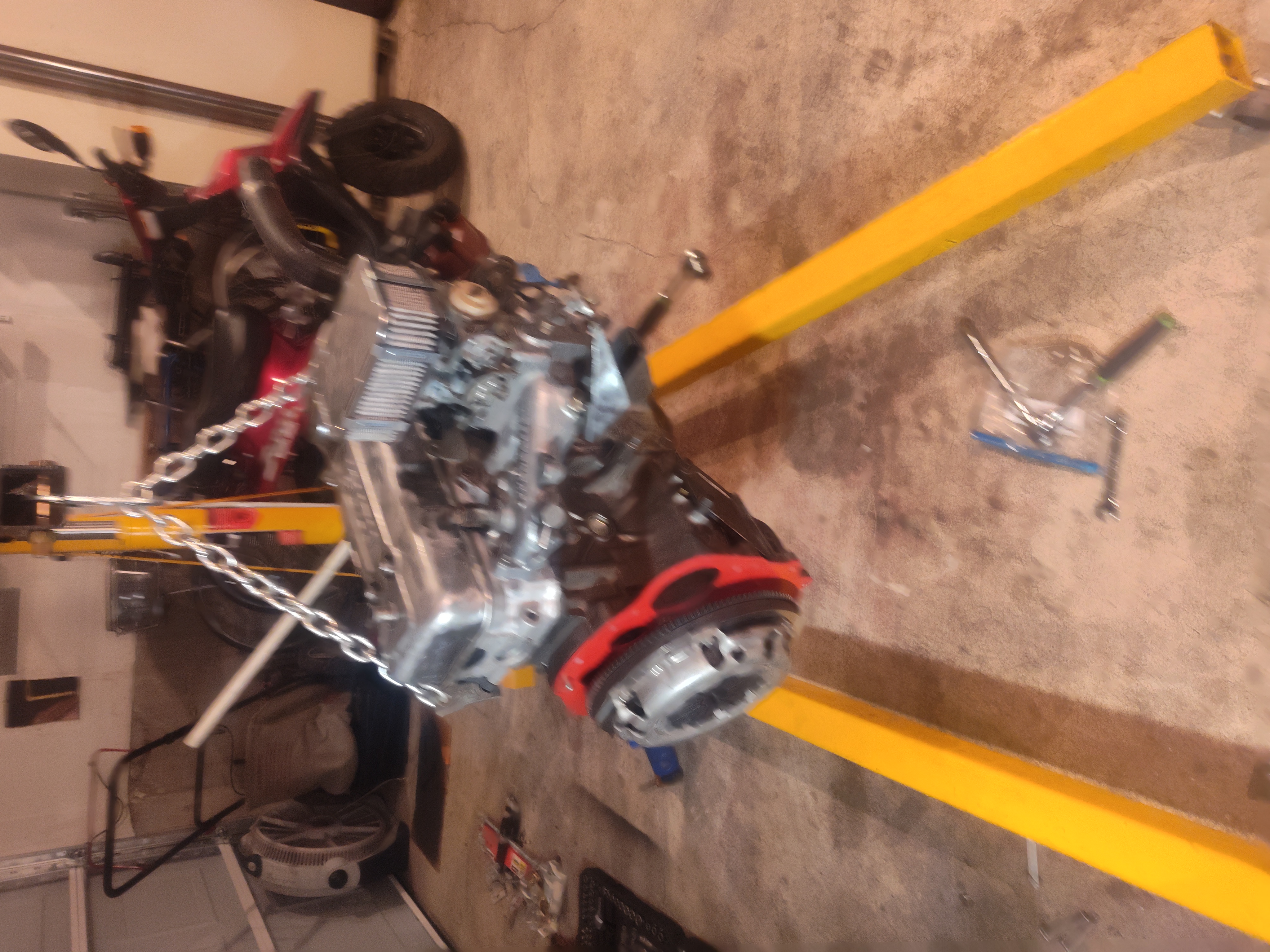

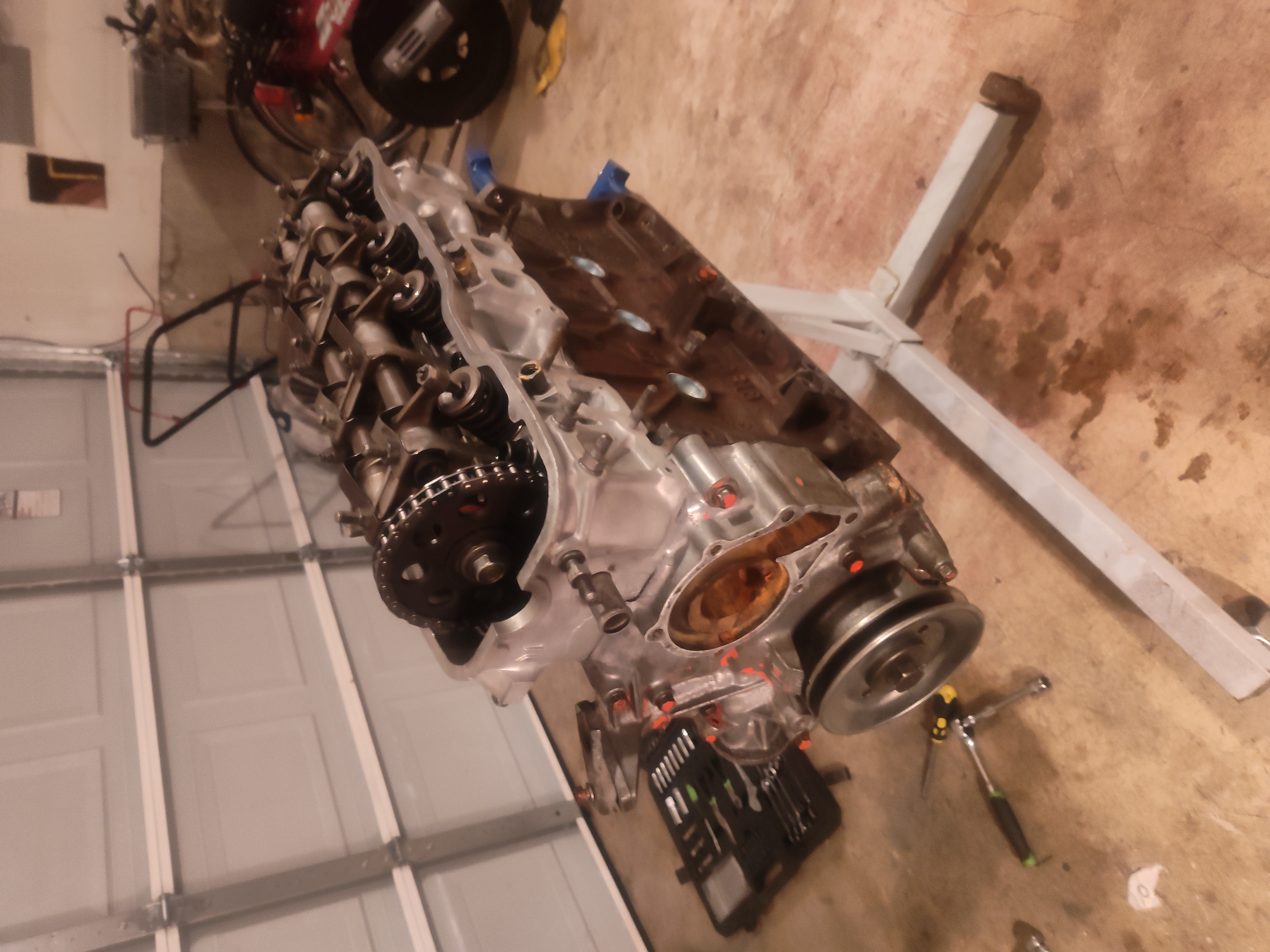

Continuation of rebuild.
File comment: Offenhauser intake cleaned up inside and out.
File comment: Meticulously cleaned Weber 32/36 and put on new gaskets.
File comment: Resurfaced Block on stand.

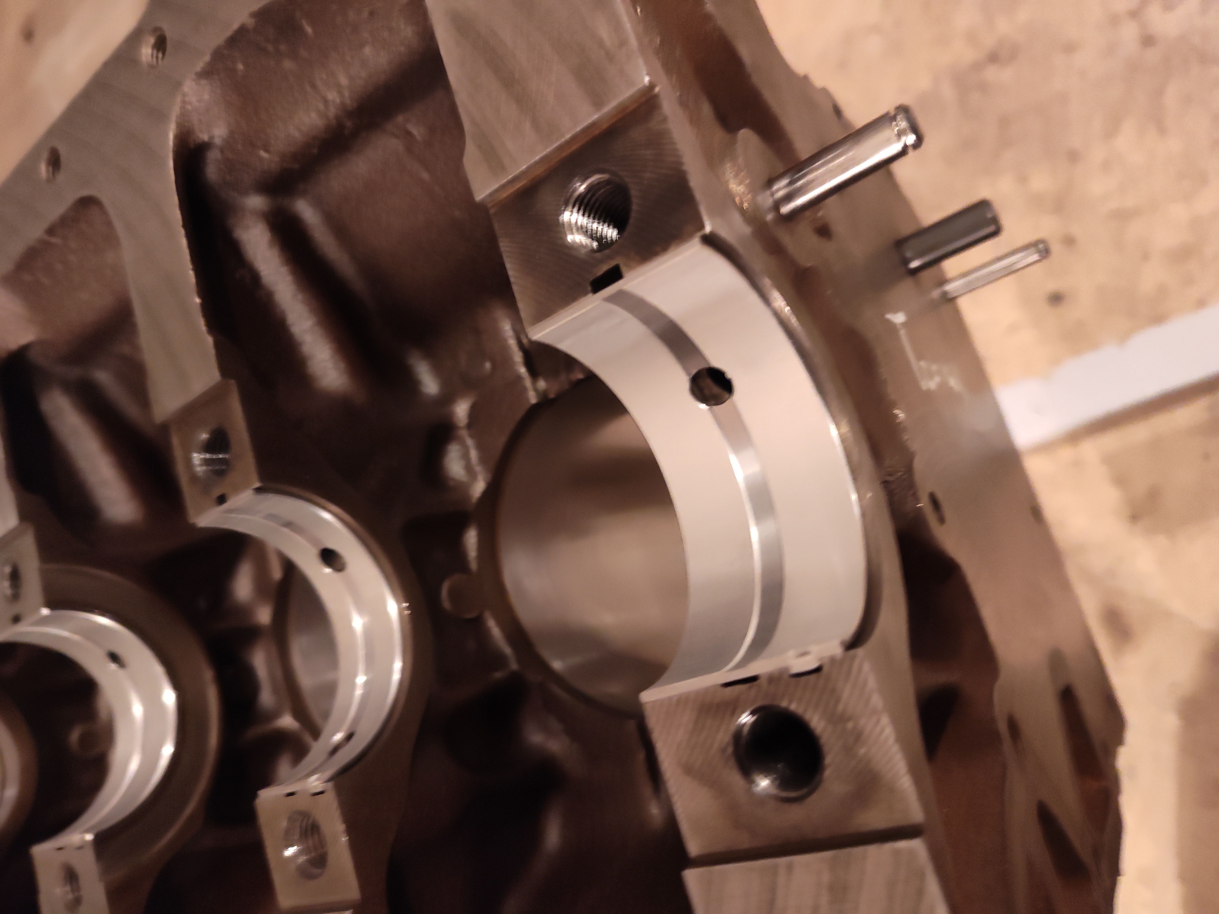

File comment: These are 25 under main bearings lubed up with Lucas brand assembly lube.
File comment: Crankshaft that I had ground at eastco resting in place.

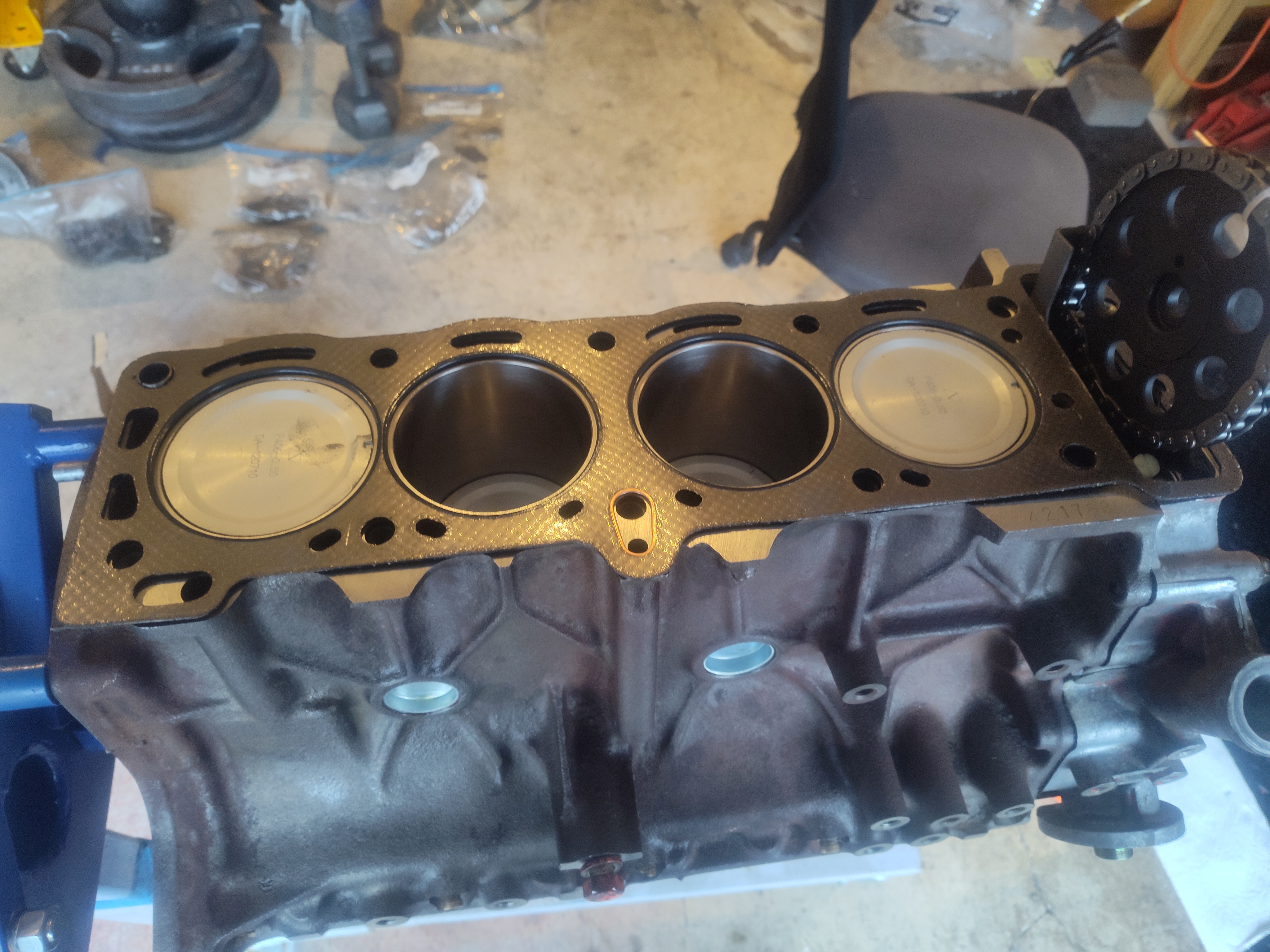

File comment: Piston rings installed 1st, 2nd and oil groves. One of my 4 manuals describes and instructs you to position the gaps in the rings at staggered positions so as to not have a straight gap going from top to bottom between your rings. I did that. I also dipped the tops of the pistons with rings I stalled I to motor oil to aid in the fitting of them into the cylinders.
File comment: 20 over pistons at TDC

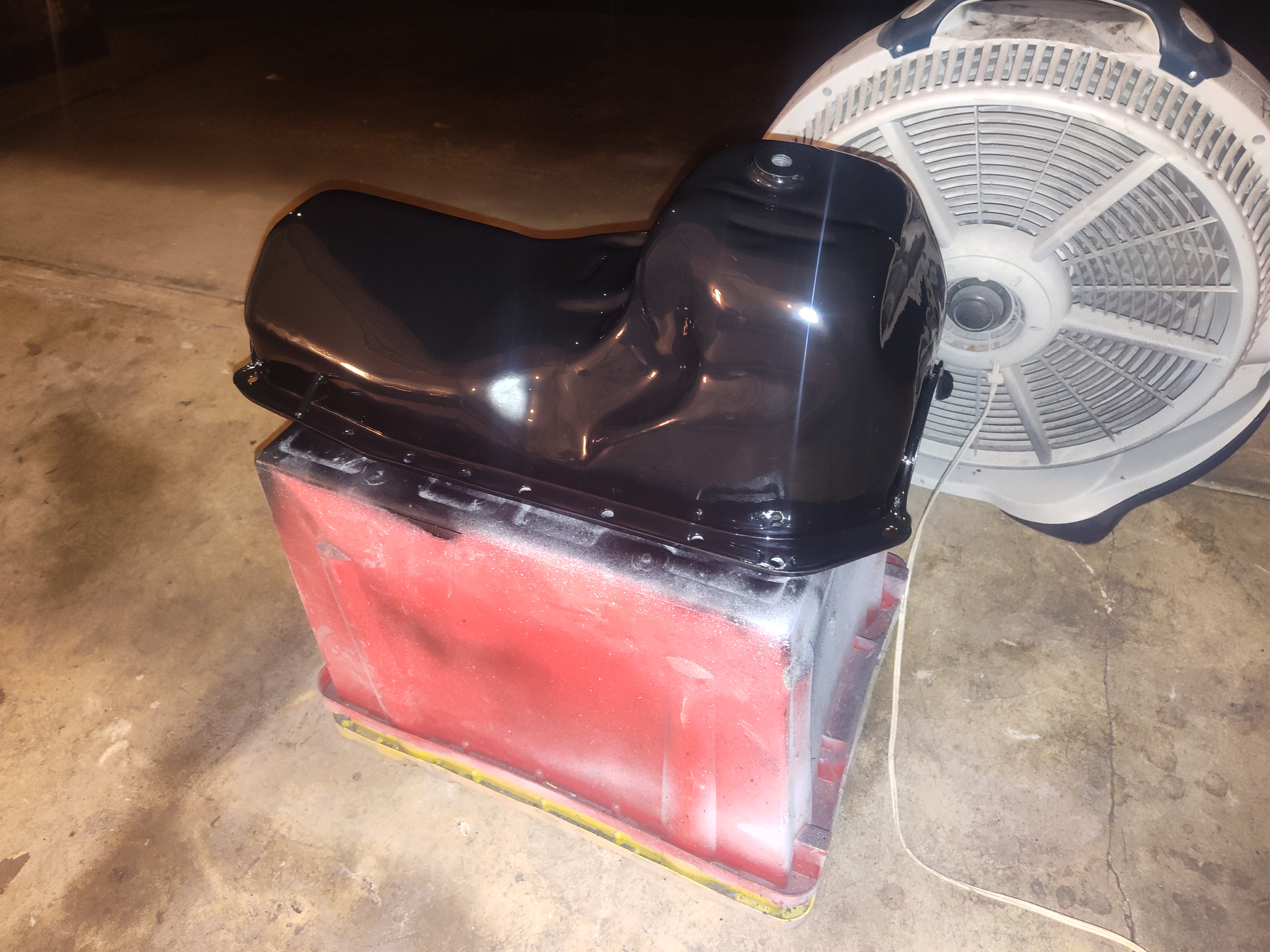

File comment: Oil pan sanded/wire brushed to bare metal. Primed and painted.

Yep, it's been up and running for about a month now. runs strong and smooth. I got a new Weber on its way cause the one I have on it has worn out components and the throttle plate gets stuck when returning to idle, I have tovfeatger and blip the gas pedal to get it back to idle. Also the idle mixture screw does absolutely nothing so I'm opting for a new carb rather than a rebuild. Im now working on a front end rebuild. Installed an idler arm assembly out of an 85' trooper, new upper/lower ball joints, new inner/putter tie-rods, new center-link and boots for my cv axles.
