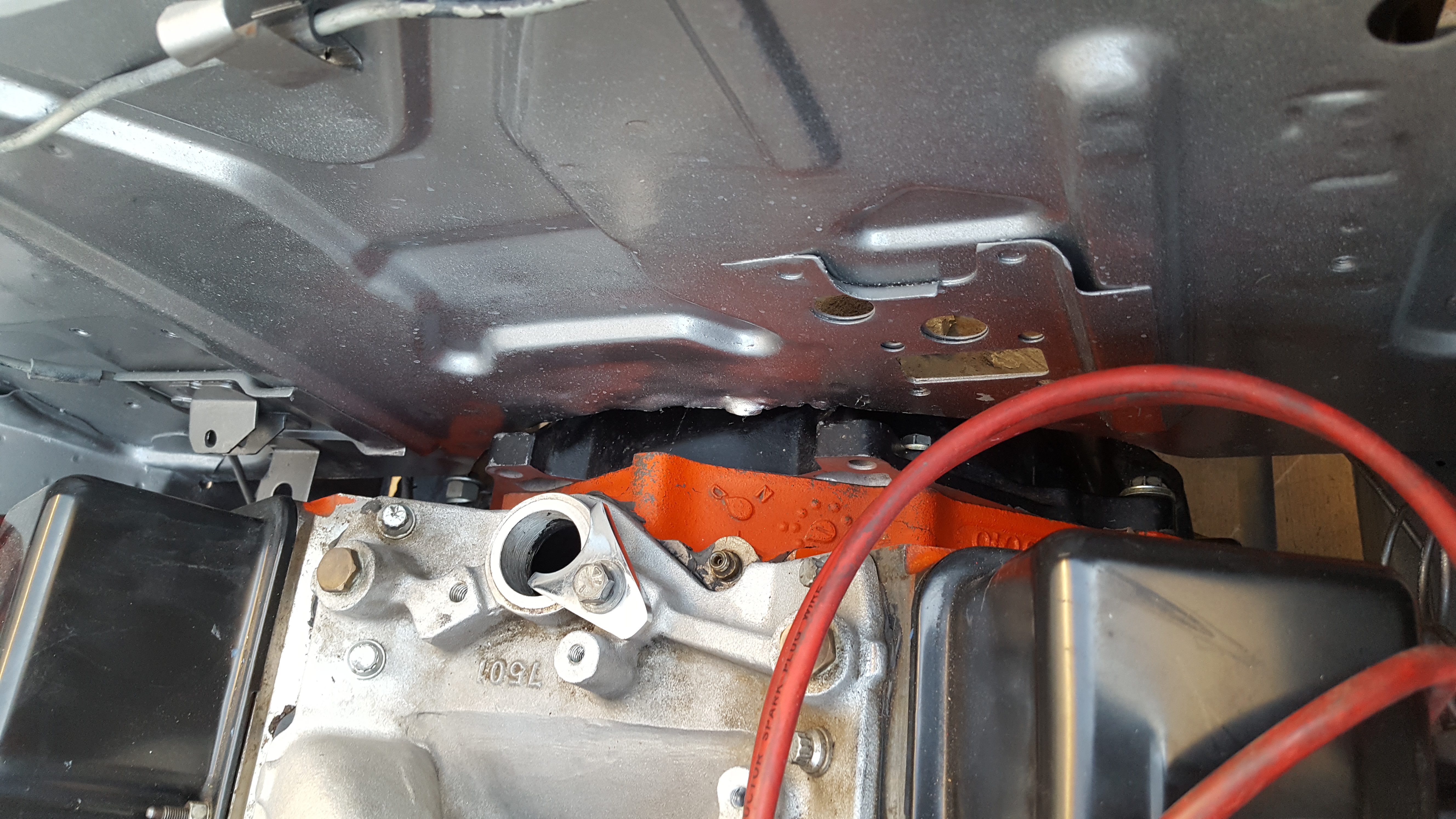

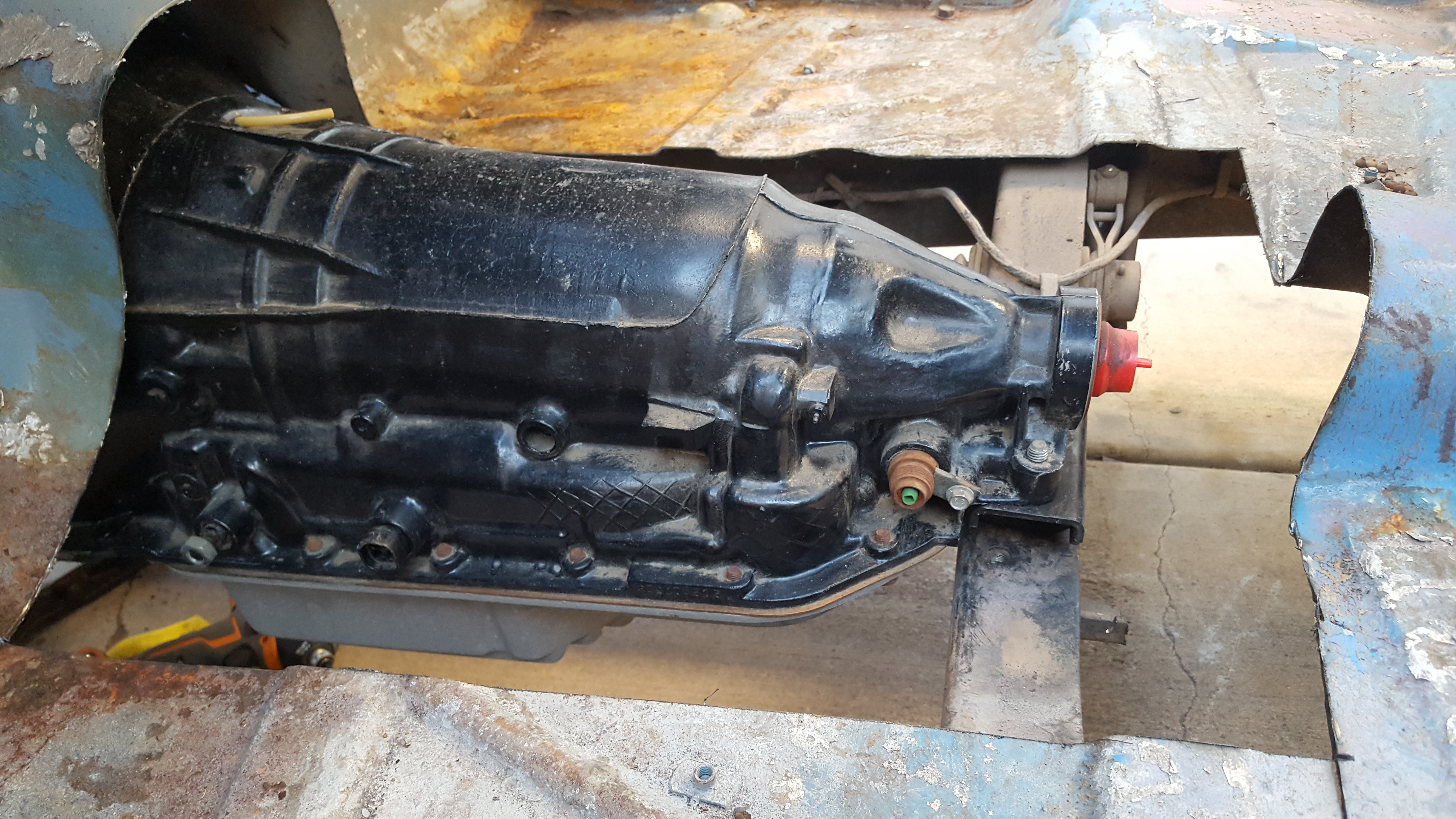

The trans mount on the 2004R landed right on top of the cross member. Fantastic! I did make a small access hole in the floor to see whats going on :lol:

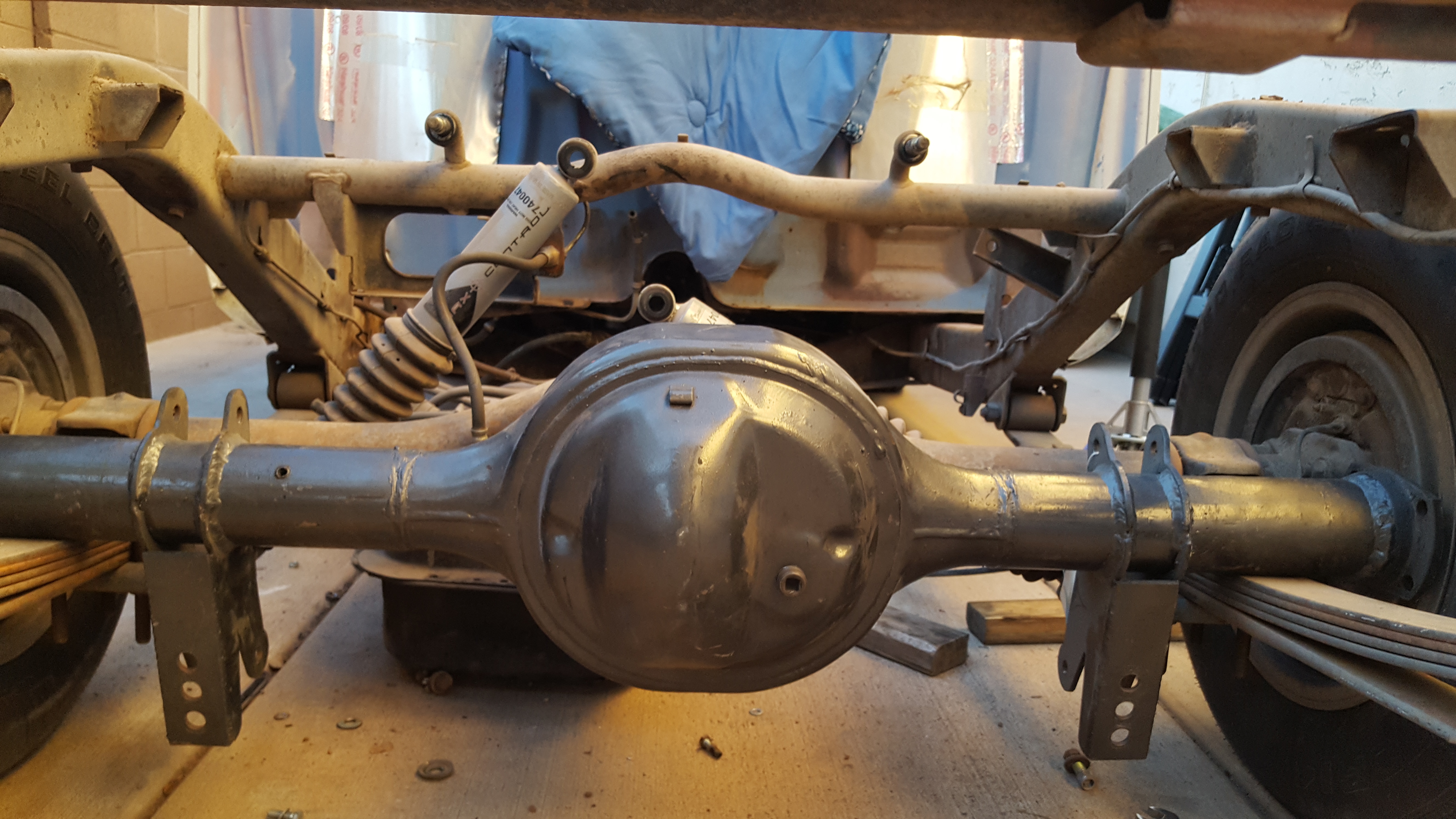

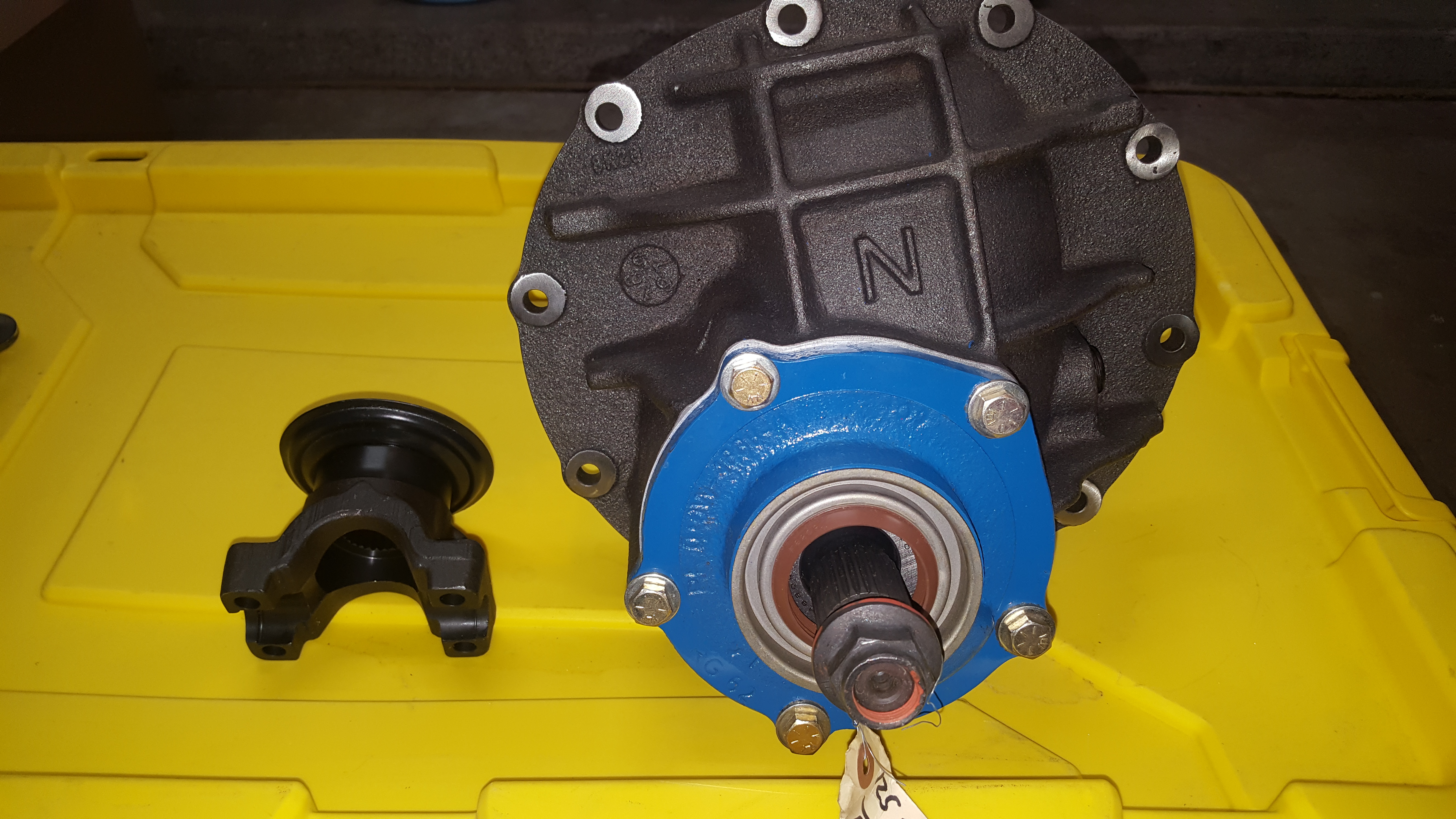

Back to work on the LUV. Was going to put a Moser 9" into it with a Nodular 3rd member, and a speedway disc brake set up into it, but have a complete Modular Strange set up that would make the job even easier.

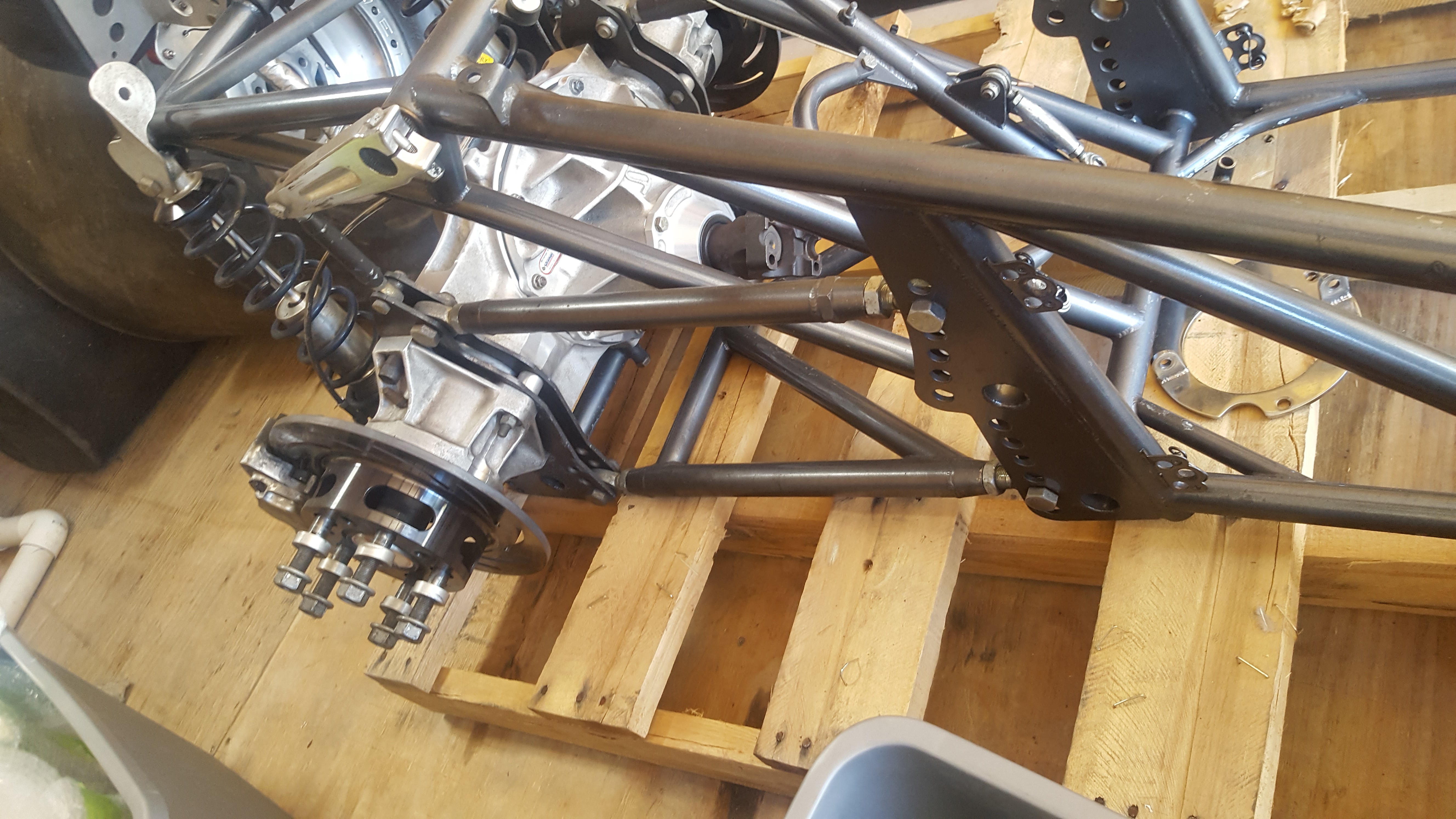

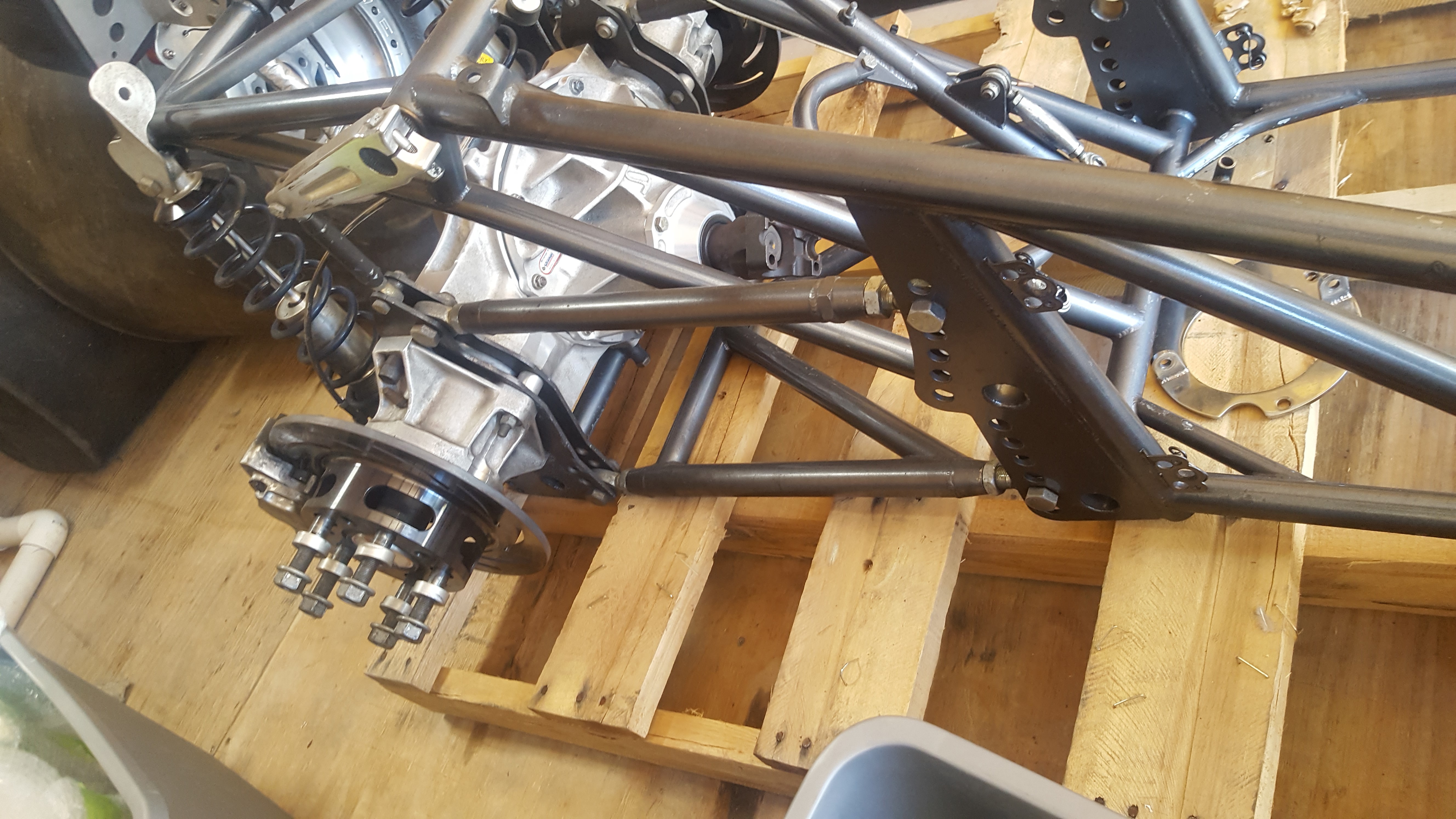

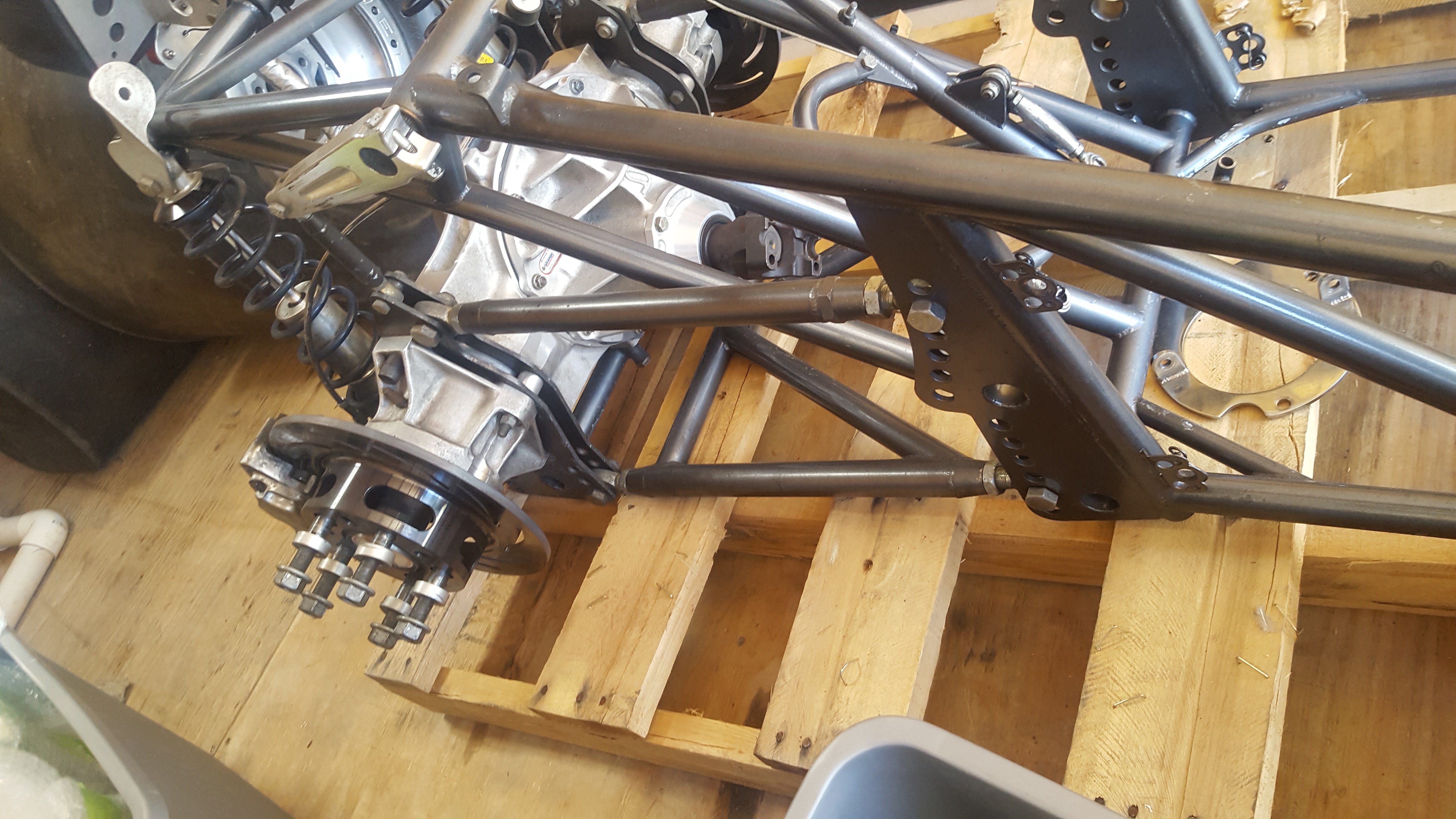

The Strange Modular housing and 4 link already has everything I need for the rear end and suspension so its a no brainer. It's even Narrow for the Luv, so I will have to get some wheels with hardly any back spacing though.

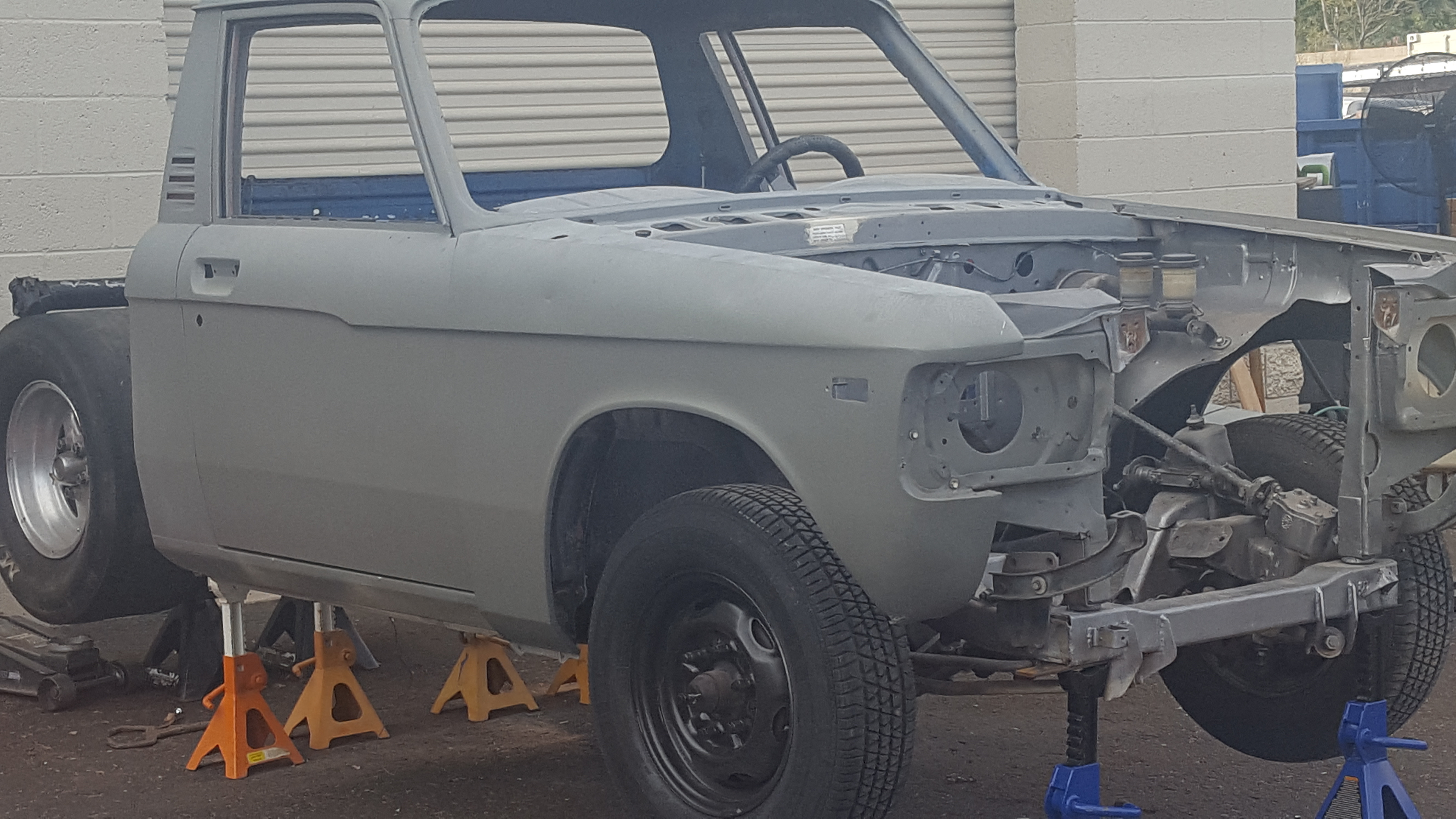

Decided to bite the bullet and go with an Autoweld Chrome Moly cage along with enough extra tubing to build a frame. Truck is at the Fabricators and most of the frame is going away :lol:
