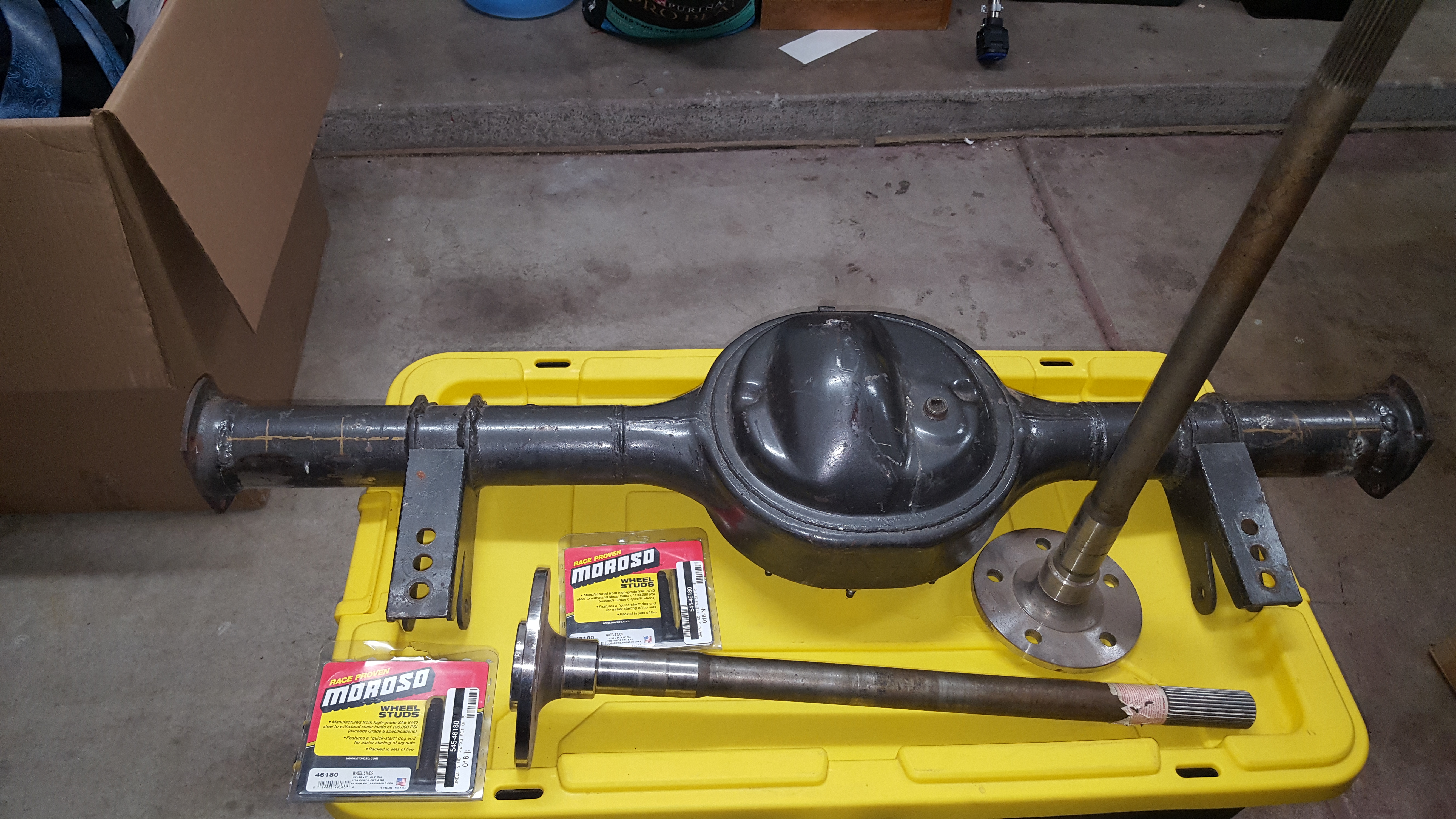

Back to work on the LUV. Was going to put a Moser 9" into it with a Nodular 3rd member, and a speedway disc brake set up into it, but have a complete Modular Strange set up that would make the job even easier.

The Strange Modular housing and 4 link already has everything I need for the rear end and suspension so its a no brainer. It's even Narrow for the Luv, so I will have to get some wheels with hardly any back spacing though.
