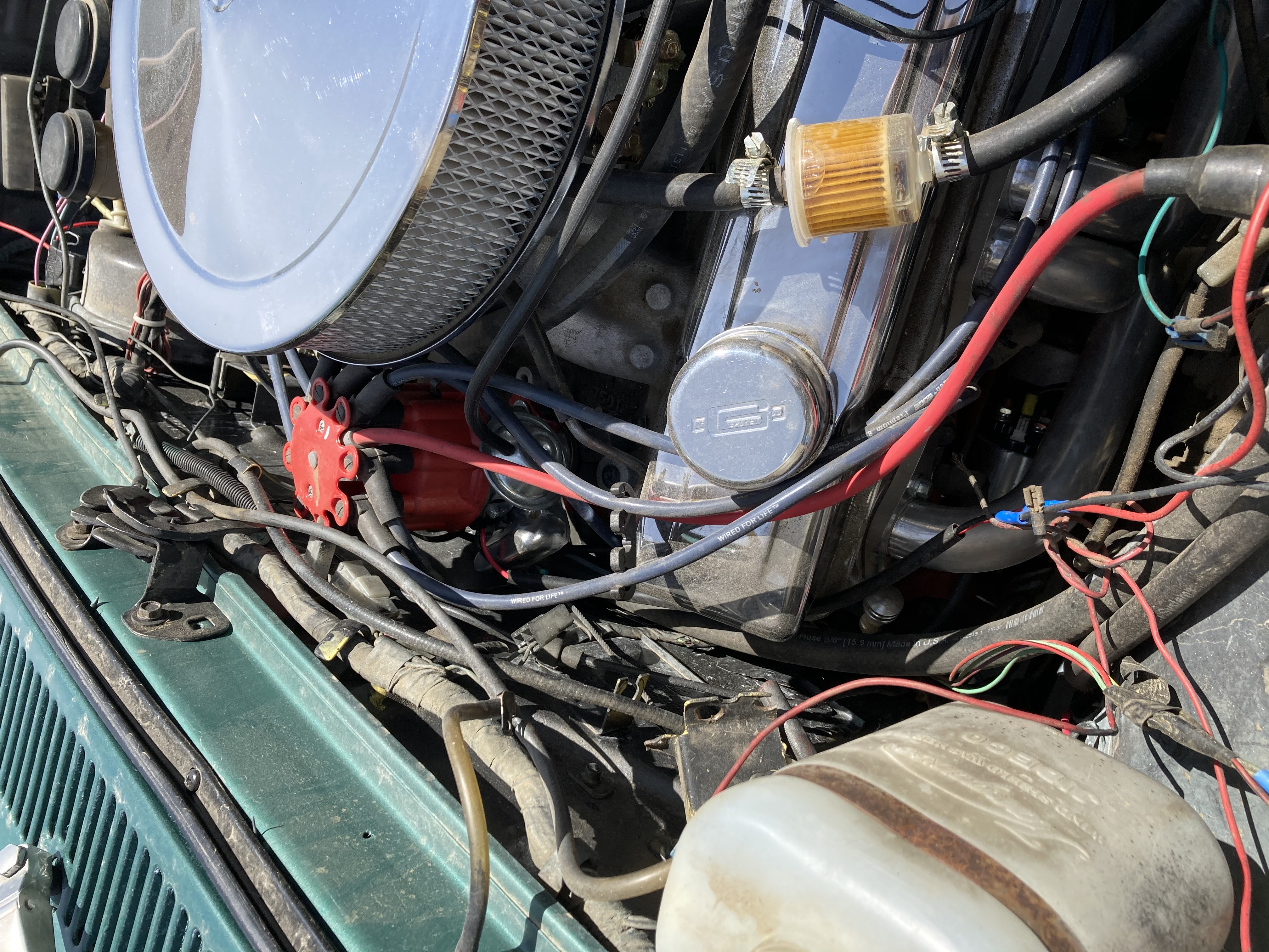

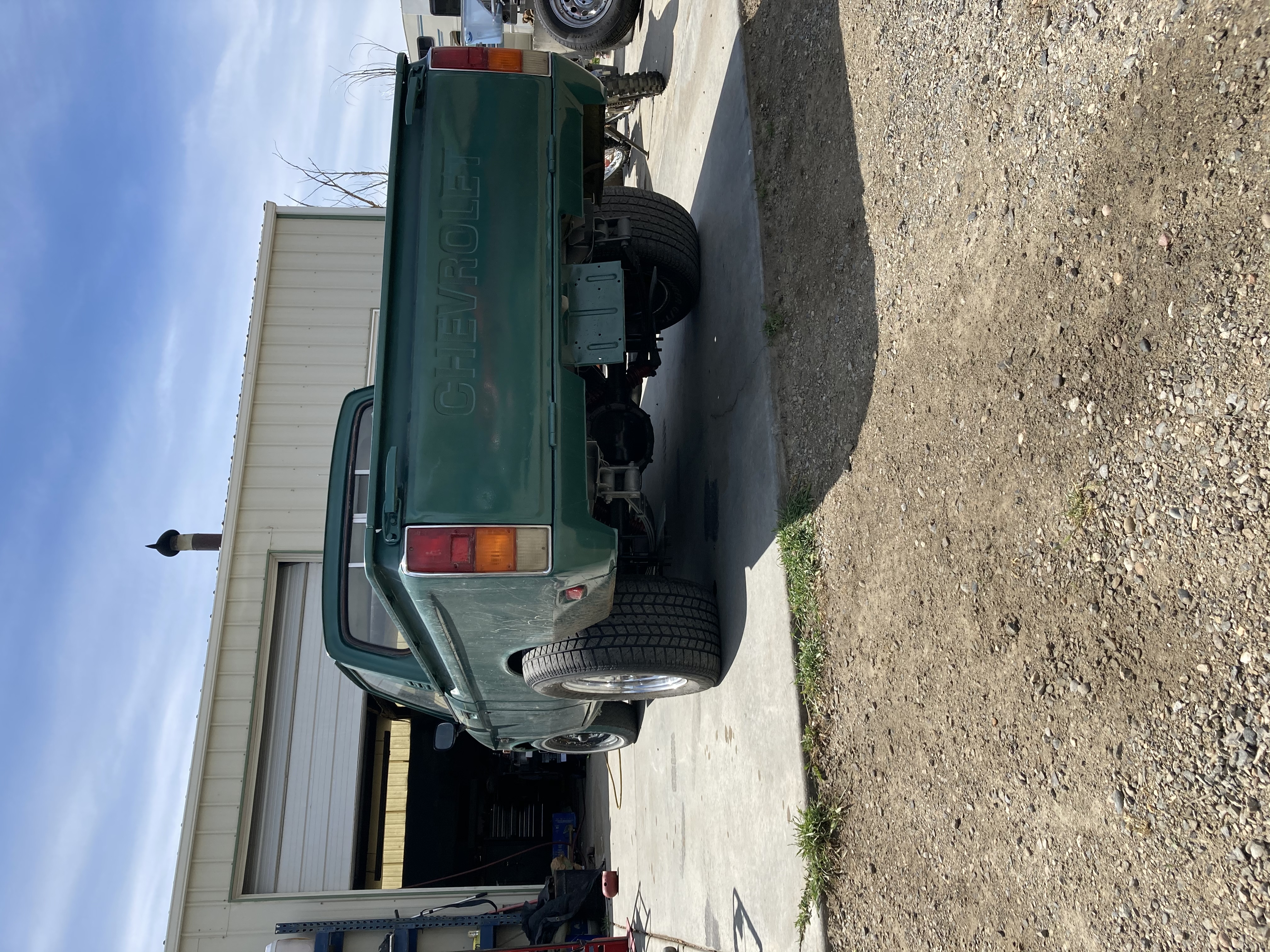

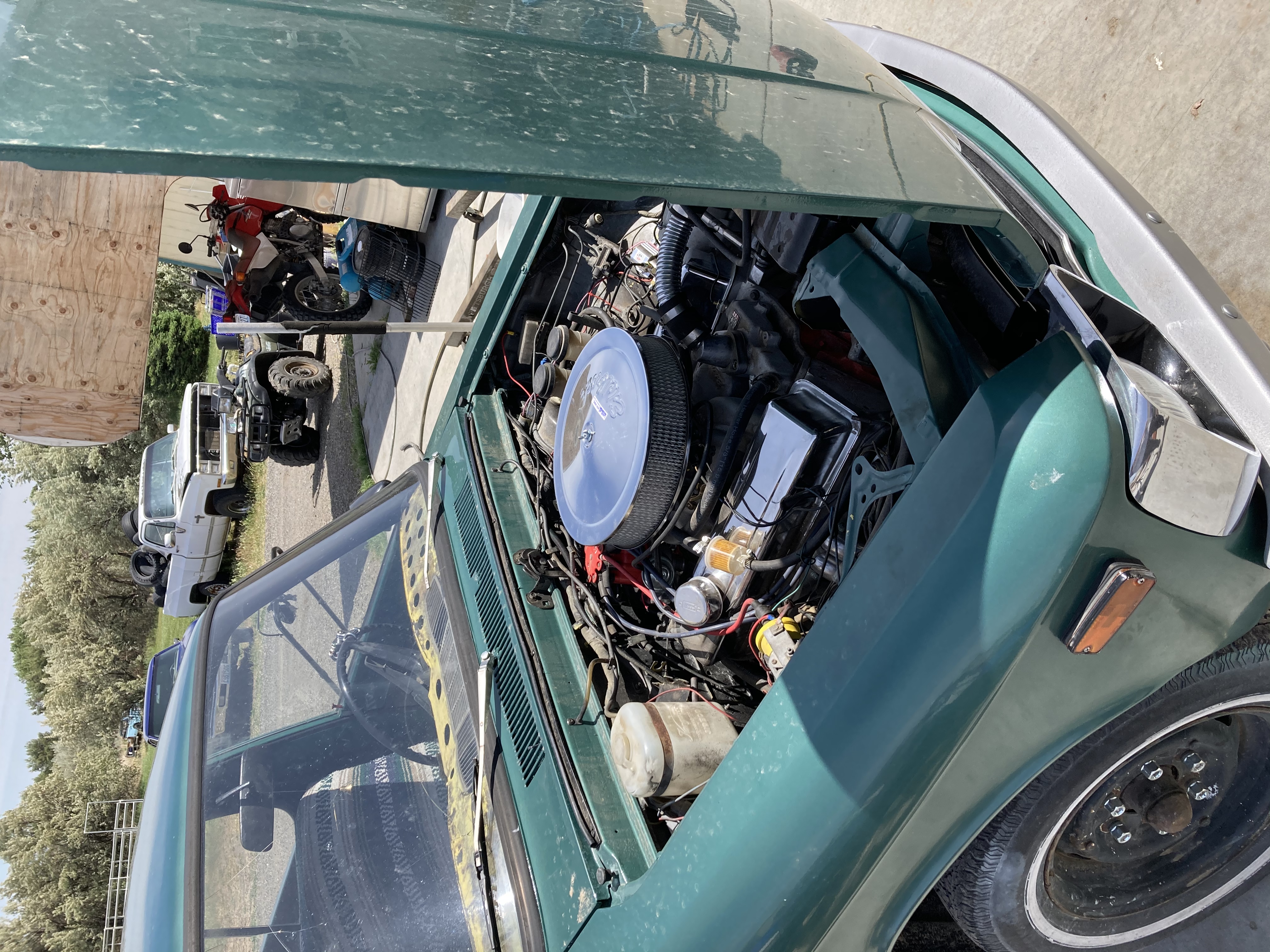

My dad and I have been working on this project for a year and a half now. We purchased it as a shell with no motor or trans and decided to do a nice build together, we swapped in a small block 350 and th350 transmission under the hood. We put a s10 rear end under it and shortened it 6 inchs on each side To fit 50s in the back for traction, re routed the battery to the bed, and removed the stock gas tank and put a fuel cell in the bed. The 350 is built with aftermarket cam,Forged pistons, trickflow heads, Edelbrock air gap riser intake, 4barrel carb, custom 4 core radiator, headman headers with exhaust pipes out the side in front of the tires, and Line Locks. We also did all the bondo/bodywork/linex/paint together and we are finally almost done with our build, there is still More things we need to do and things that I am forgetting to mention parts wise that my dad has receipts of, for the full build list. I hope you guys like it!
