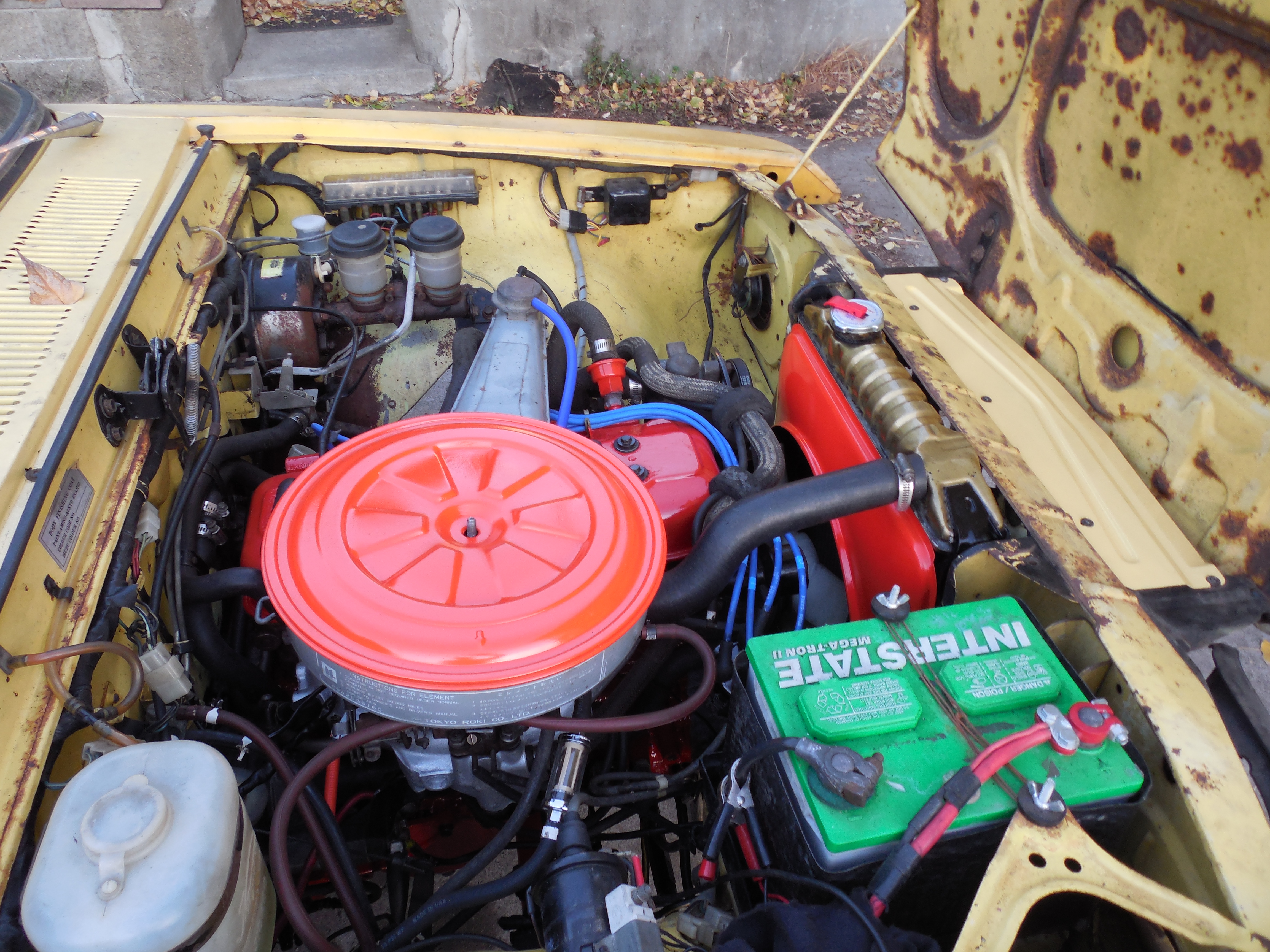

Yes, I like that look as well so when i went thru my engine bay I also cleaned mine up & clear coated it

Might want to think about putting that fuel filter on the non pressure side and away from the 40K volts of the coil.

non pressure side as in the return line? Or did I miss something?

Non pressure side as in suction side, before the fuel pump.
