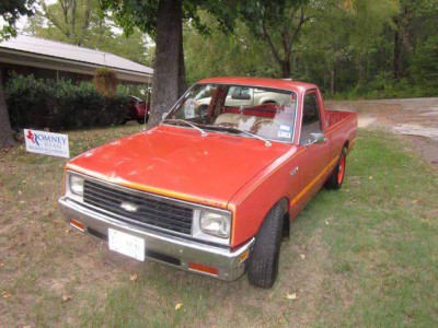

I'm sporting an 81 luv machine 2wd with 37000 miles on it. I'm the second owner.she is pampered daily. Ready to get repainted
