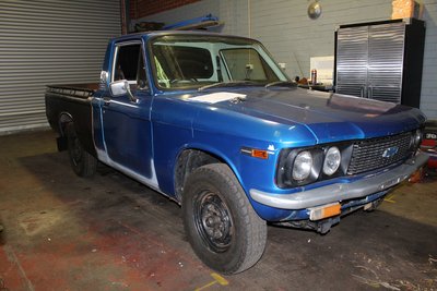

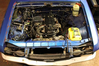

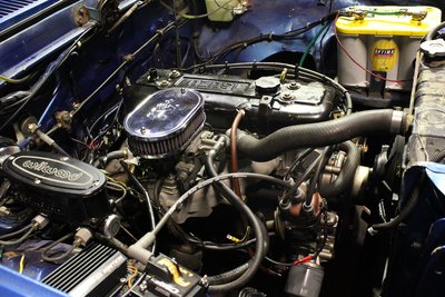

Okay so I have finally found time between other projects to spend some time on my little chevy luv.
I fitted new brake shoes and drums to try to even out a braking issue I had previously and with a little help from my good friend mr jack daniels got it to brake in a straight line again instead of pulling off the road.
I passed the mechanical inspection for registration renewal and now all I need is my registration papers to come through (its christmas time, might have a little wait on my hands) and it is back on the road.
I also fitted the new offenhauser intake manifold as supplied by mr Mokadeth and now my little chevy runs like a dream!
File comment: Looking a little old and tired
