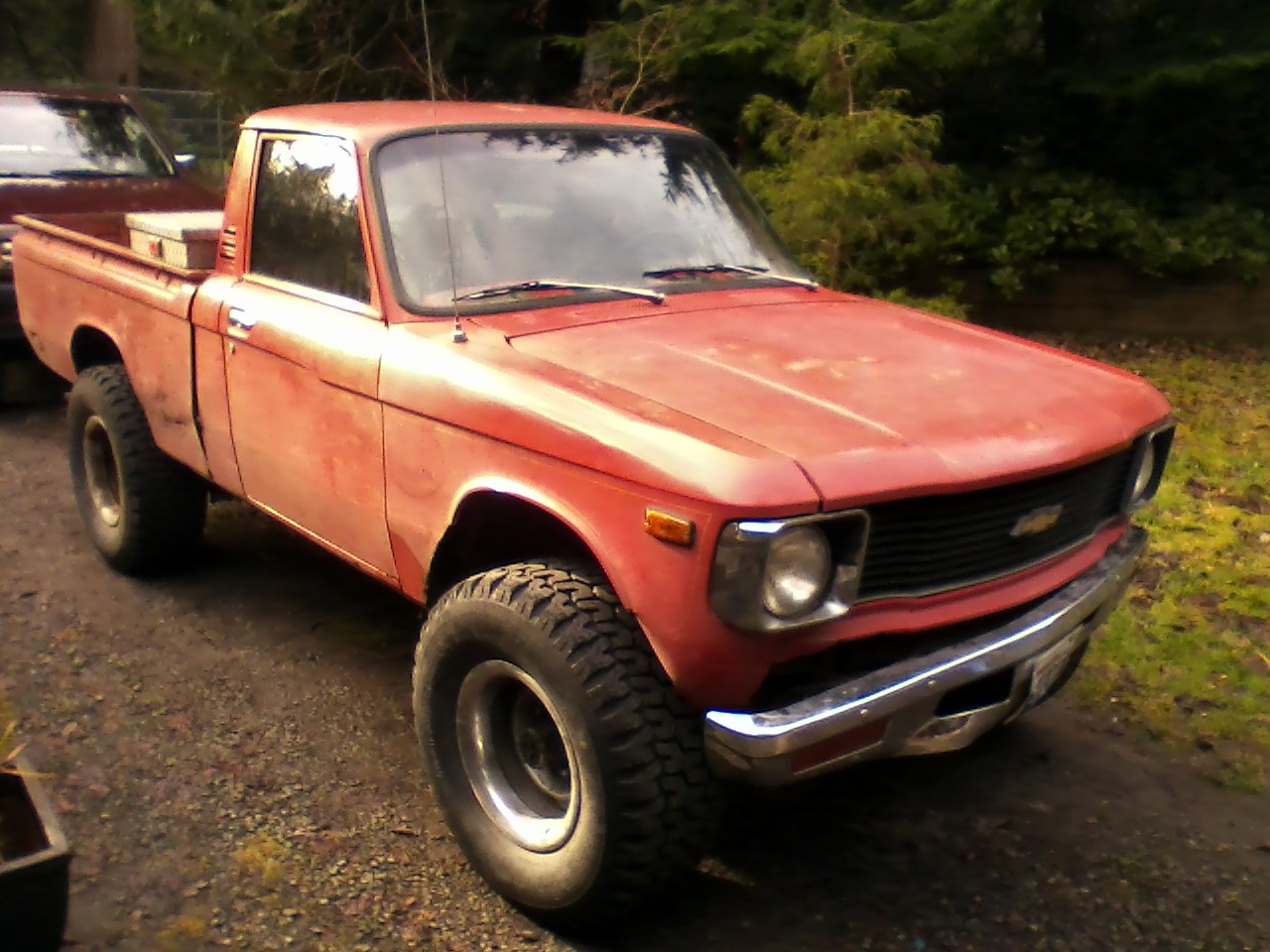

I posted an intro somewhere around here quite a while ago, I mostly hang around isuzupup.com, but I've been reading up here quite a bit lately. Thought I might as well show off my luv. It's a slow work in progress right now
This was how I got it, paid $500

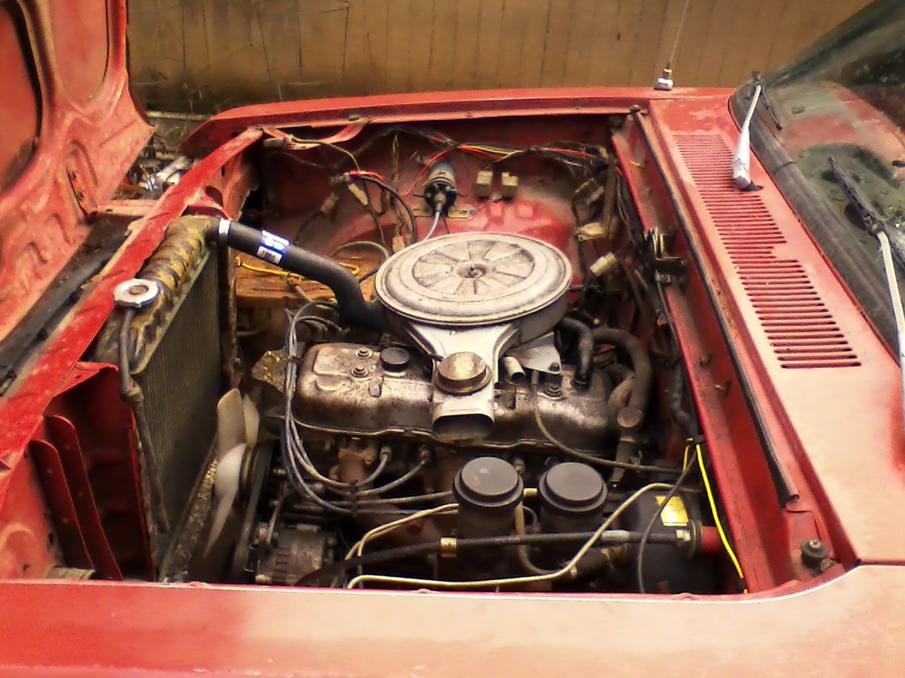

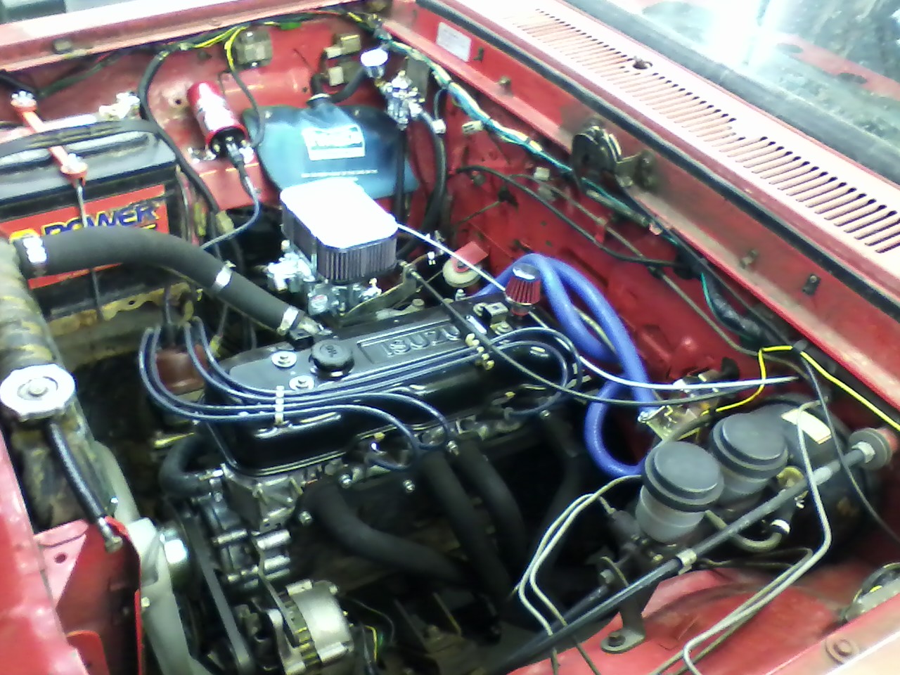

The motor blew up a couple months ago (one reason not to tie the radiator to the core support with old shoe laces and bailing twine and then fly through a mud hole :evil: ) Was overheated multiple times and the compression ended up being 120 on #1, 60 on #2, 40 on #3 and 120 on #4. The new motor came out of an 81, so I've got the electronic ignition now woo hoo. threw some other stuff on it like msd coil, brand new 32/36, header, and a w/s washer bag outta 1970s ford truck. Thinking about an offy intake... :P

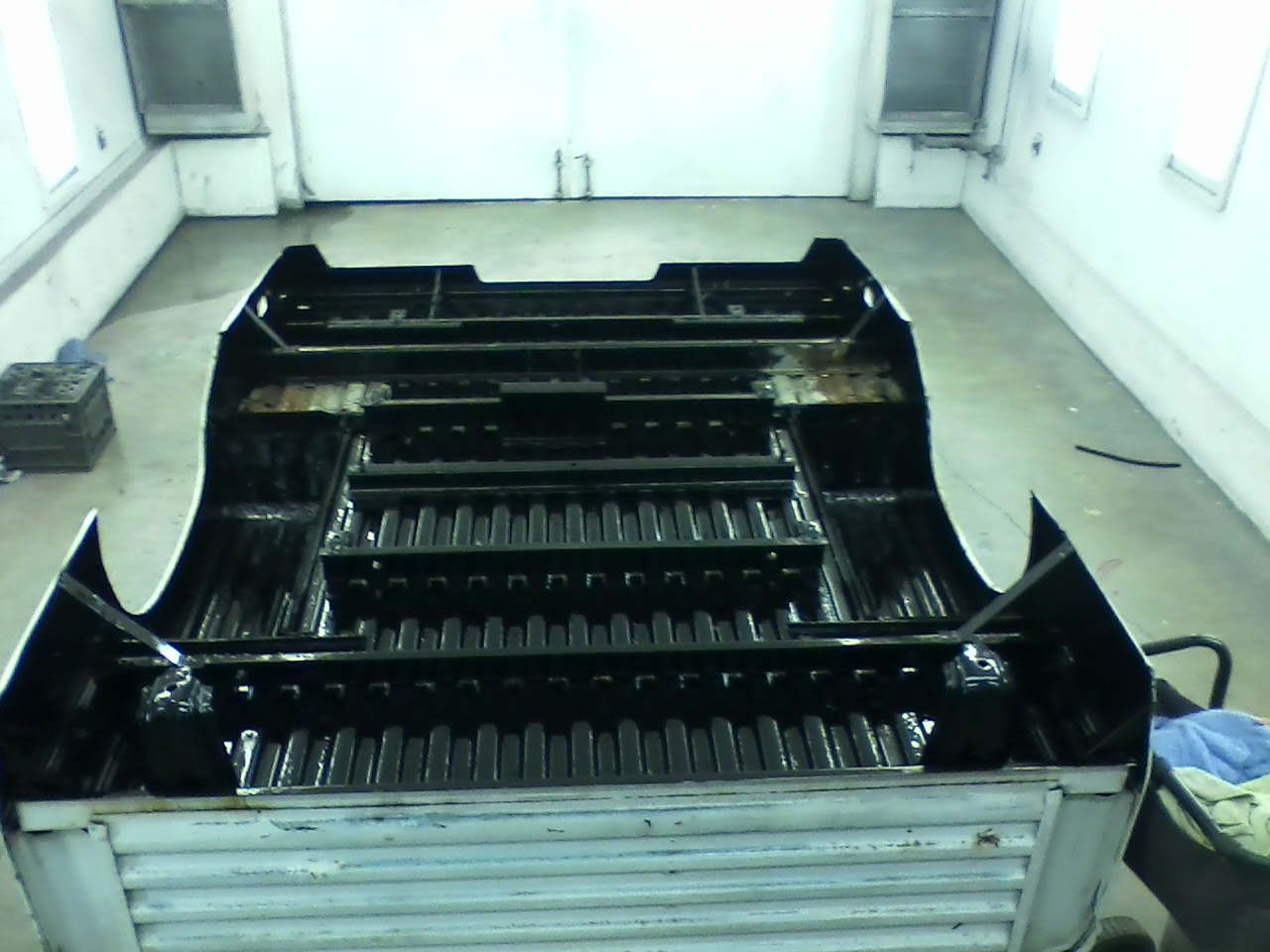

The outside is the same, I'm putting the body work and paint off till next summer. Right now I'm working on coating the frame and under body with Hammerite. I went and picked up a new straighter bed from some nice folks a few weeks ago, just got the underside done last night

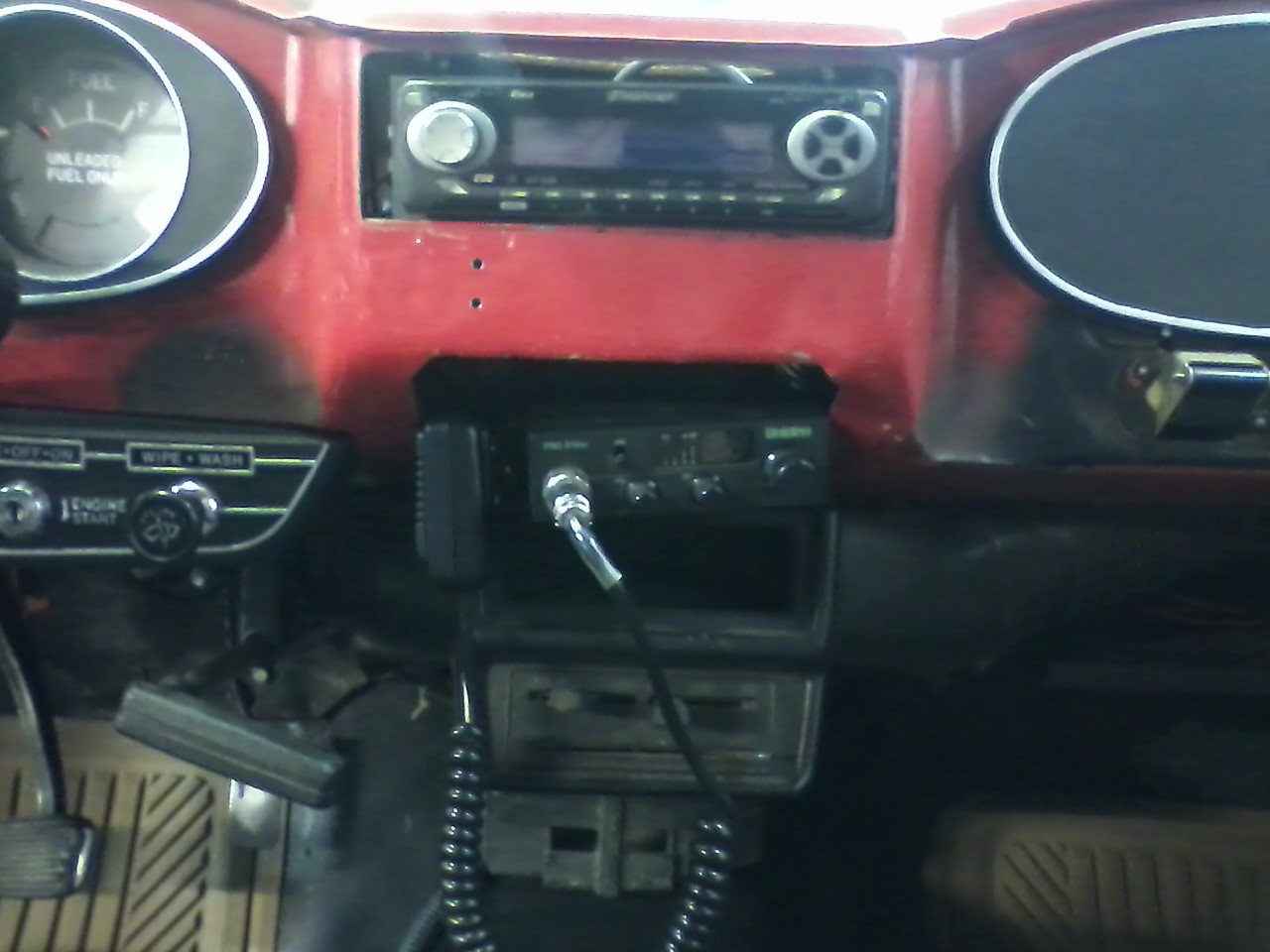

Right now I'm in the process of figuring out how to put these in....I'm a bit stumped :x
Any suggestions are welcome, there's no bracket for the factory radio or anything, it was wedged in there with a folded matchbook and some plumbers tape in the back so it didn't fall into the dash

mine isnt in there perfectly but i used a little frame around the radio with some tabs bent out to keep it centered, had issues with vibrating in there so i stuck a little bit of spare wiring underneath it to pad it.. thought about using those little rubber "bubbles" that you use to pad cabinet doors form slamming, to keep it from rattling,

Might check with custom auto sound to see if they have a DIN kit to fit that hole. I found a radio with the kit in the JY and bought it just in case my next one has been butchered...

I was thinking of welding in the radio bracket, just like 2 little tacks in the back, that might work okay I guess, those brackets are pretty much universal anyways. I'll try looking for the custom audio thing, thanks. The weber dizzy and header work fantastic. I fried one ignitor though, I accidentally wired the power through the tach sender. I had never worked with a later 1.8 before :oops: My favorite part is the weber though. I had some oddball weber on there before, its was a 32/34 DFT and had vacuum leaks all around the throttle shafts. The truck runs absolutely perfect now, even better than my 89 2.6! :D
