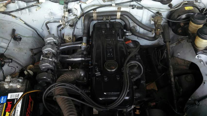

I need to build a small tank to gravity feed the 4 carbs. I can't find a electronic float valve. Any ideas for where I could look?
 Post subject: Re: Mikuni meets Isuzu
PostPosted: Thu Apr 18, 2013 10:57 am
Joined: Fri Jul 16, 2010 8:04 pm
Posts: 63
Cleaned up new paint, rings, bearings, gaskets, and seals.
