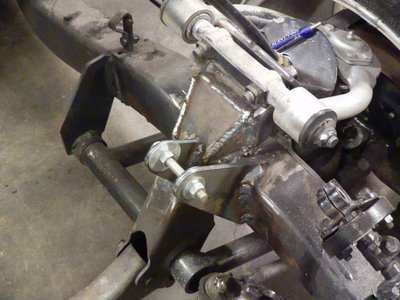

They are 5/8 heims, and will you be using the factory sub frame from the IRS you plan on running?
 Post subject: Re: my luv project....
PostPosted: Sun Dec 13, 2009 9:19 pm
Posts: 1251
Location: Loranger, Louisiana
I must agree with Mytmouz. 8O
Not trying to be a dick or anything, just trying to understand. If the geometry of those support rods are anything other than PARALLEL, camber MUST change as the tire moves through it's vertical range.
If the rods are closer together at the wheel than at the chassis, the tire will have negative camber in the upward travel and positive at the bottom of it's travel.
If the rods are farther apart at the wheel than at the chassis, the opposite will happen.
Unless you are thinking CASTER. :?
Rick
Loranger, La
1980 Stepside LUV (Again)

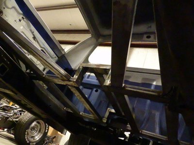

heres some updates

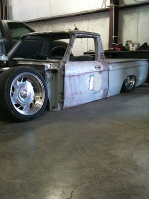

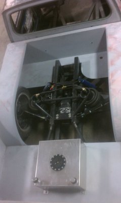

and more

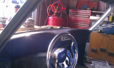

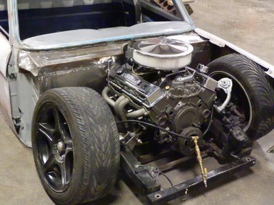

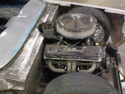

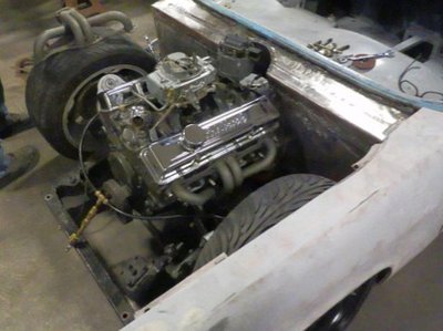

The firewall has been moved back 2 1/2"
PostPosted: Thu Aug 11, 2011 9:43 pm
Nice job on the dash 8)
PostPosted: Fri Aug 12, 2011 4:56 am
Joined: Tue Jun 02, 2009 7:57 pm
Posts: 34
Location: terrell
Thanks, I've yet to decide where I want to put my guages
