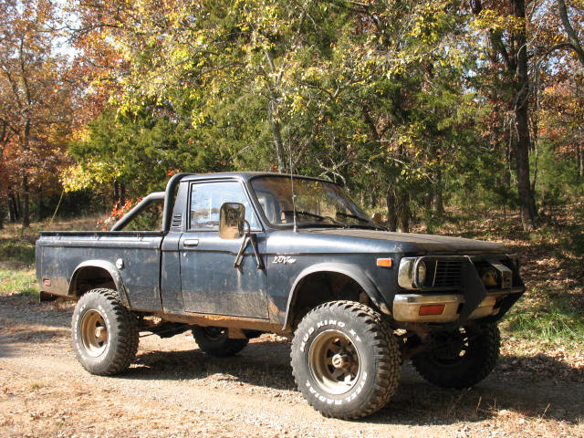

Now you have.

PostPosted: Wed Oct 19, 2016 7:12 pm
So is it a jeep style transfer case?
PostPosted: Wed Oct 19, 2016 8:43 pm
Posts: 906
Location: N W Arkansas
If your question is directed to me my t-case is a divorced Dana 20. At one time or the other D20s were used in about every brand 4x4 vehicle in production, including several models of Jeeps over the years. In that sense it is a Jeep style transfer case.

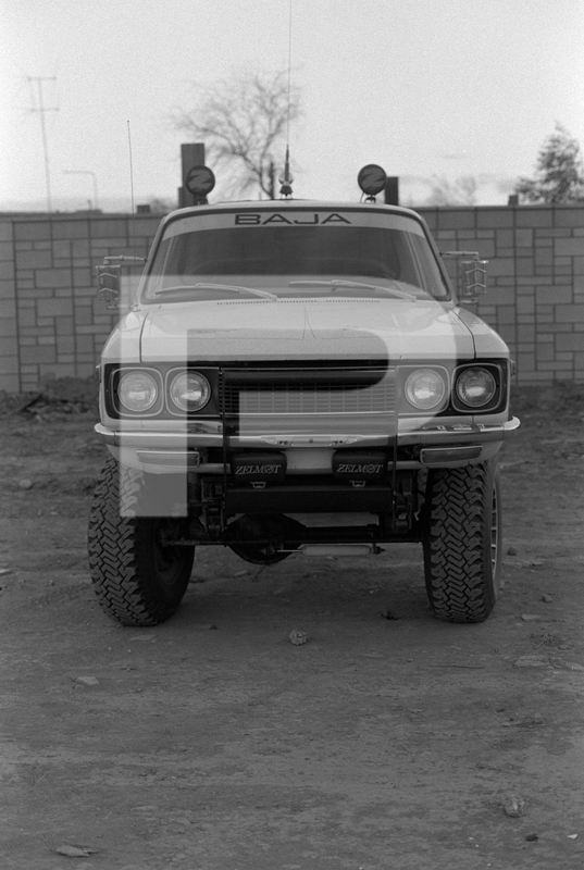

I found this Chevy LUV 4x4 conversion on the Petersen Archive in the 1978 SCORE Mexicali 300 race.
Link: https://archive.petersen.org/pages/sear ... &offset=0#
Baja Four Wheel Drive Conversions Chevy LUV 4x4-1.jpg [ 188.52 KiB | Viewed 22083 times ]
Baja Four Wheel Drive Conversions Chevy LUV 4x4-2.jpg [ 241.02 KiB | Viewed 22083 times ]
