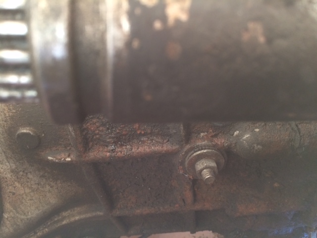

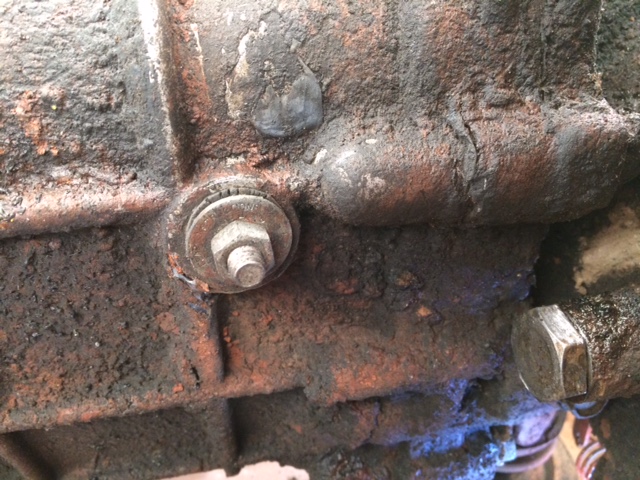

Take a look at these pics. I am thinking the stock drain plug has been replaced with this plug thing?
I am I correct in this guess? Should there be a 15/16 plug where this bolt plug thing is at?
Thanks Neal

Ok it appears that this is the plug location and someone jacked up the threads and replaced it with a rubber plug thing.lol
Tomorrow I will see if I can tape it and get a real plug in it.

The plug threads are so bad that I am going to just get a new rubber plug and call it done.
