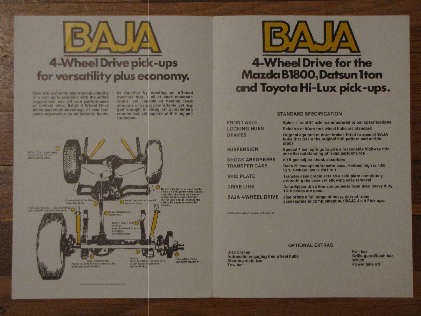

Here is a Baja 4-Wheel Drive conversion brochure.
