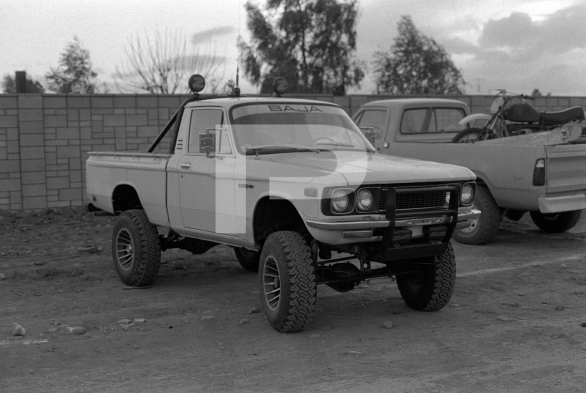

I found this Chevy LUV 4x4 conversion on the Petersen Archive in the 1978 SCORE Mexicali 300 race.
Link: https://archive.petersen.org/pages/sear ... &offset=0#
Baja Four Wheel Drive Conversions Chevy LUV 4x4-1.jpg [ 188.52 KiB | Viewed 22833 times ]
Baja Four Wheel Drive Conversions Chevy LUV 4x4-2.jpg [ 241.02 KiB | Viewed 22833 times ]
