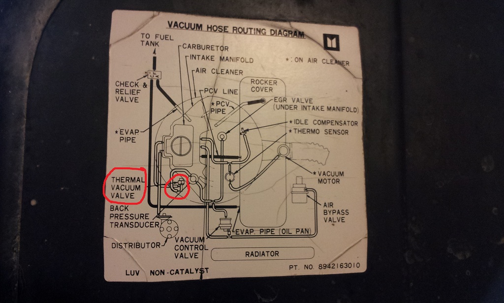

I have a 1980 Chevy Luv with a 32/36 DGEV Weber carb. The automatic choke broke so I put on a manual one. I'm having trouble figuring out where all the vacuum hoses go because there are a couple hoses that aren't hooked up from previous owner. Can some help me with this thank you.

I just did that conversion myself... precisely because I did NOT want to bother with tracking down all my vaccum lines and missing emissions components (for whatever it's worth, I'm attaching a diagram of the original setup).
Well, the good news is the Weber is waaay simpler. Fuel line in, vacuum line to distributor, breather line to the engine, make sure your fuel tank can still vent somehow (pinhole in the gas cap? ;) . I just plugged off everything else and it works great.
File comment: original vacuum lines... hasta la vista!
