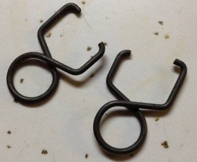

I got them in the mail today, I ordered them from partsgeek.com. I will be installing them this weekend.
