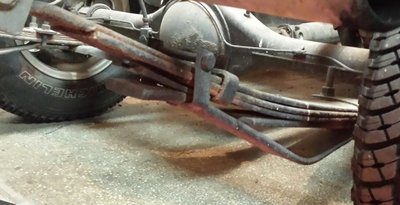

Anyone know what this extra leaf is for? Thanks

mine doesn't have that lower big kinked one so im assuming someone added it along the way with the body lift you took off.

It is a aftermarket helper spring. Usually installed to aid in lifting vehicle or because stock springs have lost the arch(sagging). Hope this helps.
