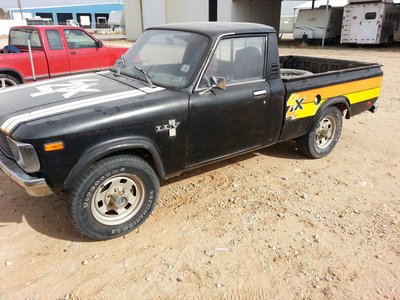

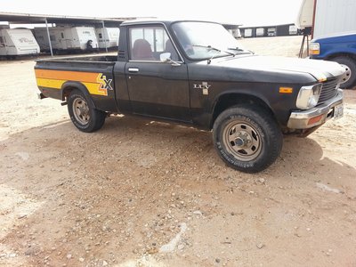

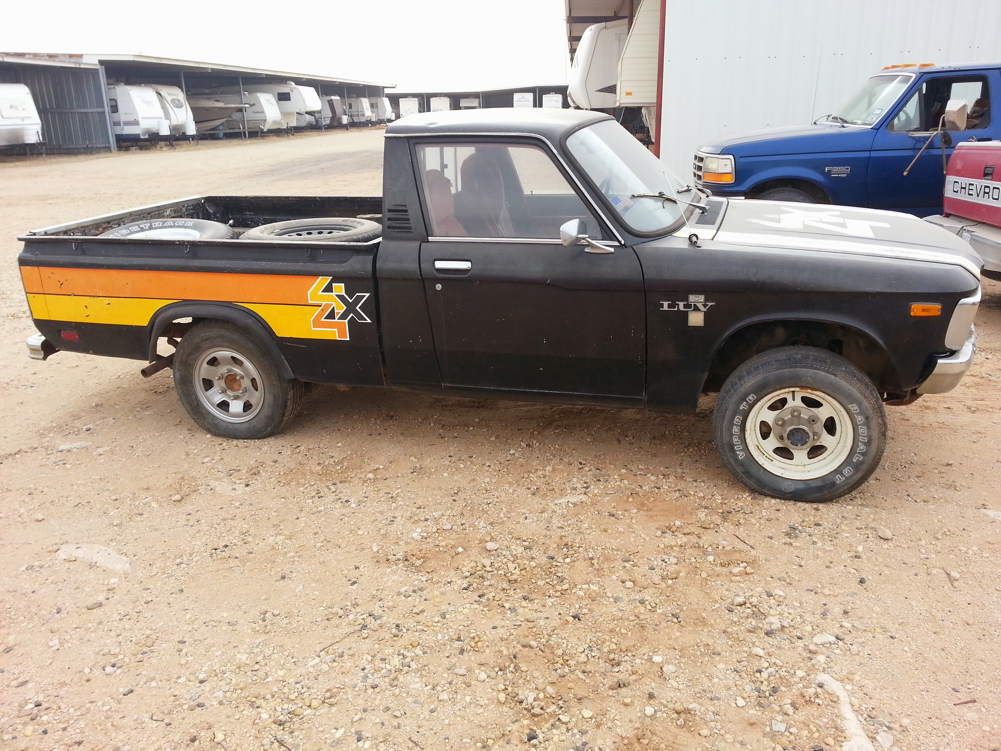

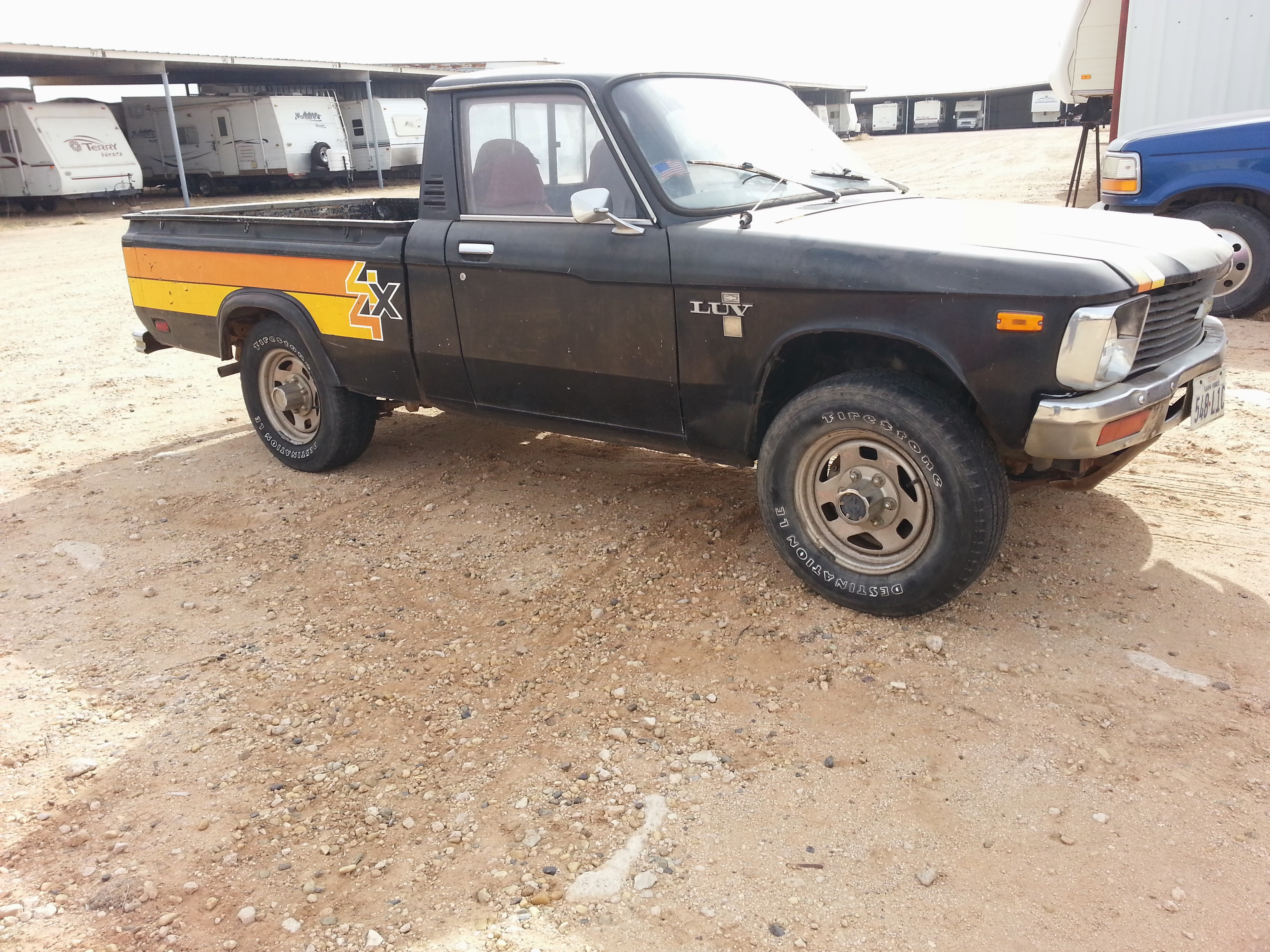

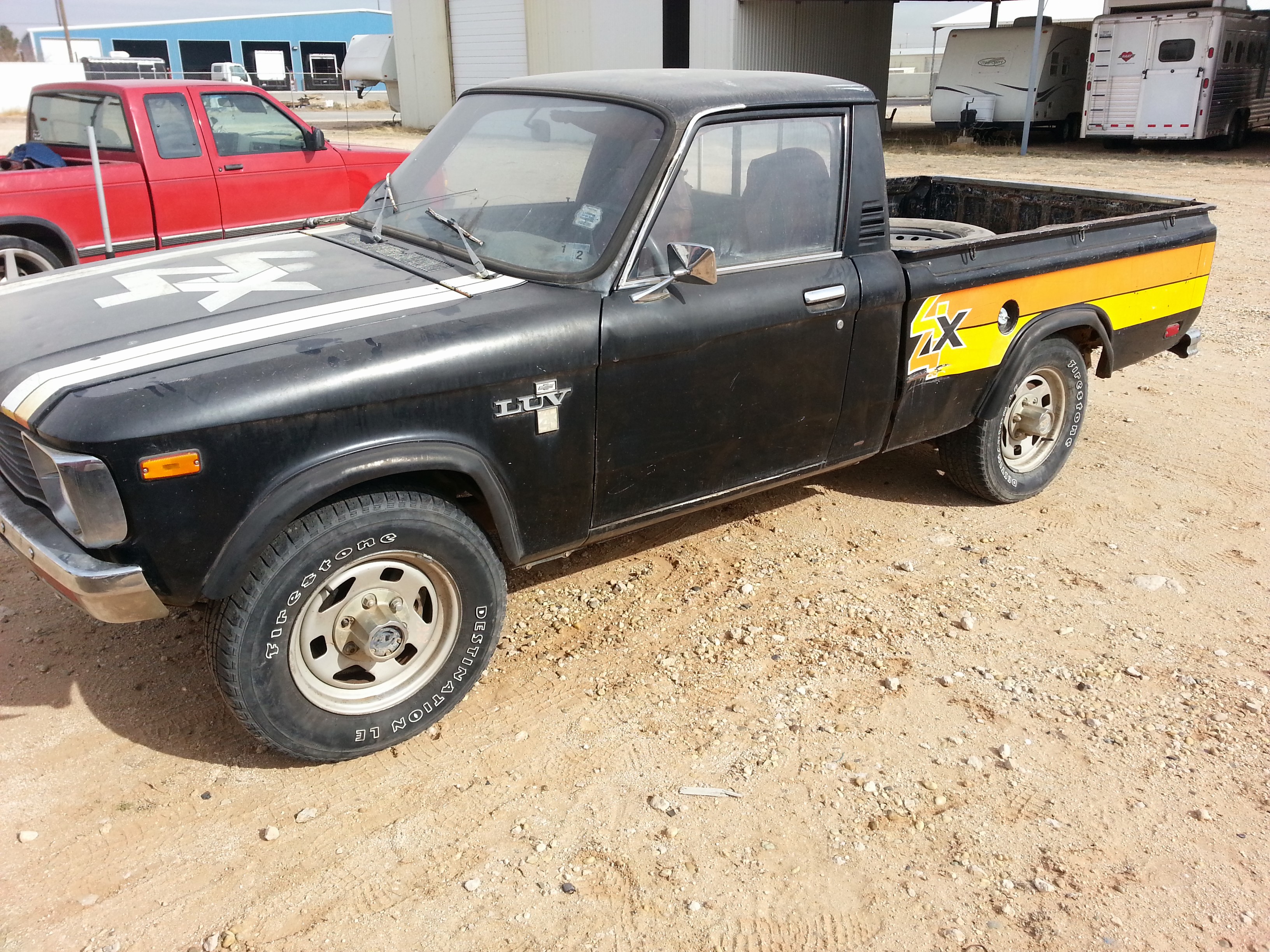

picked up these trooper wheels and firestone tires for $200 total then had an old customer of my who owns a tire shop mount and balance them for me on barter. I had the factory 4x4 LUV center caps and they fit perfect! i think the only thing im going to do now is add a set of beauty rings to make it pop. tires are 225/70r15. any bigger and theyd prob rub but these seem to be perfect for stock height trucks. the truck sits level but the pics make it look like it sags in the back. its just an illusion. i still havent anymore since it was kinda pointless to work on a truck that had tires that wouldnt hold air for more than a couple hours. i plan to bring it home and clean the tank over the weekend then it should be ready to roll. ive already put points wires plugs cap rebuilt the carb and have a new battery also.
