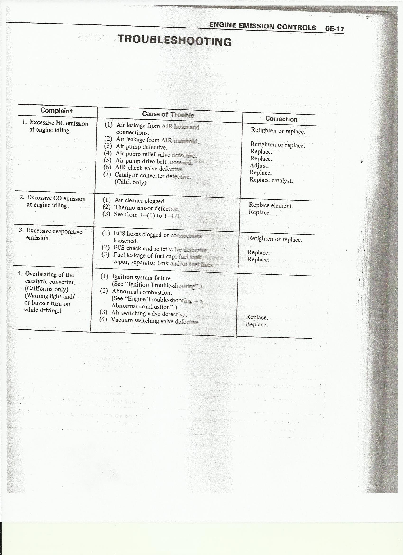

If the stickers are still under the hood they will say if it's CA or Fed. You don't say what year your truck it is, but through 1980 Only CA trucks had catalytic converters.
Make sure the float level is correct.
There should be an idle mixture adjustment screw, but sometimes the head is epoxied over to avoid tampering, drill out the epoxy.
The attached is for an '80.
