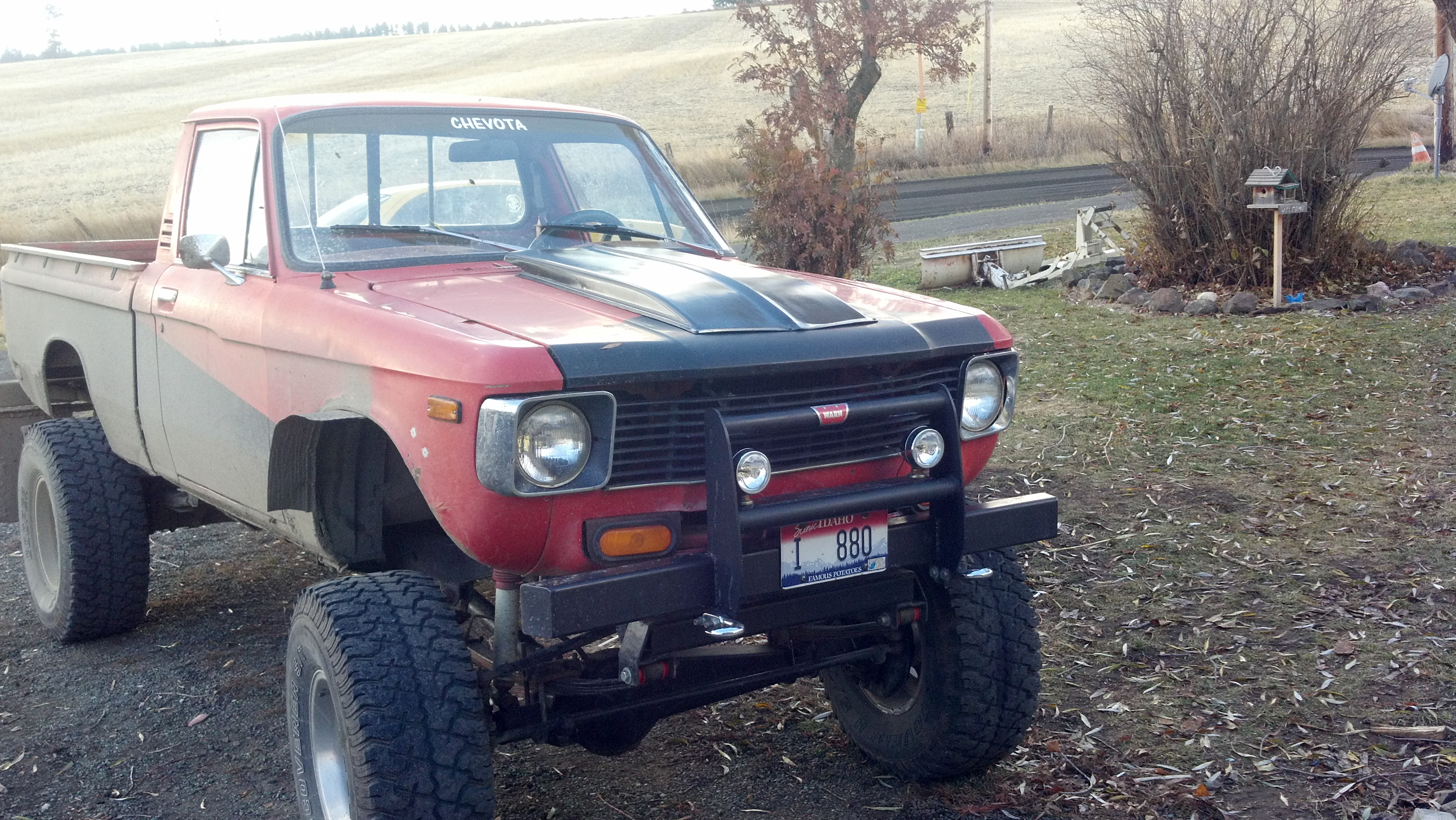

PostPosted: Mon Nov 25, 2013 4:06 am
Joined: Sun Mar 06, 2011 9:16 pm
Posts: 29
Location: WESTLAKE ID
The best lift kit
File comment: Sas
 Post subject: Re: 4x4 suspension lift
PostPosted: Sat Nov 30, 2013 12:29 pm
check some of my post and you will see my 4x4 lifted the max you can do and still drive it after that it will be a straight axle to get more lift.
