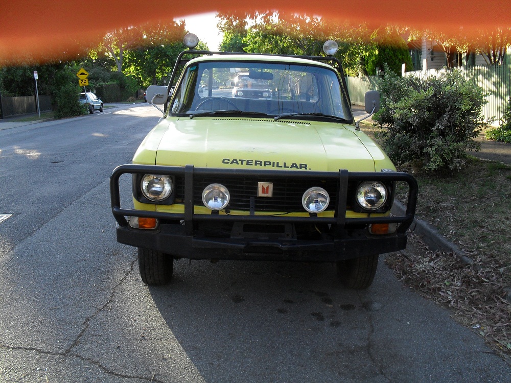

For those who wish to fit a bull bar to their Luvs, i have found the ARB 3434010 is a compatable fitment for the Luv. They are listed for fitment to 81-88 Mitsubishi Montero's. All you need to do to fit, is fabricate two simple brackets from flat steel and drill four holes.

Got a price on one of these at a Arb dealer. $999.

Damn, i payed half that for mine and it came with complete running 4x4 Luv.

for that price you could custom fab one along with matching rear bumper! :lol:
does look pretty beastly on the luv, "caterpillar" is a nice touch :egeek
