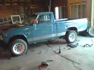

I just installed a 2 inch lift on mine but thatll be my personal max but to each his own.Each guys gotta be happy with his ride cuz in the end hes the man paying for the repairs his tweecking caused.Were all crazy just to what extent
